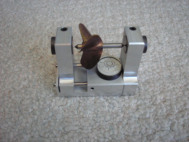

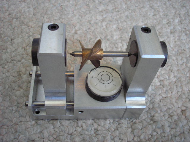

The magnetic propeller balancer shown in the photos was built in 1978. Three leveling screws & the round leveling device make it possible to easily level the balancer. Two .875" diameter X 1.000" magnets are used at each end. One end of the balancer is adjustable. It can be moved & locked into any position when using different length shafts. All of the full hardened shafts used have precision ground points, concentric with the shaft's center line, which ensures that the shafts themselves are not out of balance. Once a prop is balanced, very light polishing with #800 grit wet or dry paper will knock the balance off.

deansok replied the topic: A Magnetic Propeller Balancer
why do you need to level a magnetic balaner
#20933
strictlybusiness1 replied the topic: A Magnetic Propeller Balancer
YOU DON'T! Purposely added bling that is not a permanent part of the balancer to see who is really looking at & thinking about what is posted. Good thinking & observation on your part.
