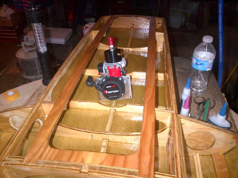

mephiskapheles6 replied the topic: 1/6 scale Miss Supertest III
Three coats of the System Three and a wee little zenoah

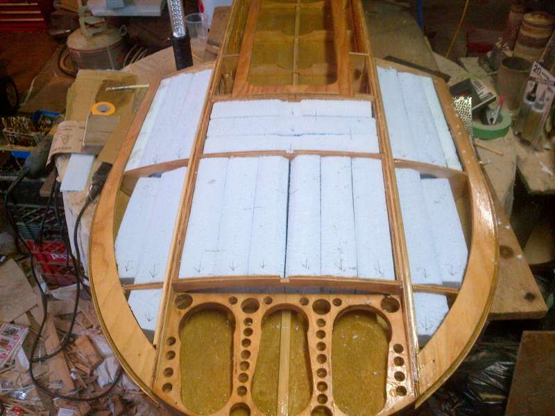

Wow...I have a lot of work ahead of me if I am to get any where close to that...just got the kit yesterday so I am in the process of building it.
Got some floatation fitted...gotta head out to the pond to check for leaks before I skin the top...she will not fit in my bath tub!

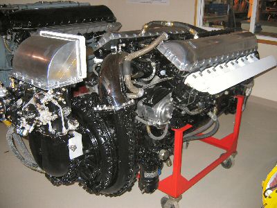

tootalltechie replied the topic: 1/6 scale Miss Supertest III
Miss Supertest II and III both used RR GRIFFON MK 58's. in the last picture the intake is facing down with out the carb on it.
the above picture is a "Merlin" but not the Griffon a Griffon rotates in the opposite direction (notice supercharger outlet)
the above picture is a a Griffon, also notice round top on cam covers
I was aware that the engine in her was a Griffon, however I was unable to find a dummy Griffon engine kit so I opted for the Merlin (at least it is a Rolls Royce) I will attempt to make a few changes to it so that it looks closer to a Griffon.
