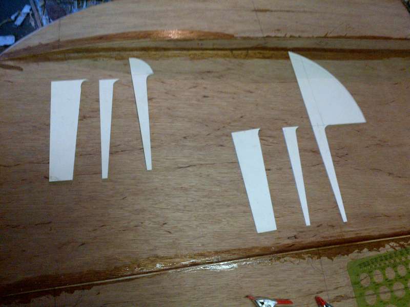

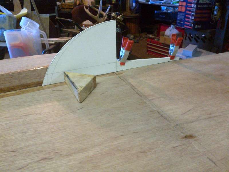

Here is what I have come up with for the turn fin/air damn. Any thoughts or constructive criticism are welcome. I was thinking about trying to make these out of aluminium, is there a preferred type of aluminium used in this hobby?

tootalltechie replied the topic: 1/6 scale Miss Supertest III
most rc racers put turn fins on or near the outside of the ride pad. I would try to make it flush with the side of the sponson / tunel...less drag. looks good
EDIT: most rc boats will tell you if you go too much to scale the boat will not handle well.
#22317
mephiskapheles6 replied the topic: 1/6 scale Miss Supertest III
Good to know...I was just concentrating on getting her to look like the real deal...I will re work the cardboard pieces.

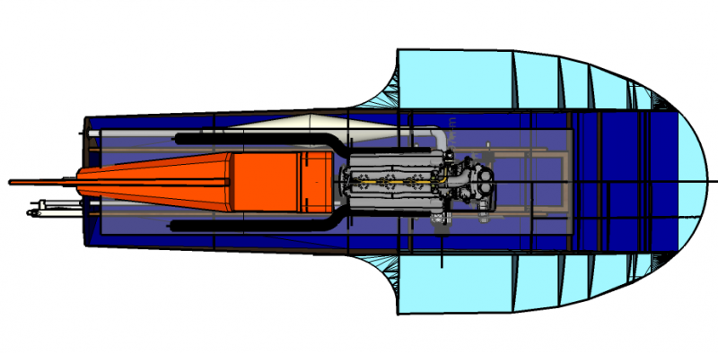

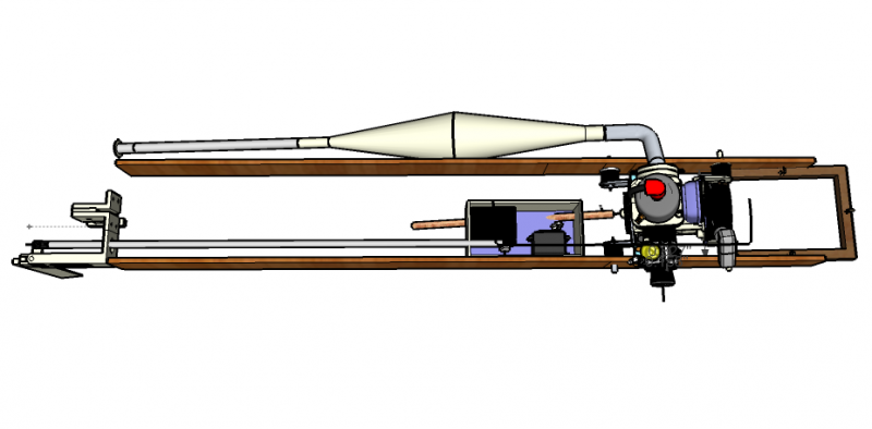

This an rendering of the hardware layout that I hope to use.
#22389
I like the layout...guess there is no getting away with trying to hide the pipe under the cowl?
#22391
the pipe on most RC "thunder boats" hydros sits outside the engine rails, the rails are 5 inches apart, usually 1/4" plywood. The pipe will usually just fit under the deck, it will need cooling. On zippkits and others people cut cooling holes in the side of the hull and direct airflow over the pipe and out the transom. On Miss supertest 3 there are vents on the deck either side of the cowl that could be used.
