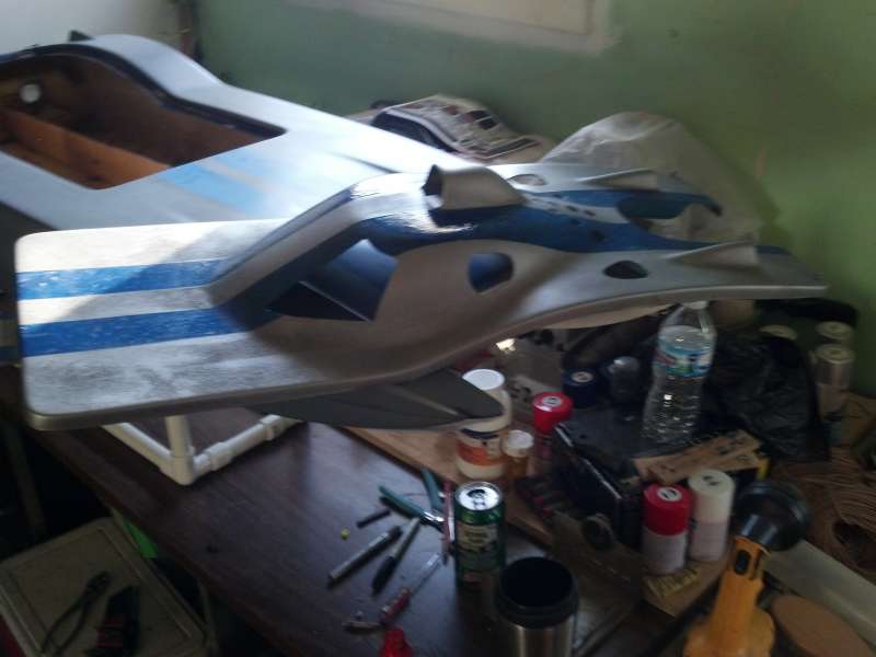

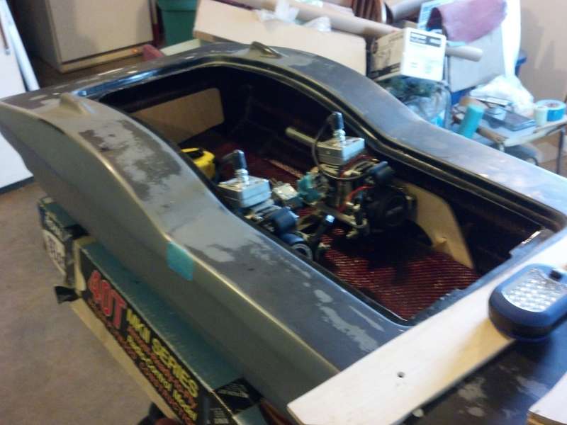

Here's my project. I got the hull for a dept from a engine build. I might be doing it the hard way but she's come along way in the past 60 days. She is a glass version that I sanded 2 1/2 pounds out of and have replaced with a layer of red carbon/kevlar and vinyl ester resin. I removed all the wood and replaced it to fit my agenda for my twin 27 cc Rmck evos which I wanted to be side by side and not offset. I hope these pics will upload and I will post more on the build as I go.

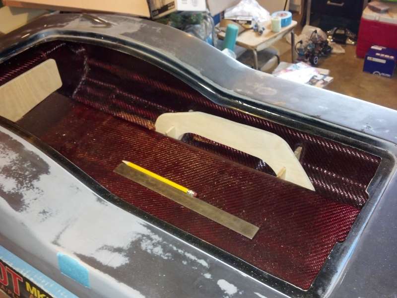

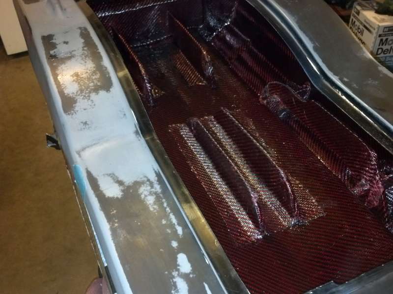

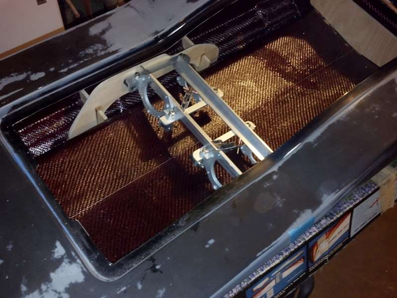

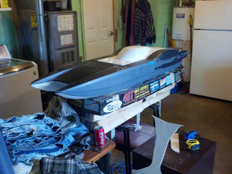

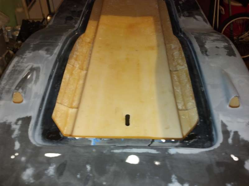

Yes she was rough when I first got it, but here's a few more pics of the progress.

bn2o replied the topic: My project. 60 inch Mti by Expresscraft
A few more pics and thanks Tom for the new hatch, the one that came with the boat was hacked up to much. The hull and hatch with stringers and carbon/kevlar comes in at just a couple ounces over 12 pounds. Now if I can keep the paint job in check she shouldn't come out to porkly.

marc replied the topic: My project. 60 inch Mti by Expresscraft
She's coming along nicely!!! Good work!
Thank you Marc, in the process of doing the body work. Can't wait to paint it!! Lots and lots of block sanding.
