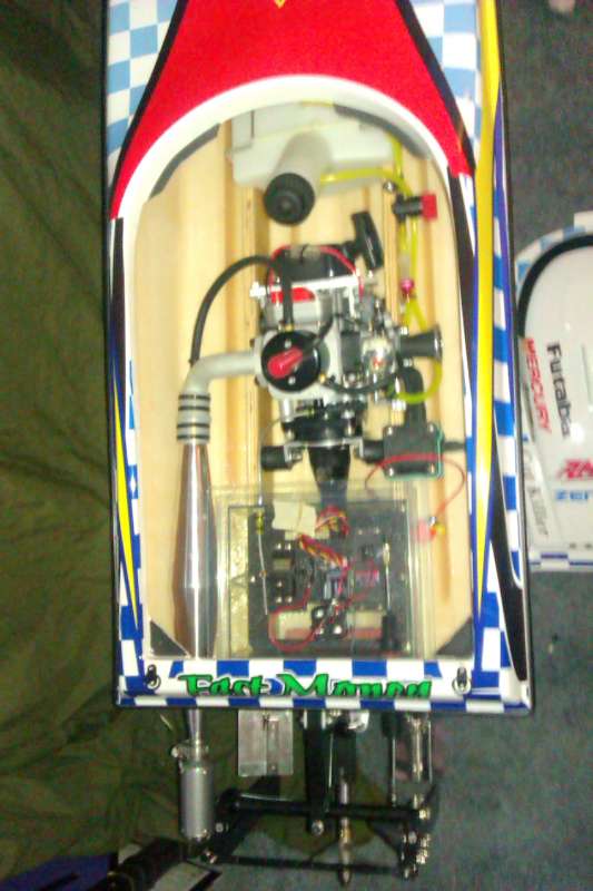

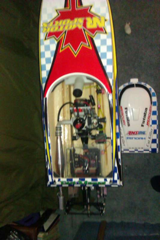

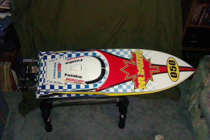

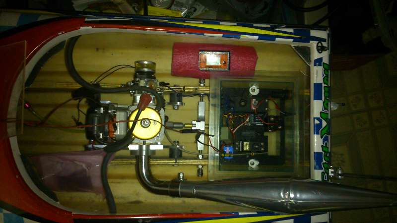

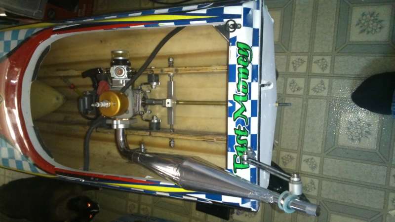

This is my WHH Team Pro. It started out a stock RTR 26cc Zenoah with a clutch. since then I removed the clutch(2nd year). Curently I'm fitting in a 28.5 cc 1.6mm stroker.

madanna67 replied the topic: Warehouse hobbies Team Pro
Forgot to ask , Is that one of Daniels pipe's? I like the clamp fit.
#23968
tootalltechie replied the topic: Warehouse hobbies Team Pro
Yes that's Daniel's pipe currently set at 12" ,
#23971
Nice, let us know how it runs when you get a chance to run it.
#23972
The engine is a 28.5cc 1.6mm Tiger King crank, high speed nylon bearings, low drag seals, WT-813 carb with a "bat wing bar", aluminum intake, NKG iridium plug,

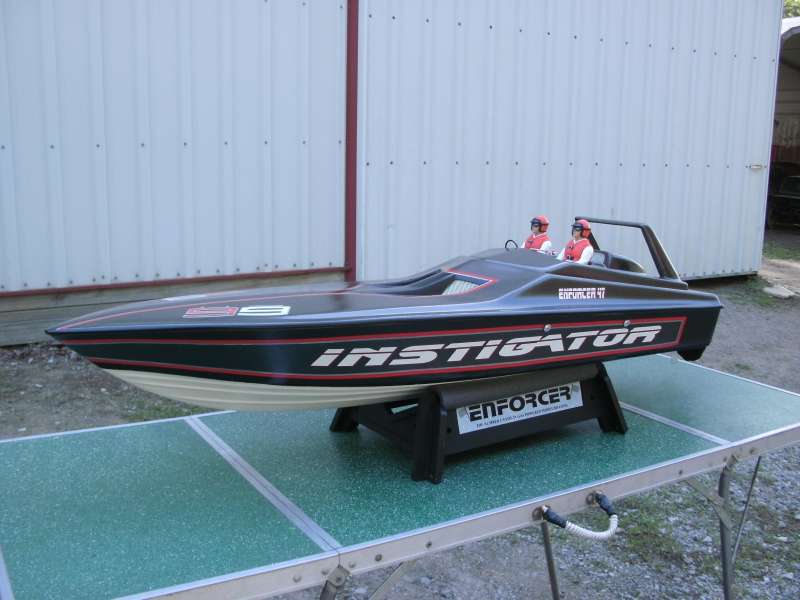

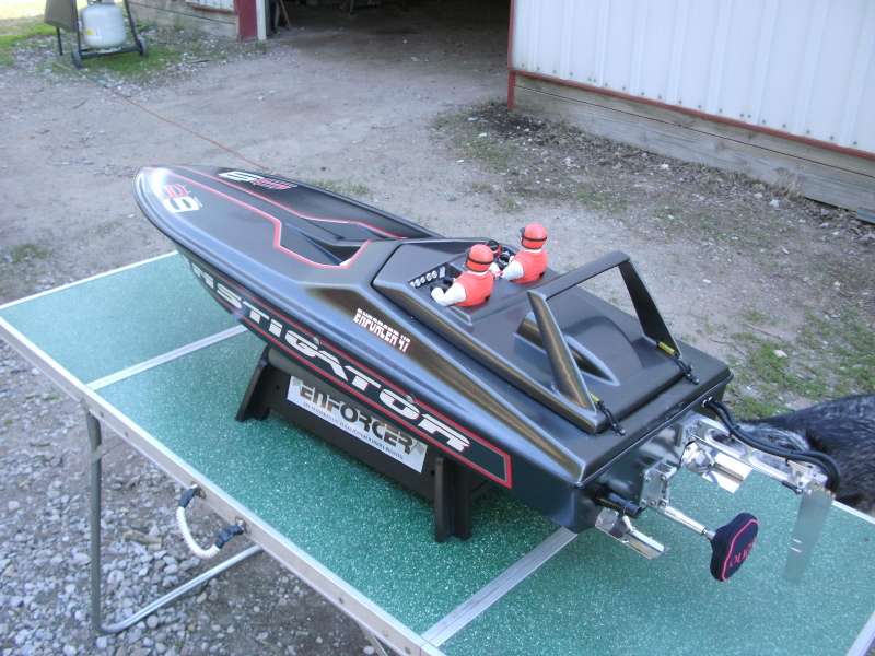

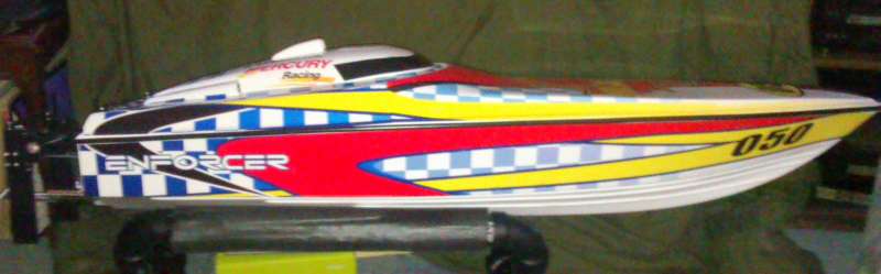

Motorboater replied the topic: Warehouse hobbies Team Pro
Nice one techie. Do you have a shot of the whole boat? What I can see looks great. Would that've run the old XP-2 inline drive that the Enforcers had?
#23978

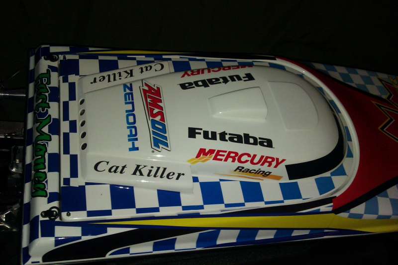

These are pictures just after I had the wrap put on with the stock engine setup. the drive setup is the SPDIII drive that has been powder coated.
#23979
Nice. Real nice. I love flat black & polished alloy hardware against white hulls. Same drive setup going back on?

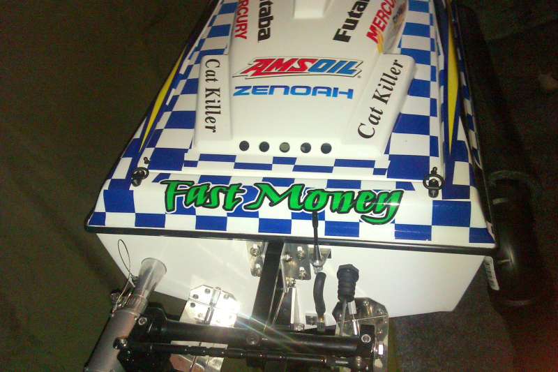

#23981
Yes same hardware is going back on, since this is a "play" and does not just turn right I like the dual rudders.
