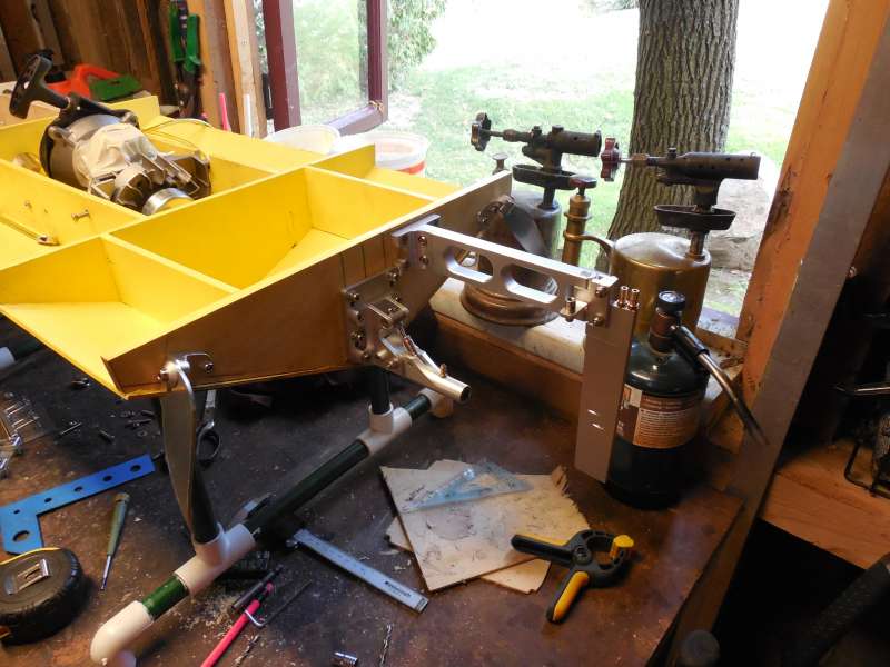

Ok so here's a pic of the stinger:
#25050
Canadian Hot Rod RC Boats replied the topic: How to waterproof a stinger drive
No seals on that stinger - you lube it through the little brass fitting on barrel. The fitting is between the 2 bearings so it will lube each of them.
A little grease gun like ProBoat sells is handy for that. Oh if you have a chain saw shop around they sell 'tip' greasers for chainsaws that you can load with your grease
www.horizonhobby.com/grease-gu...se-5-oz-prb0100
This type (Chainsaw) you load with your grease
#25051

jacboat57 replied the topic: How to waterproof a stinger drive
Ok but the water doesn't go into the boat?? :huh:
#25052
The brass tube (5/16") stuffing tube it's called should extend about 3/8" thru the transom - most guys use piece of 11/32 over the 5/16 where it comes thru transom - and use a t-bar to secure tube in boat.
The tube should extend the 3/8" thru the boat and I add a small o ring over the tube to help seal it to stinger
that way your grease is sealed in tube all the way thru stinger -- if there is grease in tube and the boat is moving - water will not go 'up' the tube
This Easy V kit shows tube install - page 26 - 28 --- it shows tube being cut flush with transom - if you let it stick out 3/8" you can install a O ring over it and helps seal stinger to boat
May be good for you to have a look through Zipp Easy V instructions as looks similar to what you are building.
zippkits.com/~zippkits/evman.pdf
#25053
What stops water from going up tube is
  • Cable turning pushes grease to rear or back of boat
  • Proper sized brass tubing 5/16" ,014 Wall K&S #1151
  • Enough grease in tube
Maintenance -- you may get small amounts of water up tube when boat sitting and grease getting thin (after running a bit)
Maek sure you install floatation like in Zipp Manual above

Steve Seebold replied the topic: How to waterproof a stinger drive
What kind of drive is it? Who makes it? I wasn't aware of anyone using roller bearings. I know I don't use them in my stuff. They are too likely to wear a groove in the shaft which could cause a catastrophic failure.
#25055
dwr9 replied the topic: How to waterproof a stinger drive
Looks like a Chinese manufactured stinger that is sold by a number of people on the web. I have a very similar stinger. It works quite well, but you are right, they can wear the shaft. You have keep an eye on the shaft. Doug
