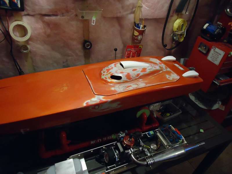

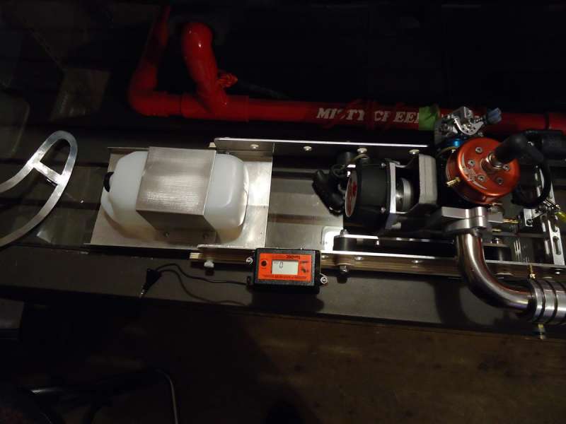

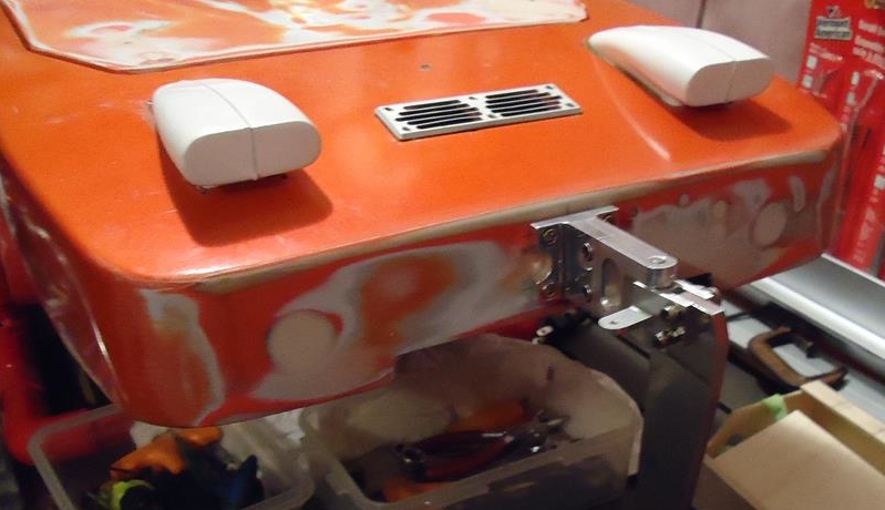

My rebuild of my Drambuie -
I figure "Real Hot Rods" should look the part so ---
- Fitted new Scoops
- "Stub Rails" with 1/8" Polished alum Main rails -
- Alum servo box
- Alum Tank or Bag mount (will do either) I like Hard Tanks
- Rubber mounted coil and tach
- Alum oil tank
- CF NASCAR Roof Vent style "Vent and Strut access
Some Build Pictures
More to come

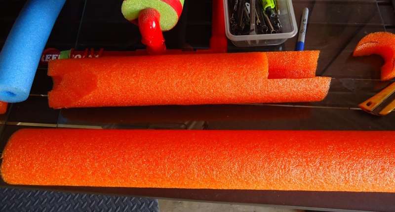

Canadian Hot Rod RC Boats replied the topic: My Hot Rod MHZ Drambuie

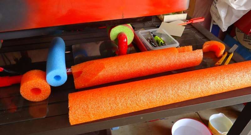

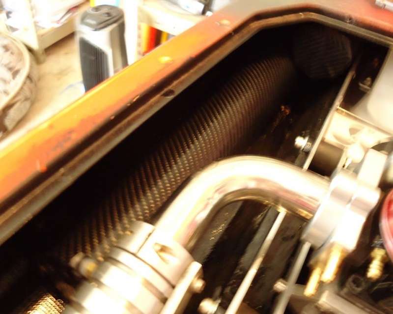

Waiting for some hose and few parts so did some "noodling"
I use Large noodles in front / back inserted into front ones -- and smaller on back (air flow)
Don't like blue or green so what u can see gets a cover of 3M CF - still needs some heat to get bubbles from noodles
I will also epoxy 'blocks' inside to Zip tie noodles to sides to keep in place

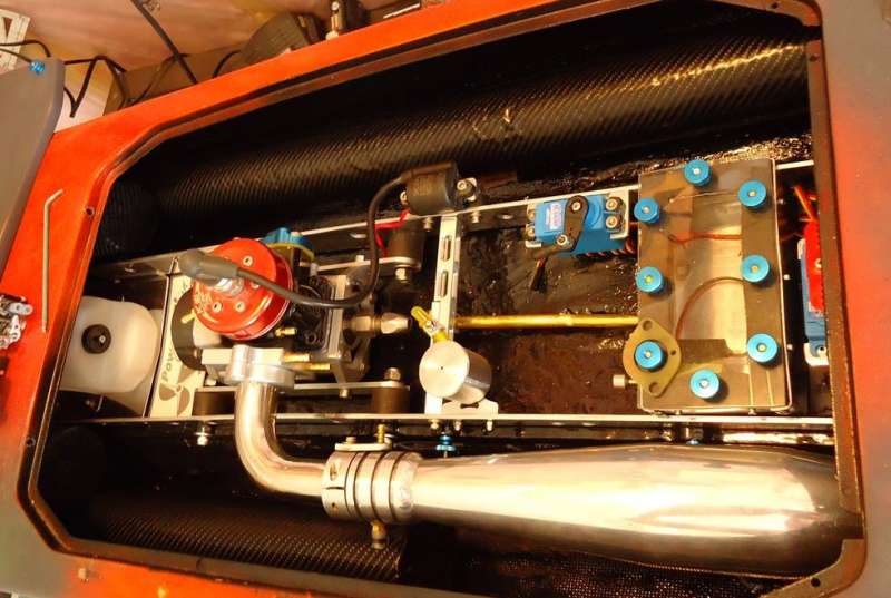

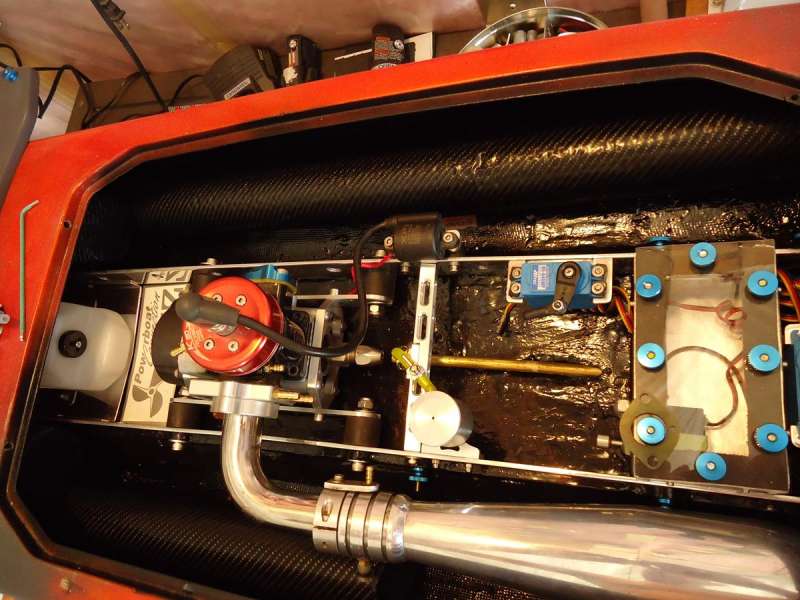

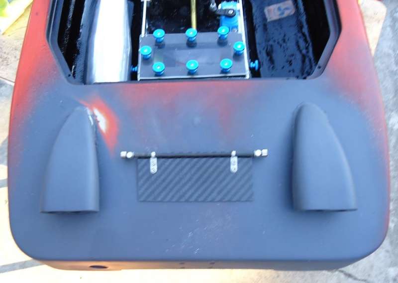

Hi
couple things about my boat
- aluminum main rails with 'stub' rails (double glassed in)
- Zen 36mm with TK 1.6 Crank
- CC 1" Header / pipe
- Alum servo box
- rubber mounted coil & tach
- adjustable (forward or rearward) fuel tank or bag mount
- custom duel rudder steering block (** From Steve here on MGB) with SpeedMaster hardware
- Hi-Tec waterproof servos
- Floatation noodles have been covered (wrapped) with Carbon fiber and zip tied to blocks glued to hull
- MHZ Scoops (replaced ugly huge thing) and MHZ scoops rear x 2
- Carbon Fiber (NASCAR style) Vent on rear (Center) - also allows strut adjustment
- Hand made windshield frame (made 2 x first one I screwed up and got wrapped around buffing wheel)
- Magnetic hatch
Zoom Zoom soon
