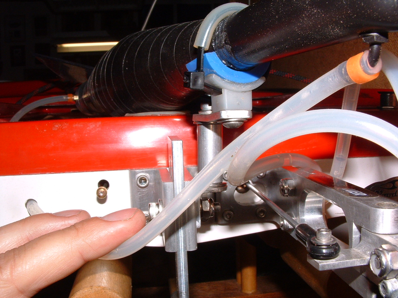

Hey I just noticed your pipe mount...looks pretty nifty! Did you make that?
#2787
Scott replied the topic: Re:Finally built it ... The Conquest lives !!
Thanks,
Yea it is all fabricated. Basically a small piece of 1/8 inch wall 90 degree angle aluminum attached to strut blade anchor screw, a stub of heavy wall aluminum tubing topped with an aluminum arm and pipe saddle, all tightened together with a single 10-32 screw down threw it.
Beauty of this is it can be swung left to right finding the natural center of pipe not binding the coupler o-rings. Strut can be adjusted without effecting pipe support position. Very K.I.S.S
