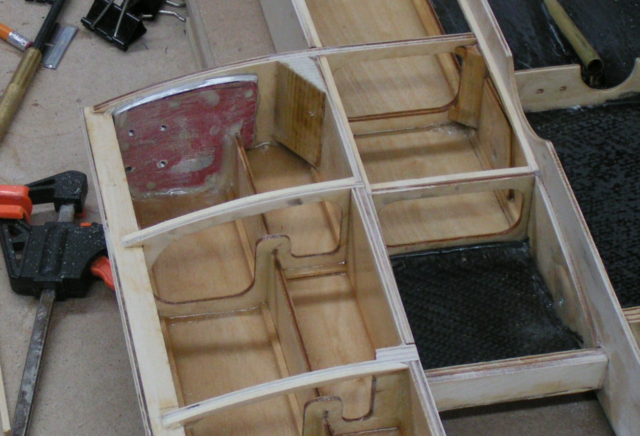

A sneak peek at the Whiplash wood kit I am building for review...will be ready to hit the lake soon as we get soft water! I am almost done with sanding and epoxy! Quite an interesting build! This is a picture of the framework.

tetrat replied the topic: Re:Whiplash Wood Review
Looks great Marc.. I have a couple more I am building right now. One from scratch the other from kit. The kit parts are really cut well I think. I have been helping Brian at Blazer Marine writing a new manual for him. It will also now contain a seperate manual for cowl installation. It is much more thorough and new builder friendly.. For the mounting of the turn fin add at least another 1/4 inch backing for the tee nuts. Then use the longer shanked t nut and this helps alot holding the bracket firmly to the boat. Just a suggestion. Good luck with your build, great boat. TomB)

marc replied the topic: Re:Whiplash Wood Review
Wish I had known the turn fin thing earlier Tom, I'm actually way passed that point now..the picture above was taken a while back. I finished mounting the cowl today. The boat is basically complete less the carb shield I want to make. Your thread on Jim's helped me out greatly, as the instructions are lacking a LOT. Definitely not a first timer's build project in my opinion, at least not with the current instructions. A lot of guess work if you don't know basics of building wood boats. Luckily I have done a few before attacking the Whip so I managed ok I think, but I still learned stuff I will do differently on the second one I have to build.
