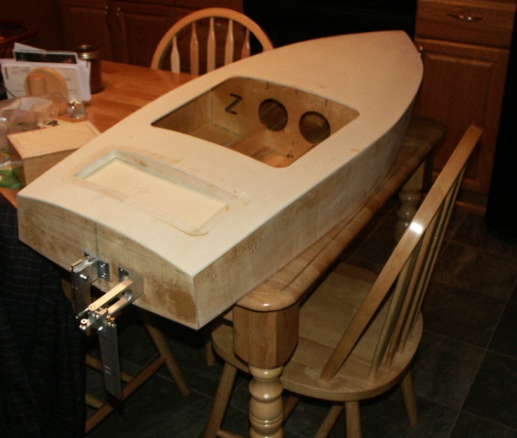

Building this one to replace the Bratz I-Box... daughters keep giving me a hard time when I race it... "Don't break it daddy!!!" :) So this will be mine. :drinks:

seadams replied the topic: Re:Another Build...Zippkits Z-Box
Looks like you are off to a great start. One thing is this boat needs down slope on the front deck. Anytime I would get mine up to speed it would blow off. Then I hit a turtle and tore the bottom up pretty bad. Got another one I am building with MAJOR mods to the bottom and top. If she runs good she will be a plug for a mold.

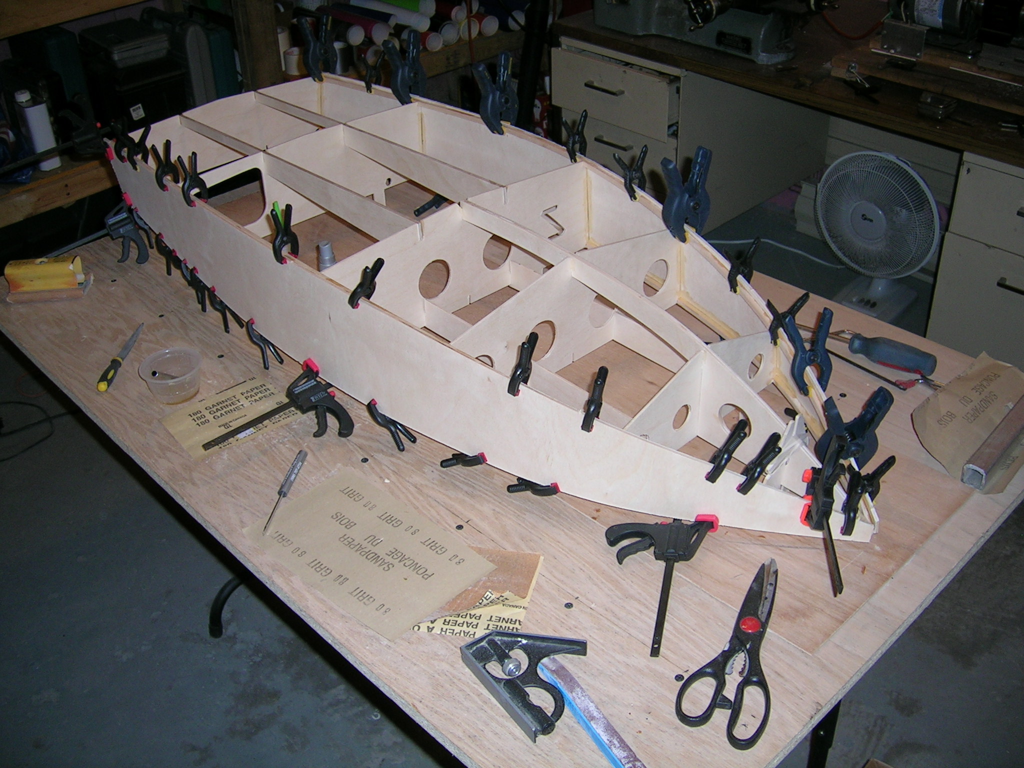

kennyrach replied the topic: Re:Another Build...Zippkits Z-Box
Hi m8 look nice .Here some picture of the one i building now

marc replied the topic: Re:Another Build...Zippkits Z-Box
Looks great! I am actually at the testing phase with mine now. So far seems to run awesome. If we can get some good weather so that I can go shoot some video I will post the review shortly. Here's a pic of the finished boat.
Look super with no paint and love the mad page of spy vs spy
