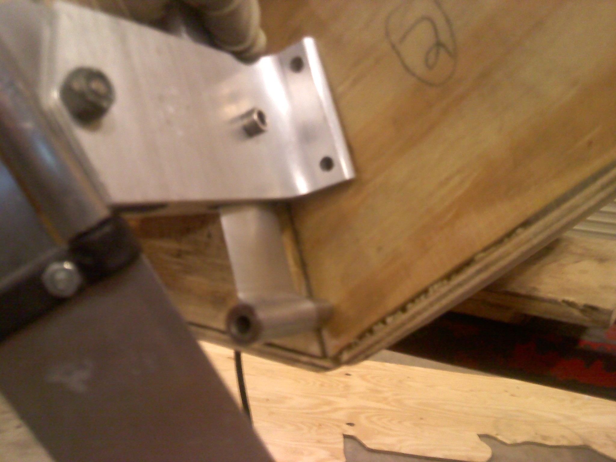

Alright guys, heres a simple but puzzling question, for me atleast. Where do I mount the strut on my deep-vee? It is 58'' long and wood.
here are some pictures. Any help would be great!

Most of us mount the strut for "surface drive"...in other words, the stuffing tube comes out the transom, and NOT under the boat. More like Picture 1. A good place to start with a lot of Deep Vees is about 1/2" above the keel (bottom of V). If you make the hole oval shape UP/Down you can adjust the strut at the lake for tuning.

You may also want to offset the strut 1/4" to the right to overcome prop walk too.
