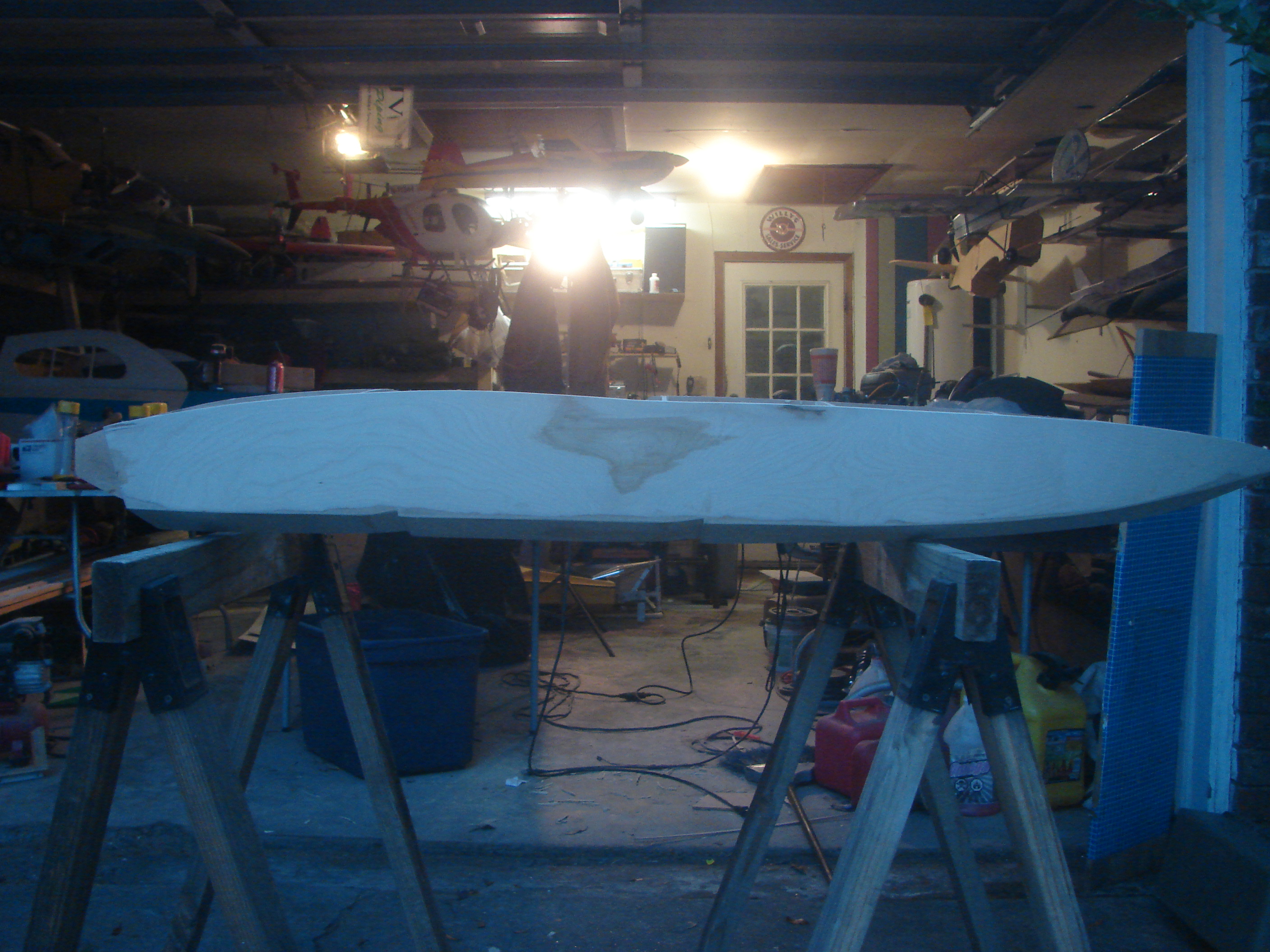

isuzudude replied the topic: Re: Killer Kat (Tech question added????)
It's actually wide enough to spead the motors out so I wouldn't have to wrap them outwards to get into the bottom of the sponson. But for ease, I think I'm going to stay in between the sponsons like you just said. But for straight out speed...should I submerge the props. Sorry to keep buggin ya Scott!!! :dry: But I know you have experience with making a boat go fast!!!(Compliment) ;)

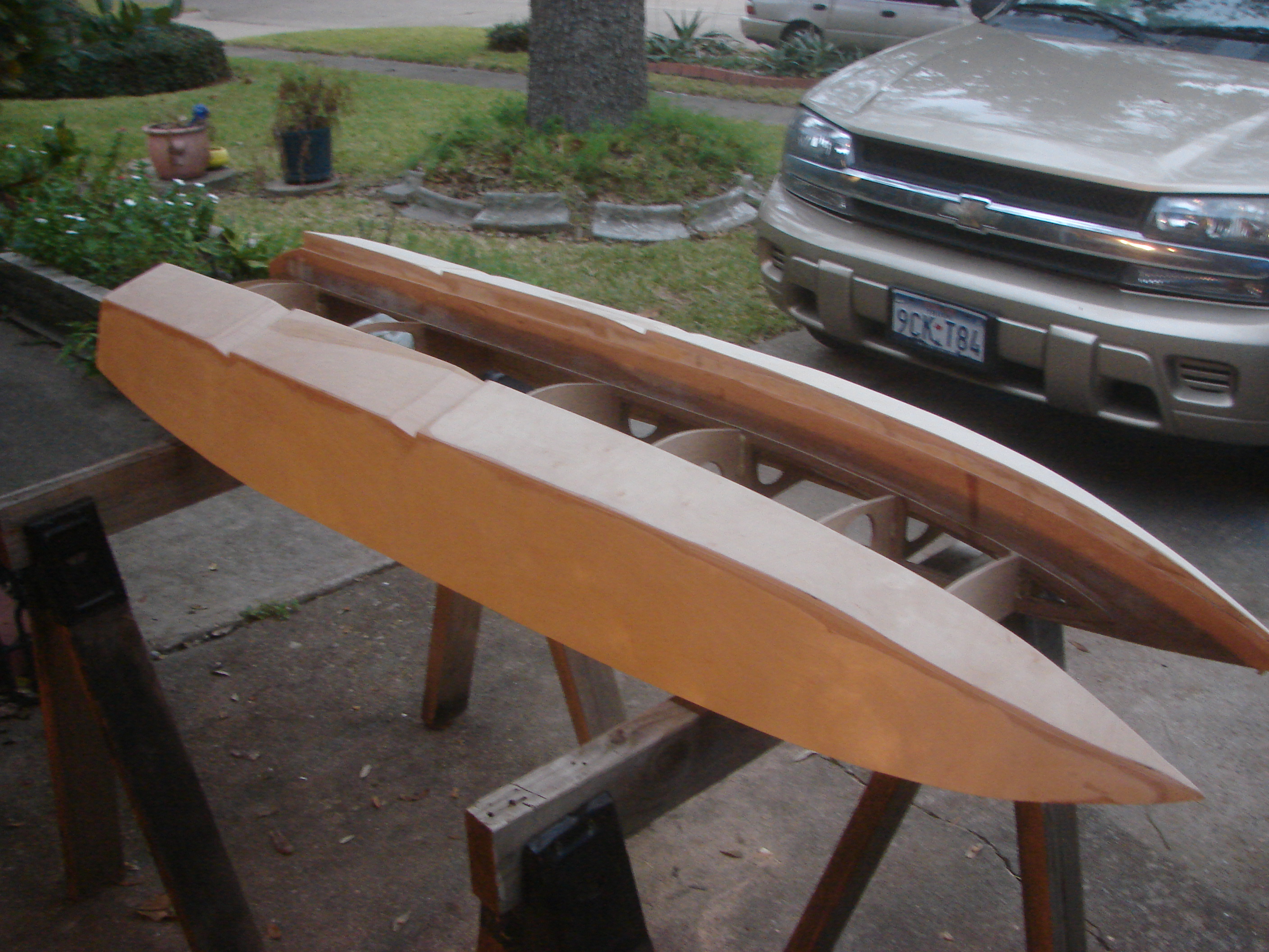

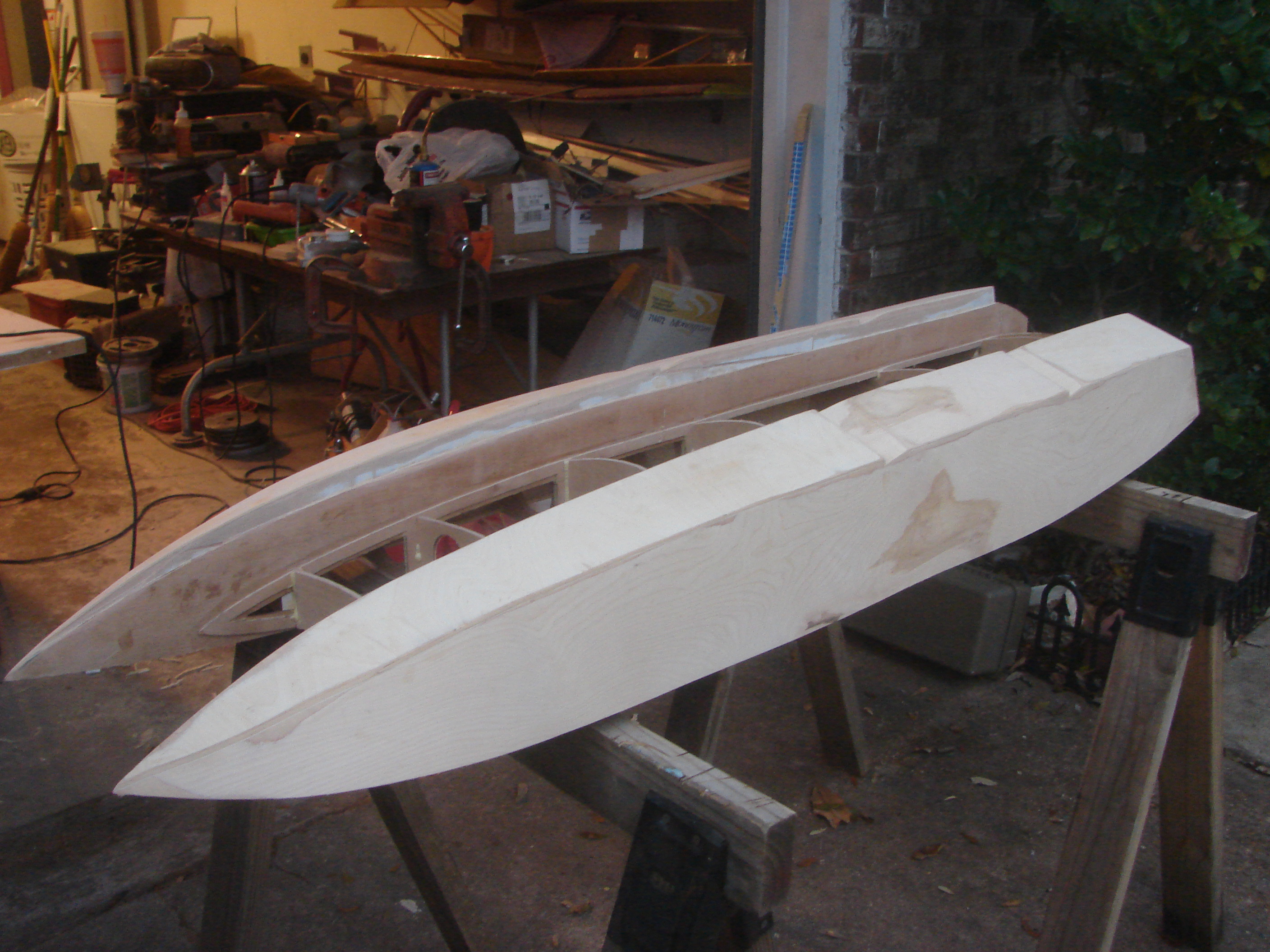

Gotta few more pics...
#13787

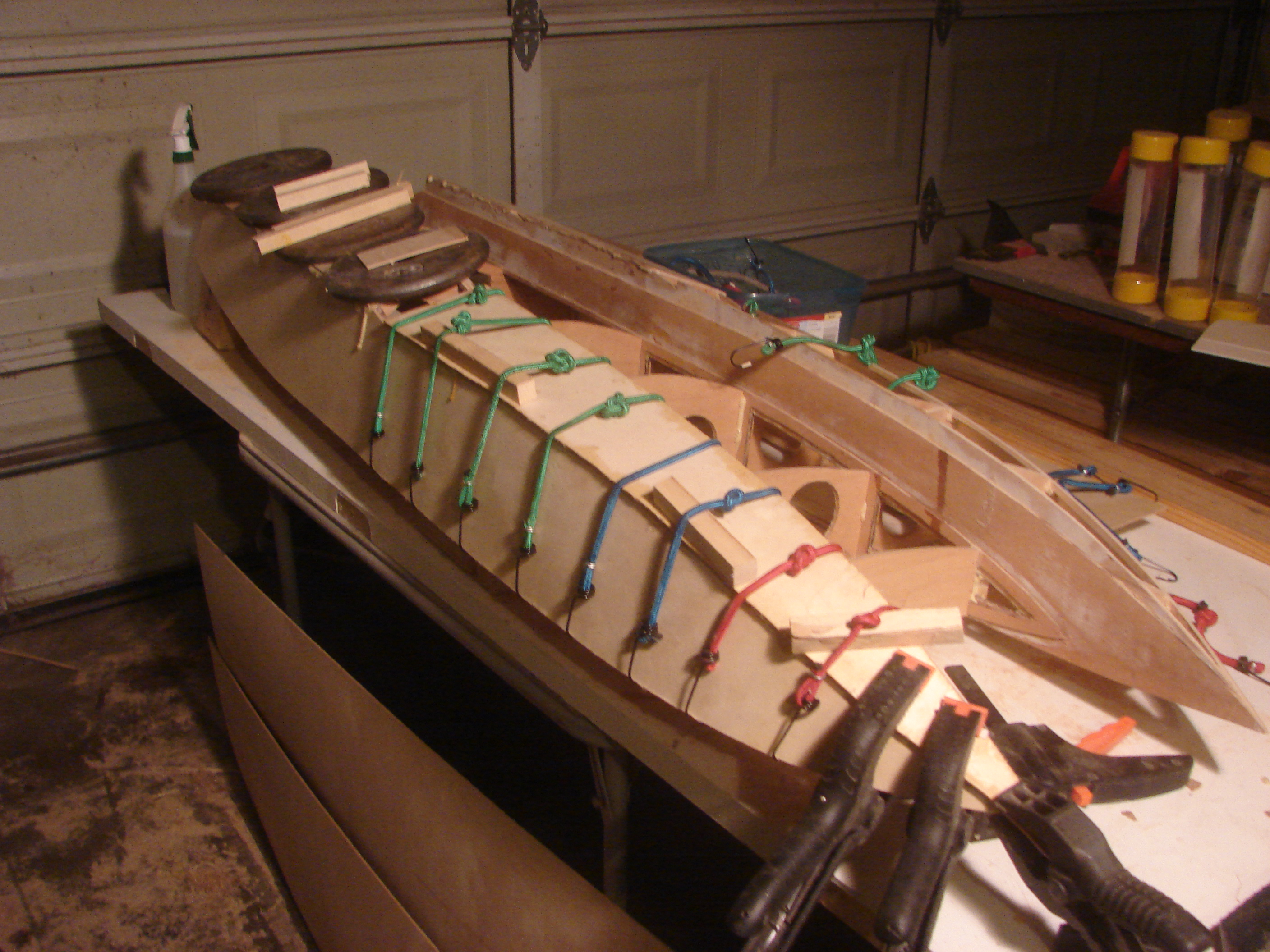

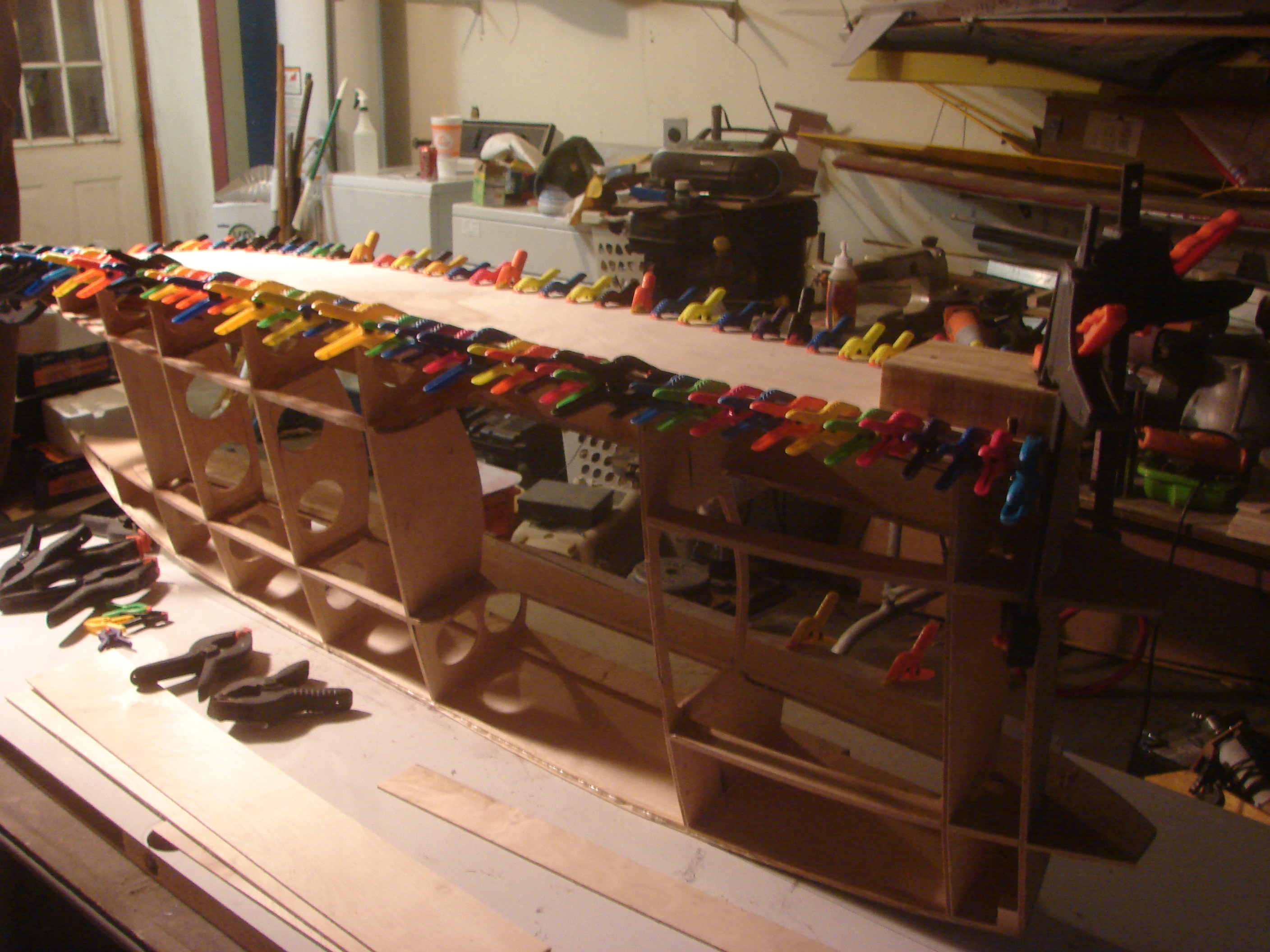

another
#13788

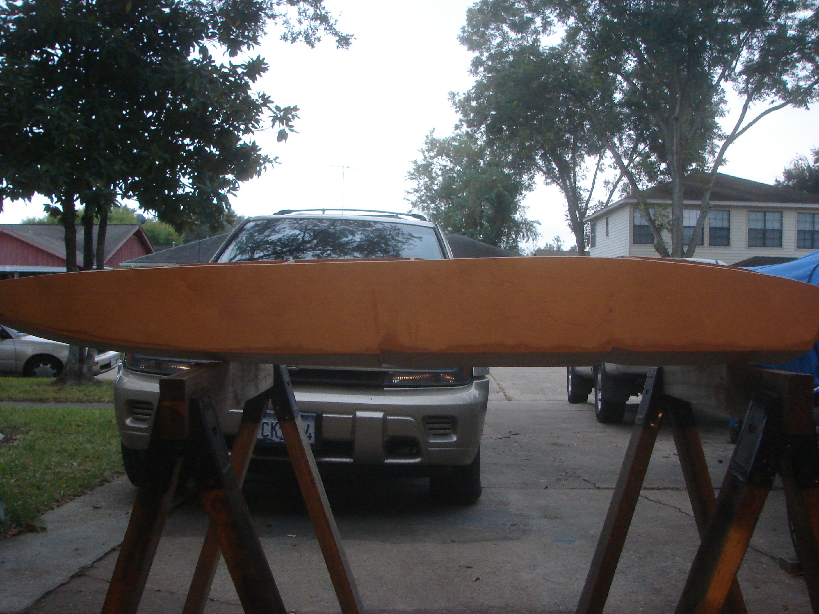

Getting really close!!!! B) B) B)
#13789

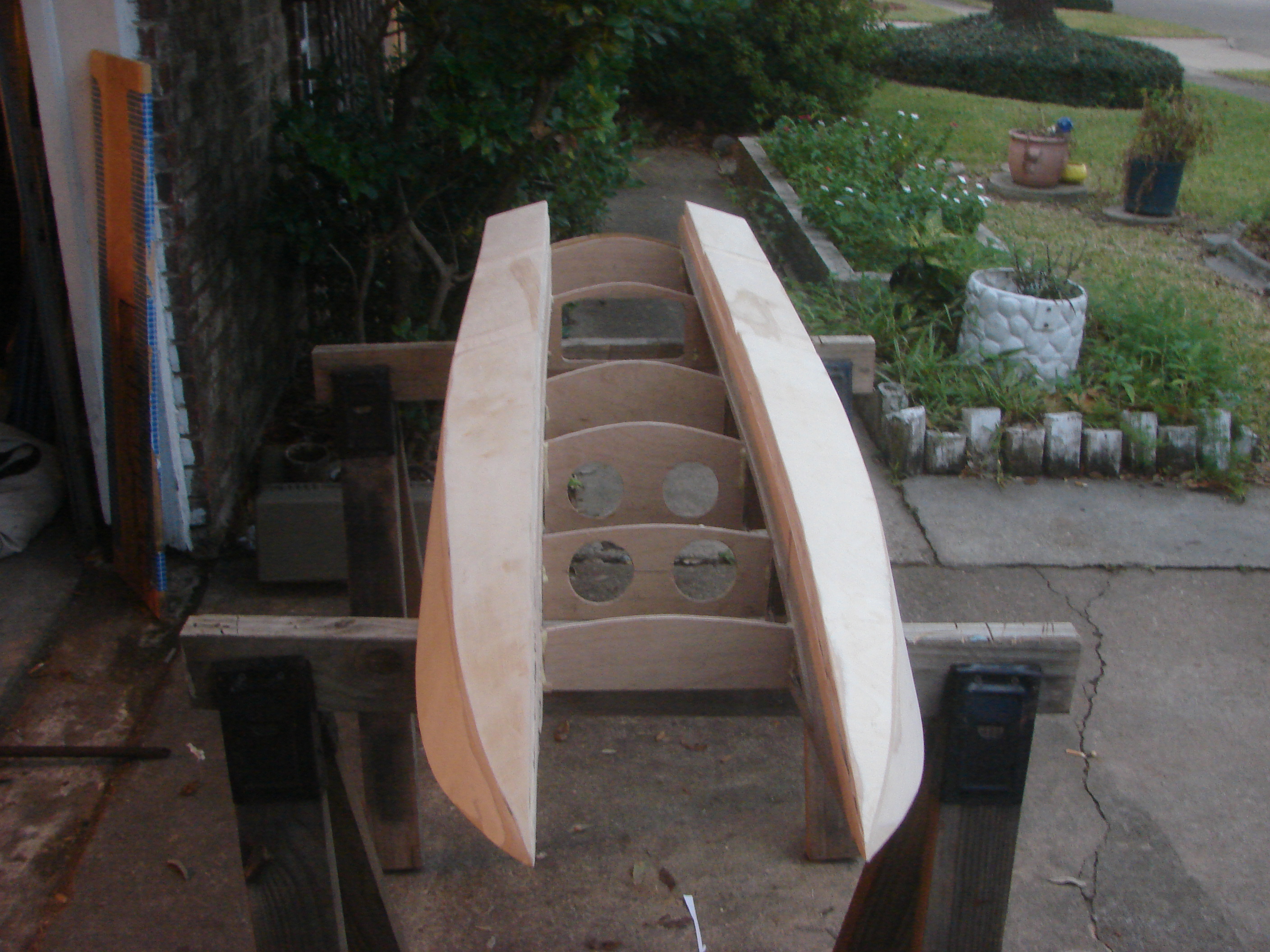

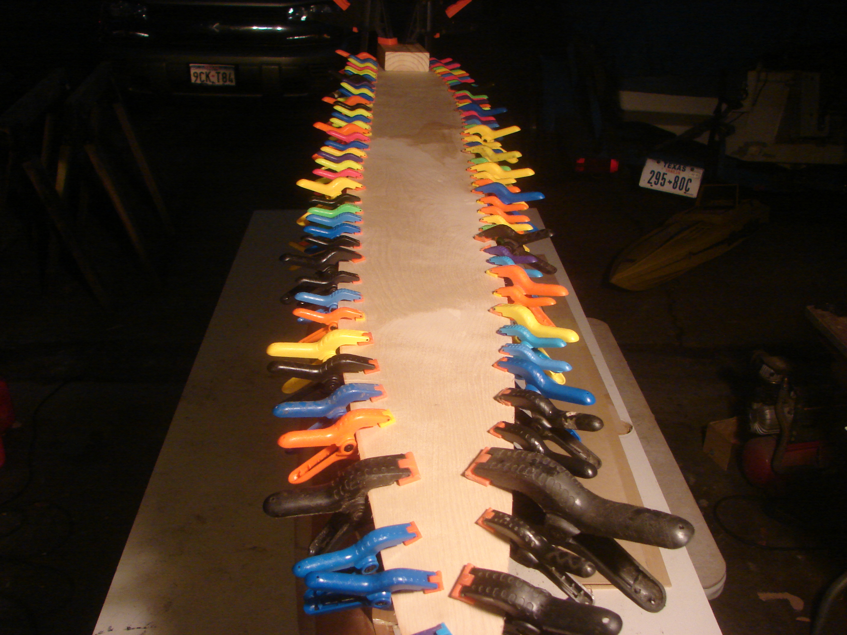

Let's try these~~ B)
#13790

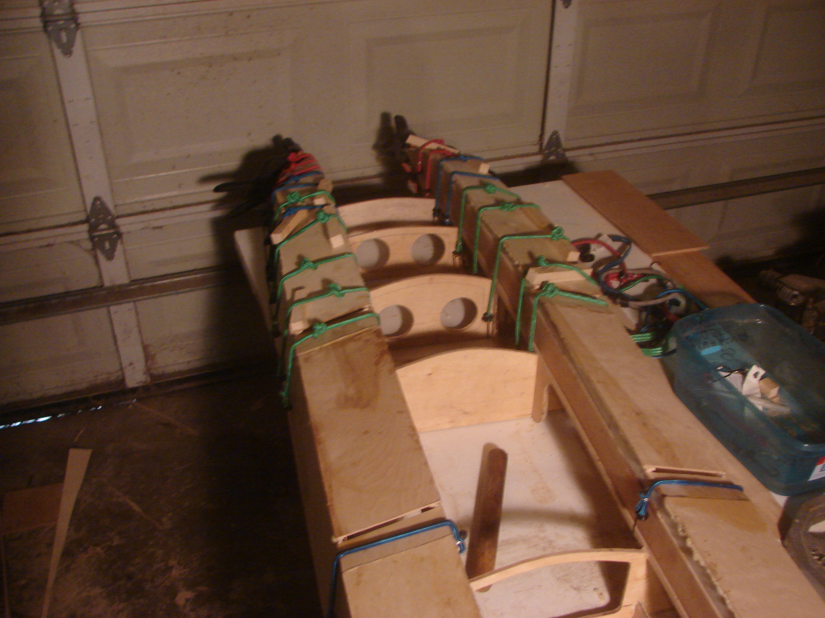

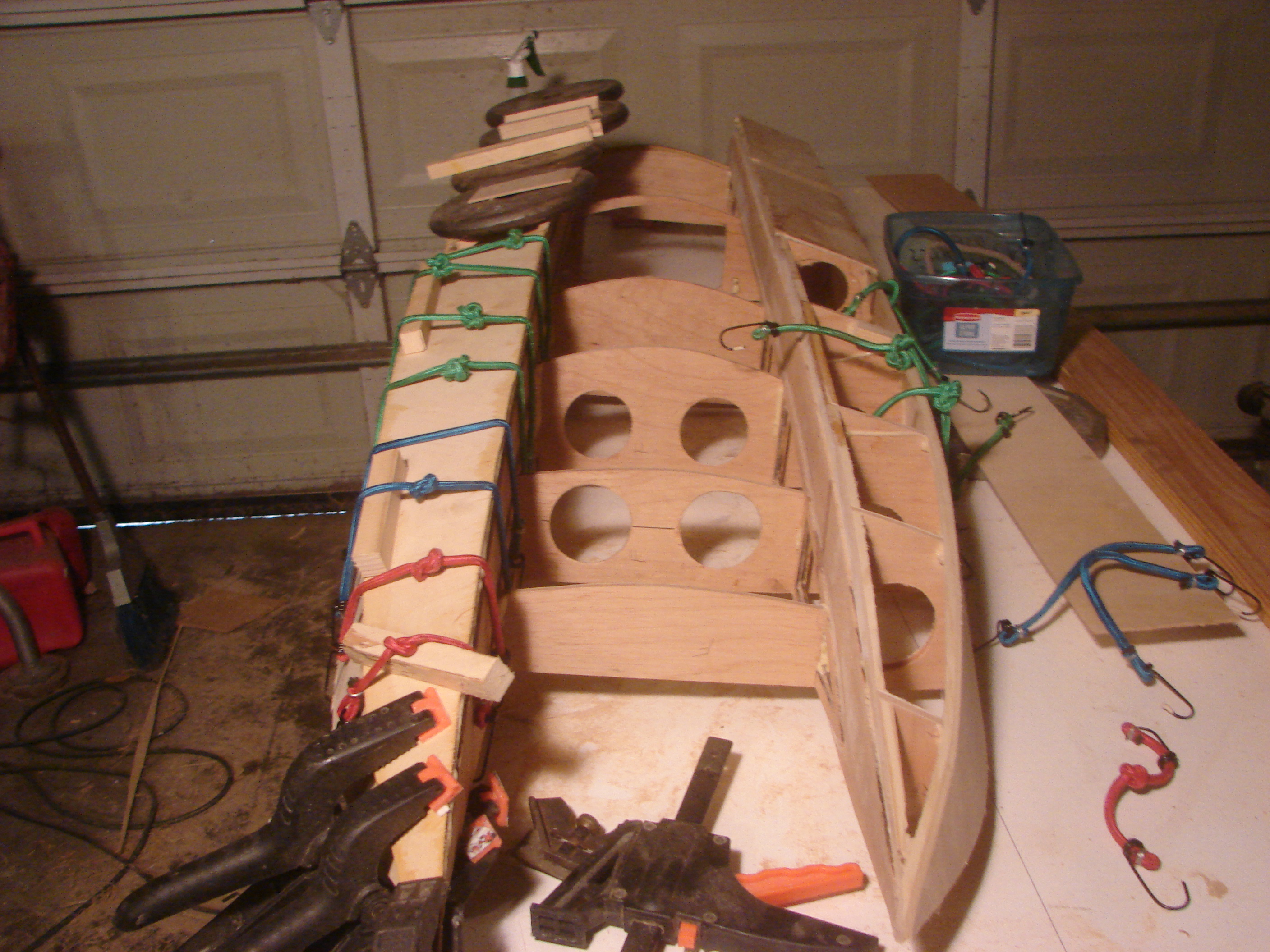

Last 2 for now....
#13791

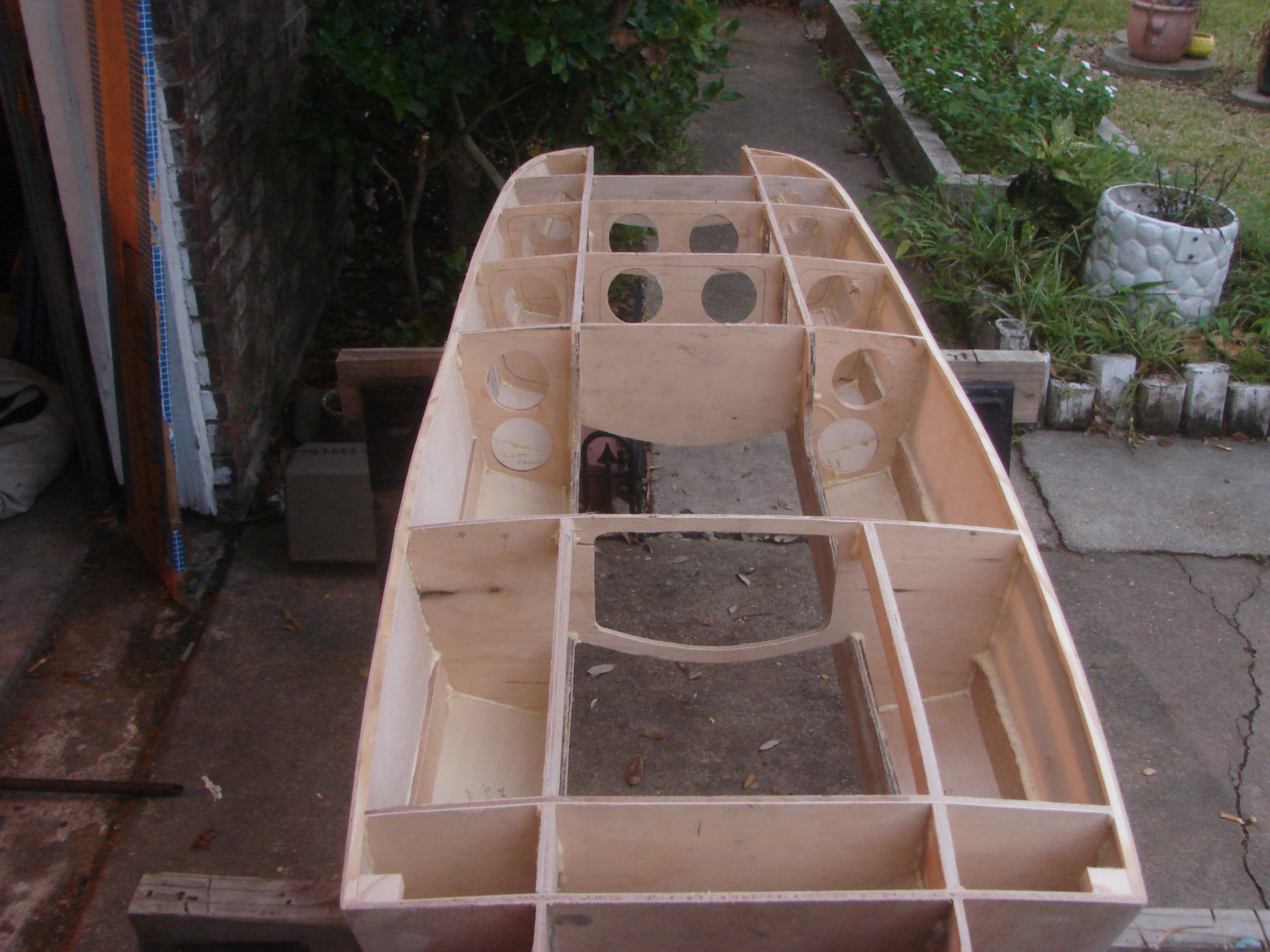

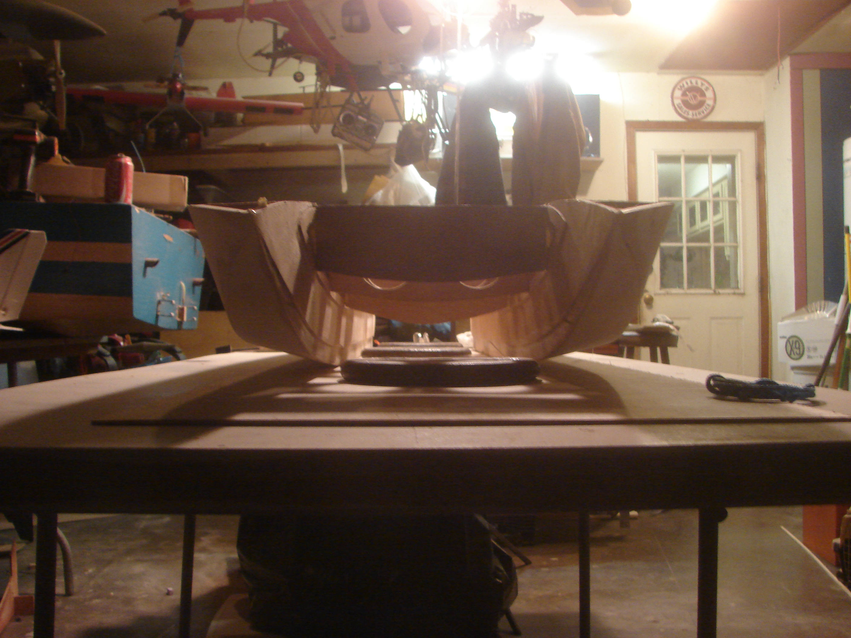

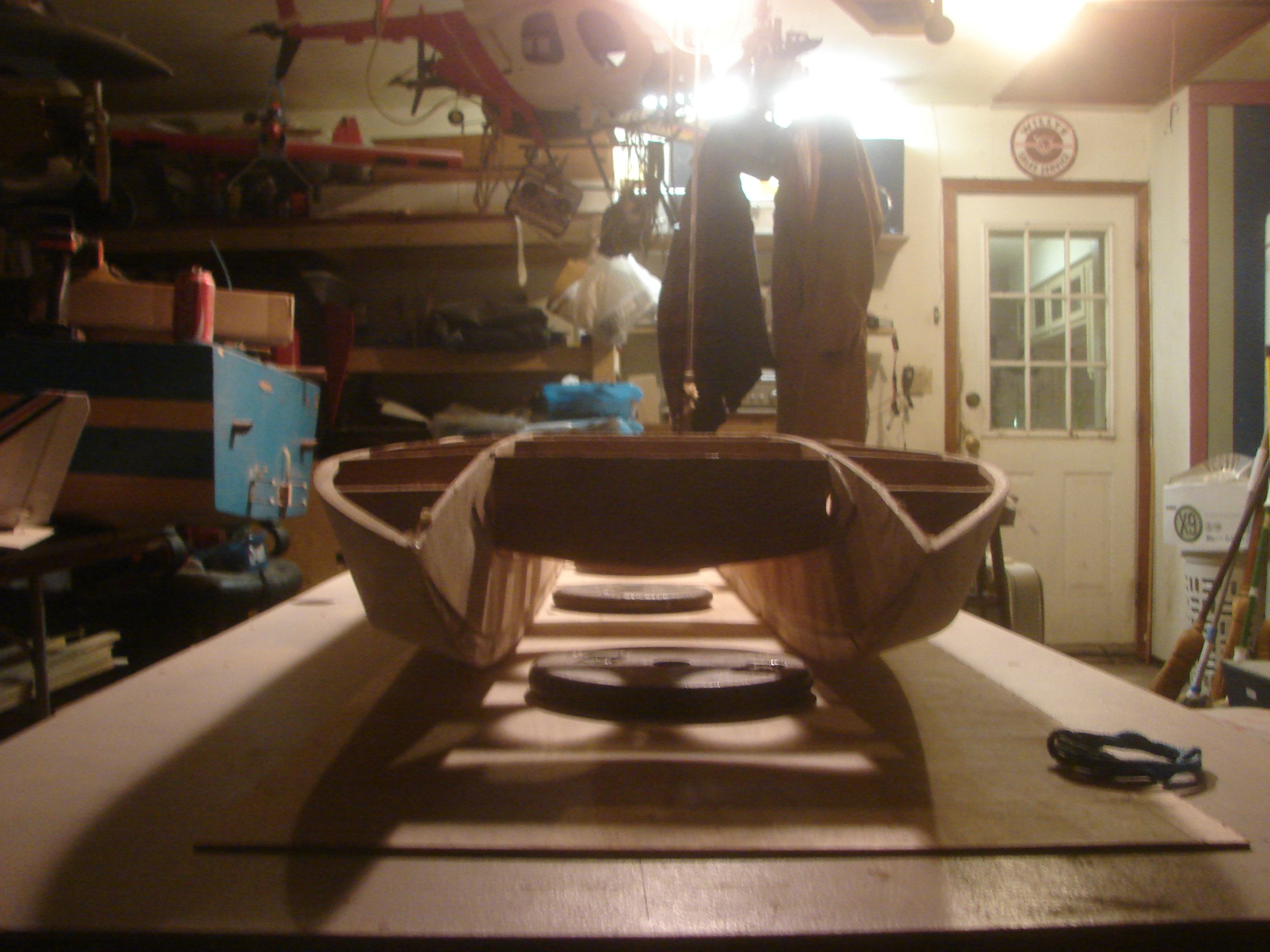

Hey Woodie... Does that last pic look like your looking down into the belly of the Beast? Just don't go gettin' scared on me :woohoo: :woohoo:

Woodie replied the topic: Re: Killer Kat (Tech question added????)
Hi Isuzu.
Thanks for the great pics. I just love good woodwork, and yours look really fine!
(I see that I have to get myself together to follow you in the build). :dry:
Scared? No, no! I never tell when I'm scared. :laugh:
