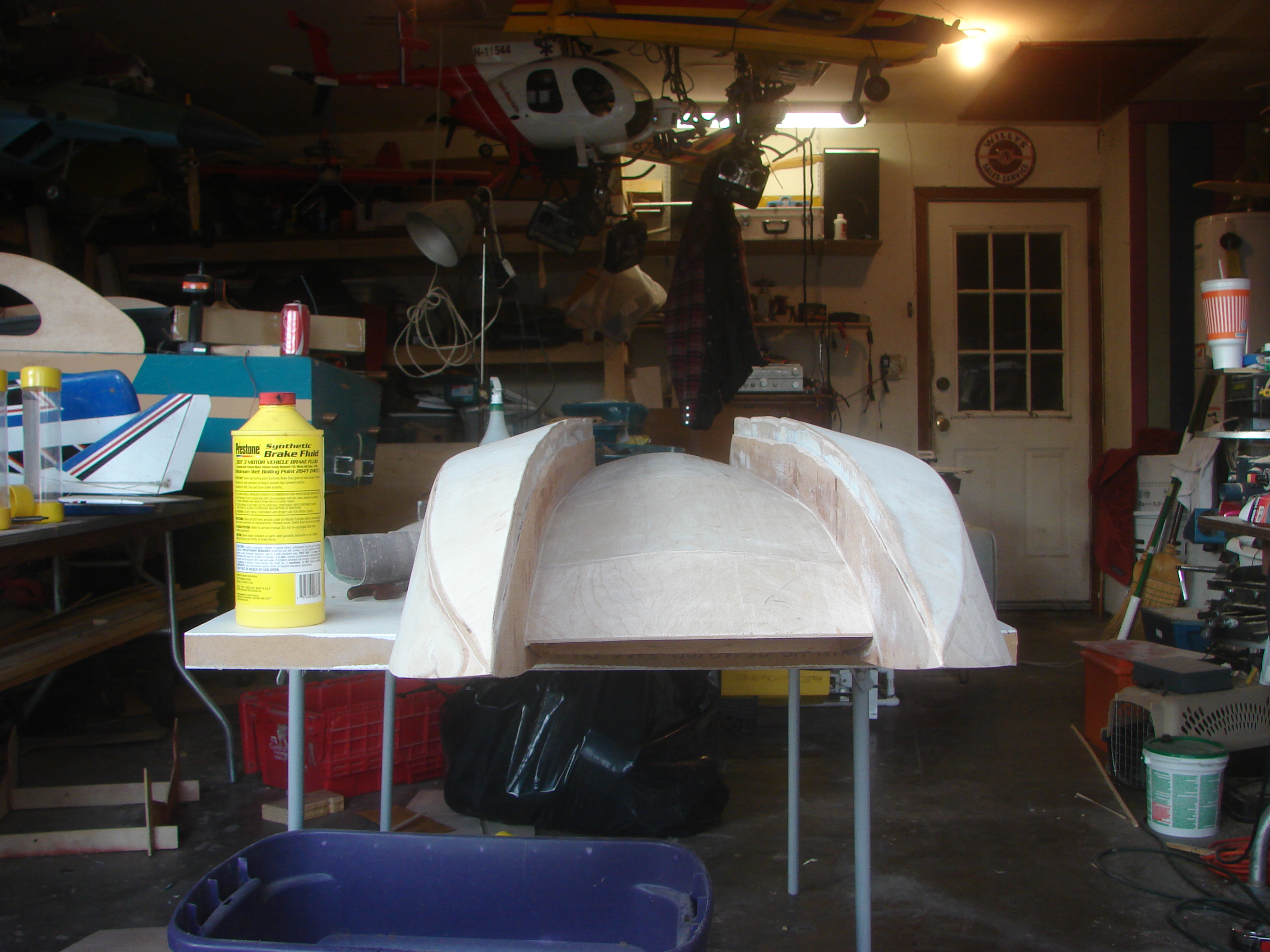

A few more pics....
#13885
Ozpulse replied the topic: Re: Killer Kat (Build Pics Updated)
Wow! :woohoo:
That really is coming along mate!
Gonna be a nice big boat when finished! B)
