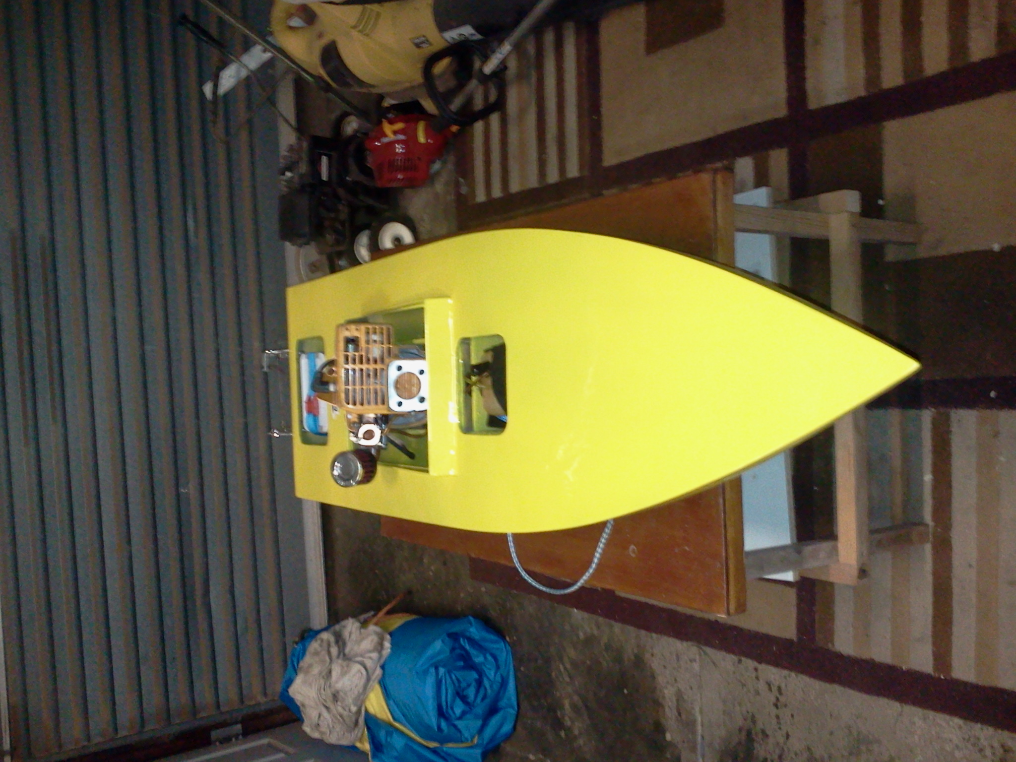

my el cheepo weedy mono
dwr9 replied the topic: Re: my el cheepo weedy mono
The boat looks real nice, congratulations. Yes, you will reduce the air cooling by removing the shroud. Doug
#16007
Woodie replied the topic: Re: my el cheepo weedy mono
Hey! That looks like one evil bastard of a mono! :laugh:
Seems you got the floatation just right, and the rest looks really fine too: Nice colour an good finish! This one is miles ahead of your old but charming Turkish Shoe! :laugh:
No, really: I can't wait to se the final result in a vid showing the boat in its right element. Just keep it up - never sinking! :woohoo:
#16010
baskarz replied the topic: Re: my el cheepo weedy mono
Well its all ready for its maiden voyage. Radio gear all trimmed and ready. I even added a kill switch activated by the 3rd channel seeing as I have no clutch this time round so I can kill it as it cruises towards the bank. The first pic shows how I rigged it up using a spare micro servo and micro switch.
I came up with a way to secure the radio box and fuel tank by using nylon cargo straps which I slotted under the trays for the tank and box. Holds them very sturdy, no movement at all.
Started it up and gave everything a functional test, all good so far.
now I just need some nice calm weather... hopefully tommorow should be nice n calm. :-)
I even dug out my old navman GPS to use to check speeds with, stuck it in a ziplock bag to stop it getting moist and found a nice snug fit up front of the fuel tank.
Last thing I want to do is make up a hatch for the radio box and fuel tank compartment and it will be complete :-D
Ooo can't wait to run it now :-)
stay tuned for first run video ...
#16044
Yay!!
Got to take it out for its first run today.
Ran ok i thought for its very first voyage :cheer:
I chucked my old gps up front of the fuel tank in a couple of zip-lock bags to get an idea of speed. First run i got a max speed of 30kph! not bad i thought, but could tell it wasn't quite getting up on plane, so i adjusted the strut a couple of degrees or so (very technical methods used here ;) ) and chucked it out again and got a 32kph top speed :P
Will now be preparing the bigger 32cc mac to go in place of the 25cc mac in it now to hopefully squeeze a bit more speed out of it.
i stuck my old digital camera on the bow in a watertight box and captured some footage as well as wifey with the other digital cam taking shore footage :cheer:
first clip is onboard footage (makes it look like its going faster than it is hehe )
second clip is shore footage.
Any feedback on what you guys think of its run and recommendations would be appreciated :)
