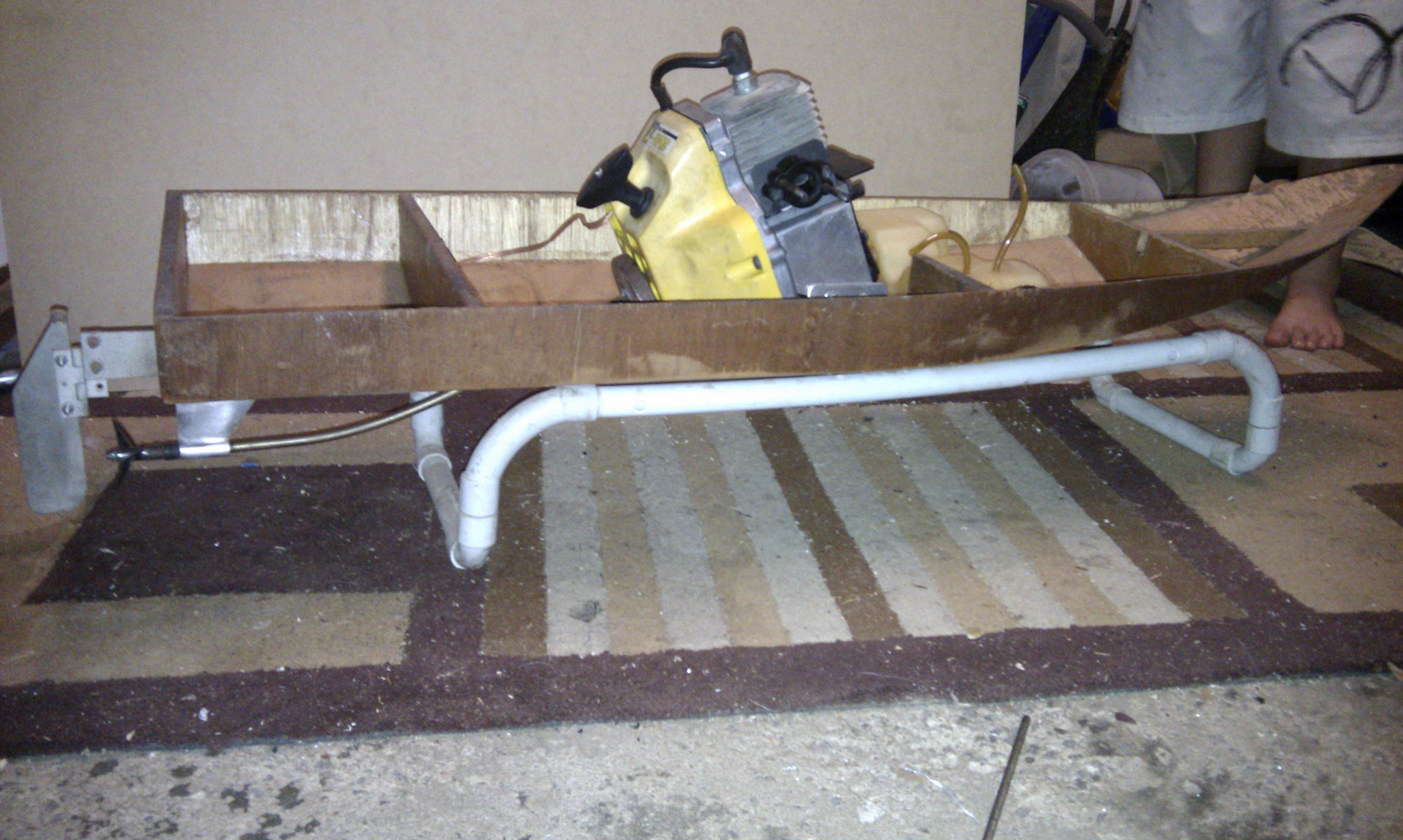

My McCulluch weed whacker was on its last legs, the shaft was wobbly and the whole trimmer head assembly would twist 90 odd degrees in any direction whenever it pleased... perfect excuse to buy a new one!
The beauty of the McCulluch tho, was that the engine ran perfectly, it has a clutch and i rediscovered my old hull...
i measured it up and compared to some gas boat plans i saw on the net and realised "damn, looks too small for a 32cc weedy motor... ah well, never mind, give it a shot anyways..."
it measured in at a mere 1 meter (39.39")long and 30cm (12") at its widest.
so i went about butchering the weedy motor and "bodging" it to mount in the hull...
well it fits! kinda dwarfs the hull but anyhoo..
all the running gear was from an old nitro boat i scored for 50 bux many years ago, its hull was ruined and motor had broken bigend... but rest was good haha.
I pressed on and slapped some dodgy aluminium brackets together to mount the motor.
after i made the brackets i realised i should have had some rubber
the mcculluch had a square drive for its shaft, i was able to modify and adapt the round shaft collet off the old nitro to suit the square drive.
you will notice the prop is a bit too small for this size motor but i wasnt worried as i have a larger suited prop on order and the smaller is just to get some testing done.
whipped up a quick dodgy deck and puttied it up with "Auto one, Metal plus" one of those 2 part body fillers containing glass fibers and metal "dust".

in this pic tho, i have a pipe on it, that pipe is (as i found out the hard way)is too small for this motor so was limiting my top end power and speed quite substantially.
i have since reverted back to the stock exhaust for now, which will do just fine until i want more speed!
i gave it a test run down my local beach and despite the limited power, it ran quite well. It was trying to plane, but the pipe held the motor back and wouldn't let it rev like i know it does, plus the prop is more suited to a .40 nitro not 32cc gas... hehe
