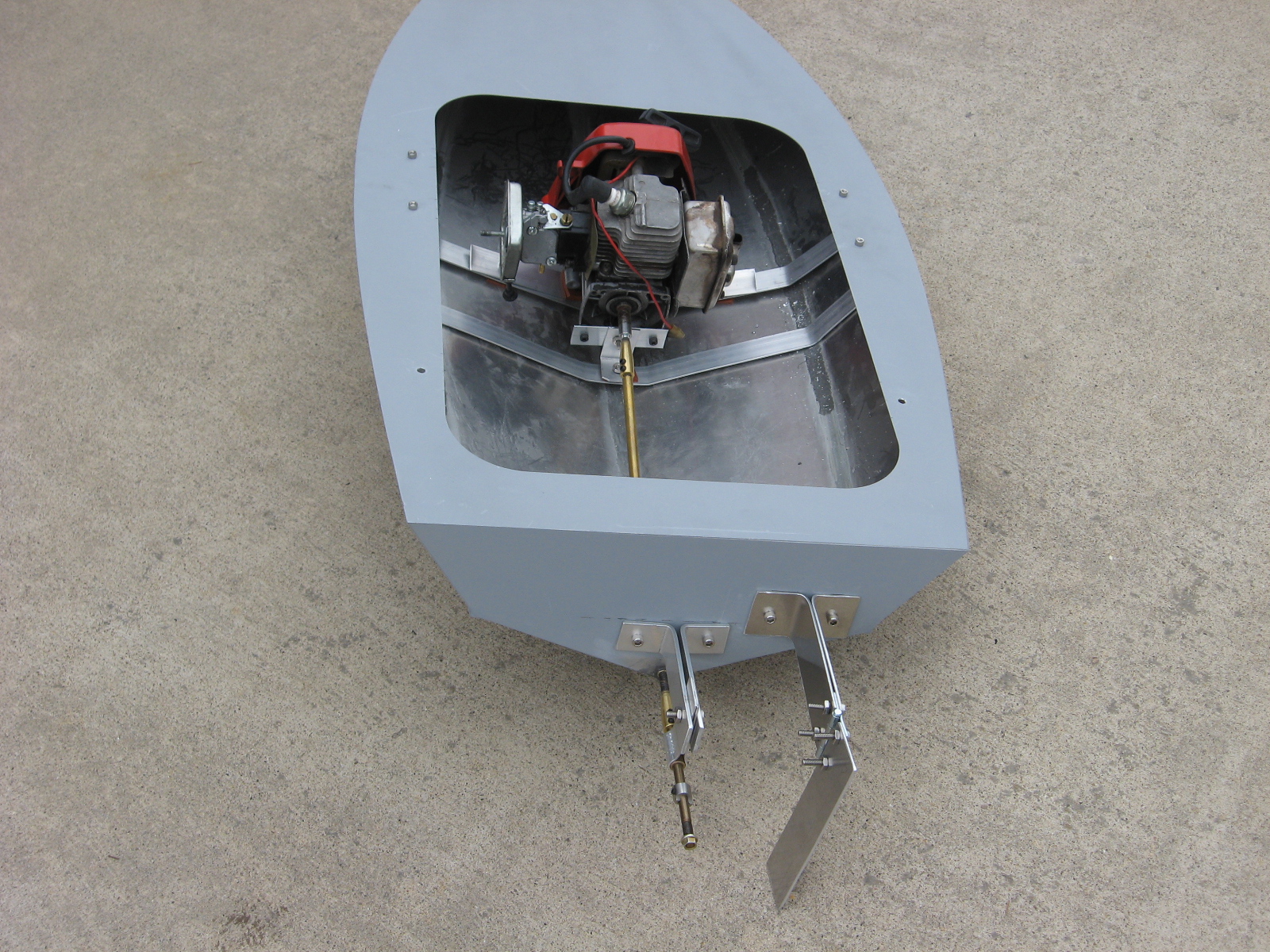

kartrobison replied the topic: Re: Weedeater engine help
the connection depends on if you have a clutch or not but usually you can find a way to connect it to the 1/4 cable if you go to www.zippkits.com they have a brass connector or ferrule that you can use sometimes to connect the cable to the motor
if you email me some pics of the motor I can look at the connection point and help
zippkits also has other good stuff that is way affordable to help you get started
here is a pic of my weedy motor I used some 1/16 thick aluminum strap from home depot or lowes to connect to any point on the motor then attach that to the hull

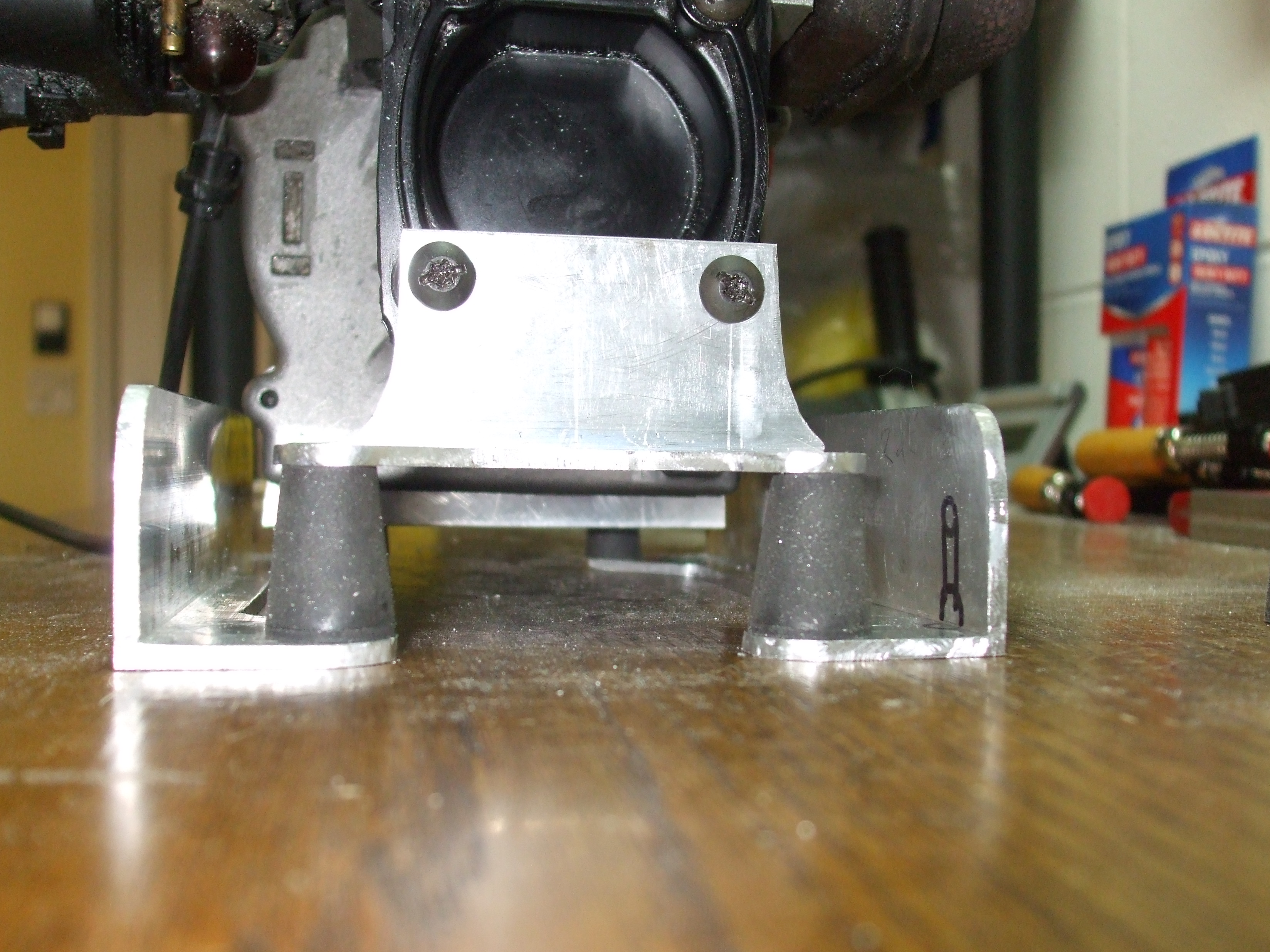

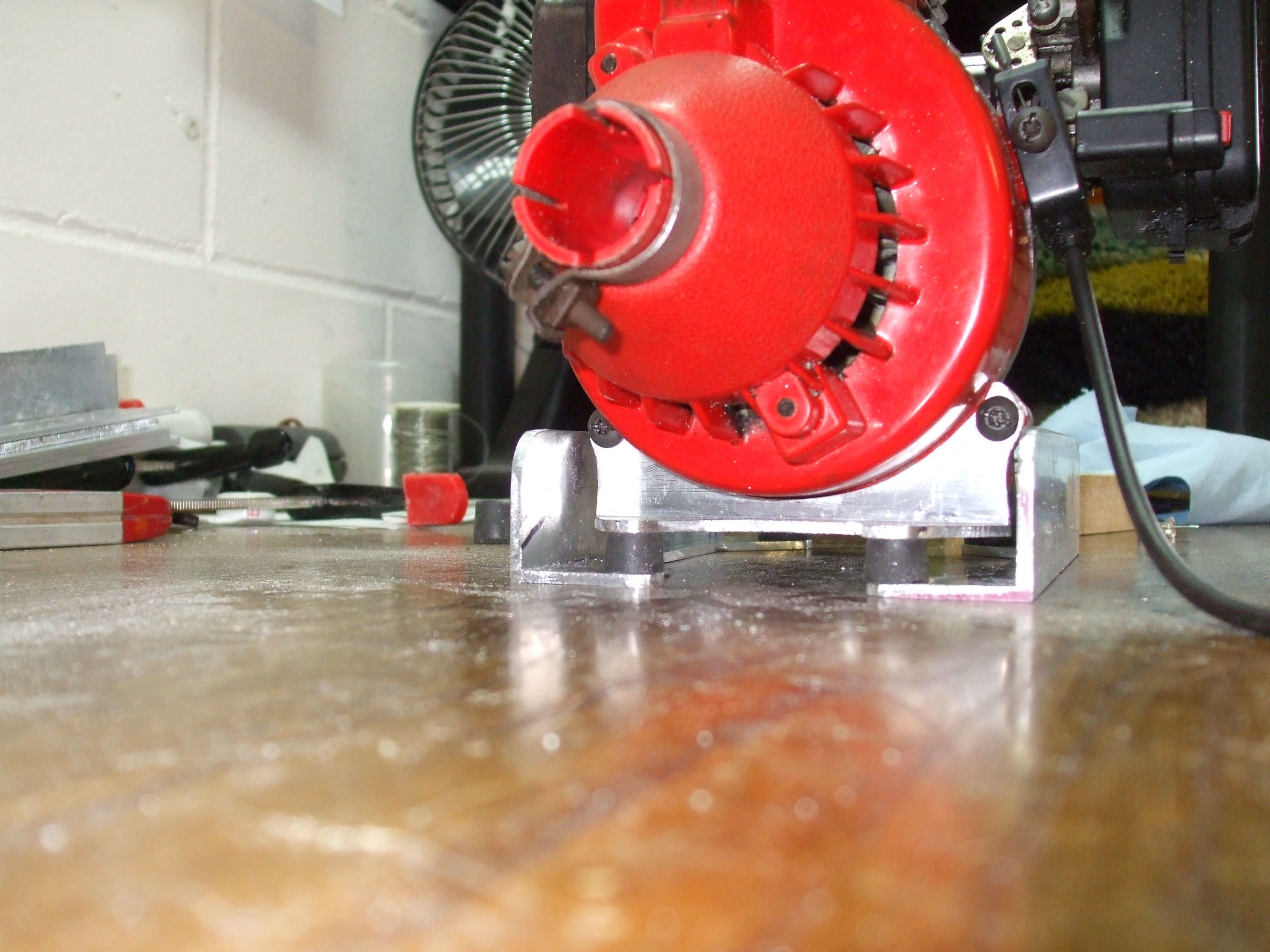

baskarz replied the topic: Re: Weedeater engine help
On the topic of engine mounting, are the rubber isolation bushes a necessity? I'm in the process of fabricating brackets for my weedy motor to mount inthe 5" rails of the 48"deep vee, I can source them if I HAVE to but would be easier not having to worry about them.
#15451
jhzman replied the topic: Re: Weedeater engine help
In a word the vibrations will slowly open up the holes drilled to mount the engine. It may also cause structural damage. Put in the rubber mounts, it is worth the money and not having the headache after finishing your boat.
#15454
Ozpulse replied the topic: Re: Weedeater engine help
Not to mention the havoc that the vibrations can cause to your radio gear! :blink:
Most bearing shops should stock a range of isolation mounts, if all else fails you can source them from wrecked cars. Plenty of rubber mounts in the engine bays holding stuff in
#15460
Heh yeah thought about that, so I went off to me local auto wreckers and grabbed 4 Holden commodore airbox mounts. They worked out perfect for me as they are only 10mm thick and I finished off the engine brackets to fit the Mac between the 5" rails :-)
#15468
They work great! I remember posting somewhere about them when I first started using them.
Just dont try to buy them new, I was quoted $26 each :blink:
At the local auto stores. The wreckers let me grab them free off the cars they are going to crush. ;)
