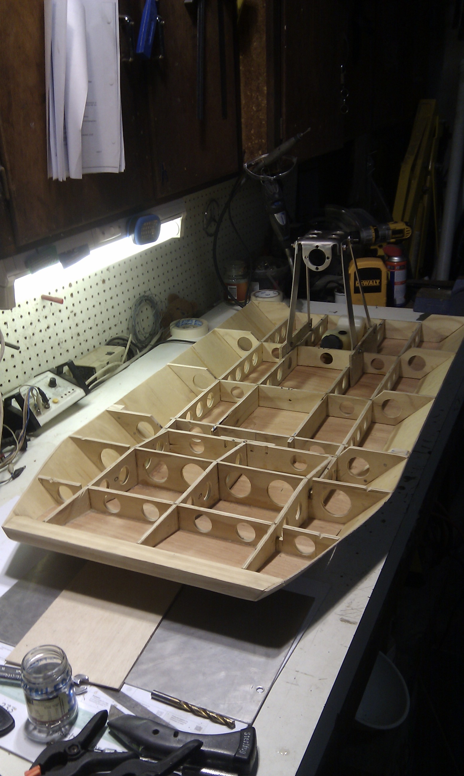

baskarz replied the topic: Re: flat bottom gas airboat build!
The dog does a good job by letting me know if someone is near the front gate :P

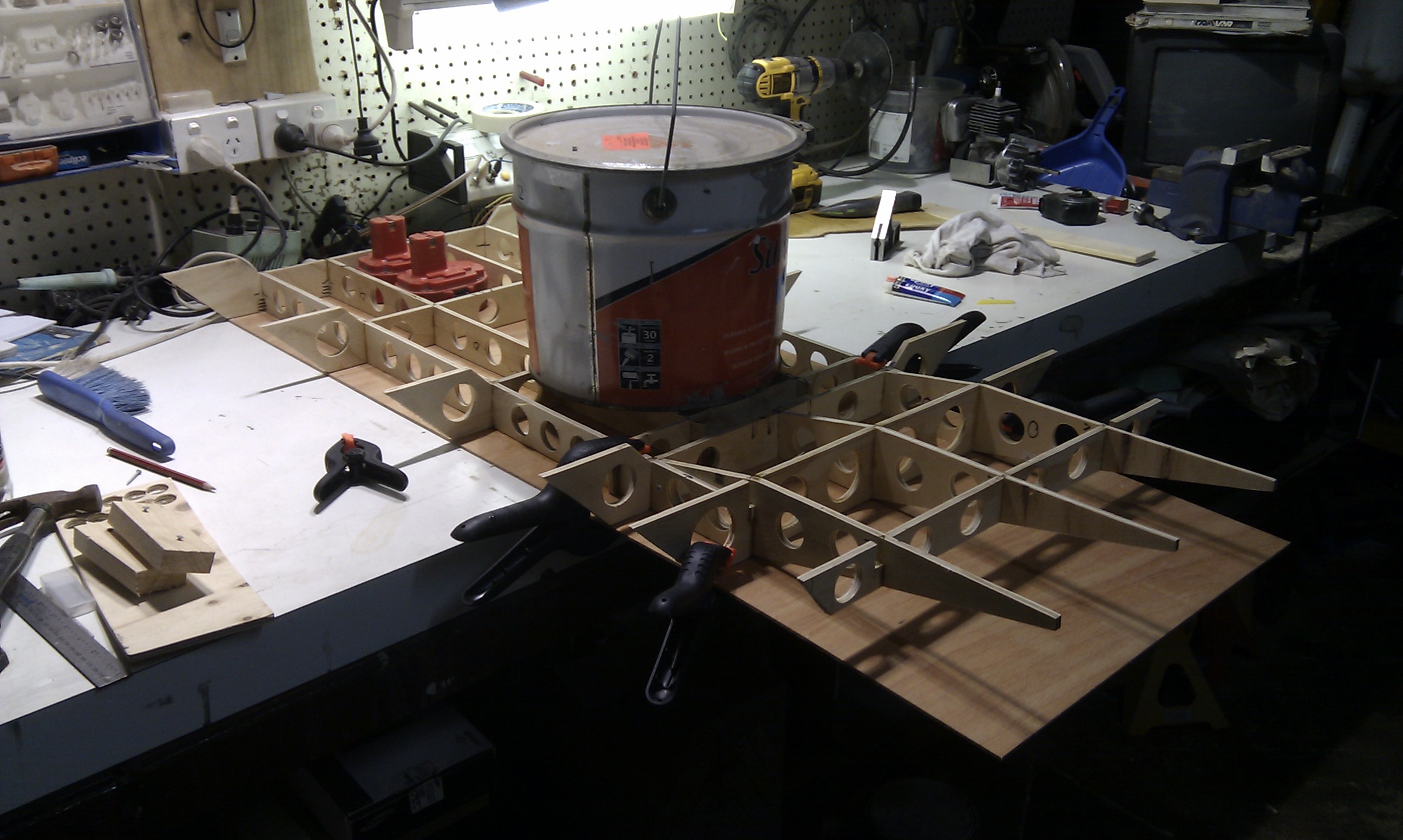

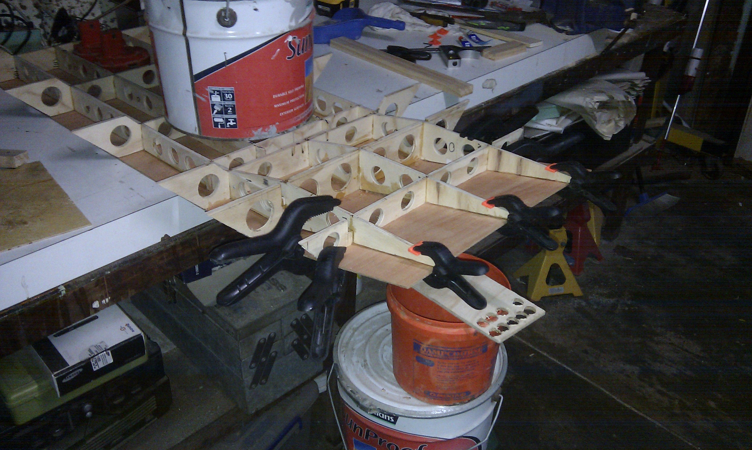

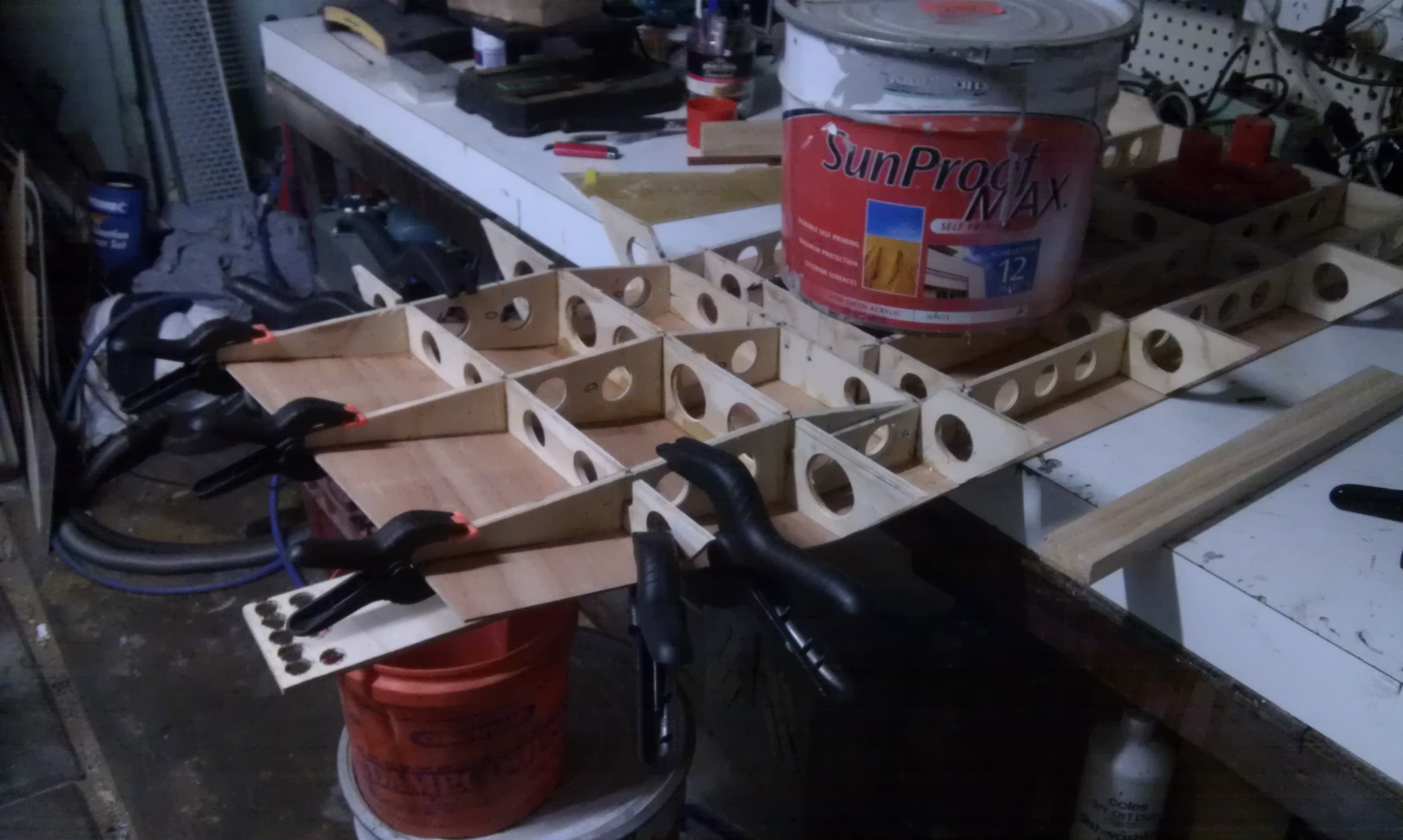

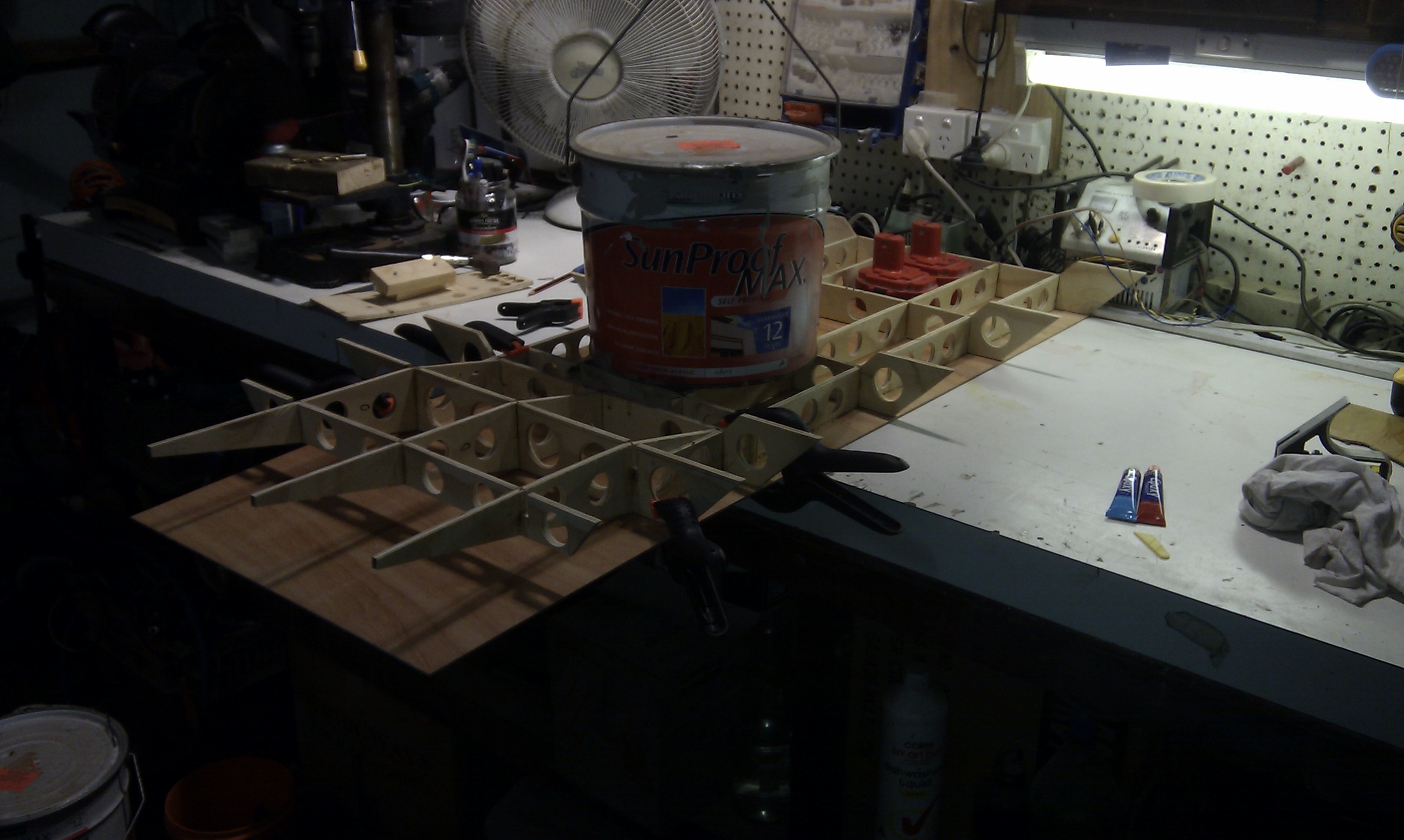

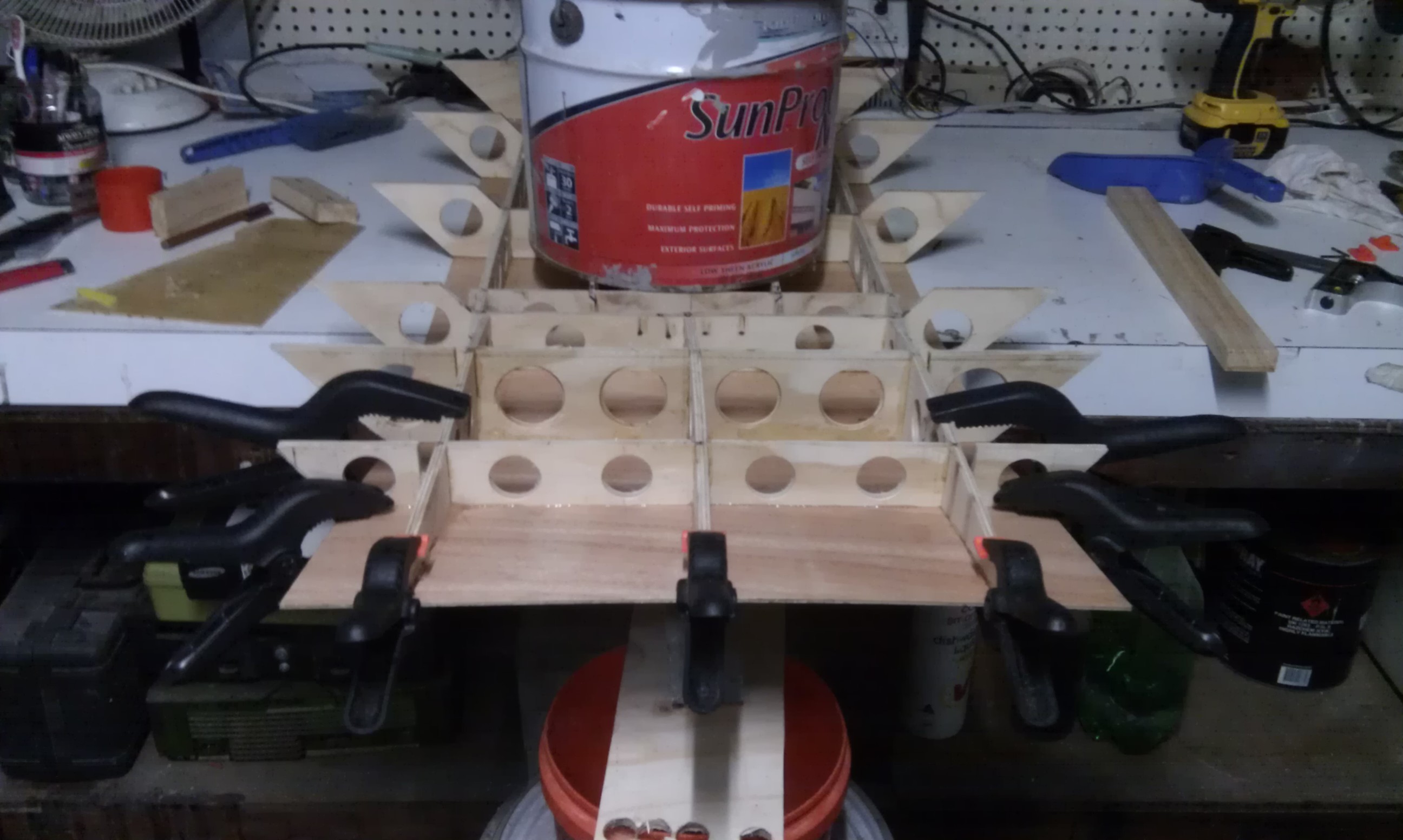

went and picked up some more luan ply to start skinning the frame. Got the flat bottom done today and the frame all epoxied together and square ;)
Im on holidays at the moment so should have most of the hull finished by the end of the week, hopefully engine mounts and rudders too :cheer:

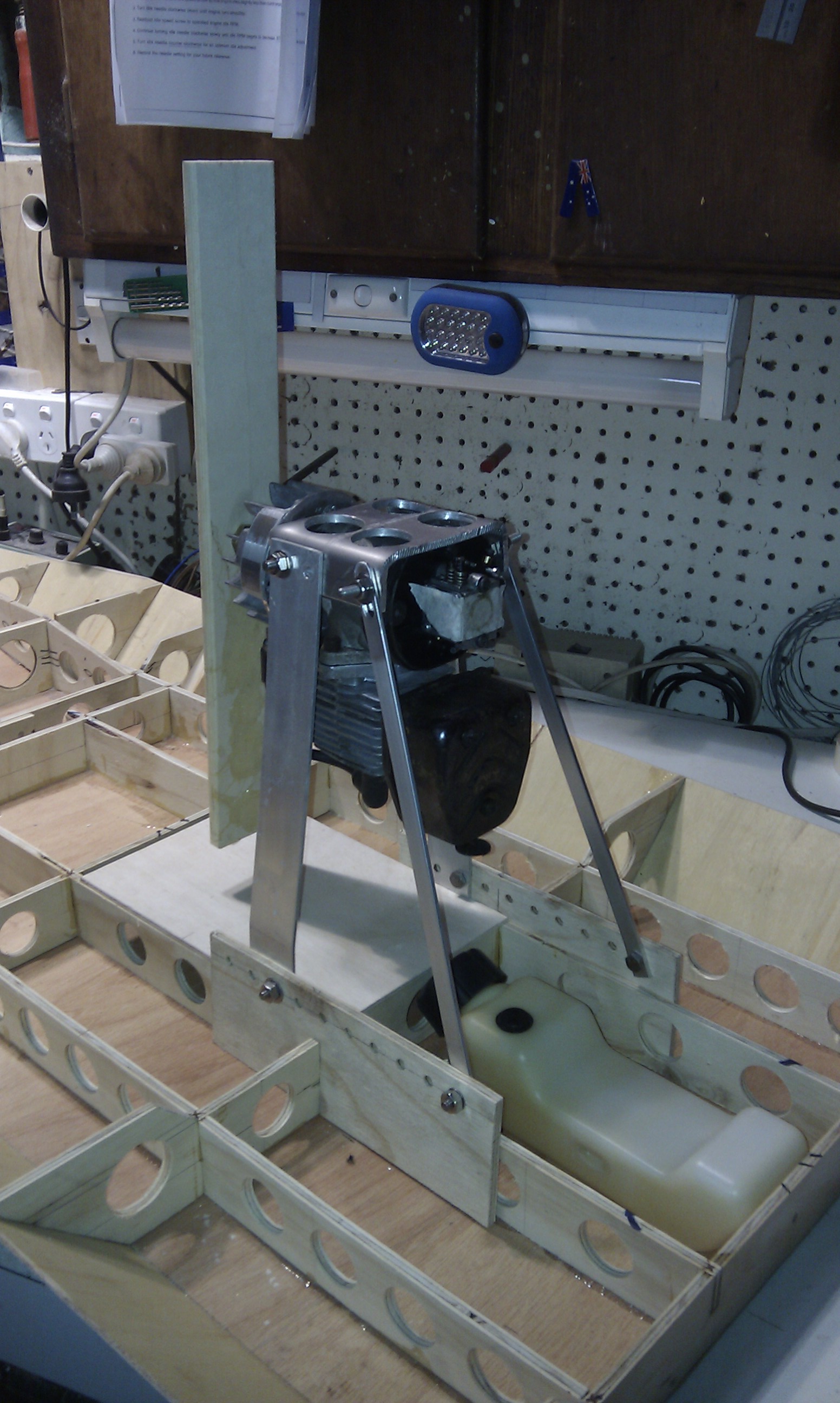

Bit more progress.

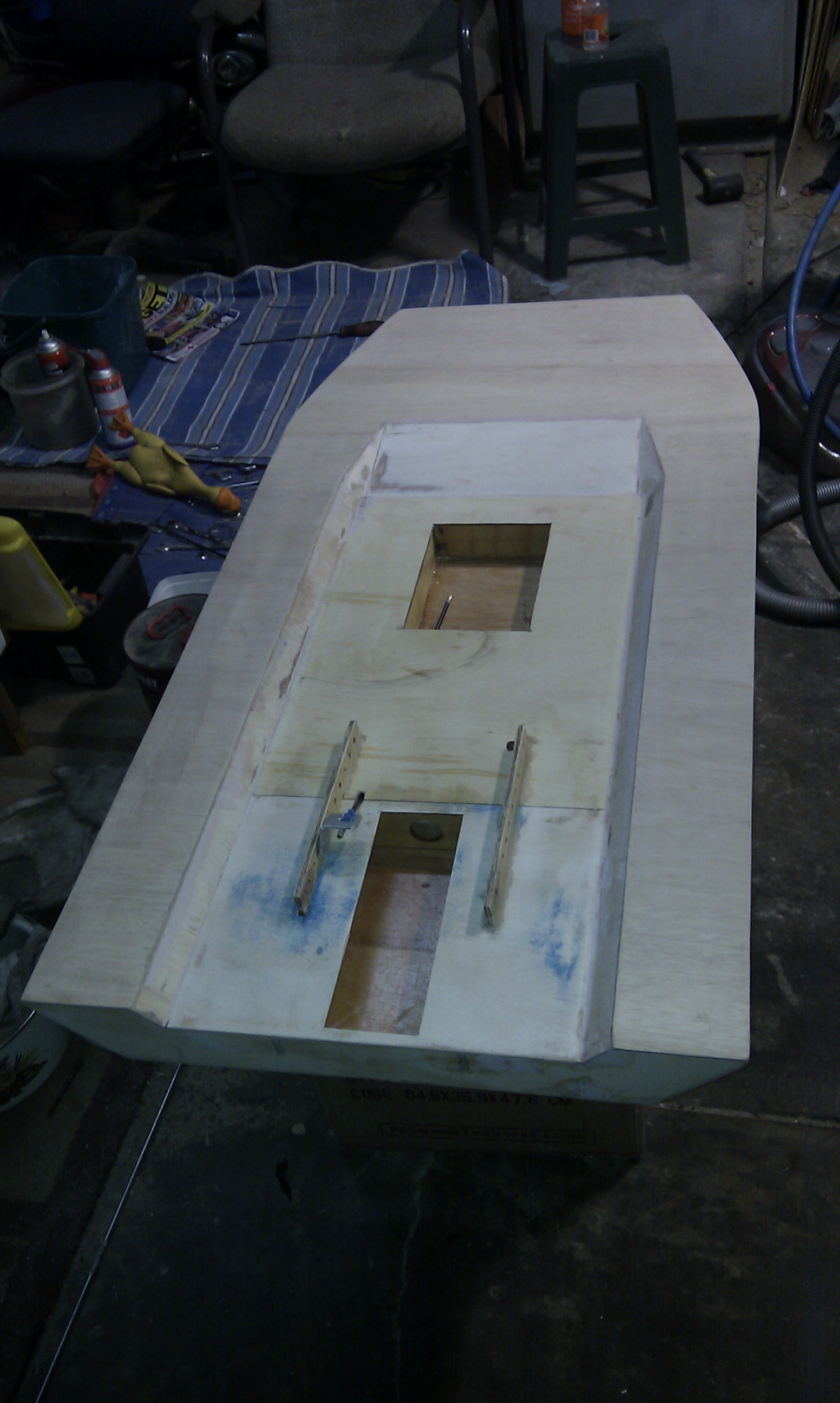

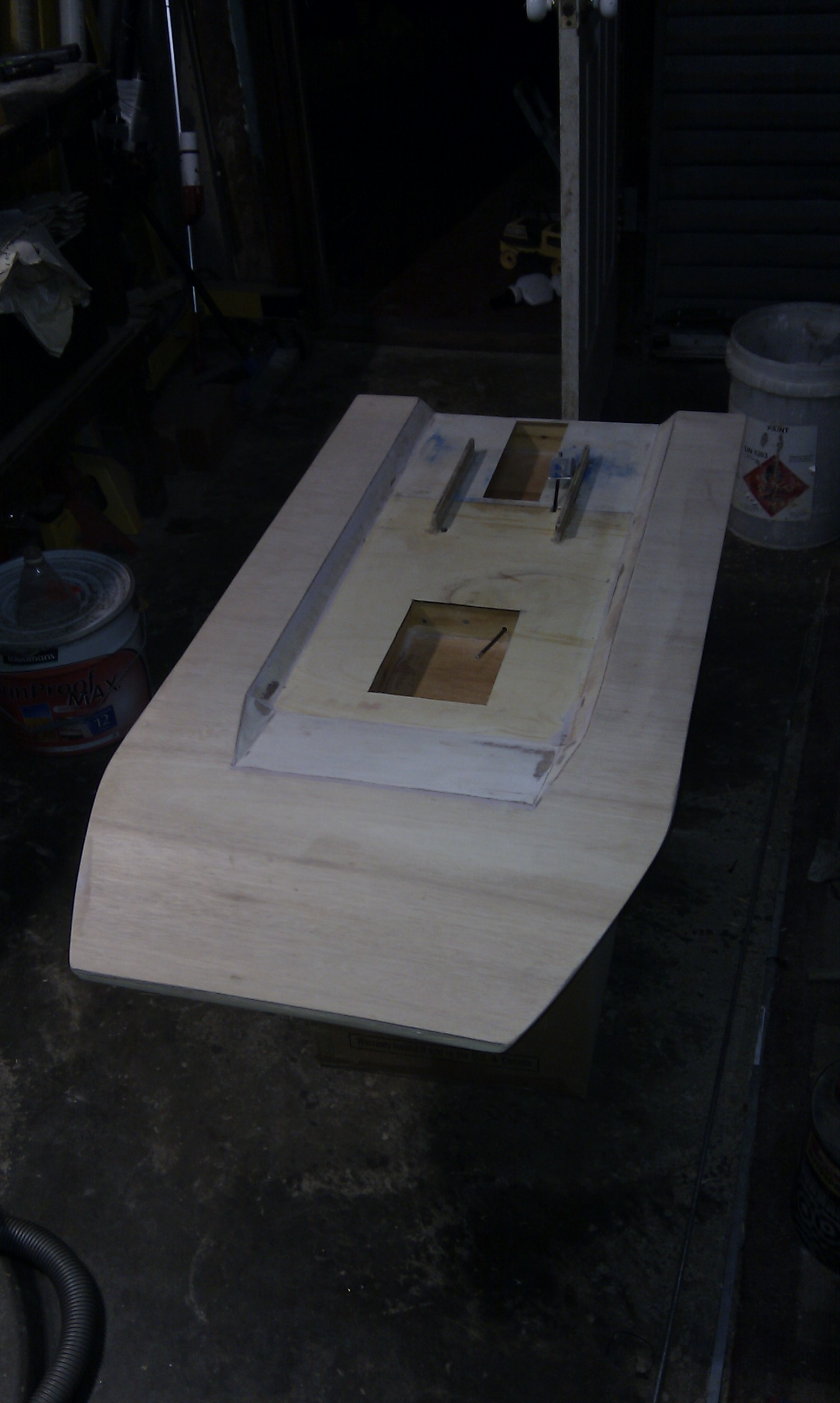

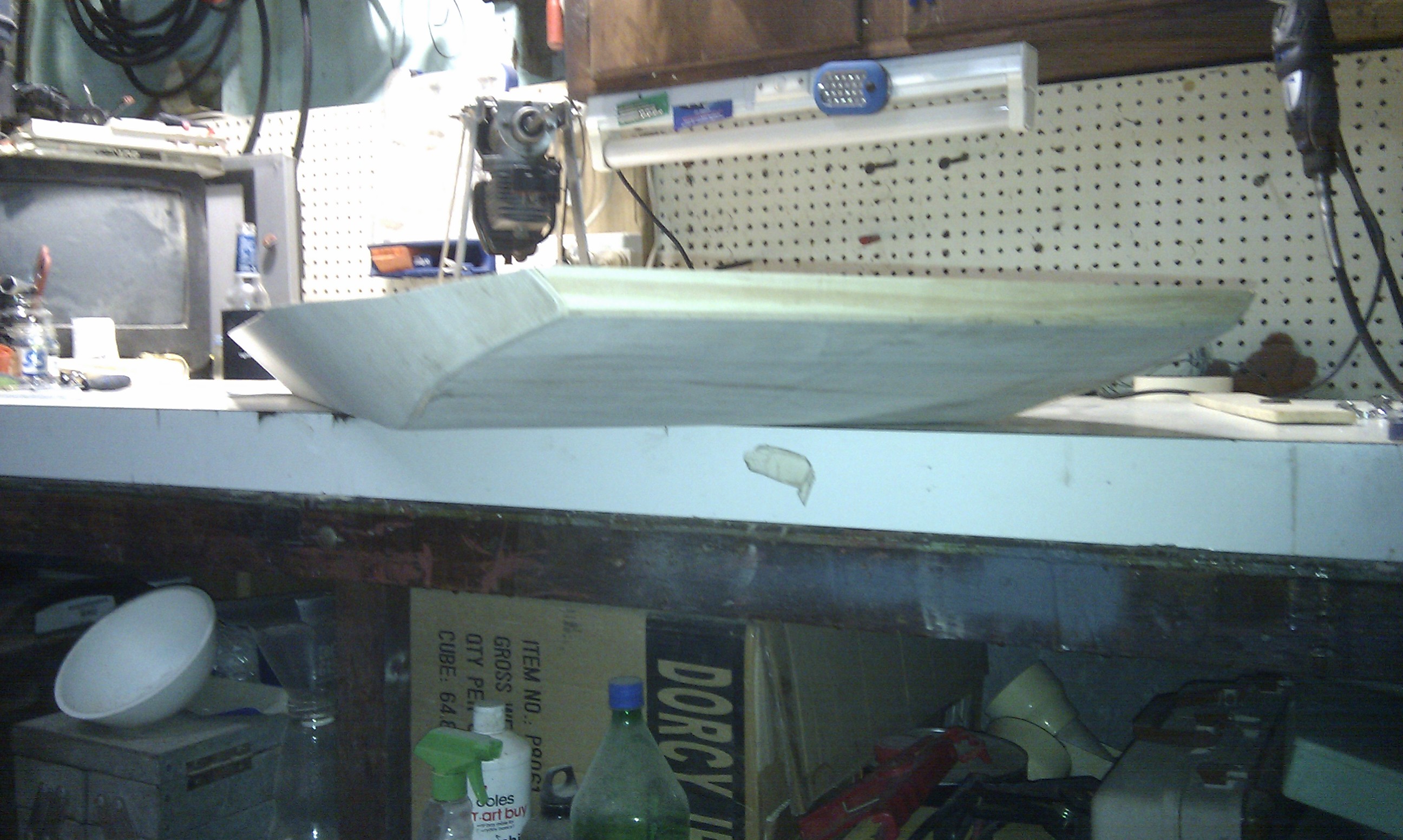

Finished skinning the bottom and sides of the hull. I added in a solid timber peice across the nose to give it a bit of strength in the event i run into something. :P
coupla little gaps where got a little too happy with the sander :S all good tho, i'll fill in the gaps with bodyfiller :)

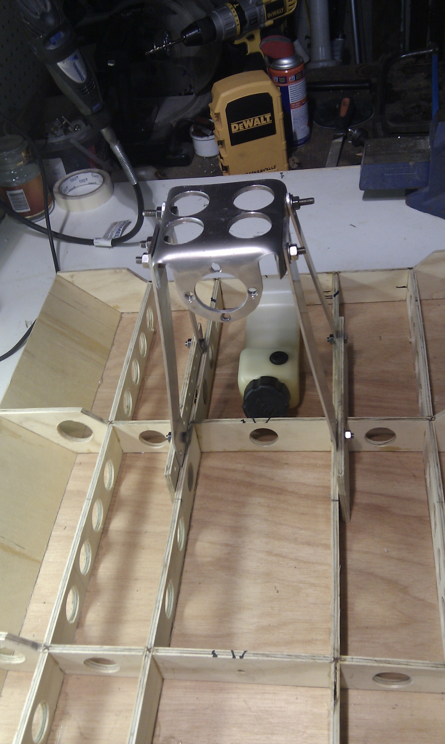

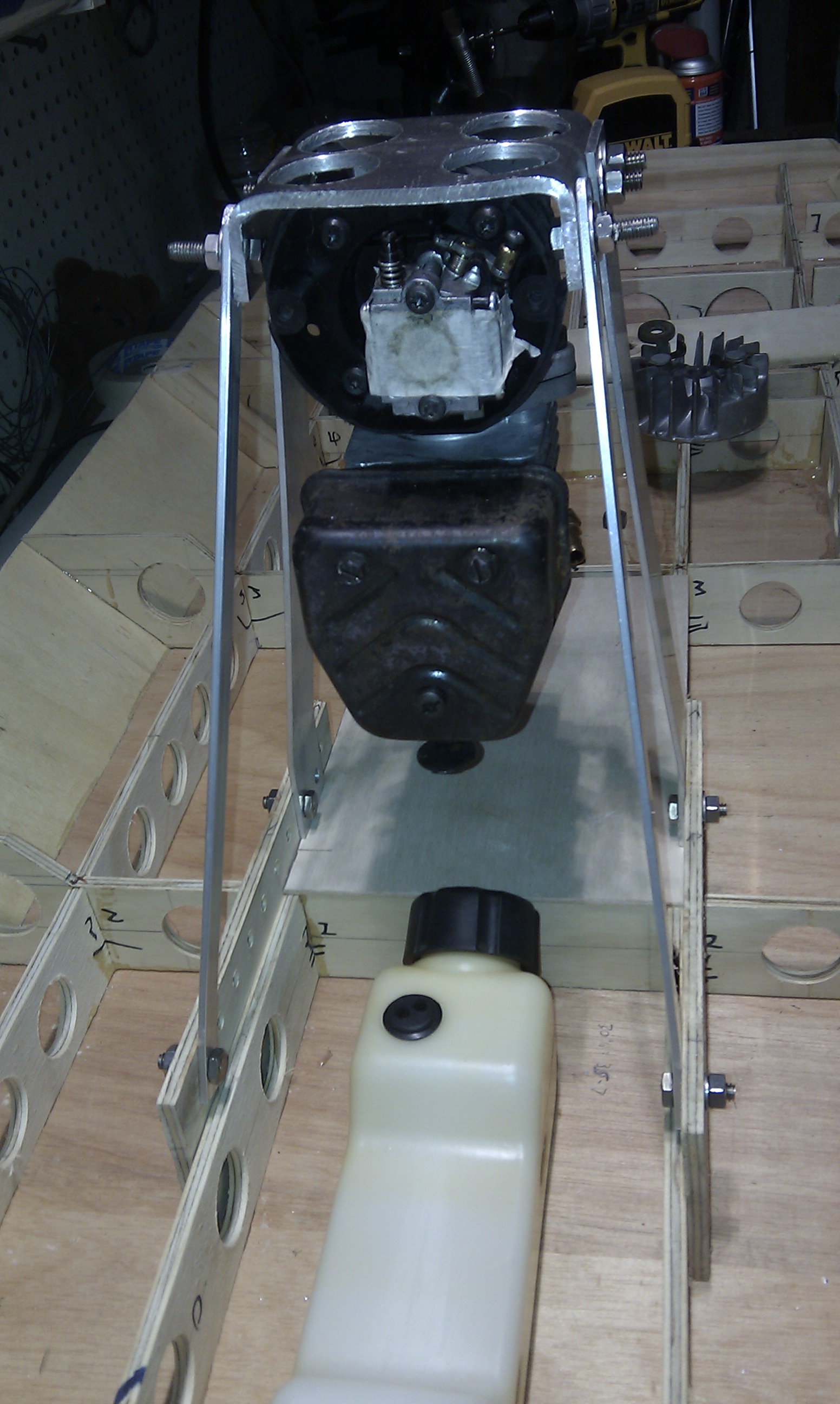

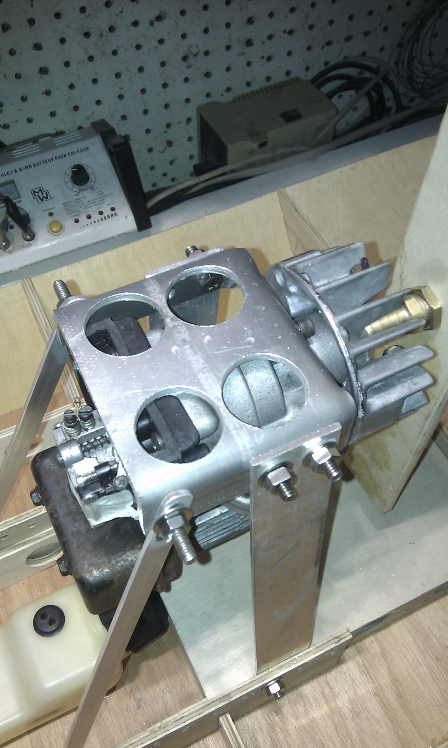

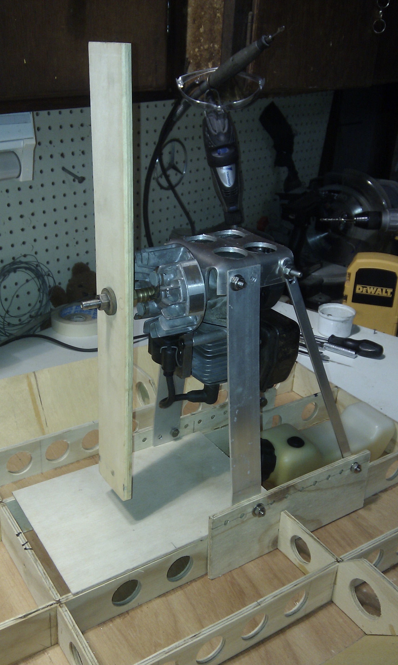

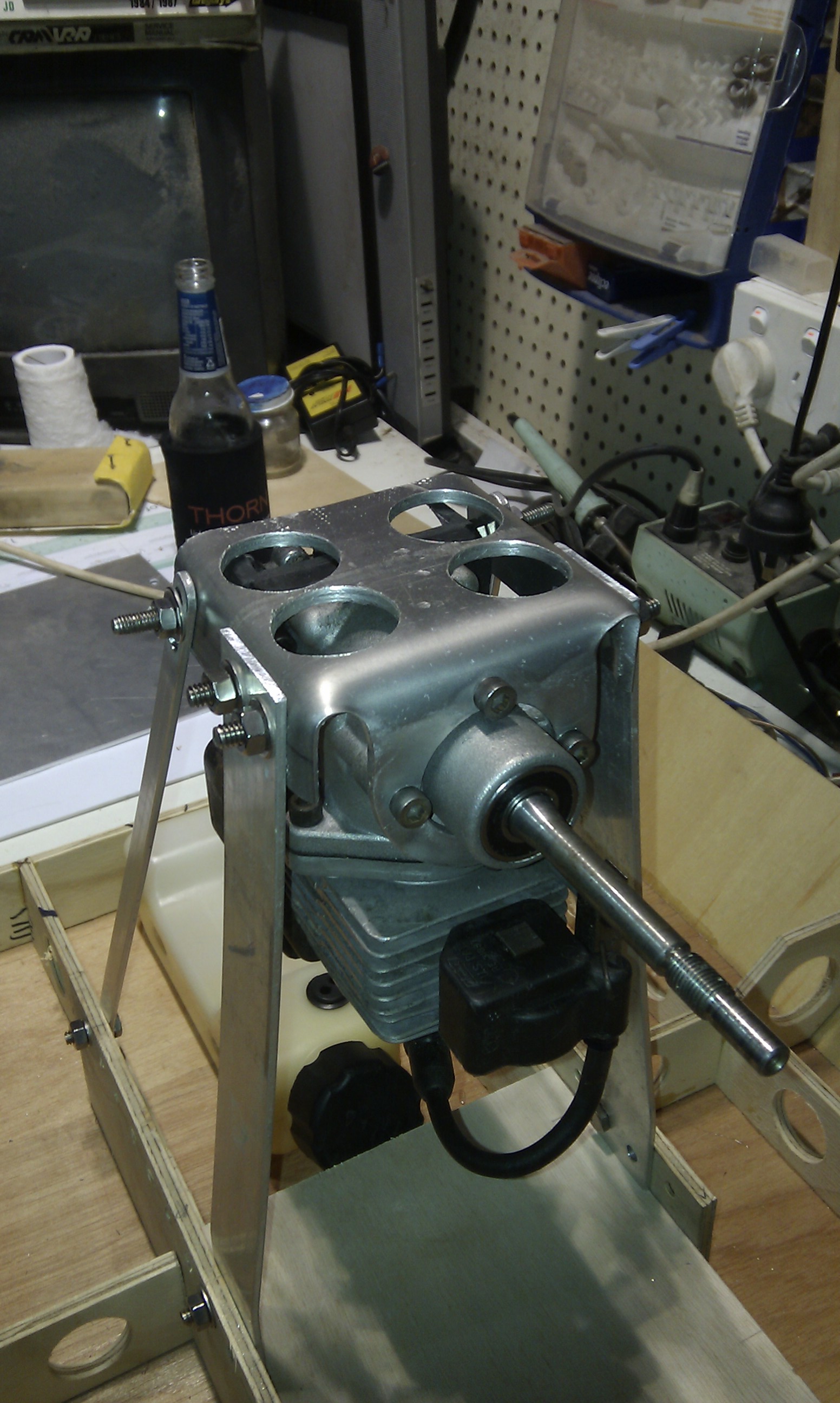

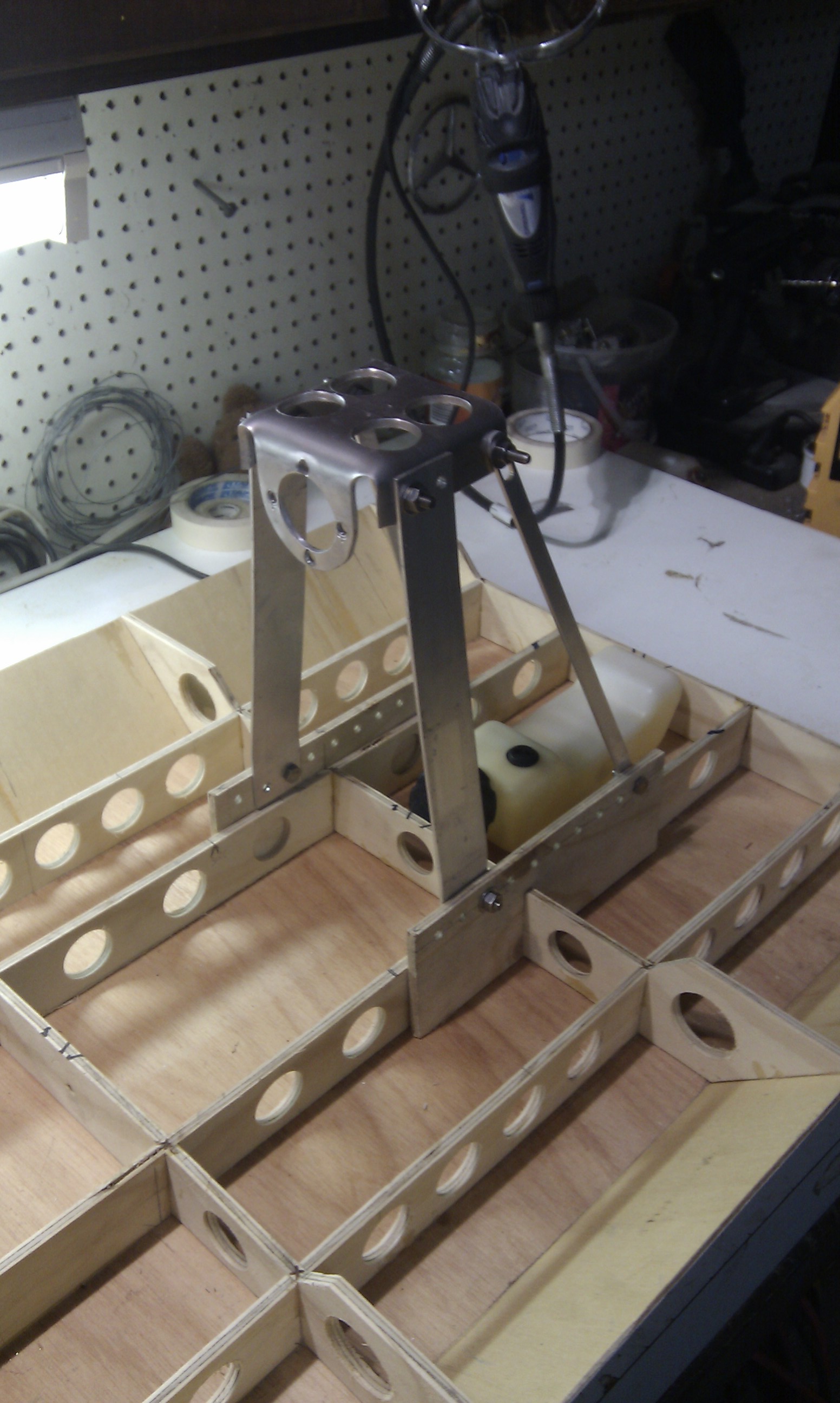

got the engine mount made up and engine mounted. Hopefully will be strong enough.
Gotta go pick up some epoxy tomorrow to coat the inside of the hull so i can stick the deck on.
Still to make up the cage but i can do that once i've got the deck on.

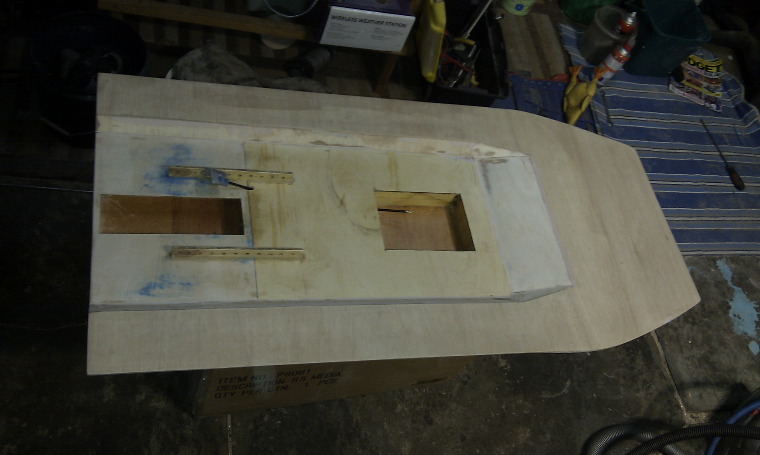

Got more done on the weekend.
Hull nearly finished, just a bit more sanding and patching then seal er up :)
At the moment the hull weighs just under 4kg, hoping its not too heavy, time will tell I guess...

Ozpulse replied the topic: Re: flat bottom gas airboat build!
looking good buddy! B)
The adjustable engine mount is cool.

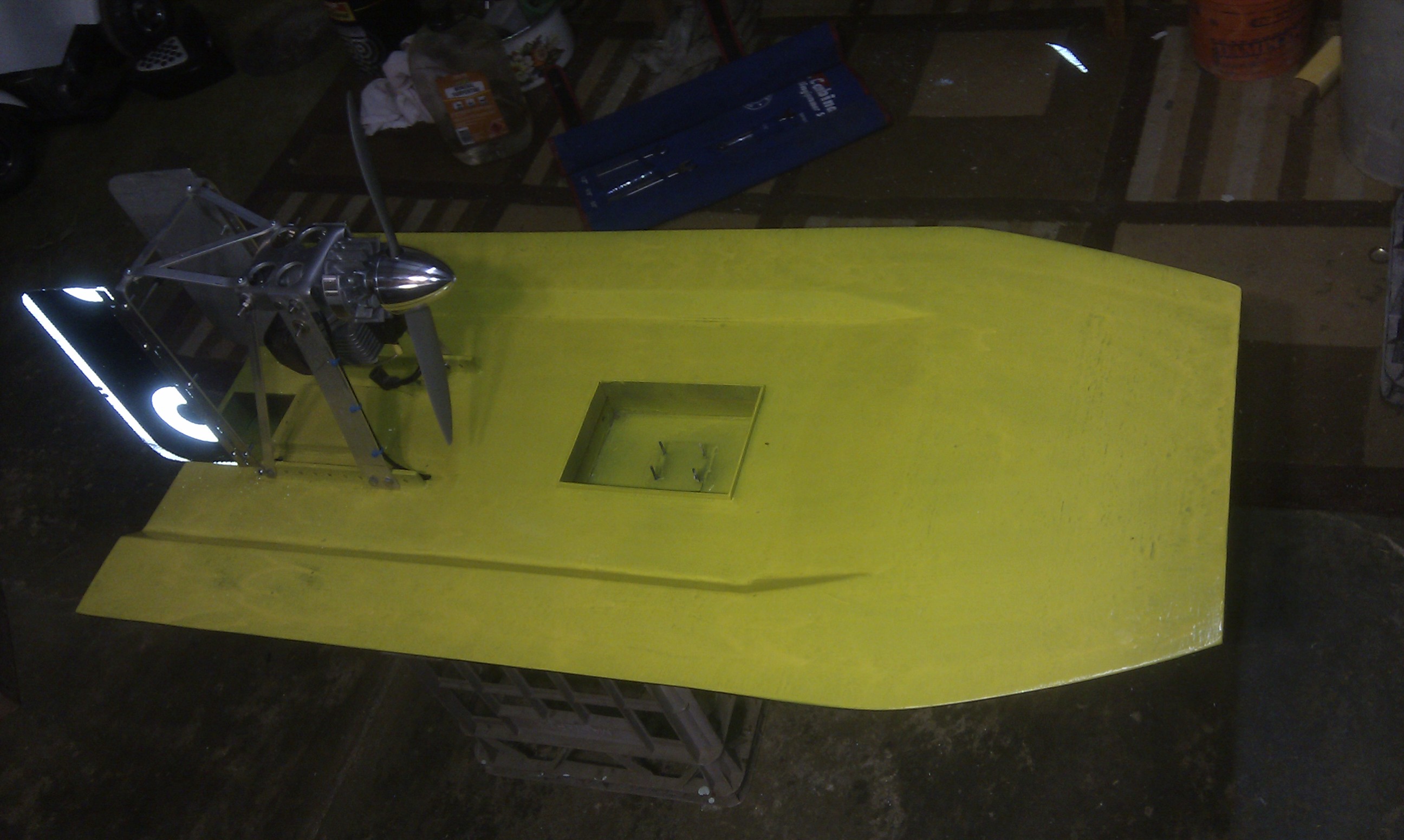

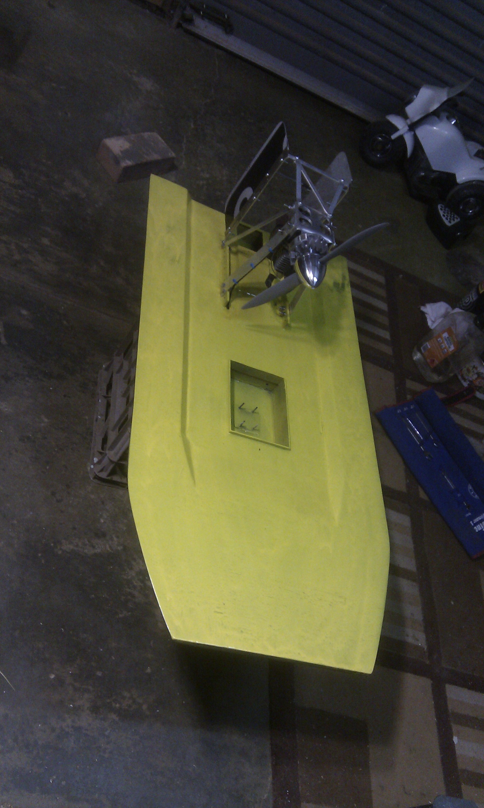

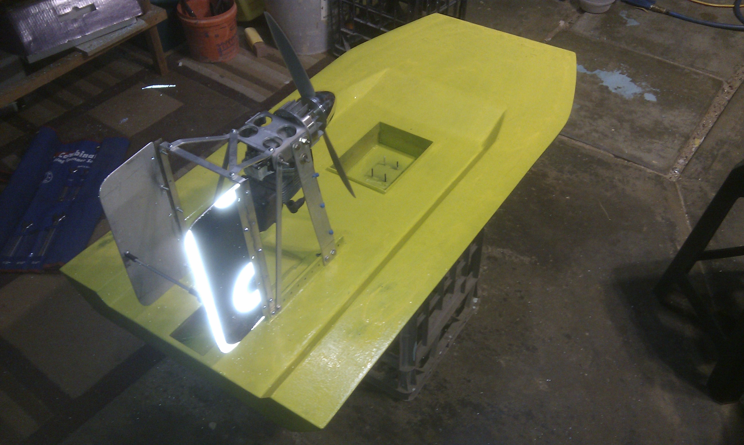

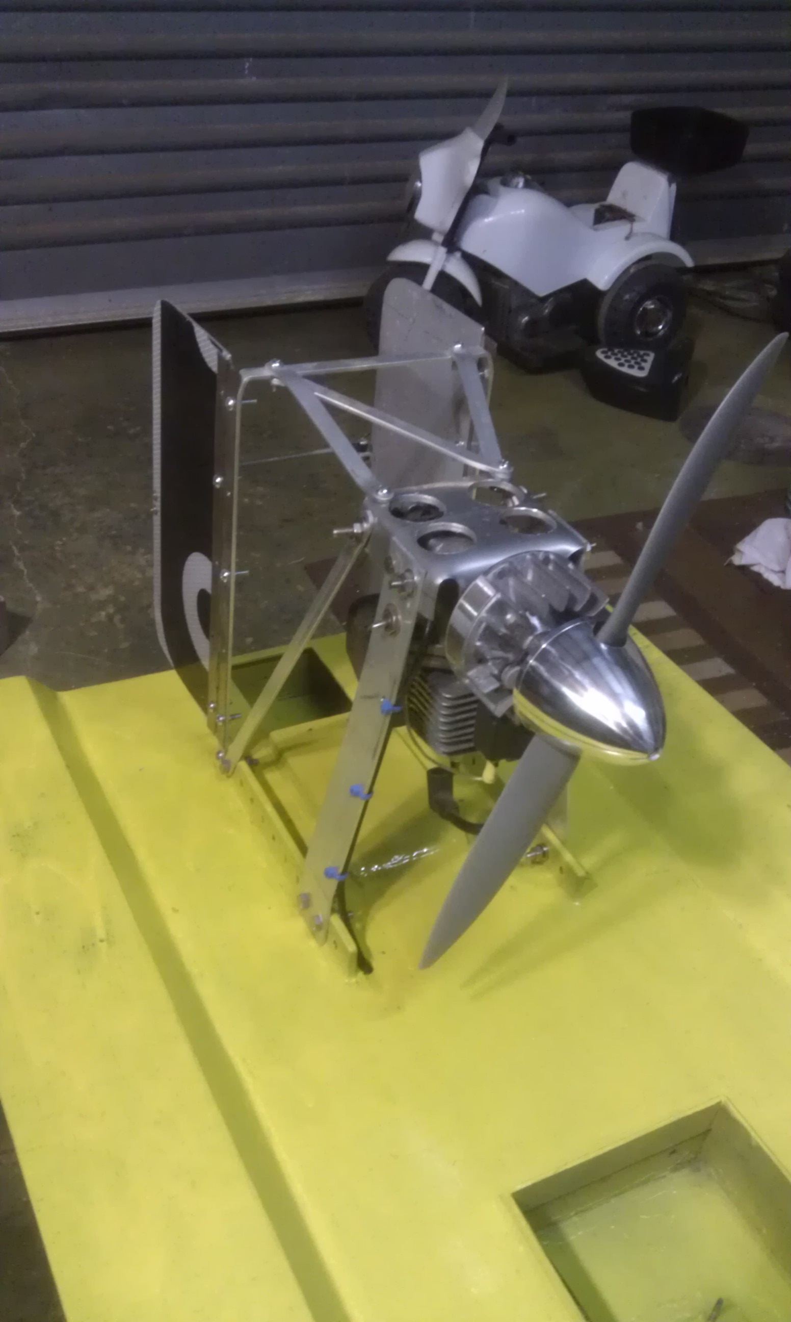

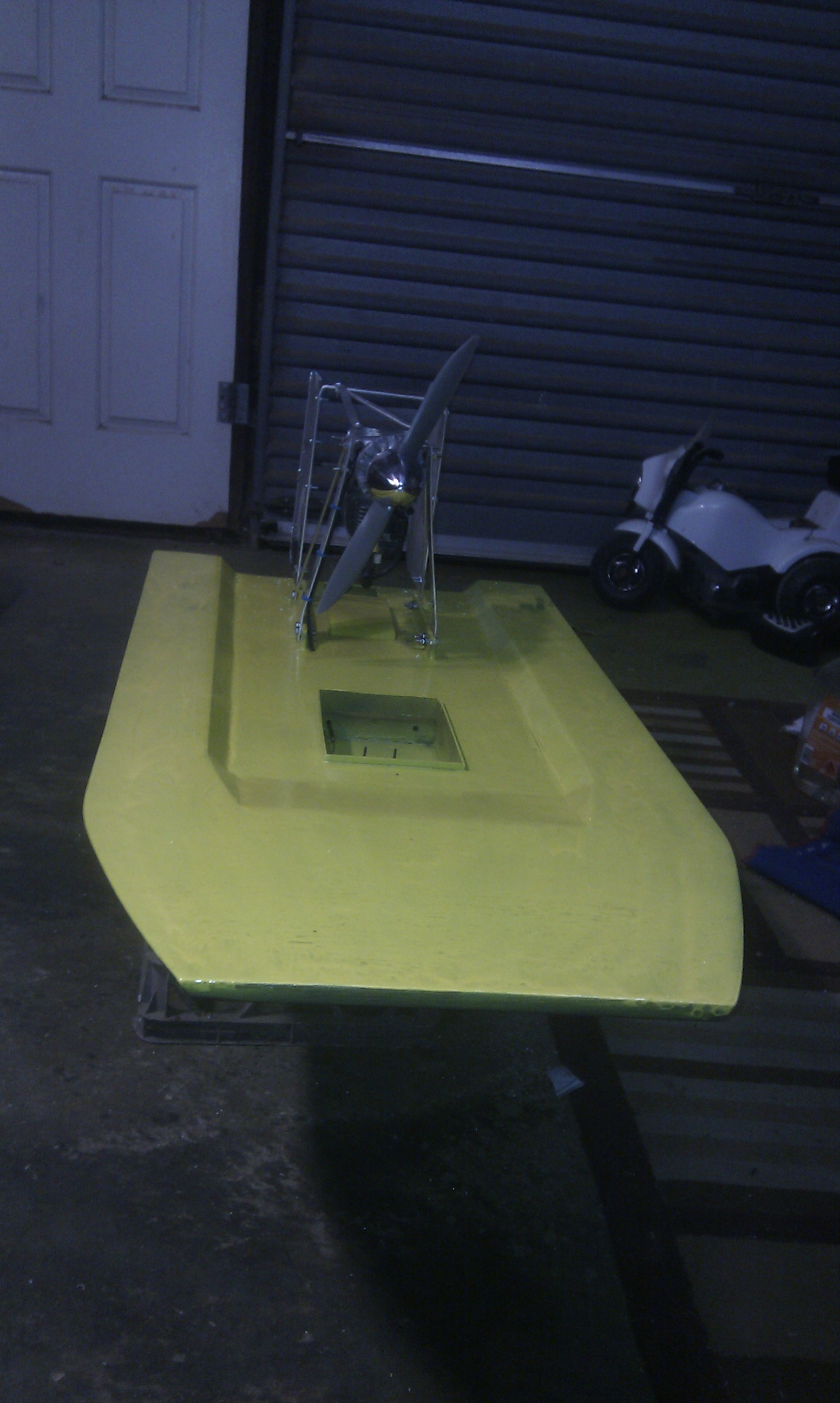

Nearly done, hull sealed and painted, the yellow came out pretty ordinary due to me buying $3 cans of spraypaint.
Once im happy with the way it runs i will sand and recoat the deck with some decent paint like i used on my mono.
Motor and rudders mounted up, fuel tank and line in, just need to bolt the servos in and hook up the control cables.
I ran the motor earlier to get it tuned up, all good so far, nothing rattled apart.
It weighs in at 8.5kg (nearly 19lbs!) but seems to have enough thrust to start moving off the mat in my shed when gassin it :)
