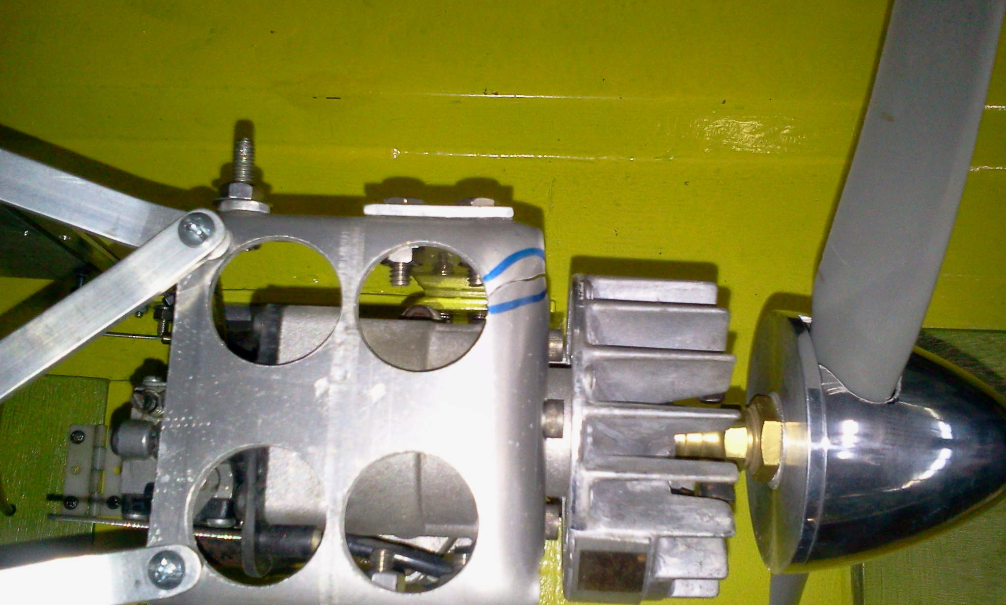

I then gutted the muffler box and drilled 2 10mm holes, and the results were quite satisfying!
Now its spinning the 16x8 APC at 8190rpm, a gain of 1110rpm!
I even swapped over to the 15x6 and got 9450rpm, a gain of 780rpm.

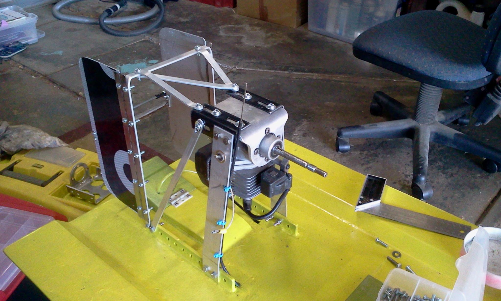

All was great until i heard a strange rattle, i killed the motor to find the motor mount had a crack in it :(
so i made up a new engine mount out of 6mm aluminium that i found at the boatbuilders scrap bin that already had the 90 deg bend i wanted.
i used angle brackets to attach the mount to the uprights this time as ozpulse pointed out that with my old one, the adjacent 90 deg bends would have stressed/weakened the ally hence why it cracked.
heres engine mount V2!
This sod wont break! so i thought... instead of the ally breaking, the black pieces of angle cracked right up the slots!! At least i got a few runs and vids before they let go!
