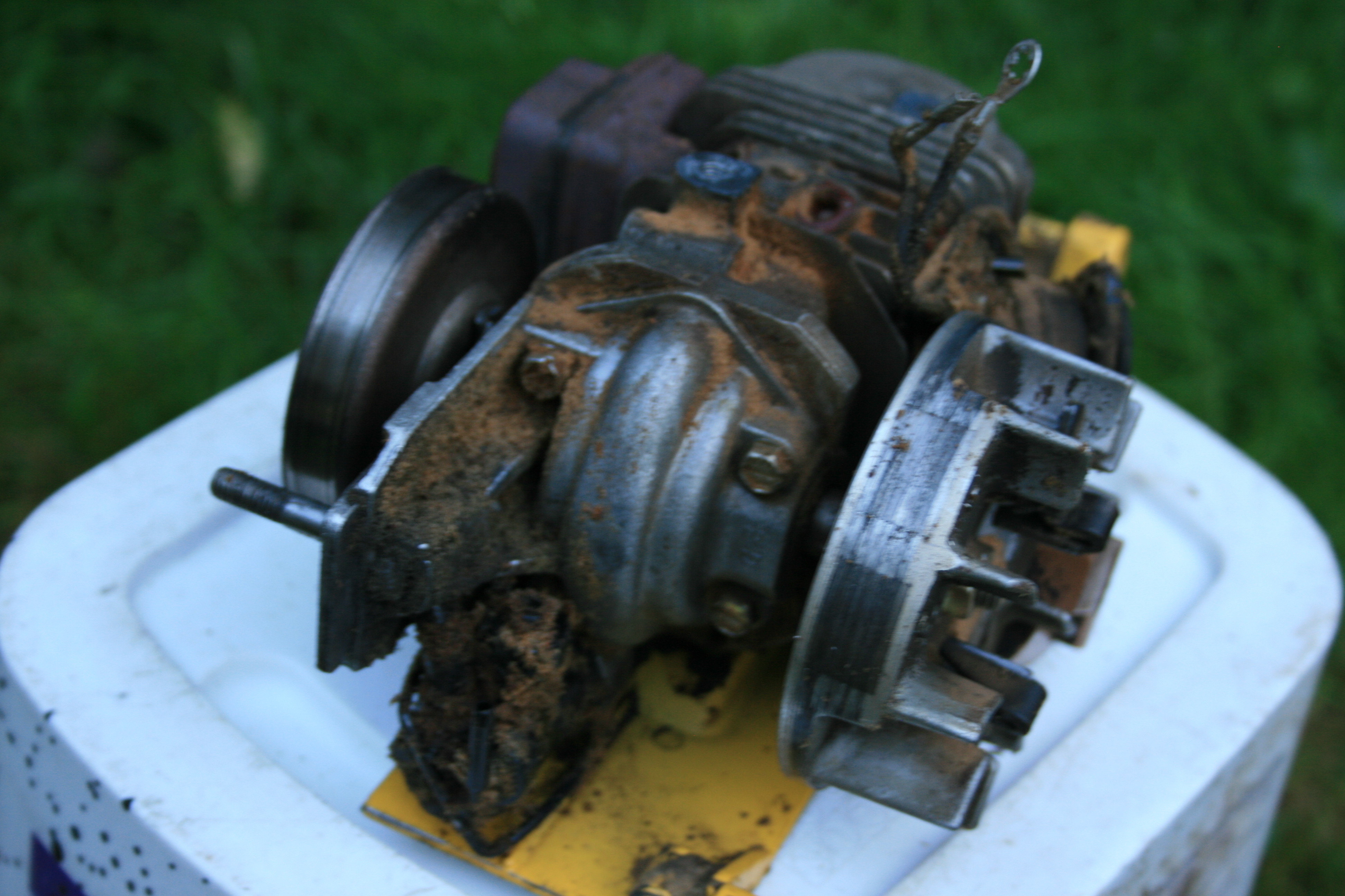

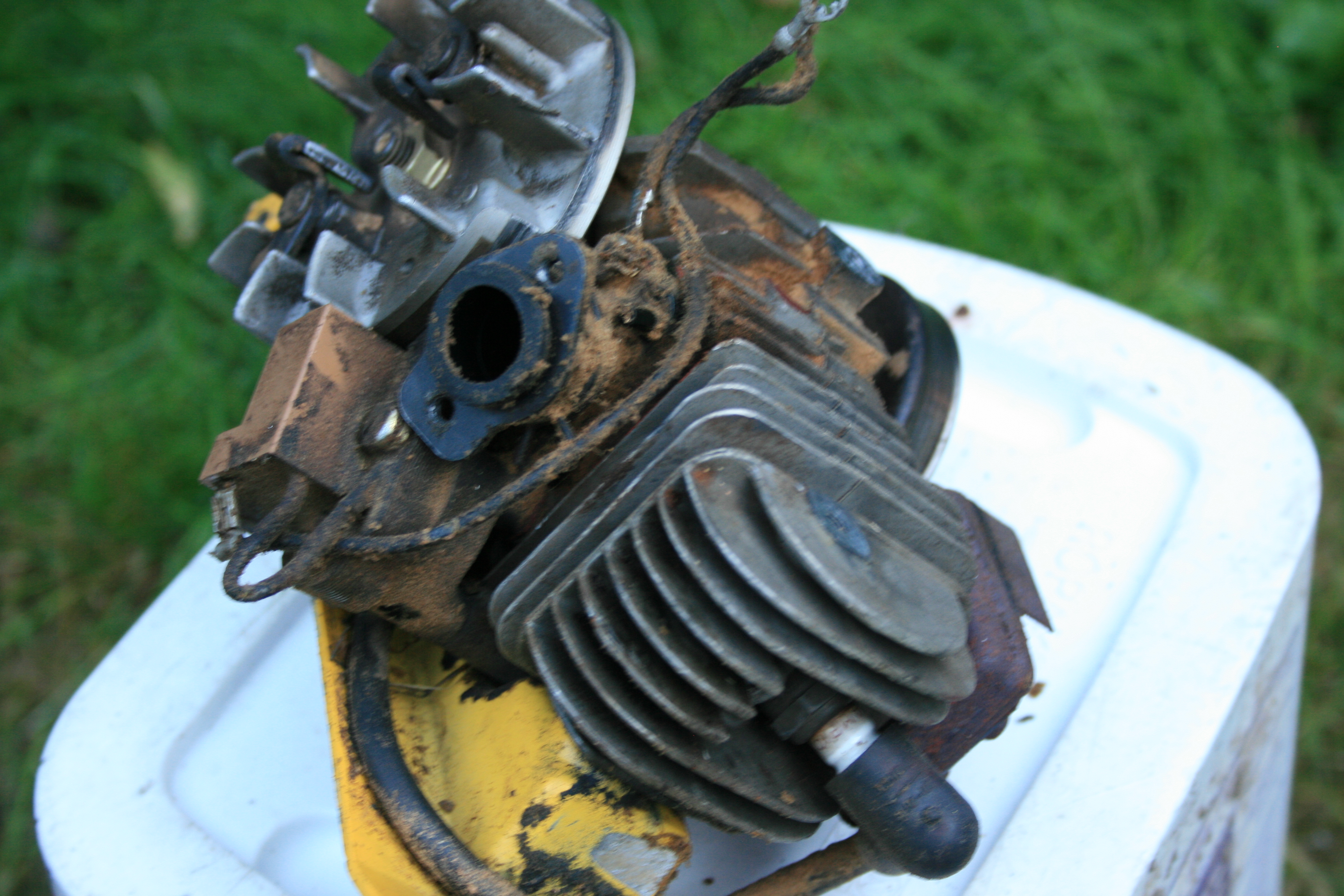

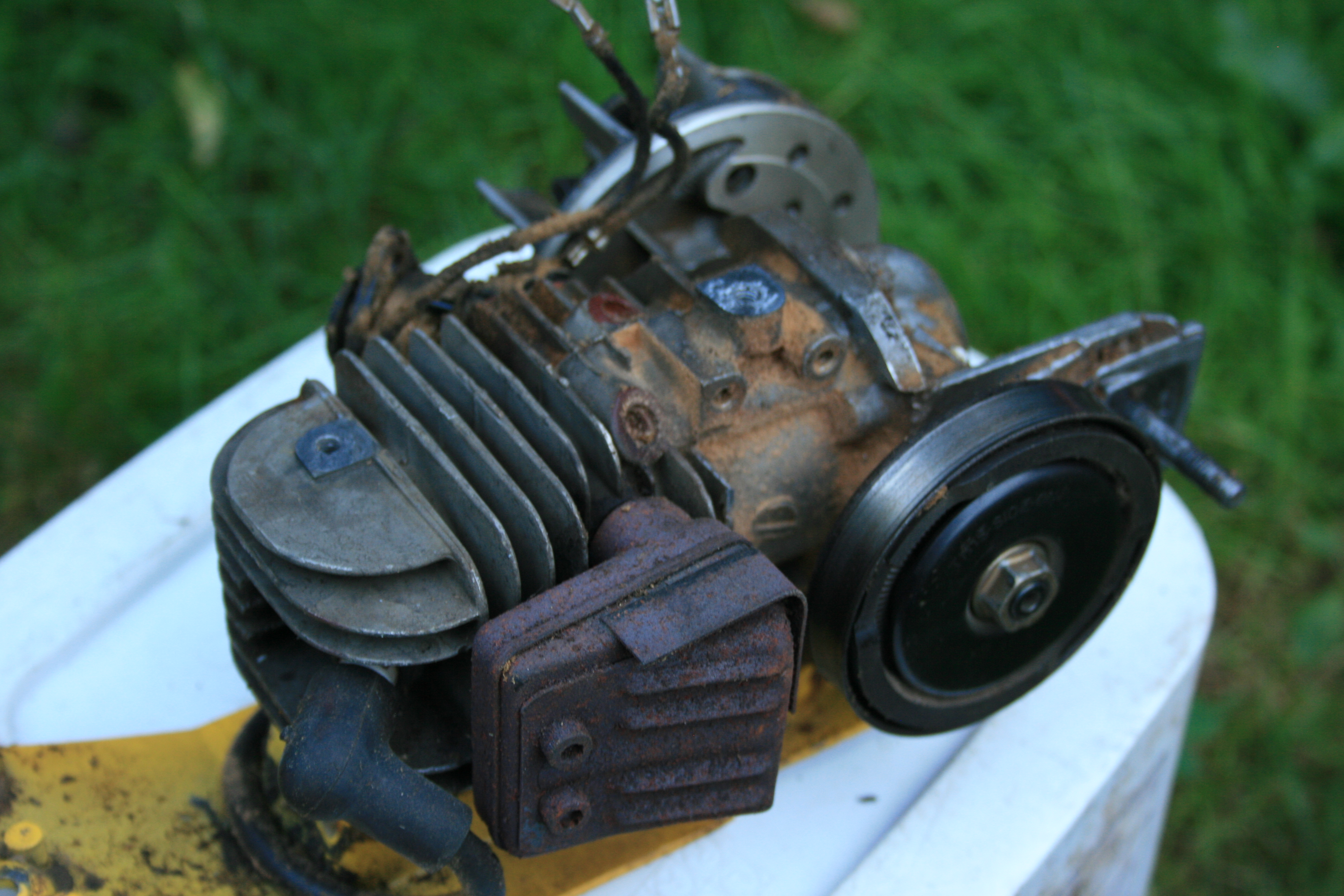

I've taken apart a McCloch 320 chain sawWonder what engine it is
has a zama carb.
Any help or links to sites would be great, it's not necessarly going in to a boat.
But possibly an air boat.

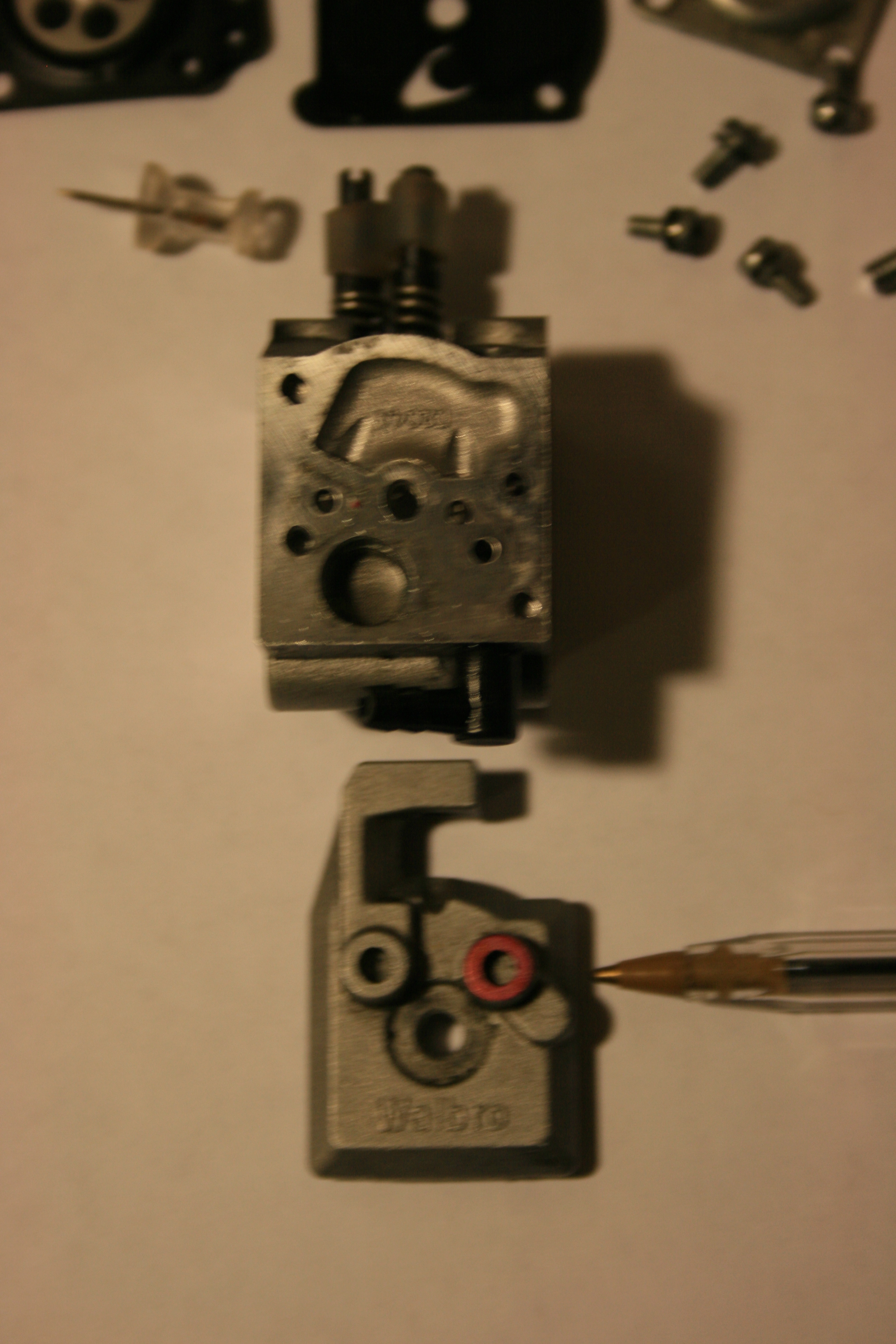

As you can see the rotor has play , may need rebuild
I know the carb needs diaphrams, which I can't get--it's too old for the saw shop.

Walbro had HDA series carbs back in the day that fit that series of saws.
being it is in the displacement range a WT-257 was designed for ... there ya go, adapt it and run one of those :woohoo:

I was afraid you might say some thing like that Scott, how ever you can still help.
i have a 257 in peices in front of me, It apears there is an embossed spot on the bottom plate. Which could be drilled and tapped for the line on the intake manifold. It's red at the tip of the pen.
