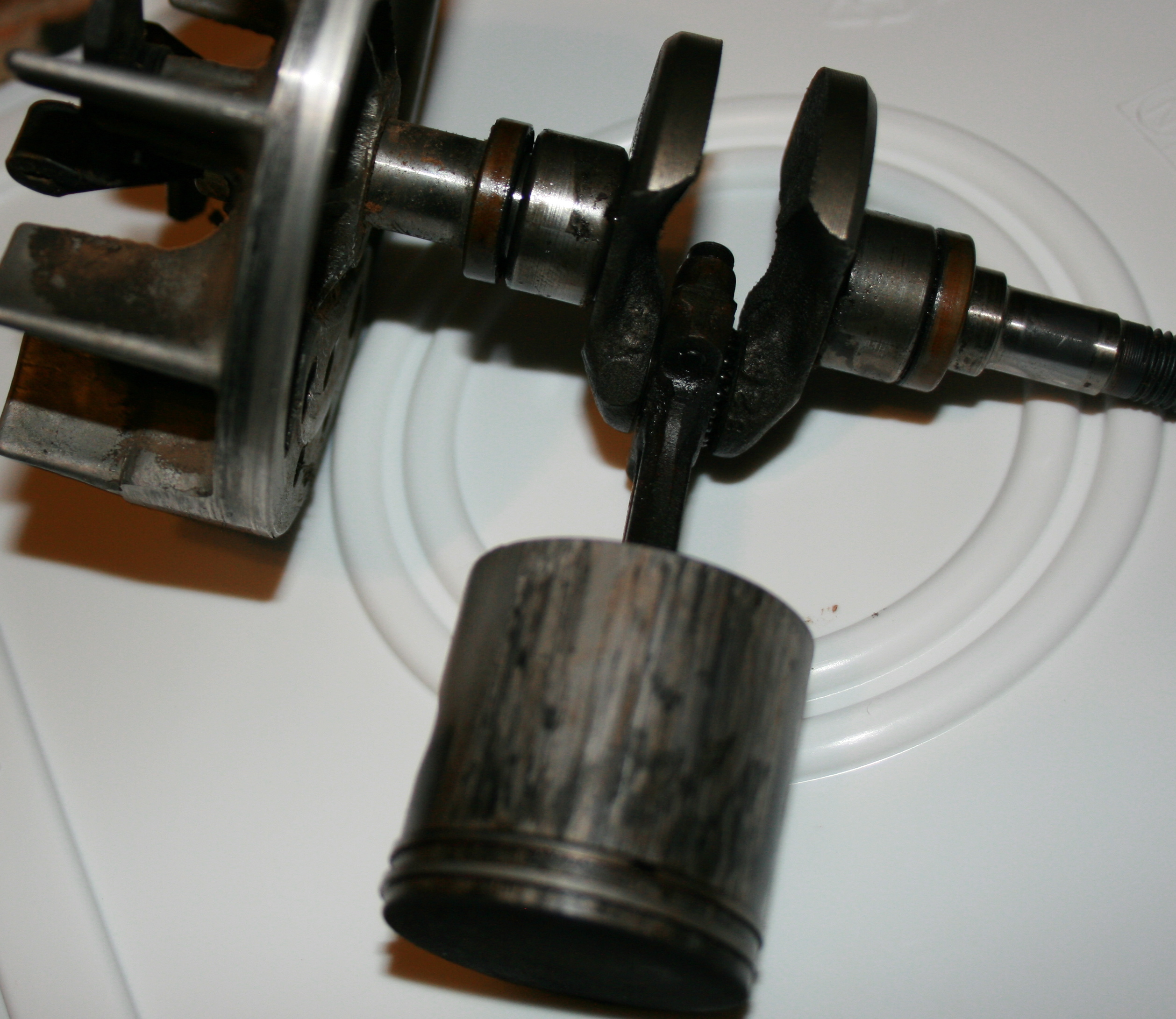

tapkoote replied the topic: Re: Help idenitifing an engine
Scott
another picture to look at
This piston is rather scuffed up, the cylinder shows wear but no real damage.
I'm going to polish it up and try it, what do you think was the cause? Did it get too hot?
The bearings seem tight, I can't detect any end to end play.
Question, the ring groves dont have any pins, could that clicking have been the end of a ring in a port?
#17484
Scott replied the topic: Re: Help idenitifing an engine
Yup, Roller bearing mains and a fracture cap rod.
Piston been seized for sure !!
No ring index pin because cylinder uses small ports and Ex is bridged.
Those roller bearing mains ARE NOT going to like axial loads being engine by design was to ONLY have radial loads of chain being spun.
More you show and memory returns on these engines have to say likely not a good candidate for a boat application with prop in water or air pusher/puller either :(
