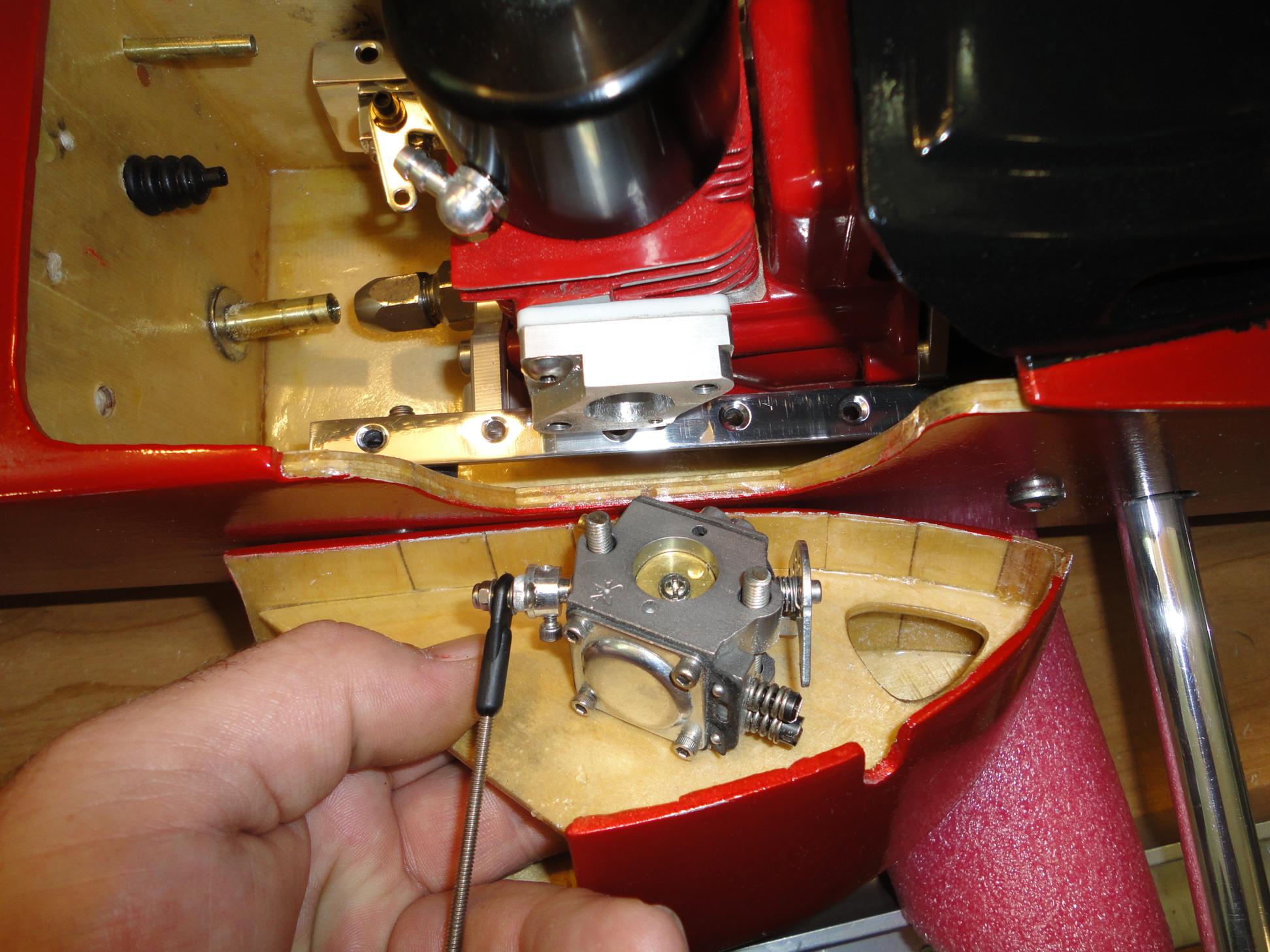

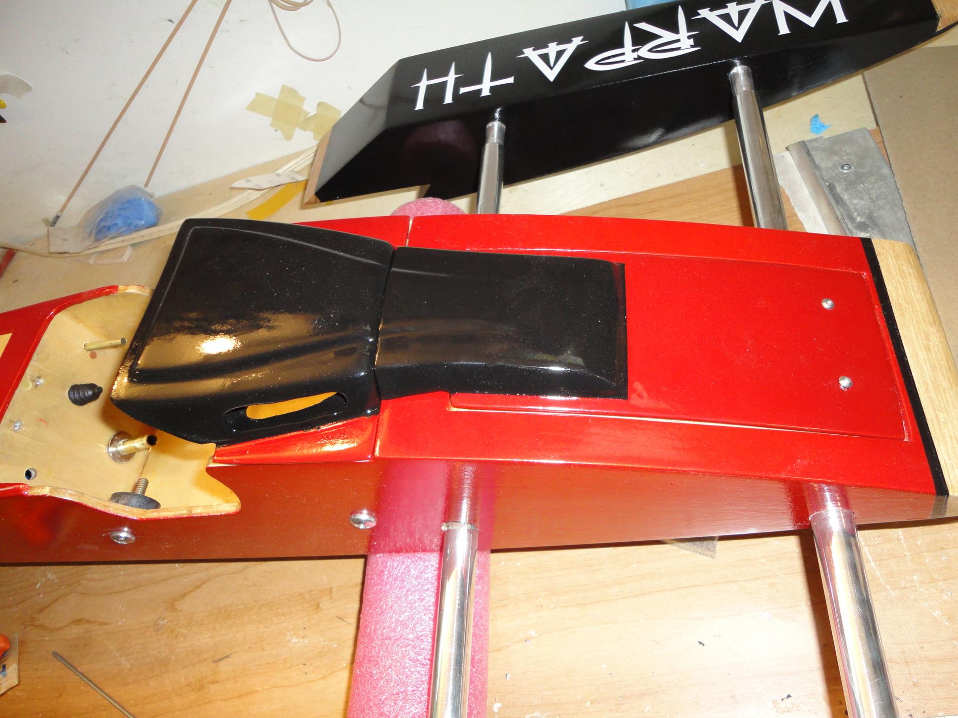

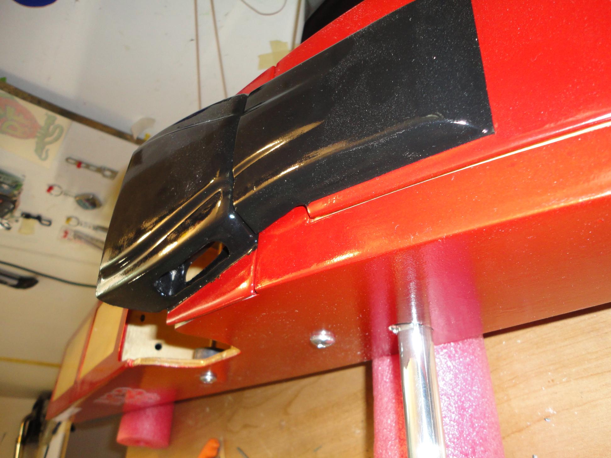

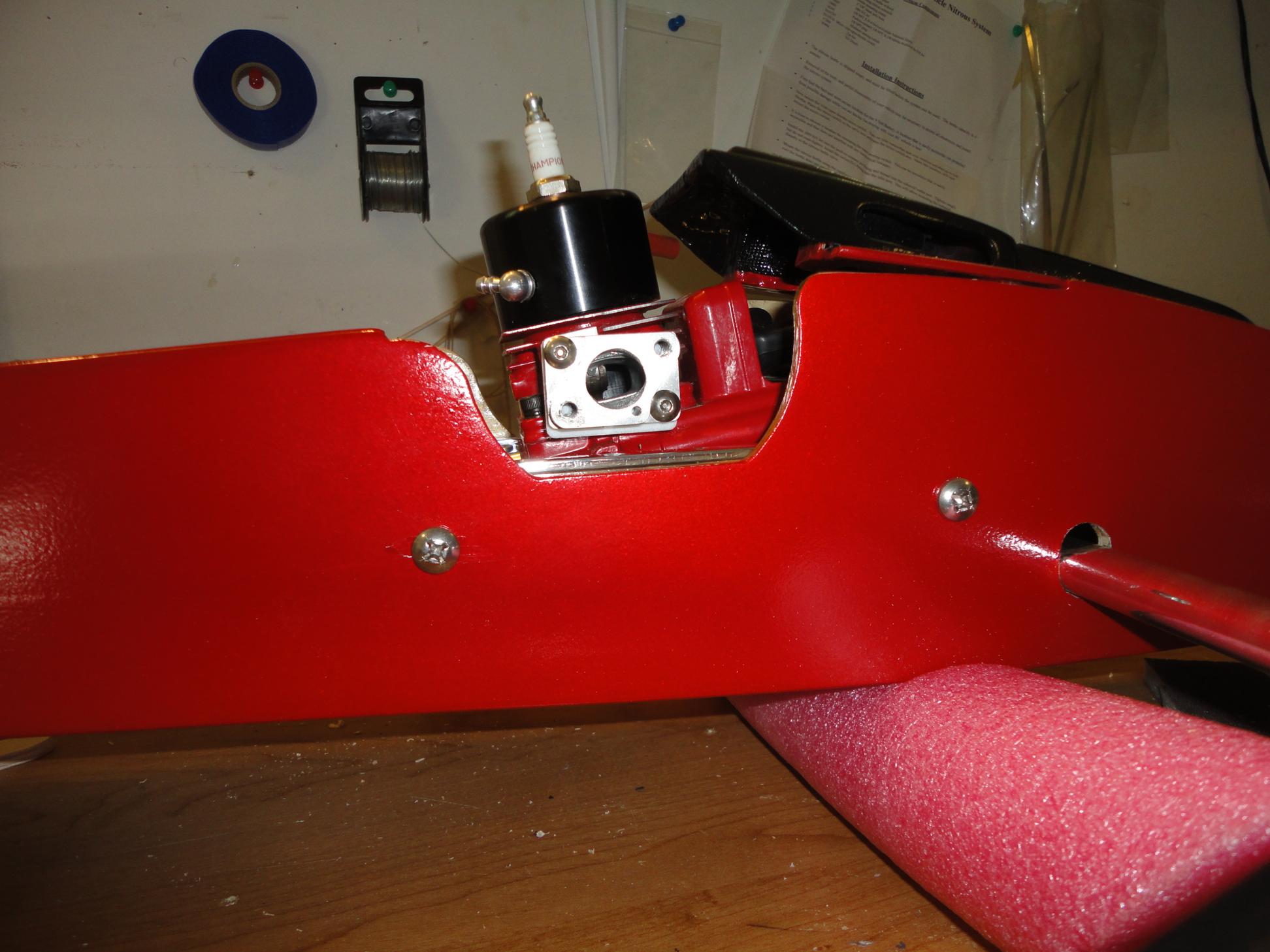

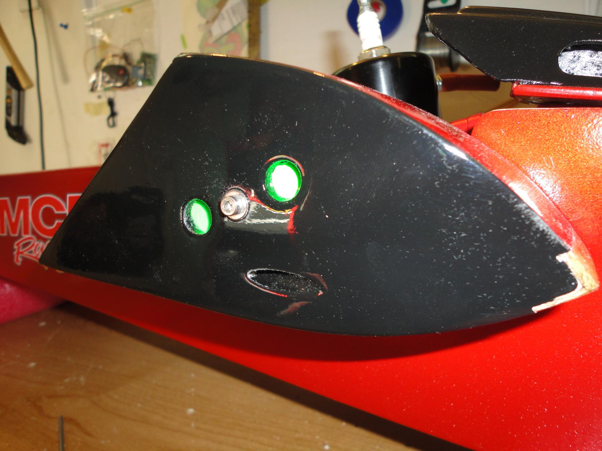

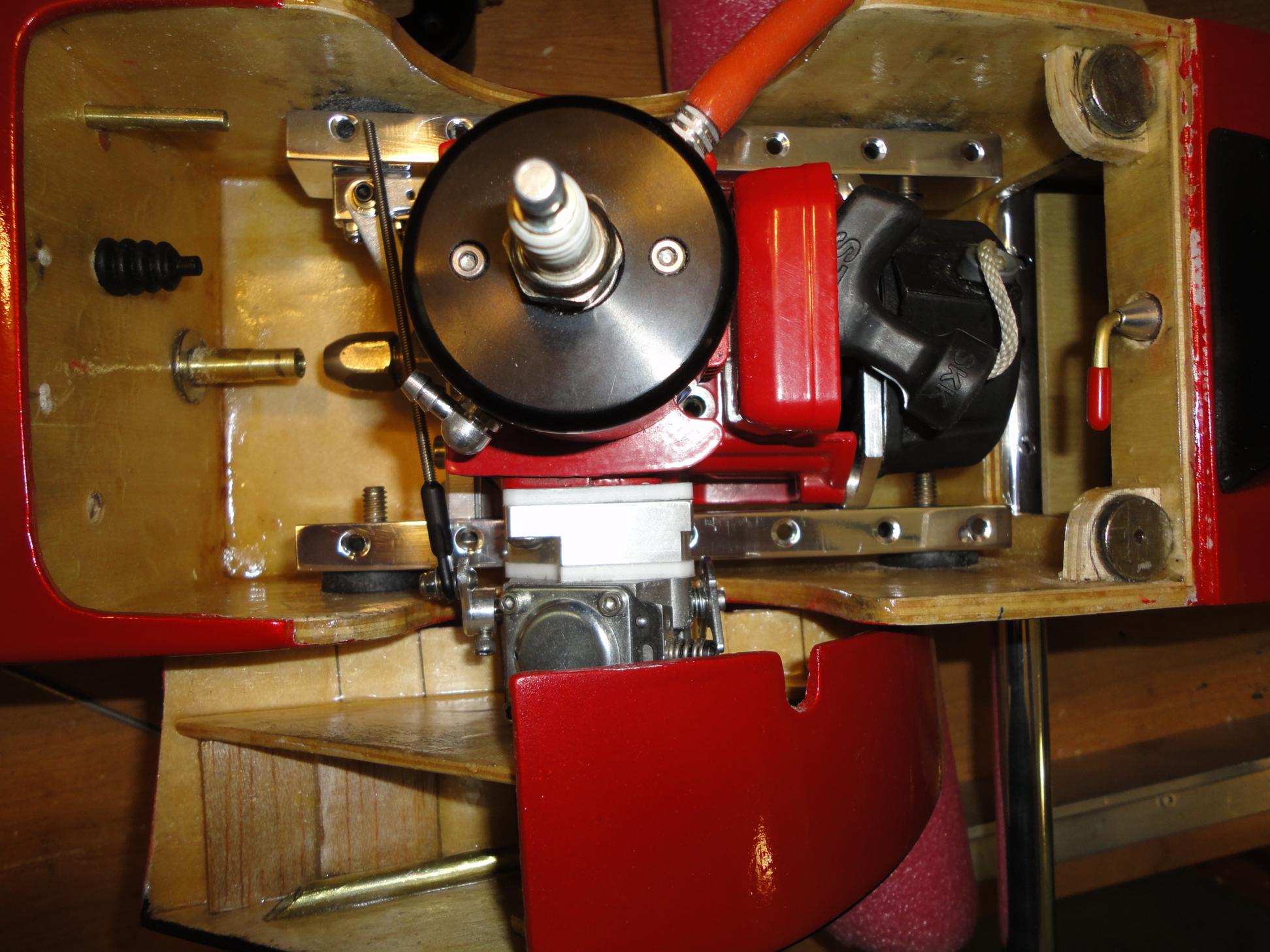

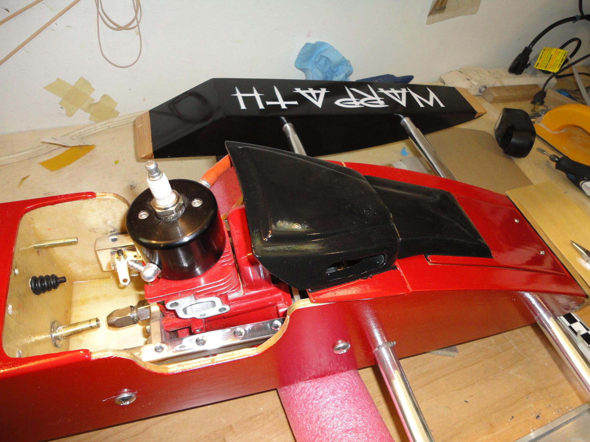

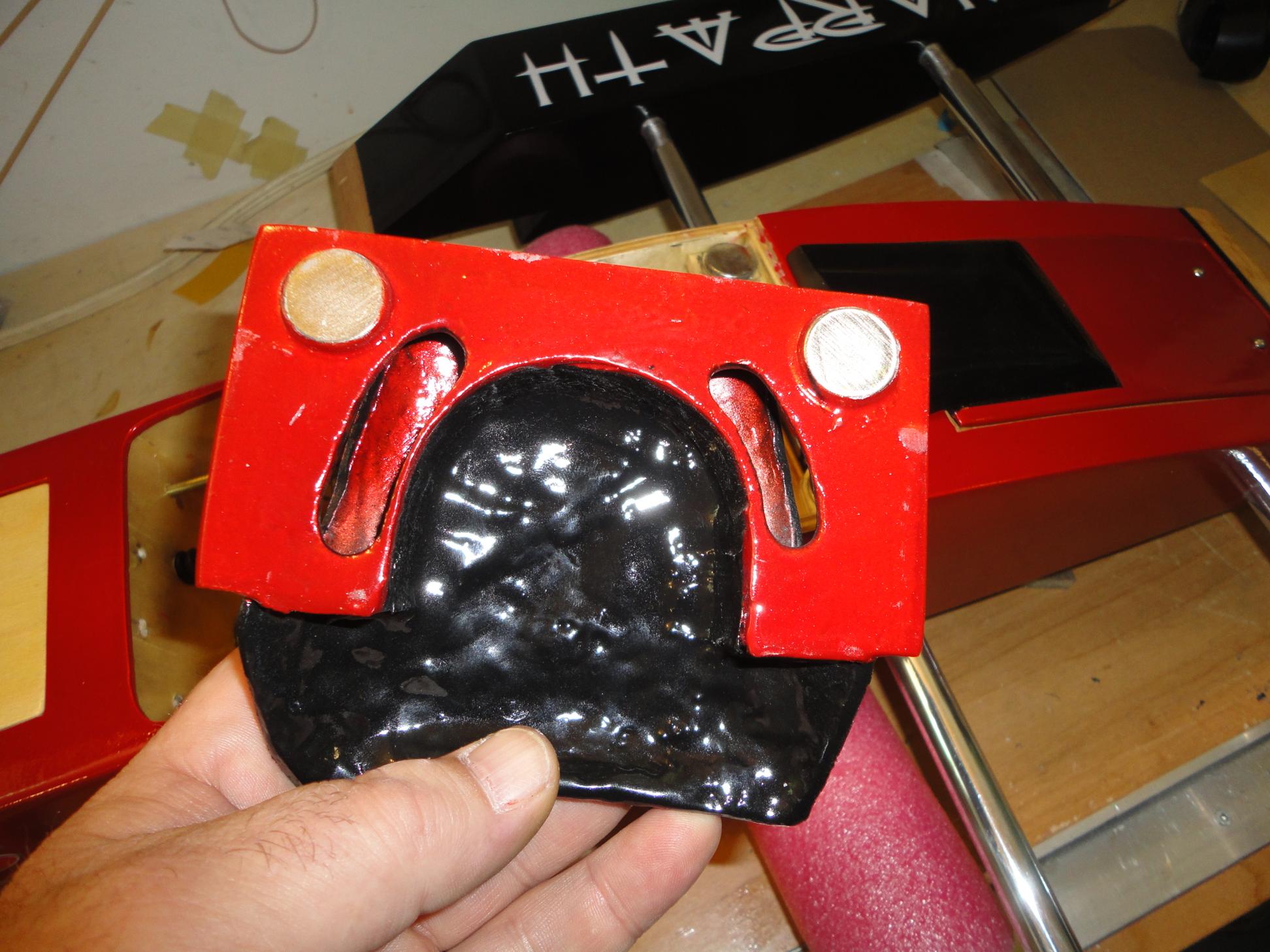

I wanted a scoop or cowl --- before Marc made then so I took a scoop turned it around and glassed it in
added air slots to corners to try to drive some air towards carb
Yes I need floatation
help on by rare earth magnet so drops into place --- you can lift boat by cowls magnets alone so they should stay in place
same set up for pcs without scoop

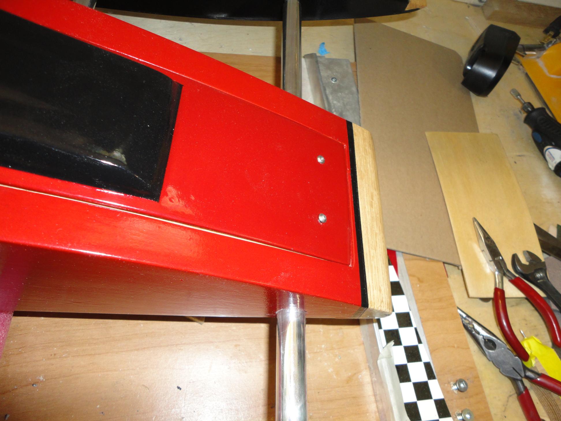

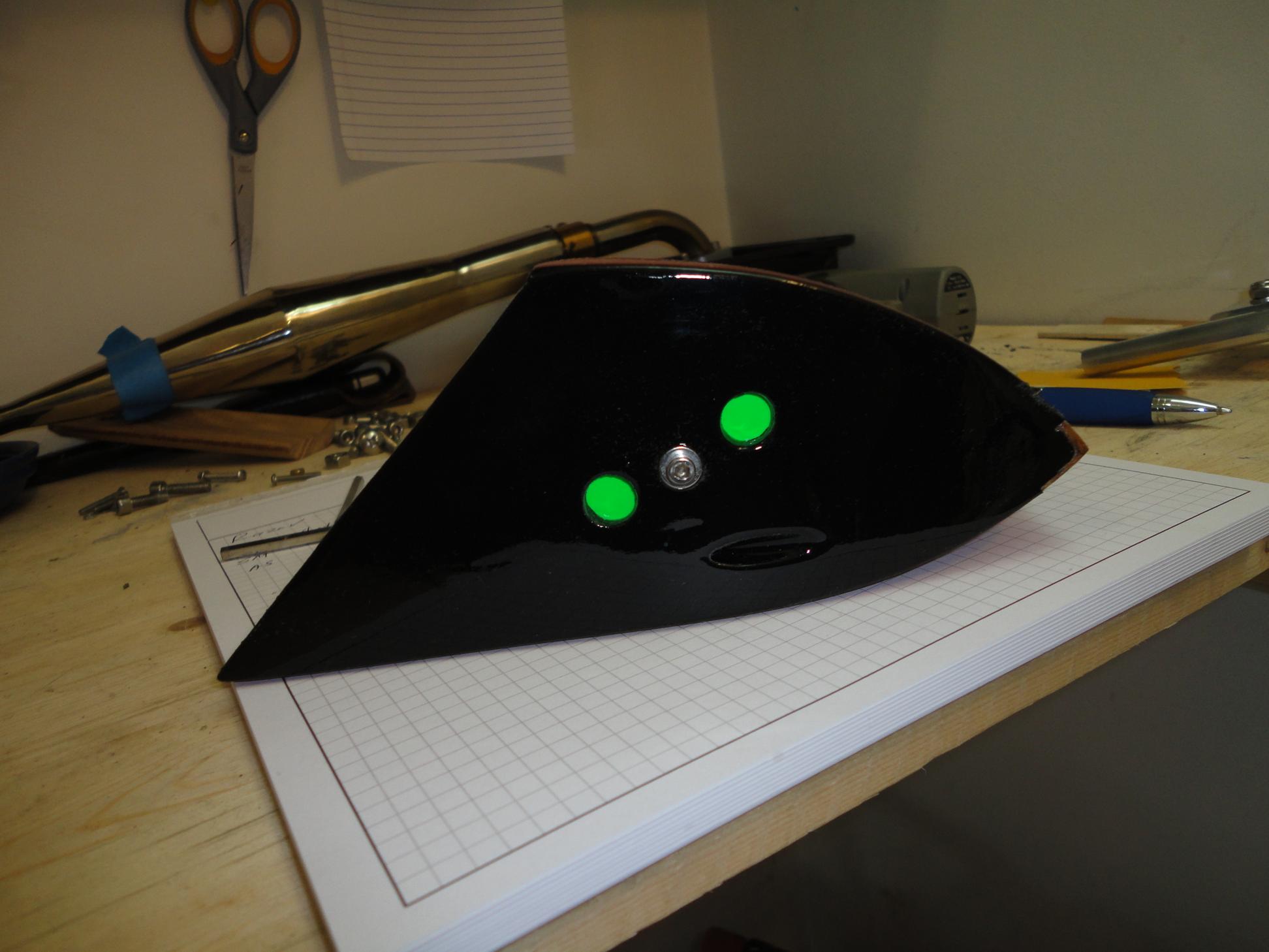

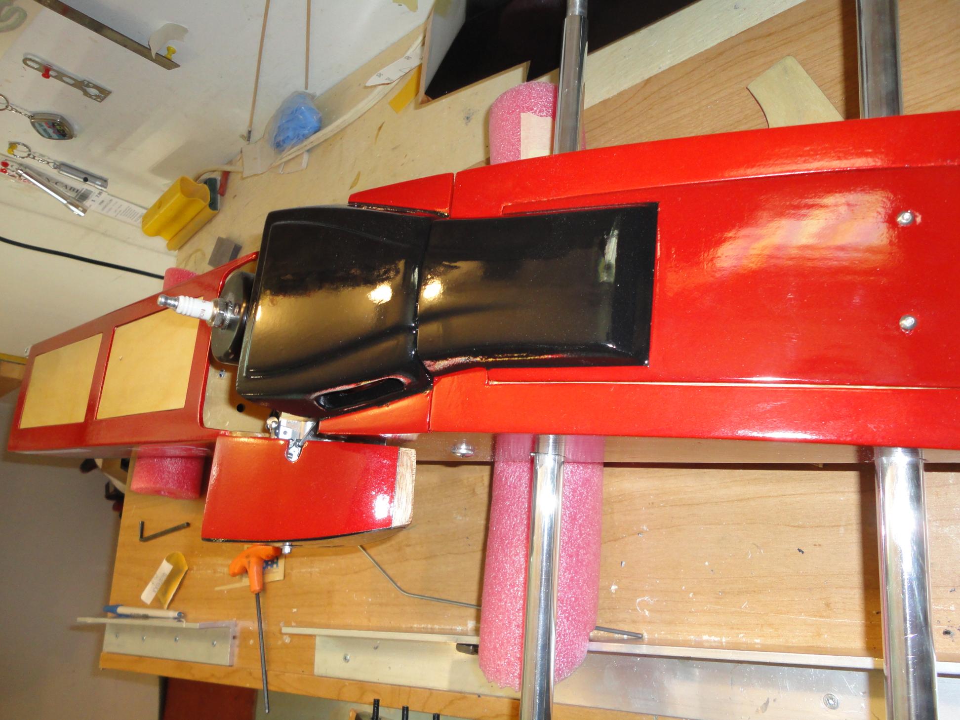

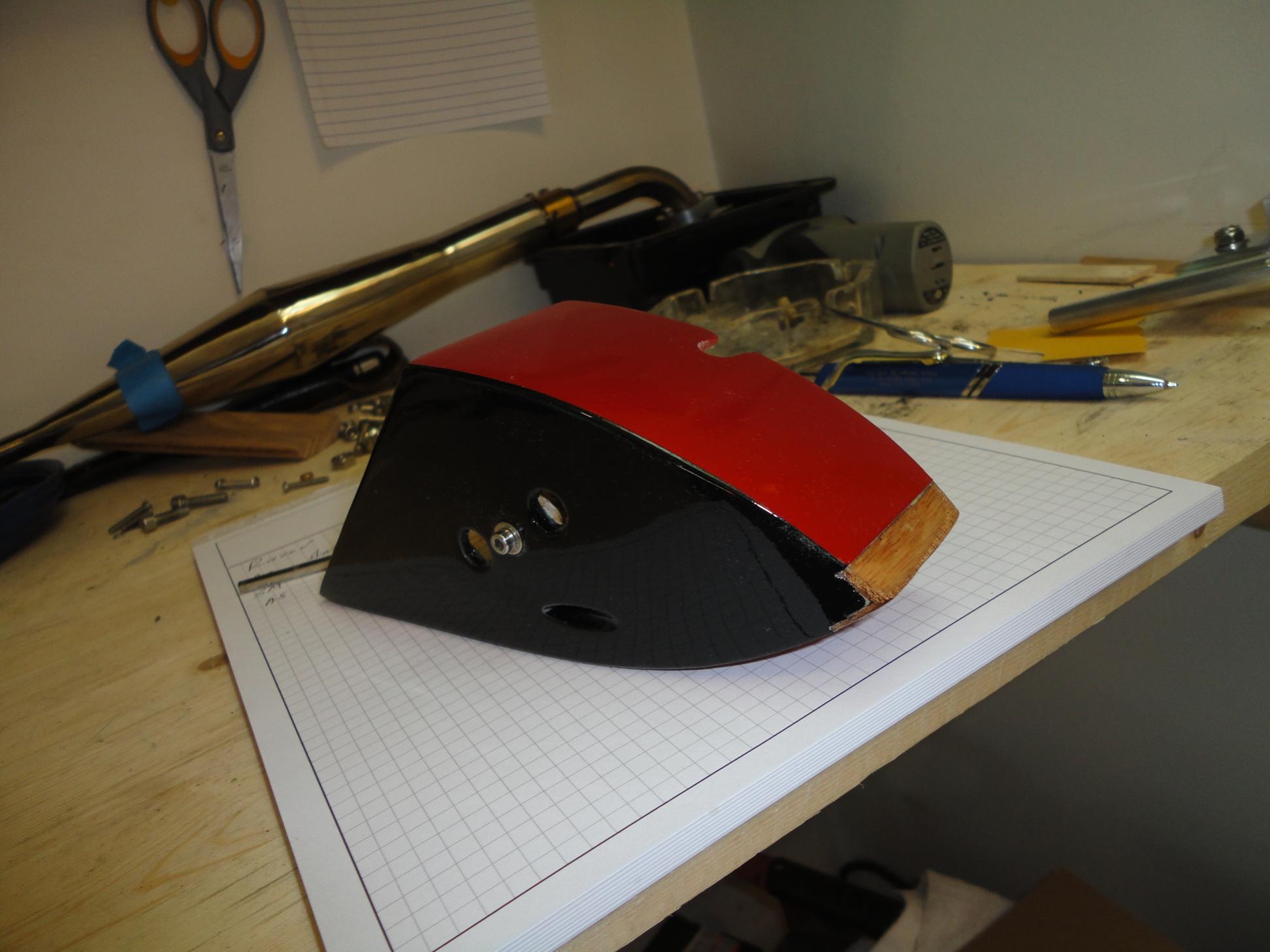

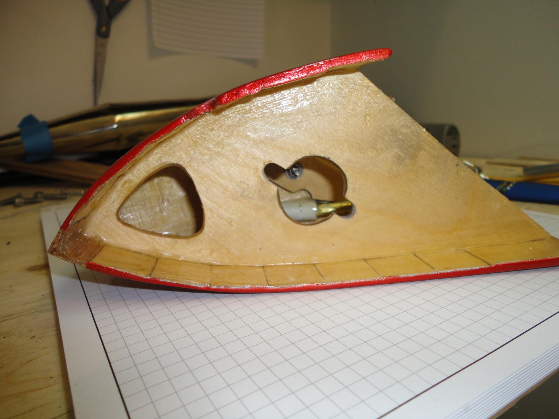

and now
Wayyyyyyyyyyyy to much free time and engineer friends + T3's = ........Lol

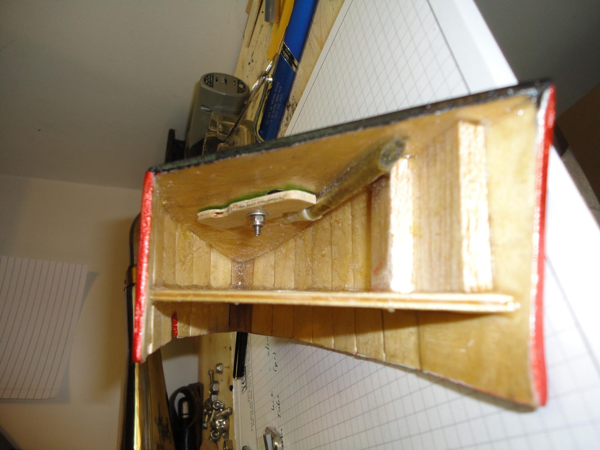

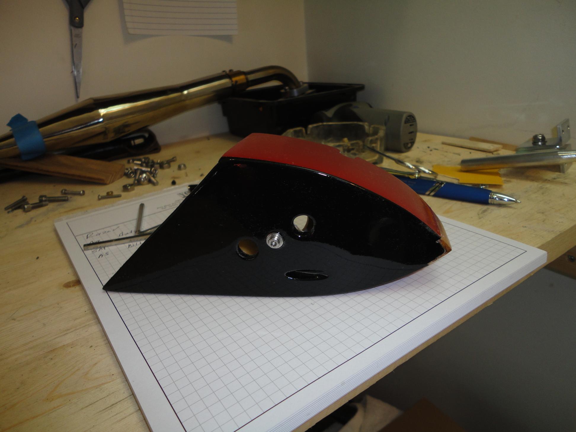

My fourth scoop
I can't bend wood woth h... so it's made from stripes of balsa with a glass and cloth coating
it's longer and wider the first
it has piece wood inside you just flip for closing acess holes to carb (bolt has nylok and been peened) -- when it's green ...... it's closed . I hate tape
it has steps to prevent water crawling in
a venturi to blow air by - hopefully help to draw air from front - hence diamond cutout in front of scoop
it will be sealed by rubber strip to body
weighs almost nothing
so idea is to draw air thru notches in top of boat - thru front to carb

Ok, you have to tell me what that brass tubing is there for!!!! :)
#17736
Canadian Hot Rod RC Boats replied the topic: Re: My Warpath
look at side of scoop there is a small scoop in the scoop that feeds that tube
idea -- blow some air thru scoop to help draw air from front and keep water out
Way to much free time ............Lol
ACTUALLY JUST KIDDIN MARC - it's idea was to just to help stop any water from climbing up the rear of scoop :lol: cheers
Marc
My boat has 2 complete sets of hatches - yours and the one's I made with scoop
my set is to play with to try some air theories my friends and I talked about when I was away sick
The scoop (I call #4 Balsa wood/glass) .......... well ..... got carried away but I like to try diff stuff
I'll start with all your stuff first ..... mine is just old school hot rod stuff .... and too many T3's .....Lol
I hope to start it - with Mod ONB on Sunday ......... if I can

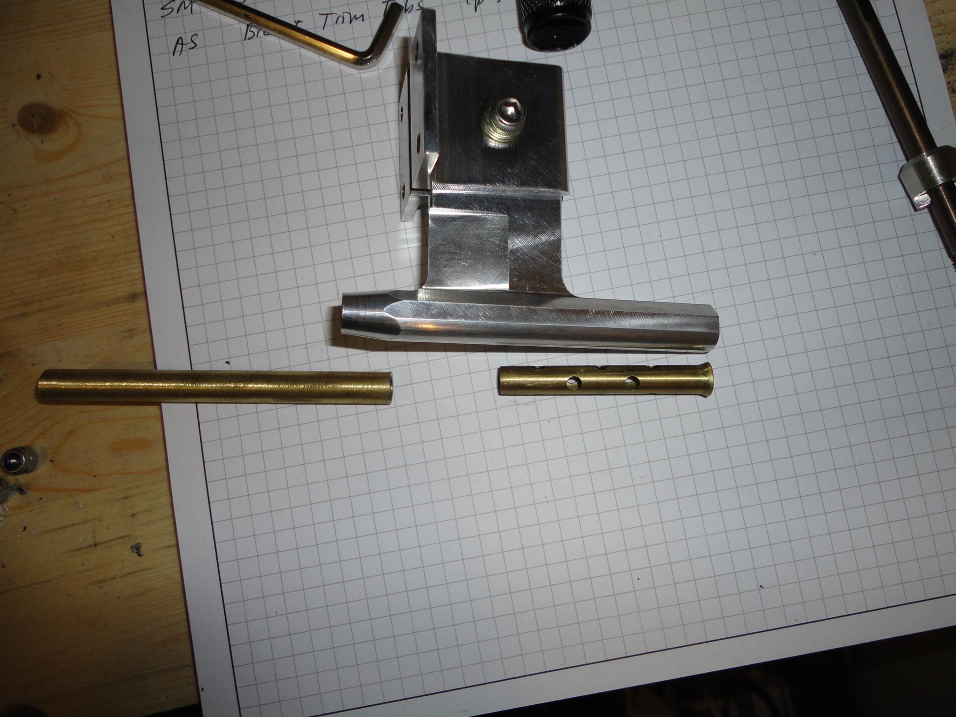

Marc or Scott or if u know
How much of the brass stuffing tube should go into the strut ?
It's a very snug fit right now my other SM stuff is not so tight ....
just wondering if my insert will be short and leave a gap is that okay or do I need longer one?

Scott replied the topic: Re: My Warpath
Using the brass tube type sleeve / bearing try to have stuffing tube go into nose of strut 3/8 - 1/2" and if a loose fit put in with a bit of Loc-tite 640/648.
If you need to adjust strut depth or angle best to pull strut blade and tube as an assembly, tweak tube a tad to reposition strut where ya want it moved. Doing it this way keeps all grease/oil on cable having to pass out threw the sleeve bearing and keeps water from being forced in at struts nose cone aggravating lube wash out.
#17742
As for sleeve bearings length, it only needs to be long enough to support prop shafts SOLID area. Supporting the cable ahead of weld joint does nothing.
#17743

Thanks Scott with the extended strut I wasn't sure about cable support
