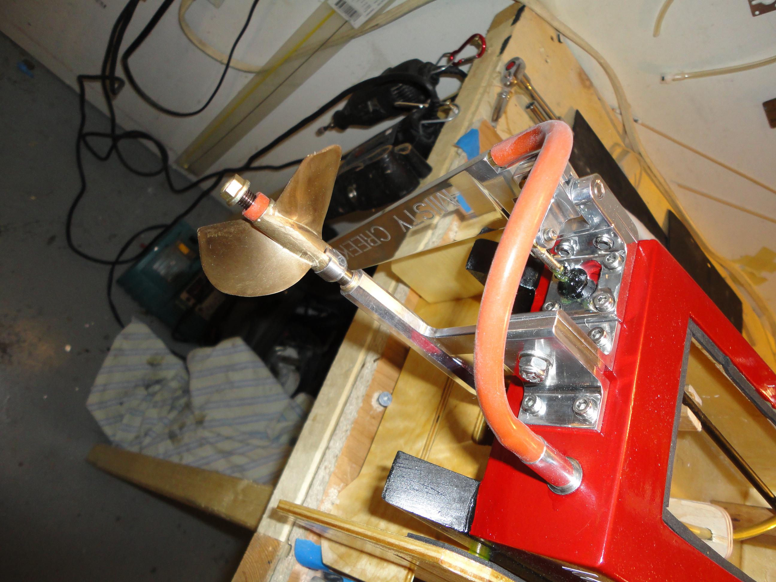

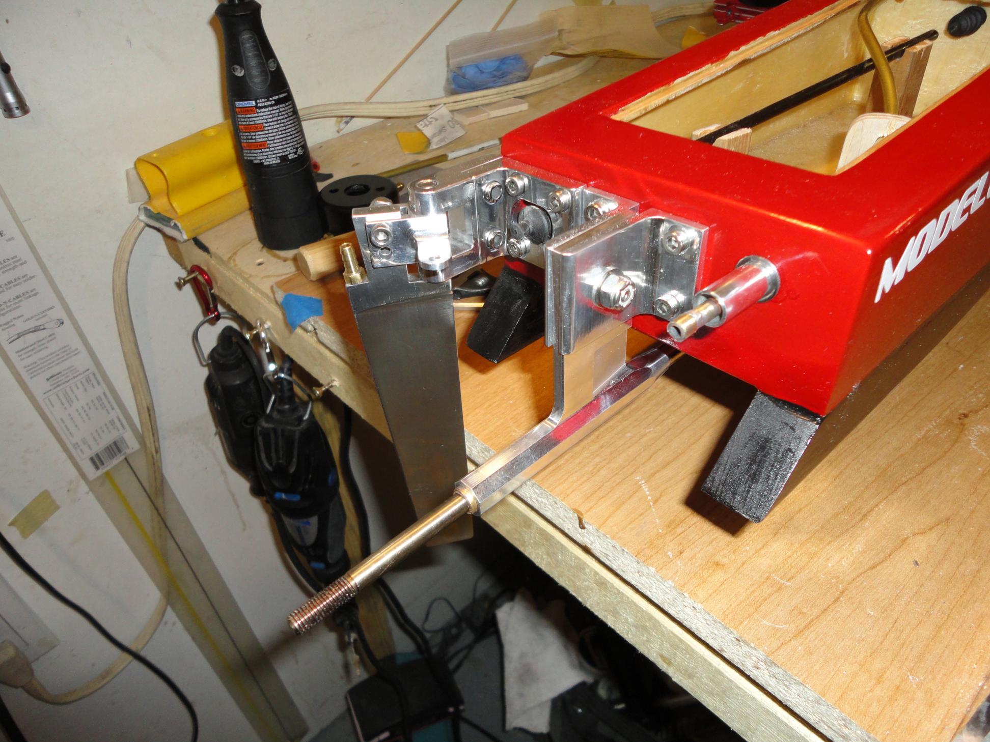

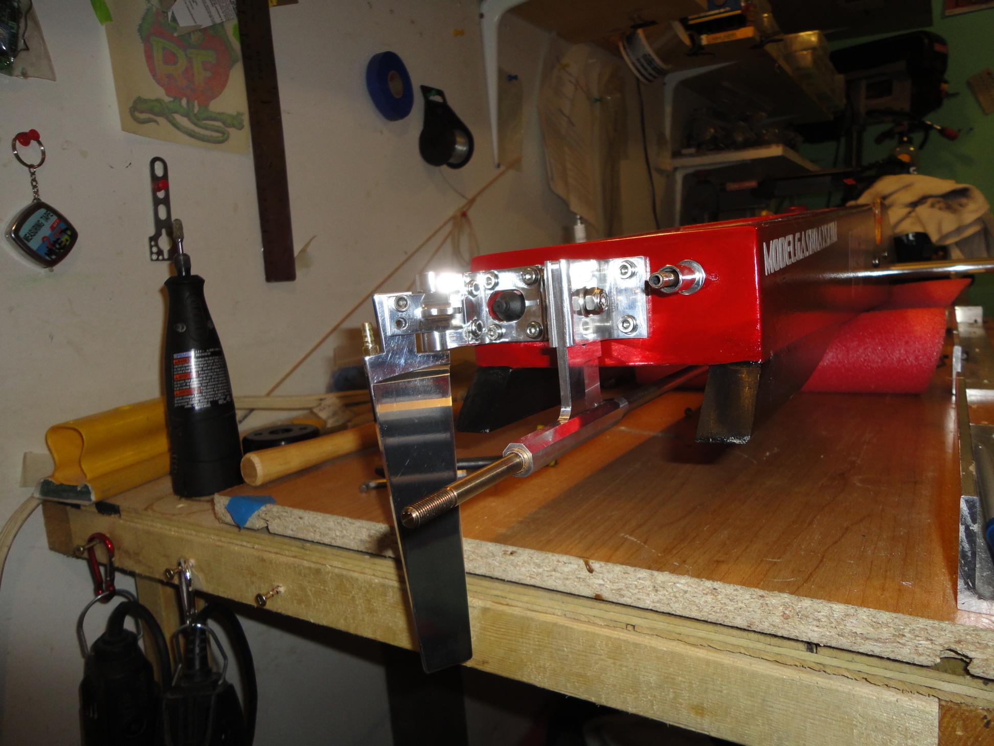

Thanks for the replys guys - I did fit last night - read this again - went back to hobby shop this morning ... new thick wall tube and went full length
I reemed strut to fit better --- still very snug but closer to my other (older SM) hardware == so I went full length and machined a bushing / silver soldered collar on bushing and am a happy camper (ah boater)
I did loctite it so I used everyone's ideas ... thank you

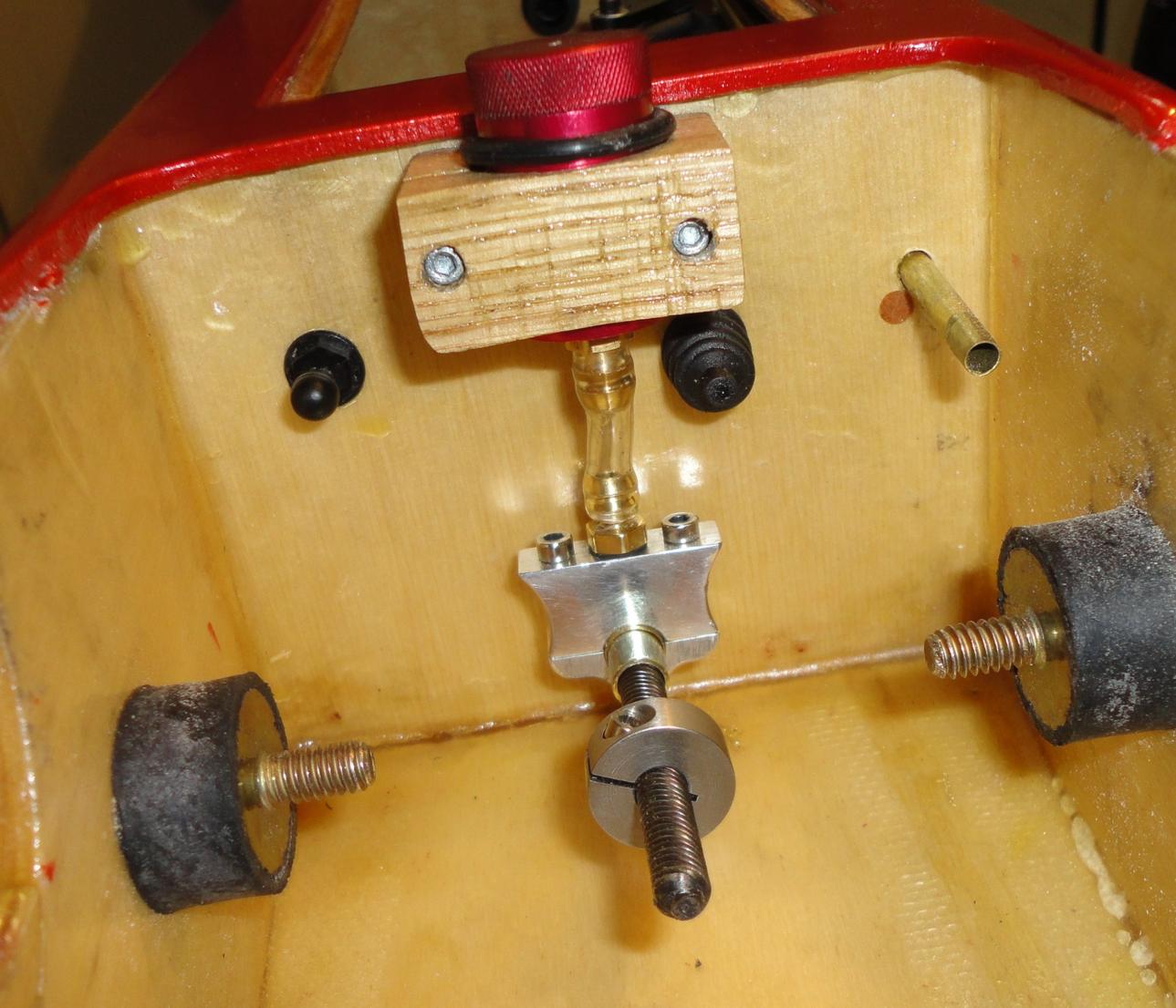

I made up a clamp/oiler (clamps evenly both sides and nice and snug) and drilled small oiler hole to start with - may use grease but wanted oiler stuff there
added alum tank and oak mounts (4/40 inserts mounted before) added switch and rubber grommets for rods (rubber from Dave P in UK - super quality boots)

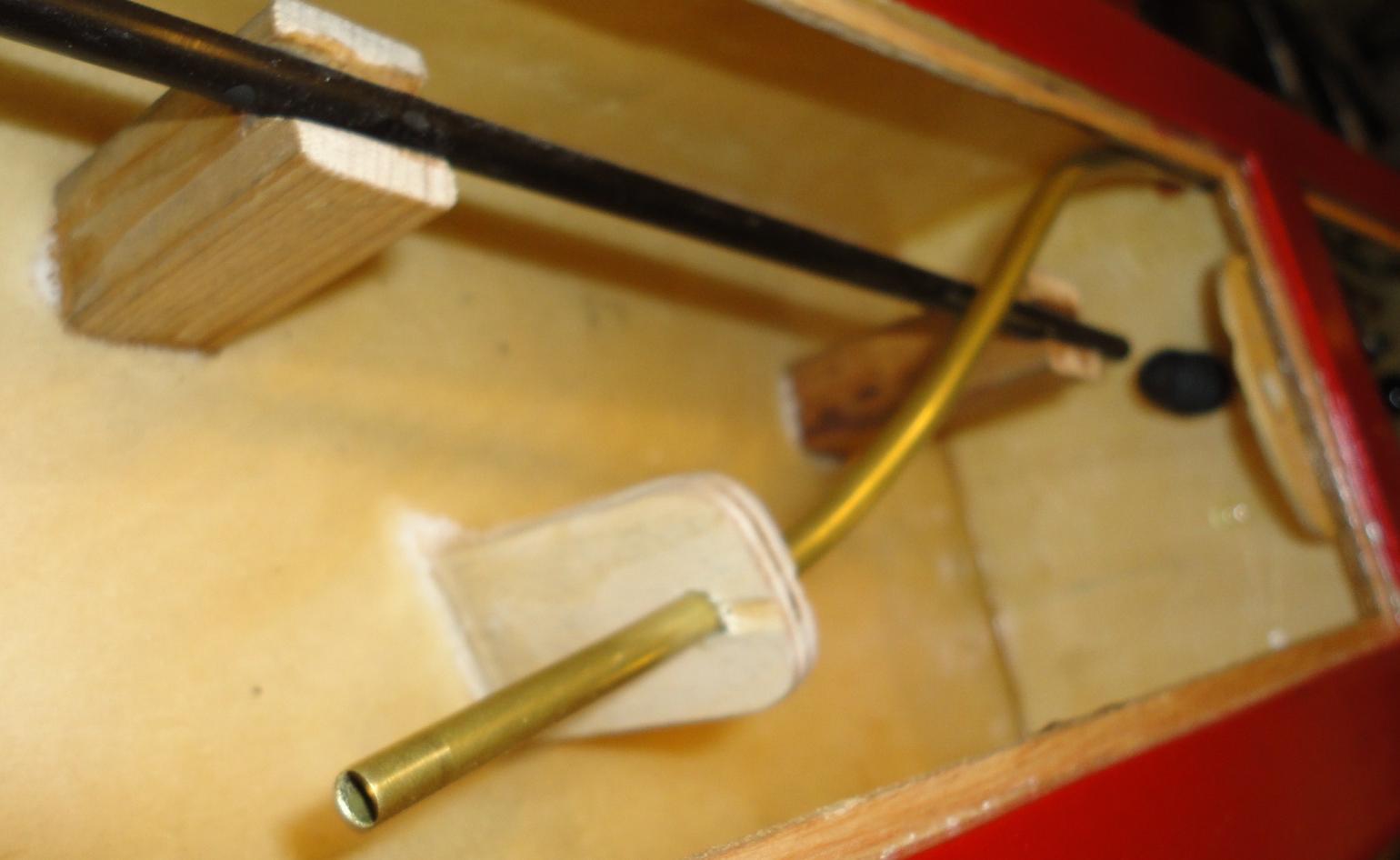

Rudder rod has carbon fiber support I'll glass in later today with water line support

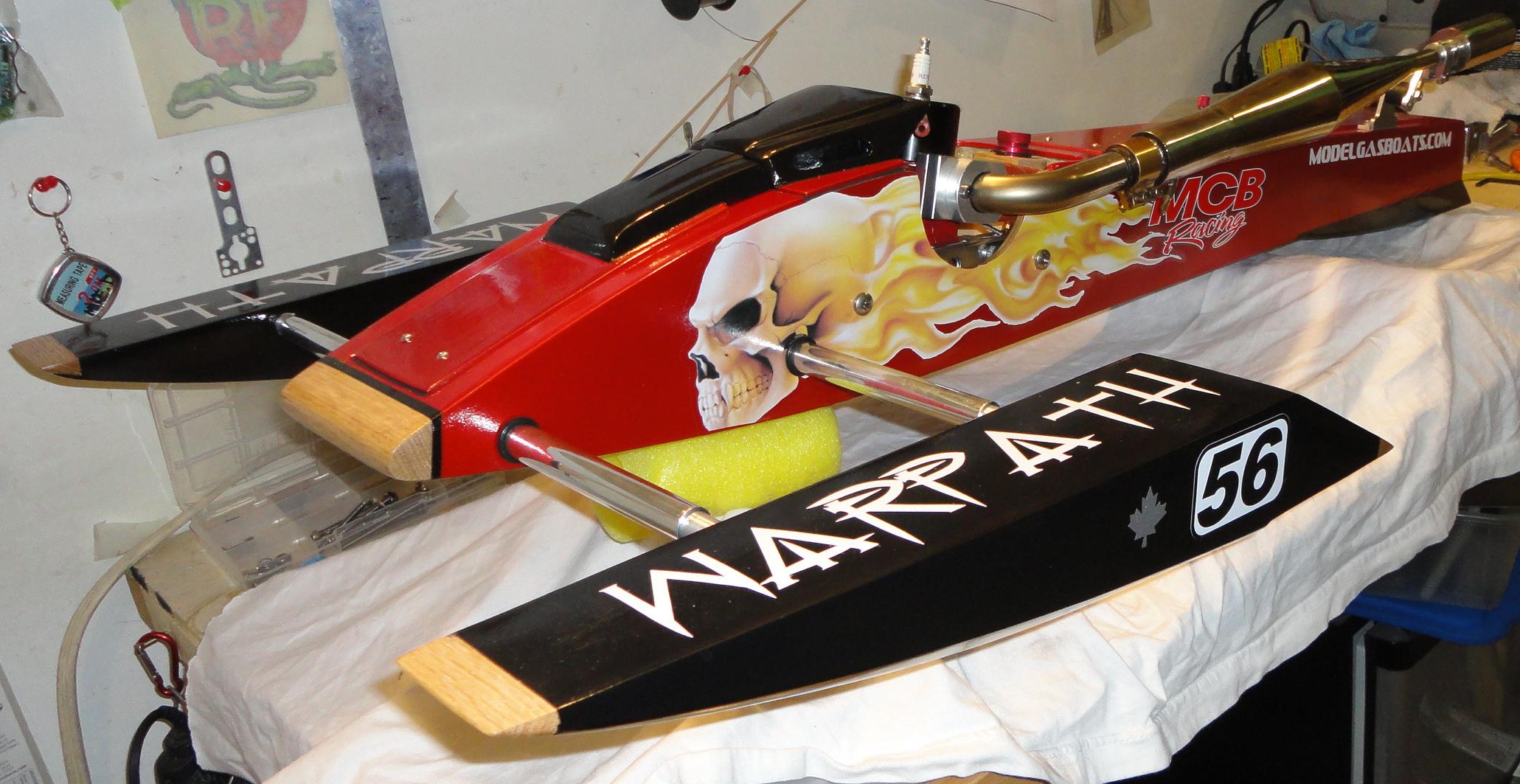

Need to do some detail but gives you general idea
#17756
Woodie replied the topic: Re: My Warpath
WOW! That is one mean looking Warpath Rigger!
Great finish! I love the flaming skull with the "MGB Racing". Where did you get/buy that?
#17757
Canadian Hot Rod RC Boats replied the topic: Re: My Warpath
Lol Thanks Woodie
I;ll fill in some details tomorrow
Look again ........
MCB not MGB ......
MCB = Misty Creek Boats .... www.youtube.com/user/mistycree...ts?feature=mhee
:laugh: That's me
The ModelGasBoats.com came with my kit ...... :blink:
maybe my other boat is better --- same decal just bigger

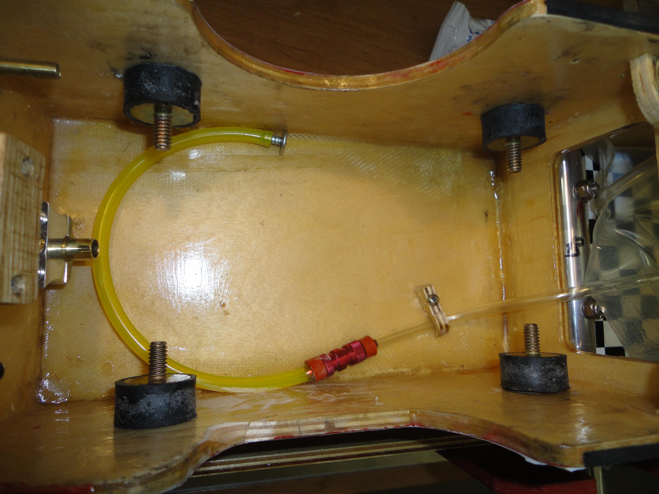

Stormy weather and missing gaskets stopped from running last weekend
I did work on some other parts

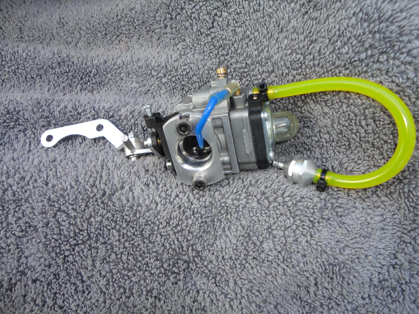

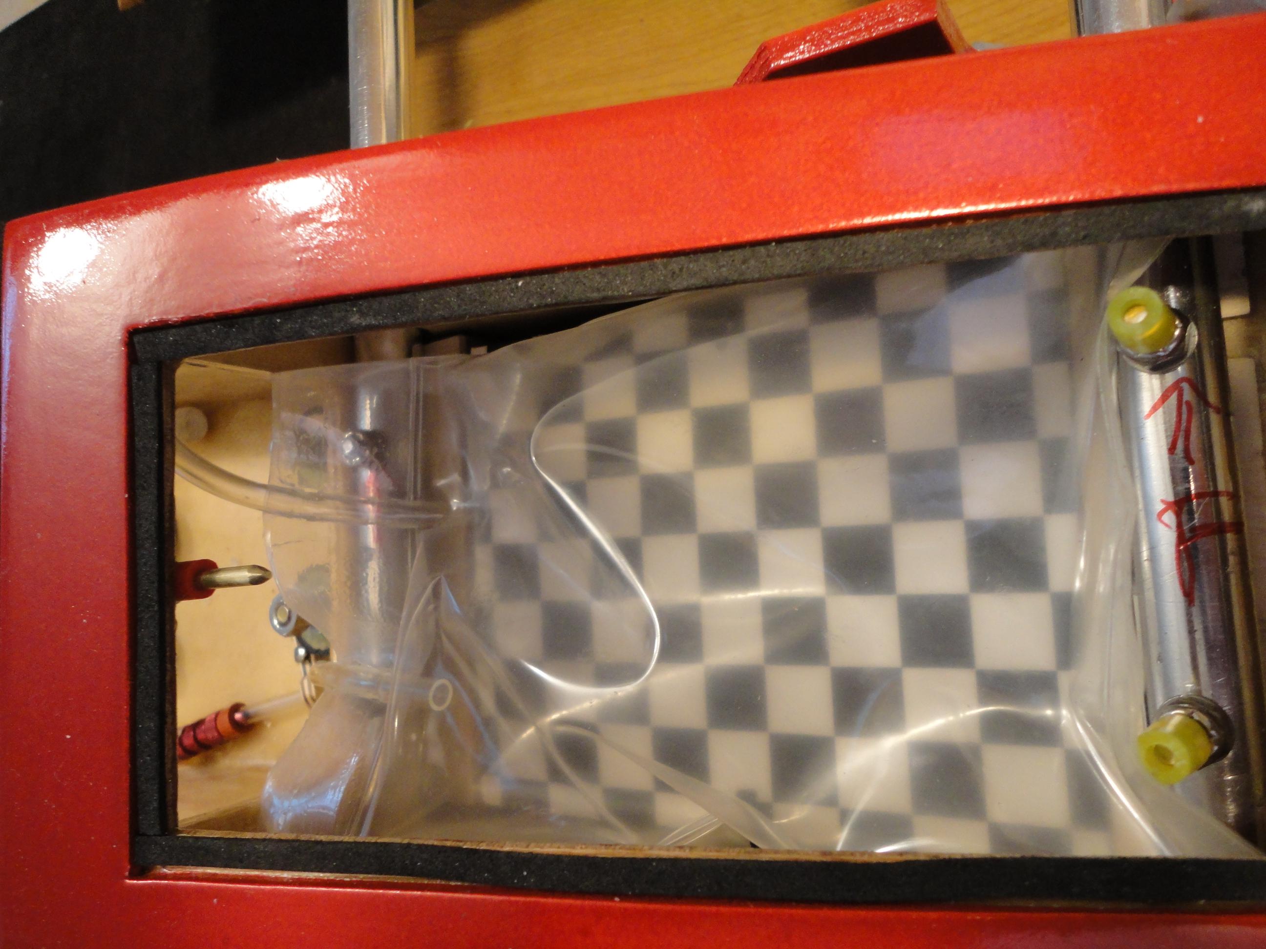

added Buck bag (my favorite item now - thanks Scott I'm hooked)
Fuel line and filter
Finished servo box except thottle linkage
few pics

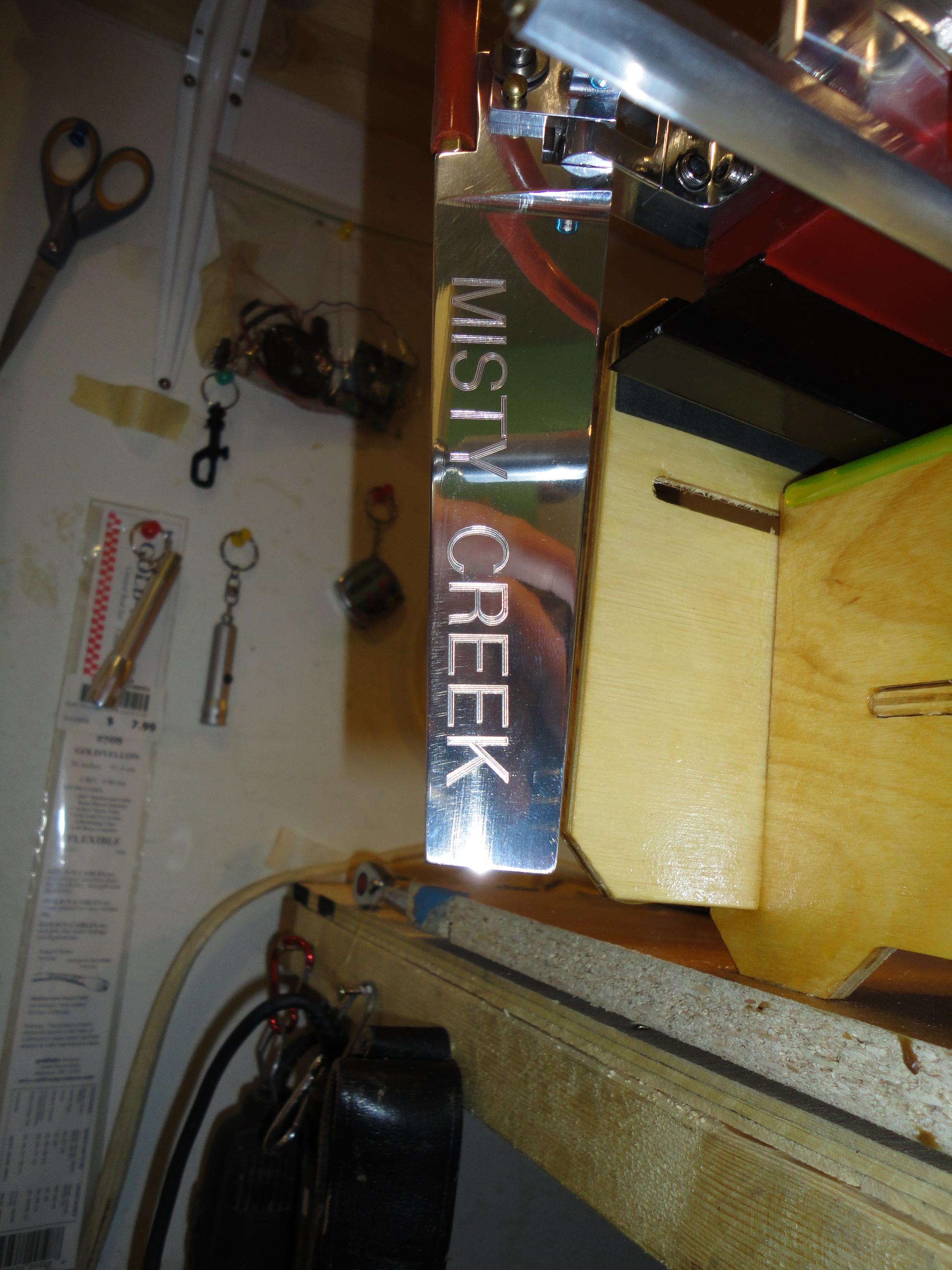

did some Laser work on Rudder ..........
