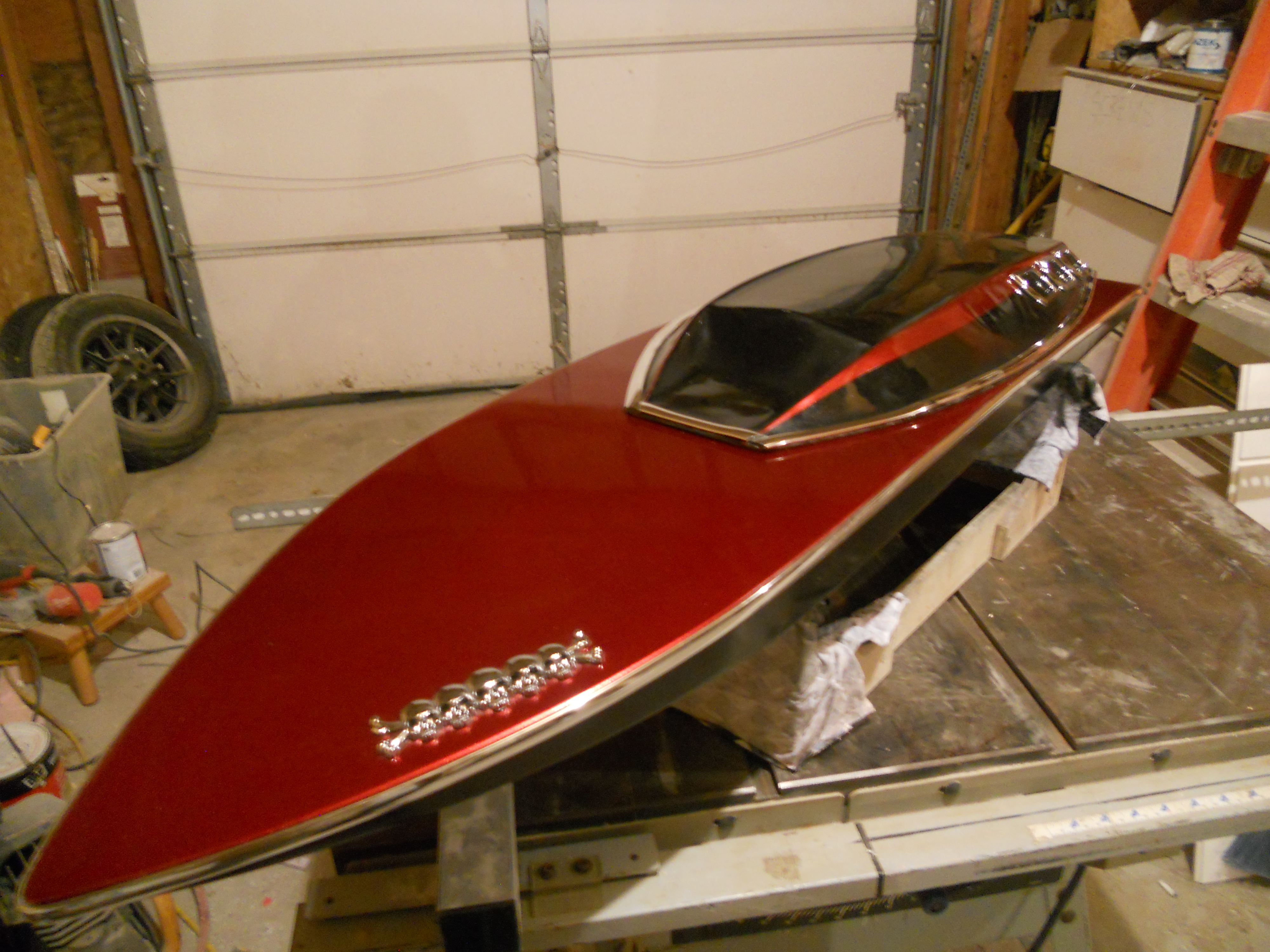

jmat975 replied the topic: Re: New to boating
Ok. I took a few pics if this will help at all. The boat is just over 48" long and has a 13" beam.
