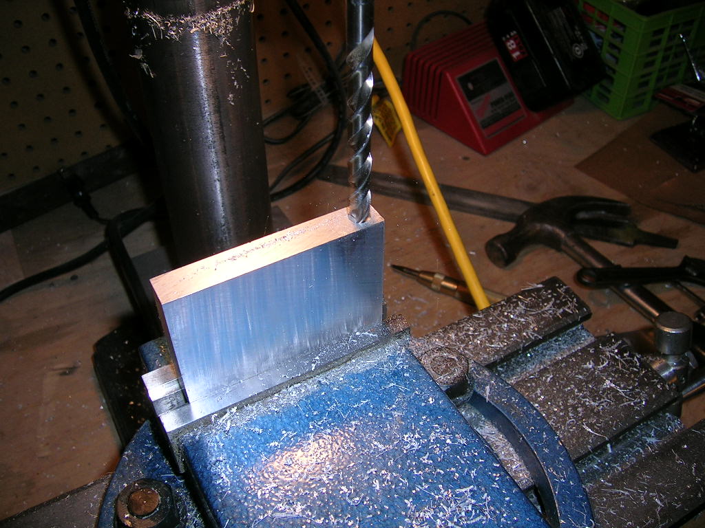

marc replied the topic: Re:Homemade Strut
Hole drilled in for stuffing tube.

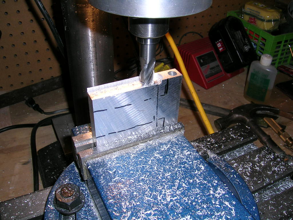

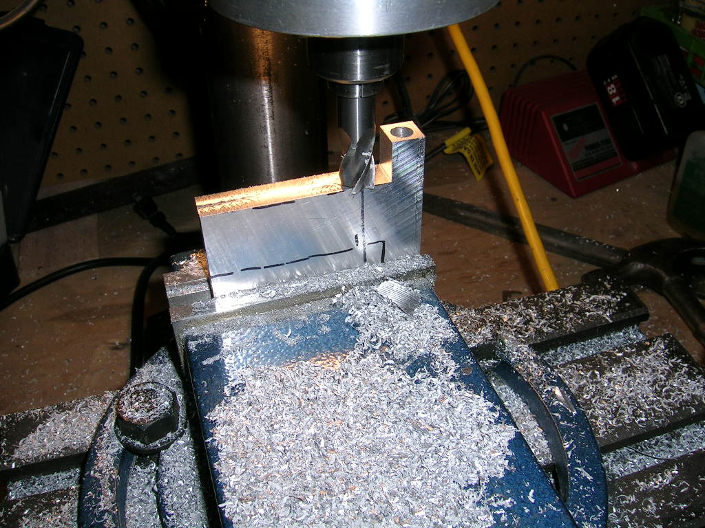

Starting the rough material removal. I sketched a VERY rough outline of the strut profile on the block of aluminum. :)
#7989
Another pic.

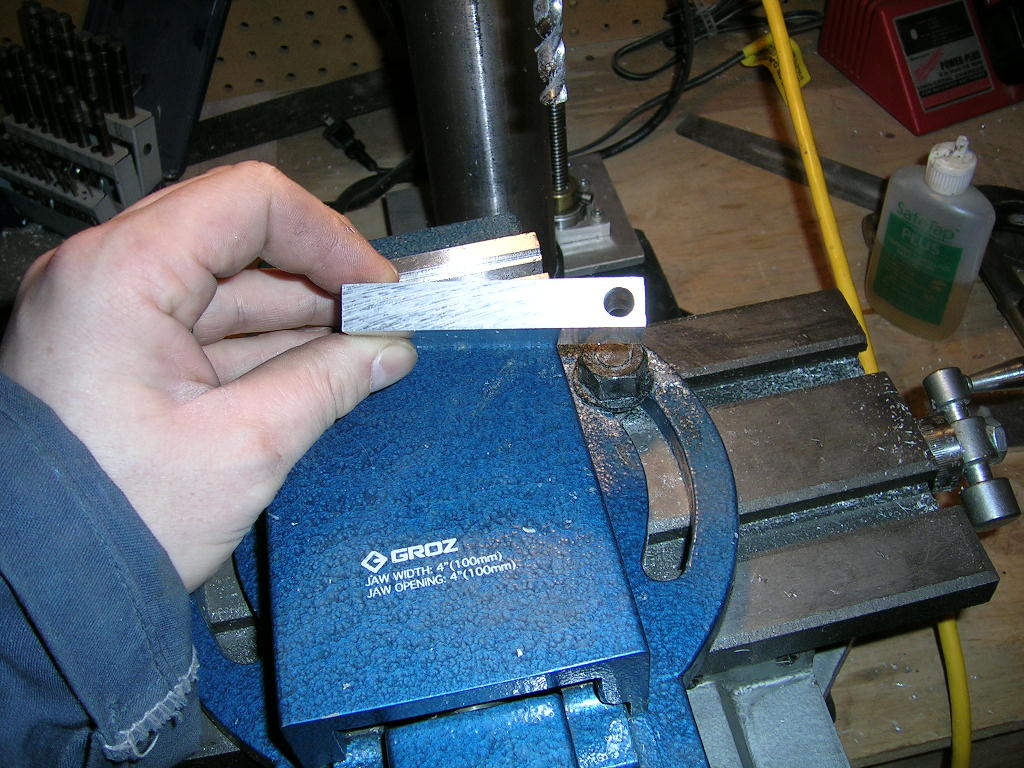

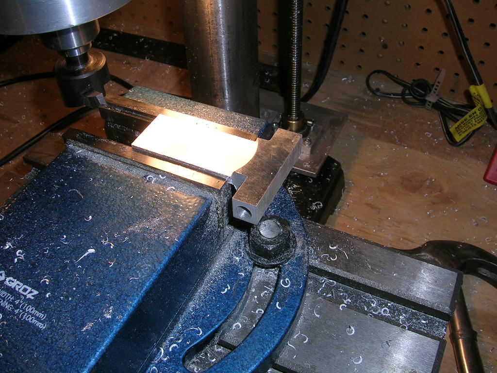

Used a flycutter to thin the blade section down.
#7991

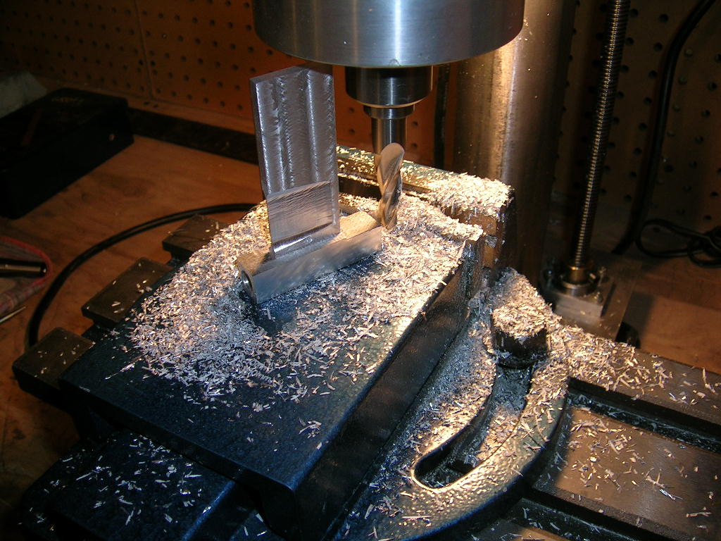

Finished squaring off the blade section with an endmill.
#7992

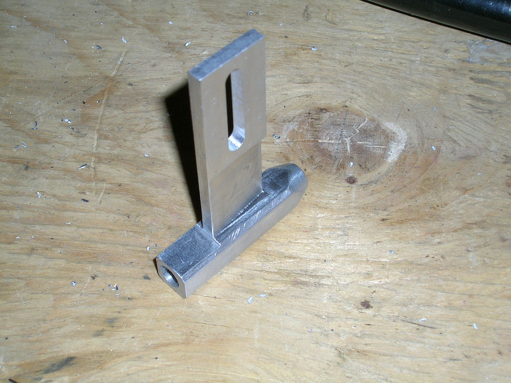

I used a tapered end mill to sharpen the blade area.
#7993

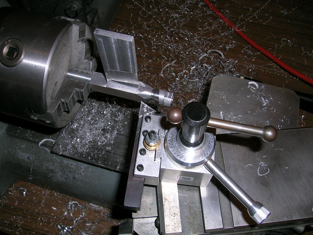

Made a little mandrel (actually just a shaft, spacer and nut) to hold the strut in the lathe and spin it on it's axis to machine the front cone section.
