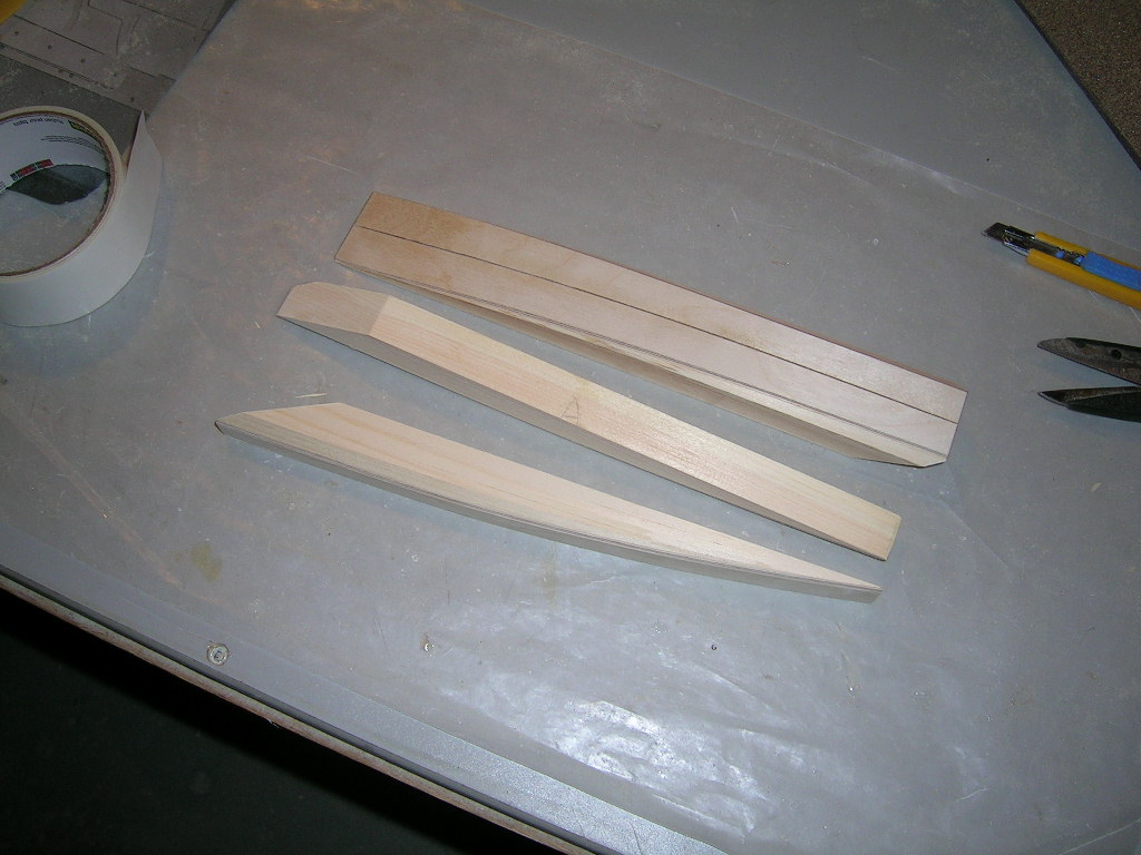

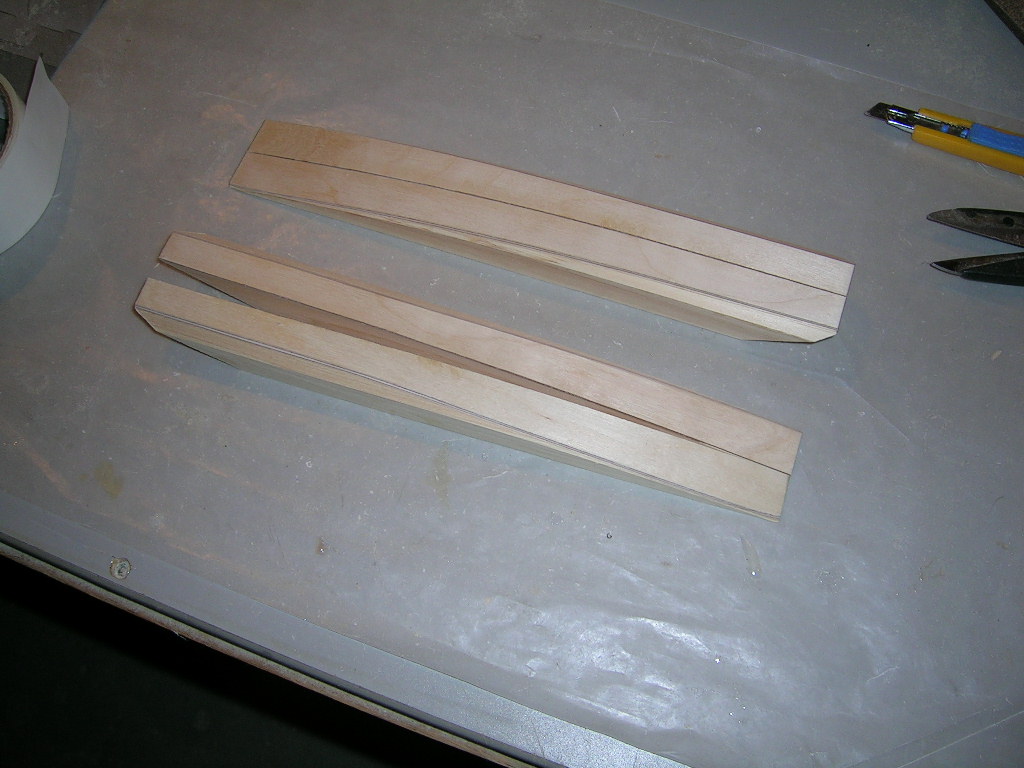

Getting some rear shoes ready. They are CNC cut from solid pine and lined with 1/16" Finnish birch on the ride surface. Final shaping done by hand.

Mounting rear shoes to the tub.

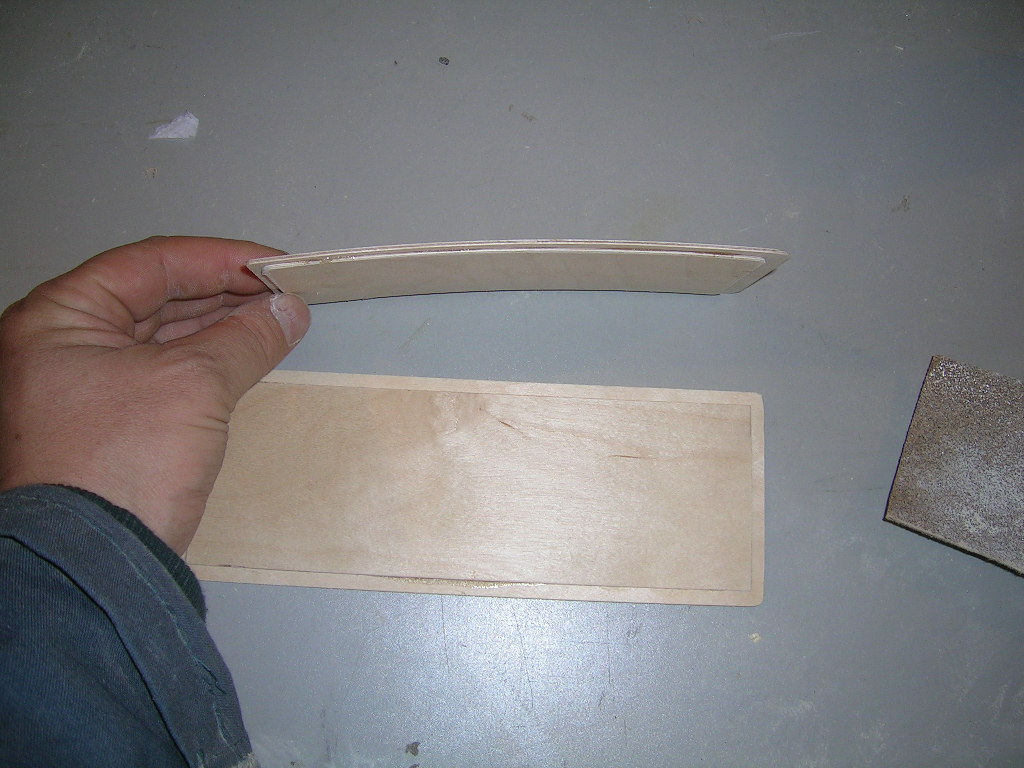

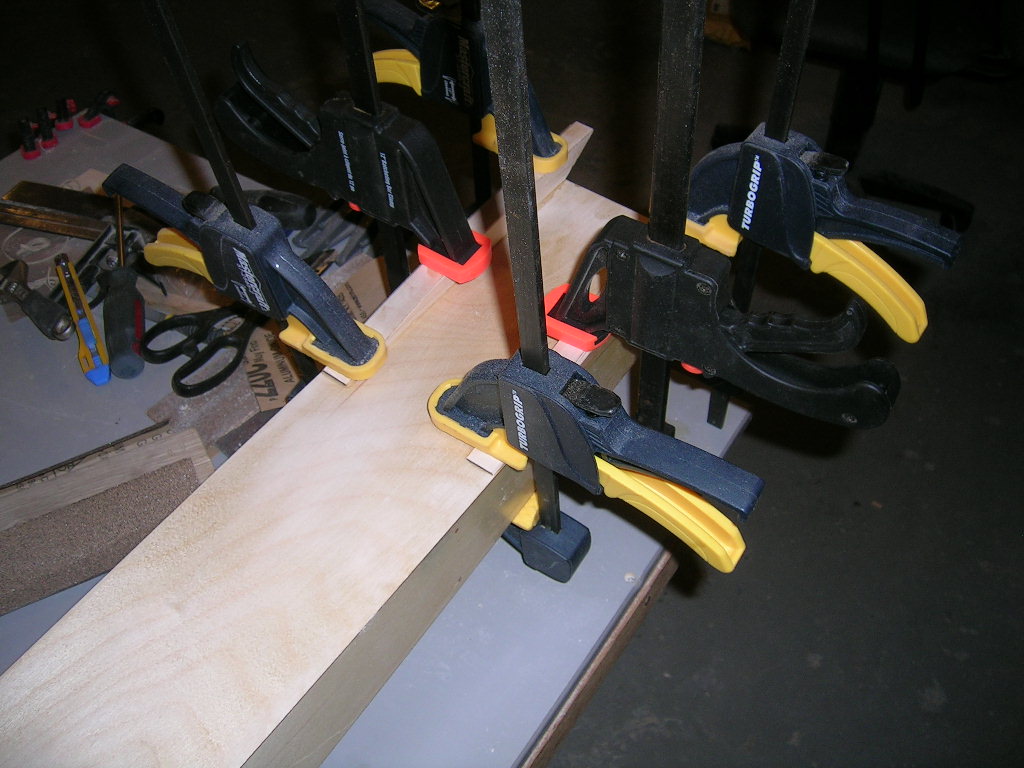

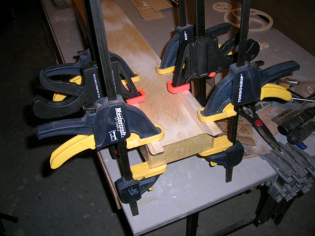

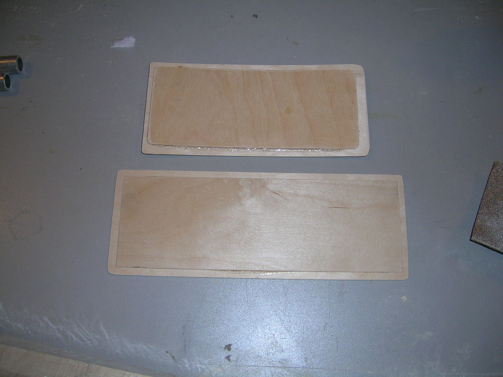

Doubling up the access covers. Notice the front one is curved to fit the shape of the front of the tub. This is pretty easy to do, just keep it slightly bent as the glue between the two layers cures. The doubler used for this cover is the one that's cut cross-grain. It's easy to tell the difference, not only by looking at it, but also by the fact that it bends a lot easier than the pieces that are cut along the length of the grain.
For the flat covers, install the doubler so the grain is opposite to the cover piece. This will make them work against one another and keep the cover straighter.
