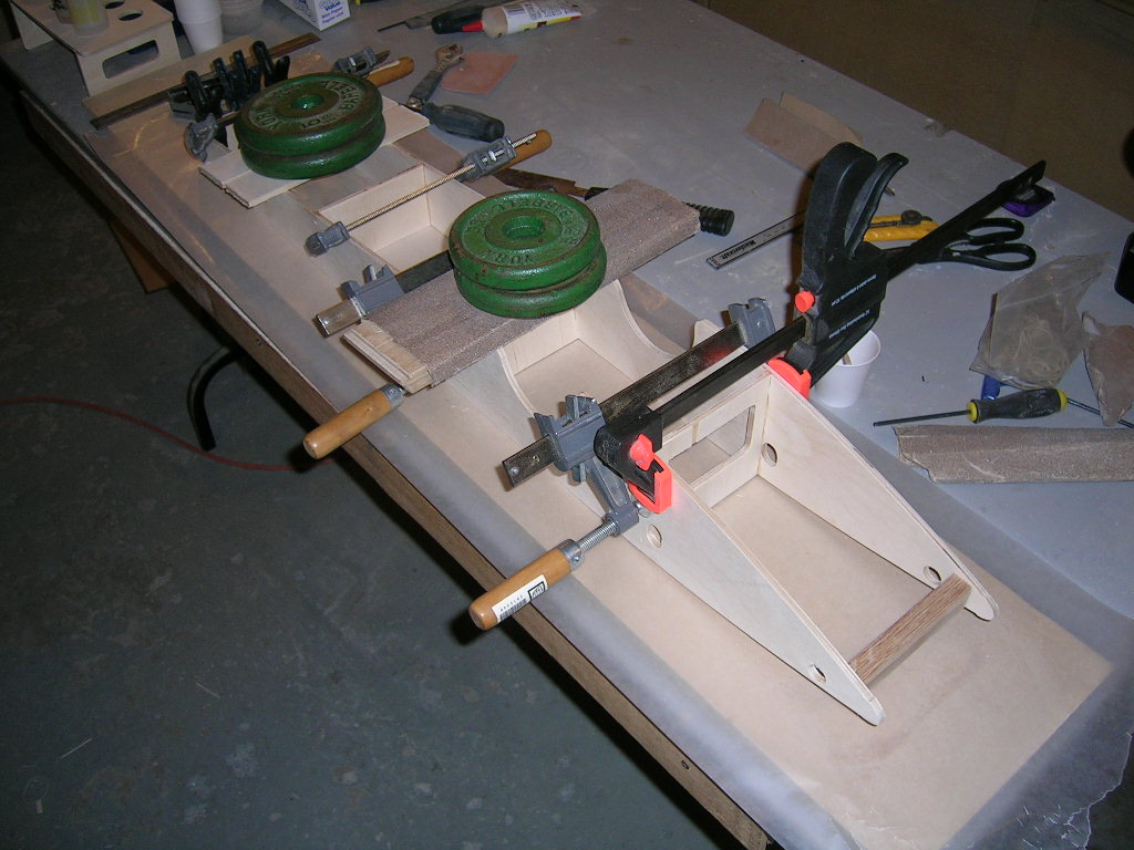

Gluing bulkheads in between tub sides.

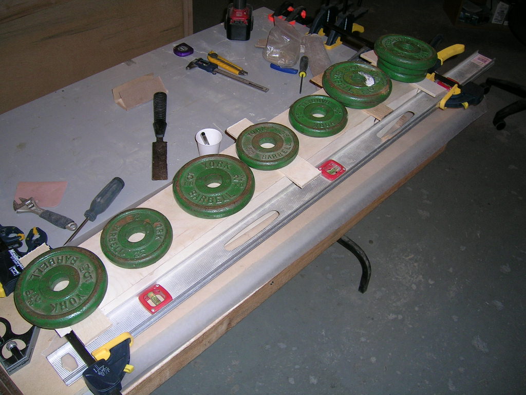

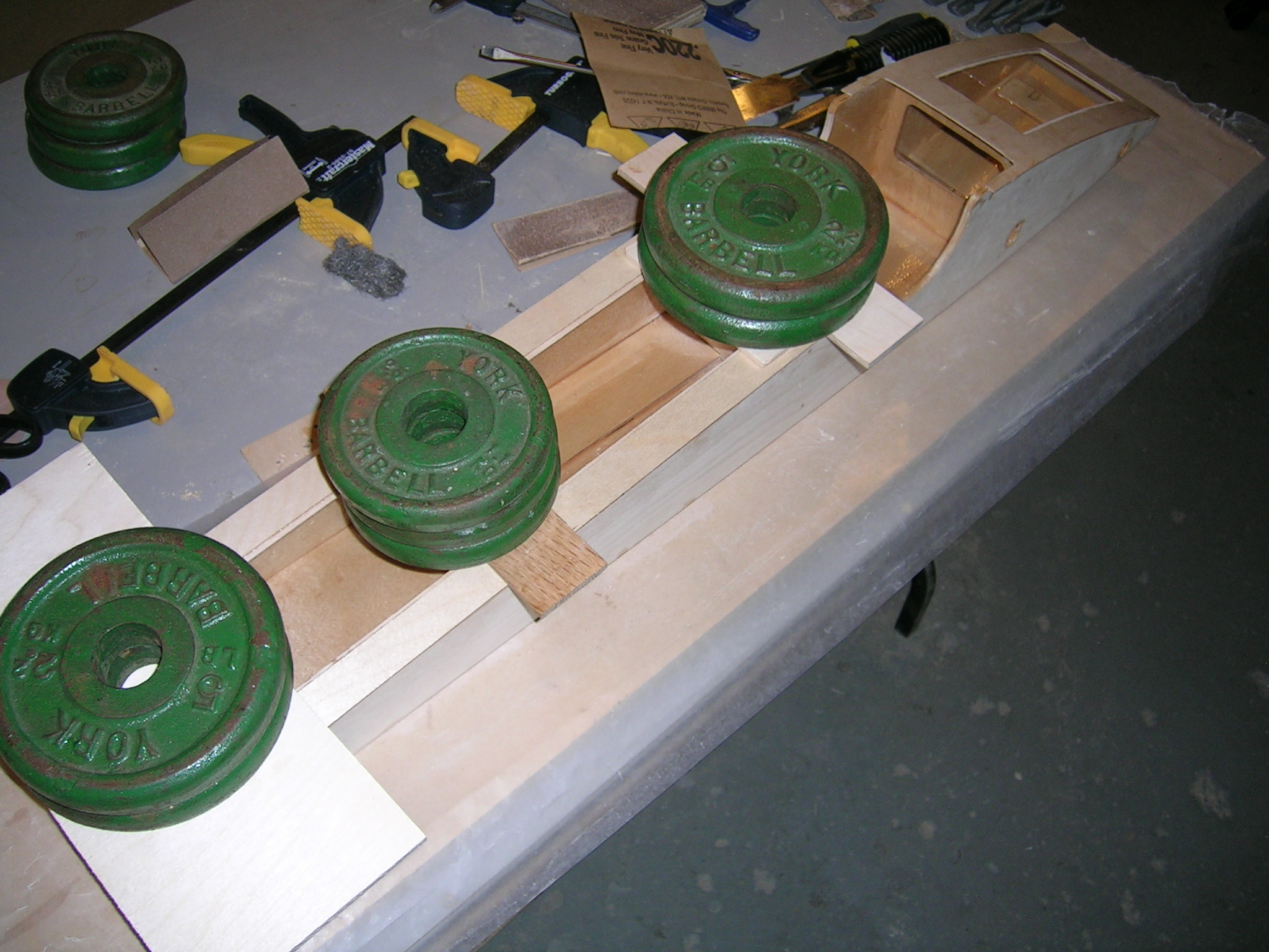

Gluing bottom sheeting to tub frame. Notice the sraight edge clamped to side to keep everything straight.

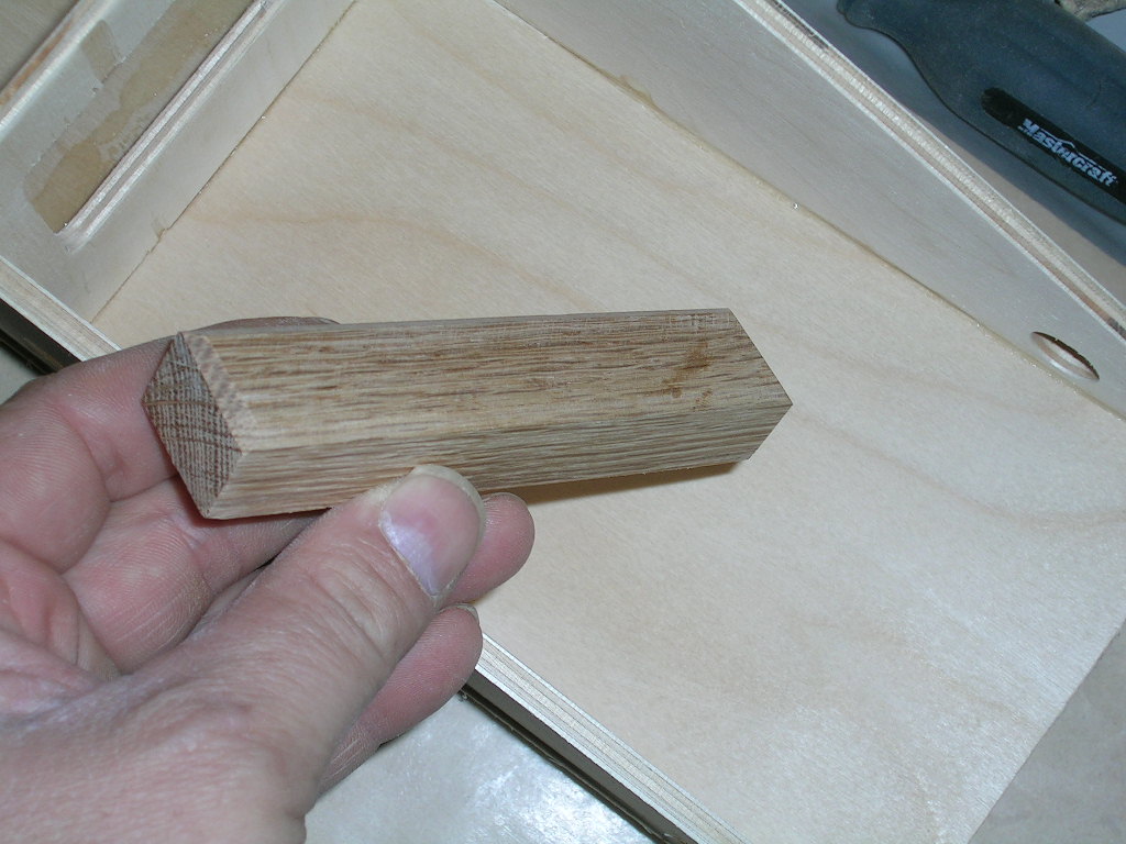

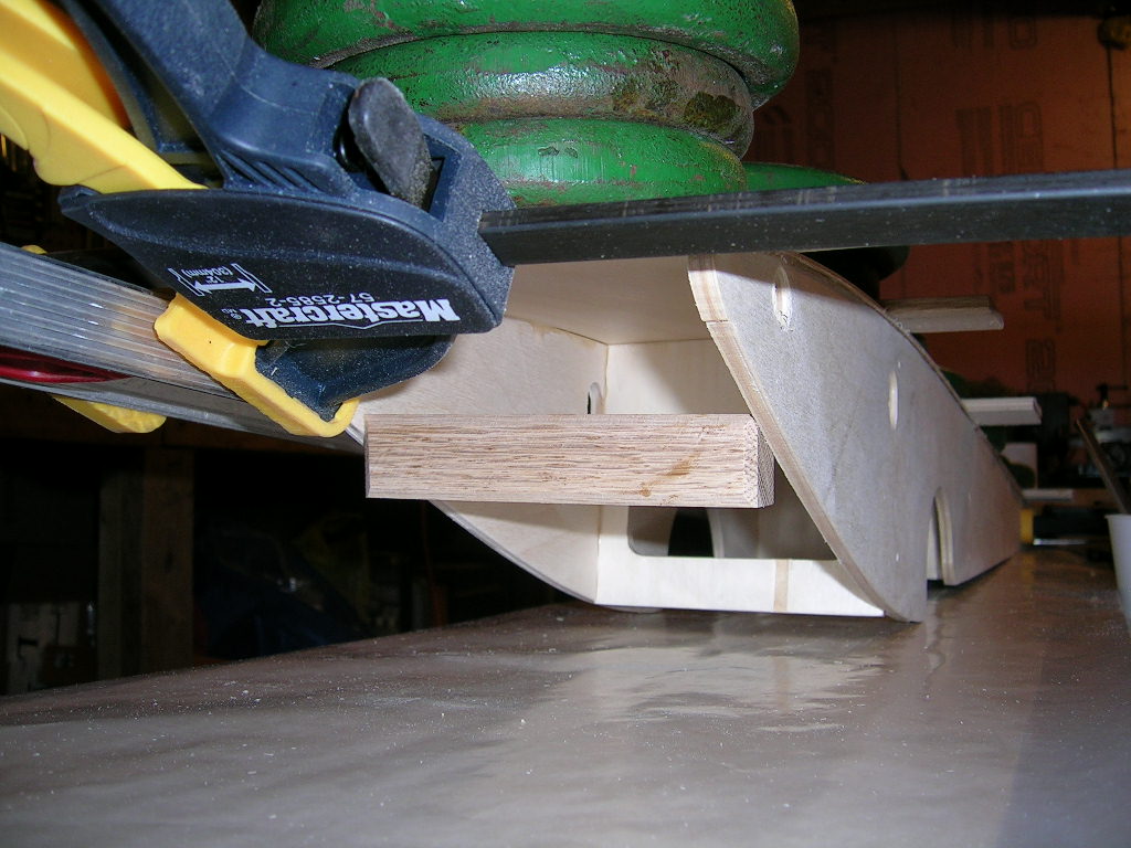

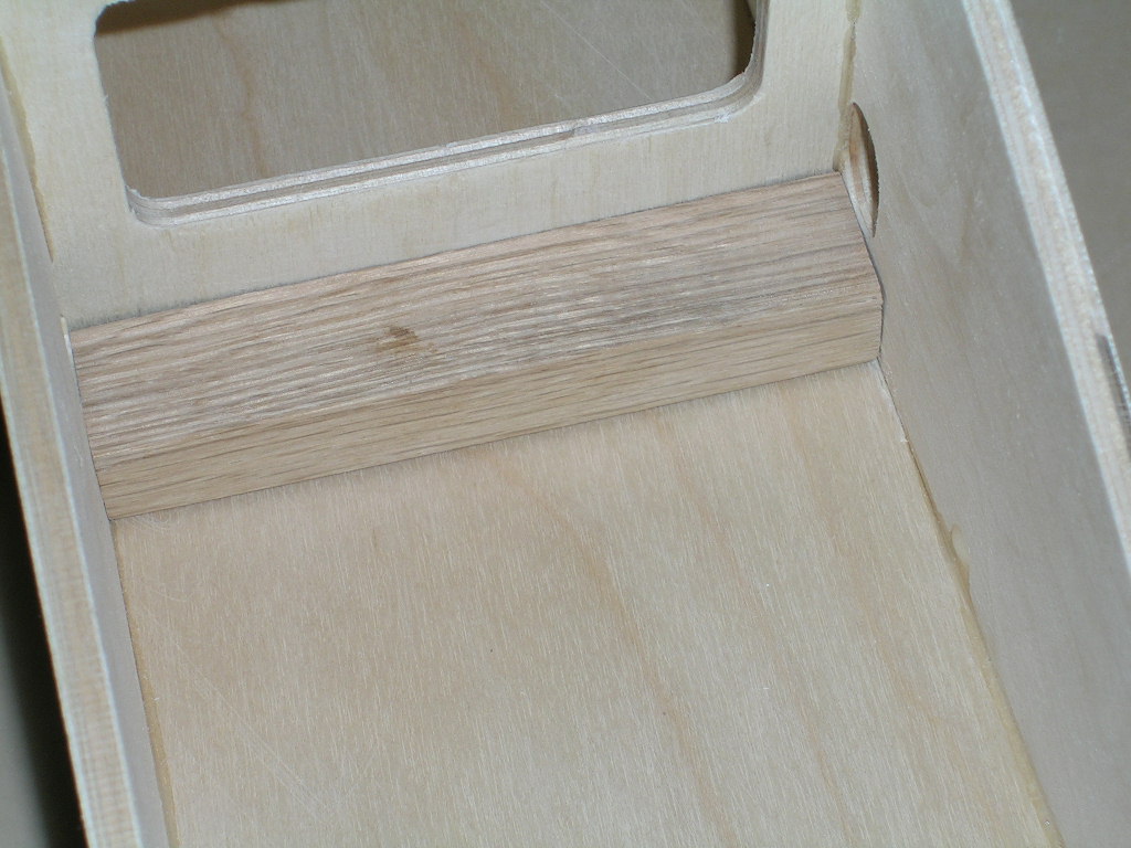

This picture just shows the 4.5" oak block used as a spacer at the front while installing the sheeting to ensure proper spacing of the sides at the front. This block is actually the block that will support the rear boom tube later on, so it's NOT glued in at this point! The reason I'm using a temporary spacer block here is because I'm doing the nose of this tub differently, and will use the full width nosepiece instead of 4.5" sandwiched between sides. It will be installed later on.

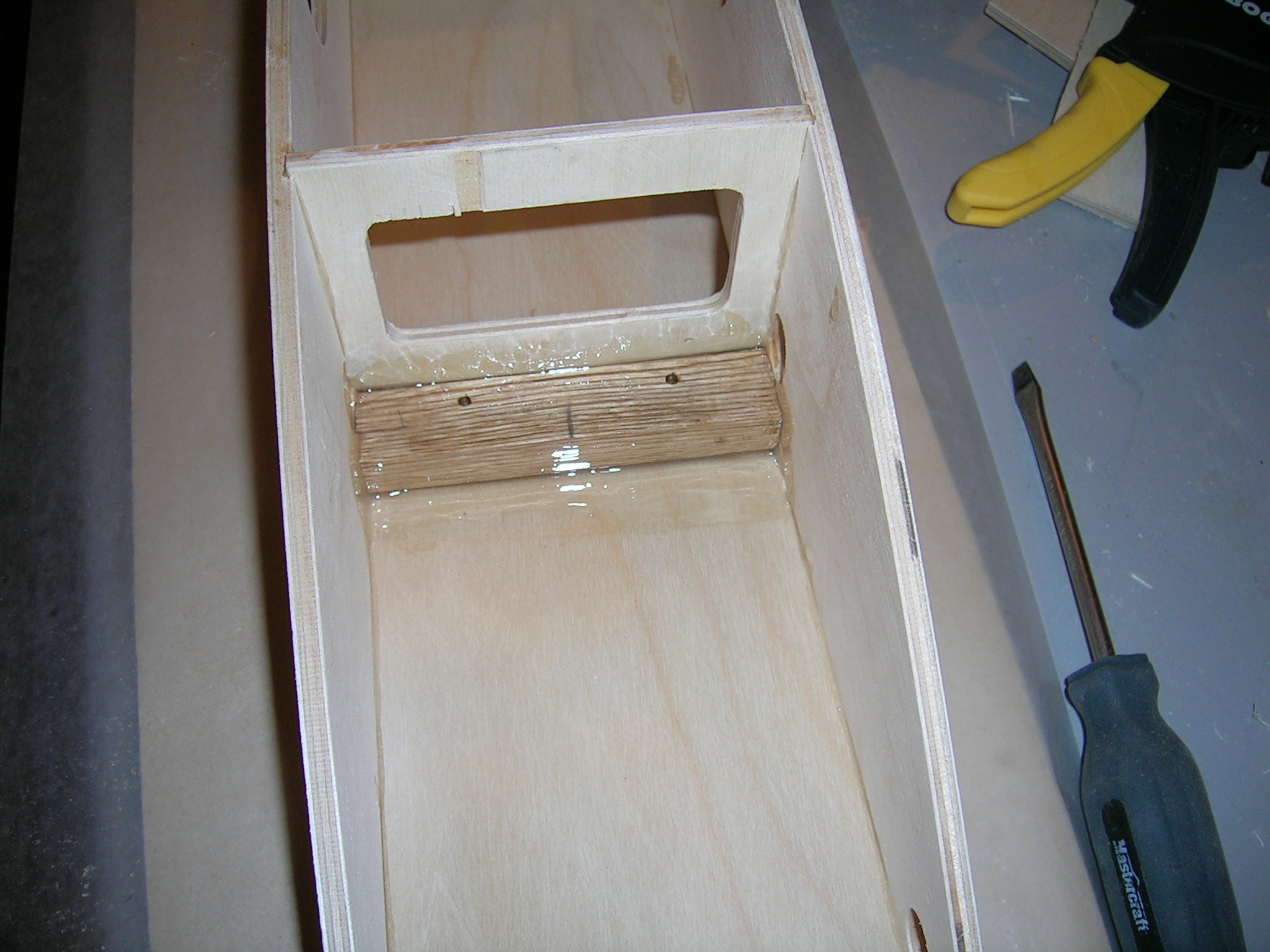

Now the 4.5" piece of oak actually gets installed where it really goes, to support the rear boom tube. Notice the bevelled bottom edges. This is to make room for a nice epoxy fillet when you push the piece flat into position. So any excess epoxy will fill this bevel...a little bit of extra glue isn't a bad thing here! :)
Test fit before actual gluing.

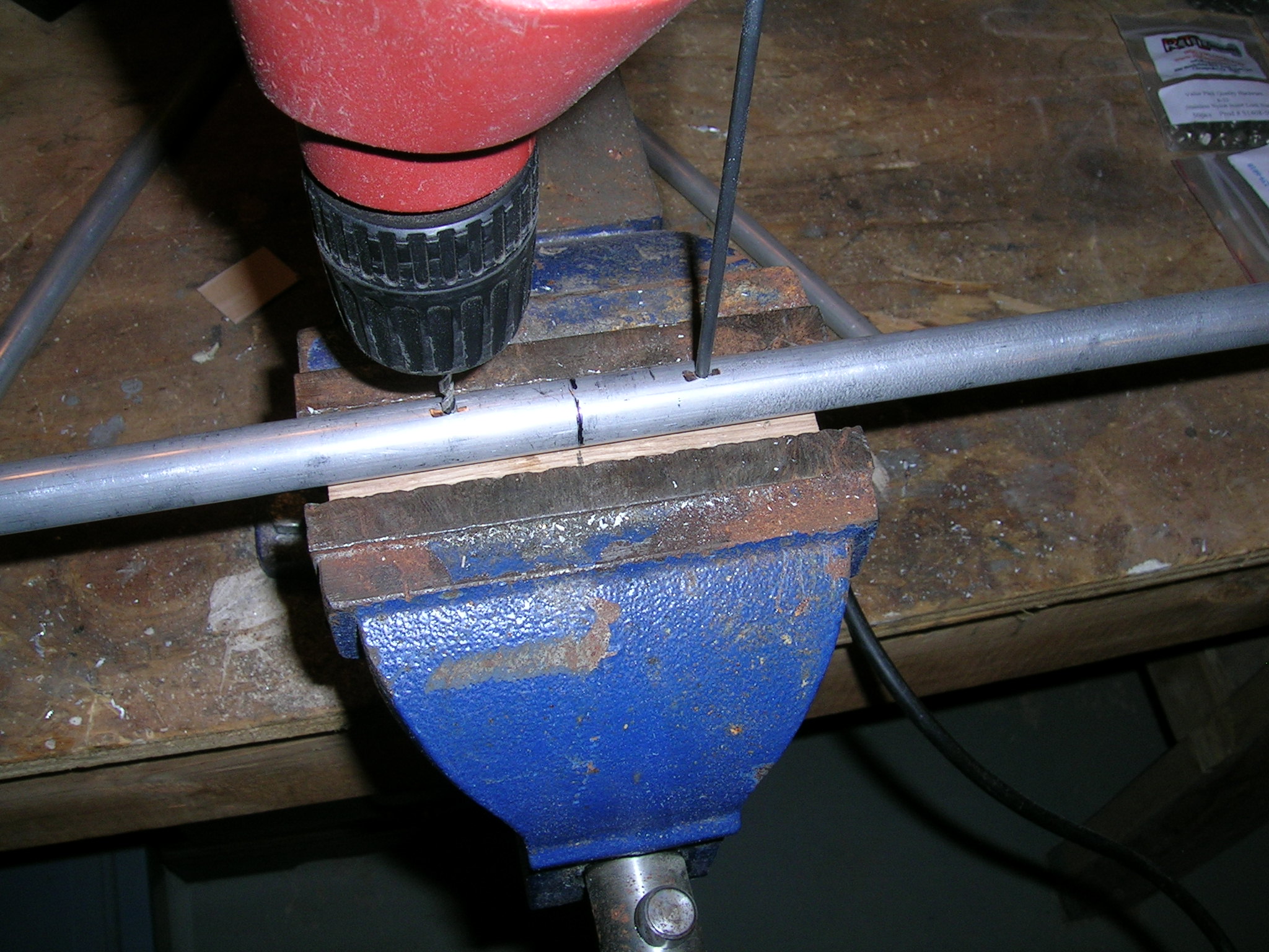

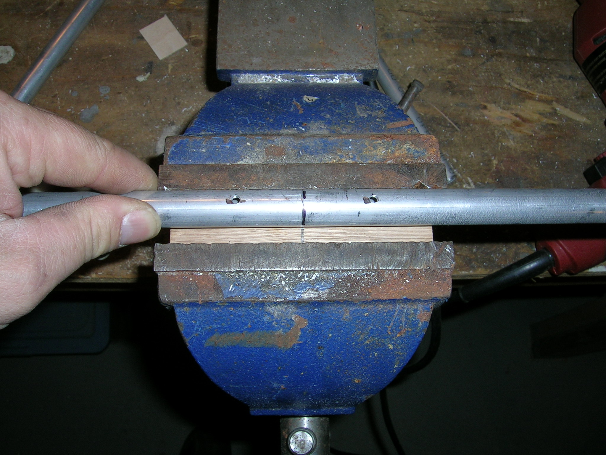

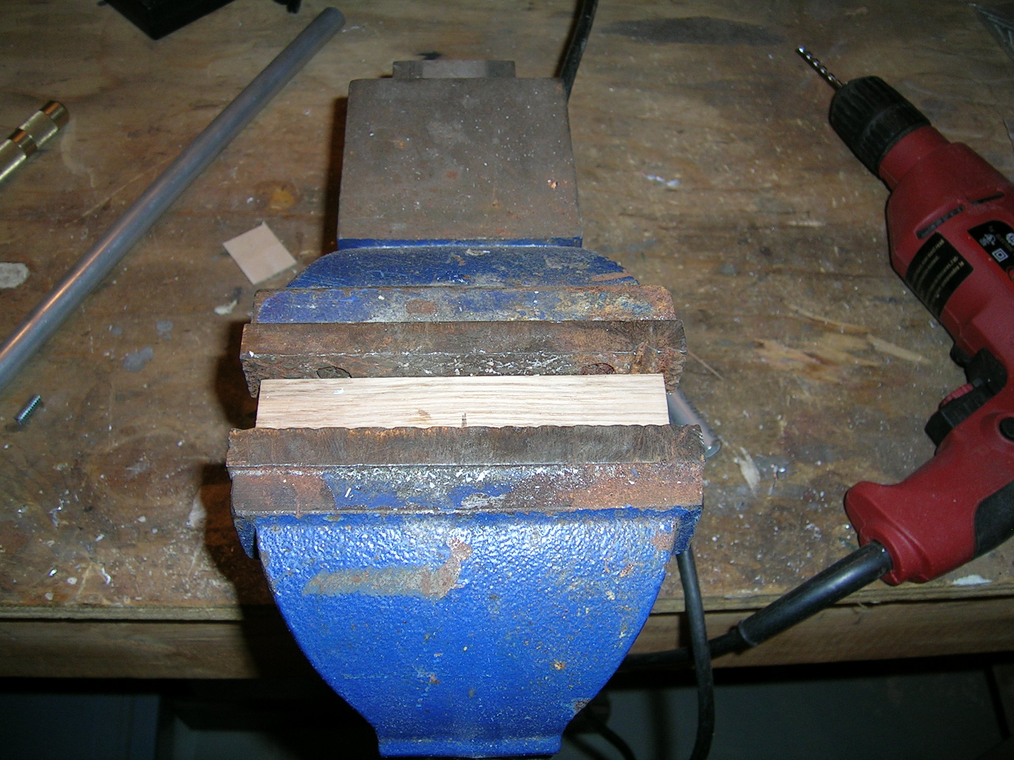

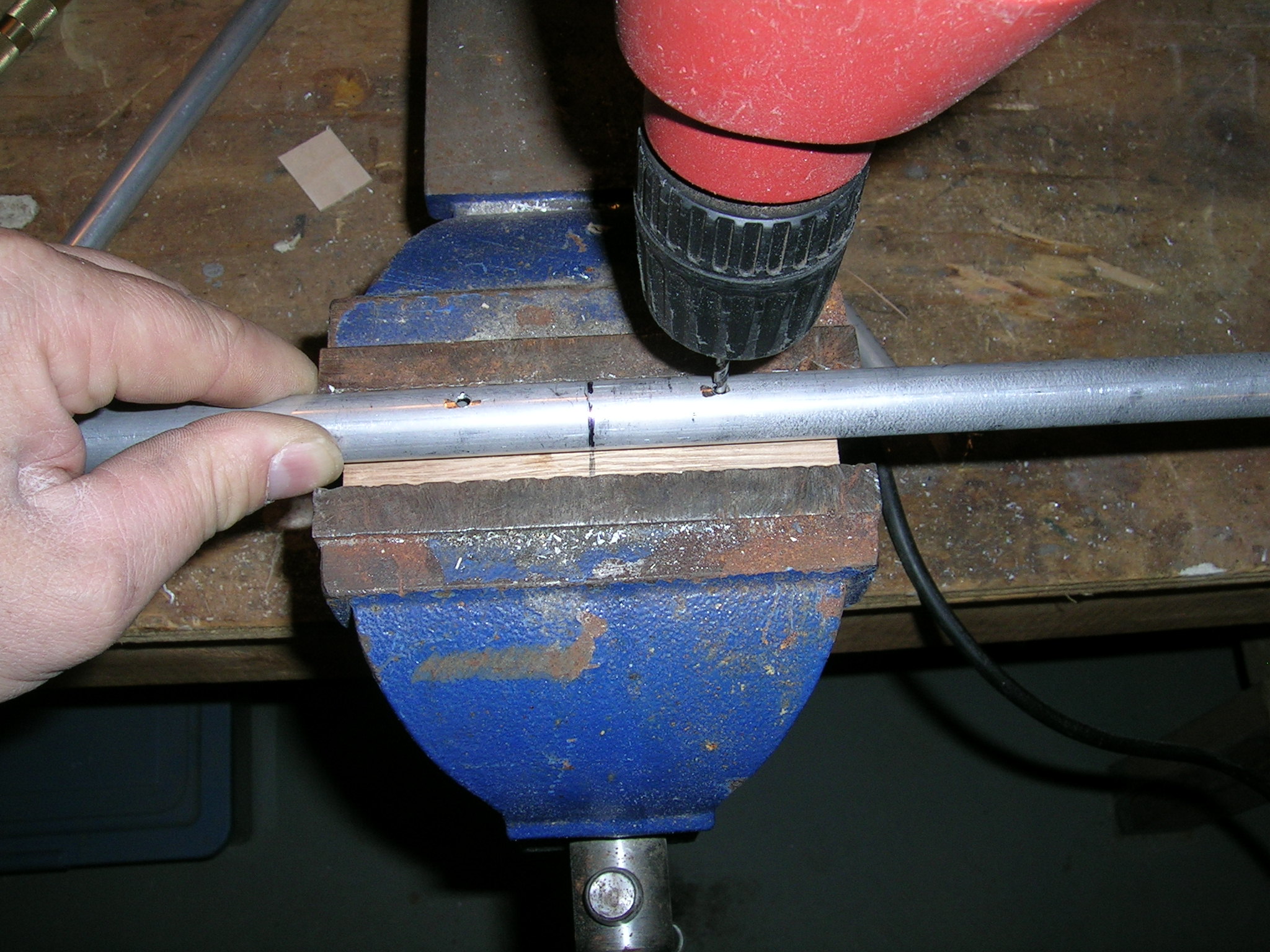

You can pre-drill the block for the screws before putting it into the tub. Here's how I do it. Set the block (bevelled edge down) deep into the vise. Mark the center of the block. Take boom tube. Mark center and drill 1/8" pilot holes in tube then line up center marks of tube and block and transfer 1/8" holes into the block. Doing it now before installing in the hull, you don't have to worry about drilling through the bottom of the tub! :)
Block glued into final position.

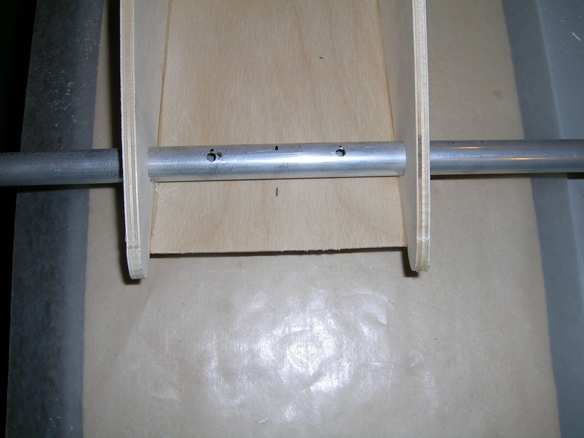

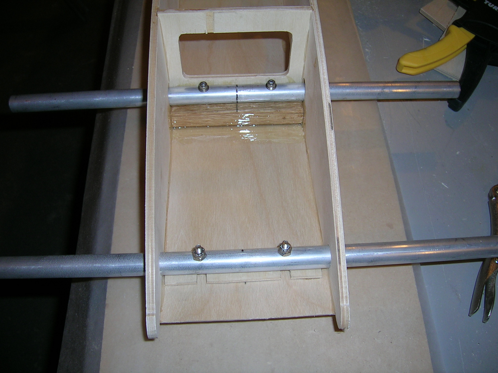

Front boom tube installation. Center marked on tube and tub bottom. 5/32 holes drilled in tube. 8-32 bolts used to mount. Supplied 1/8" spacer shim glued between tube and tub bottom to prevent flex of thin ply bottom. The sides are actually doing all the hard work of holding the tube.

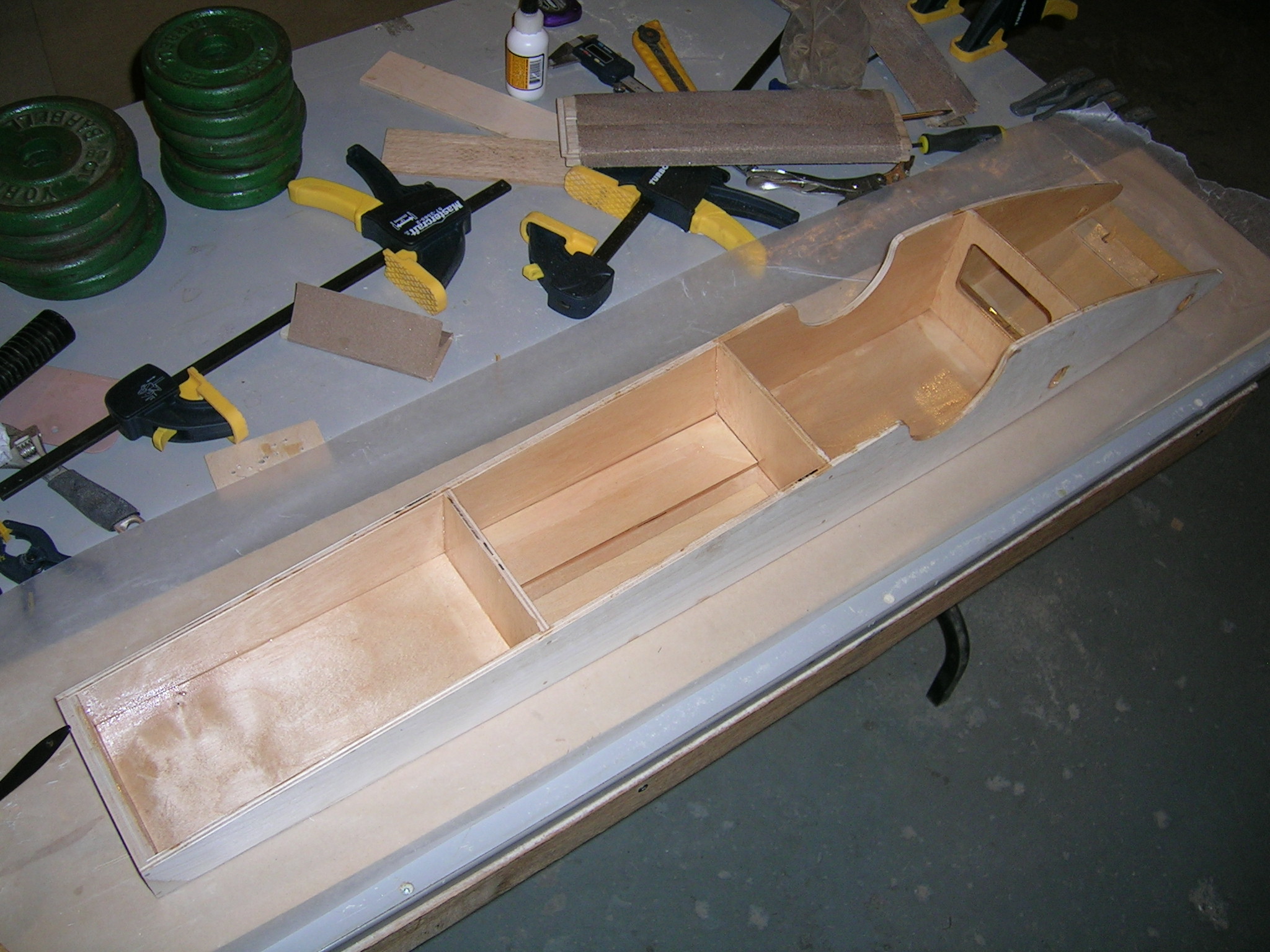

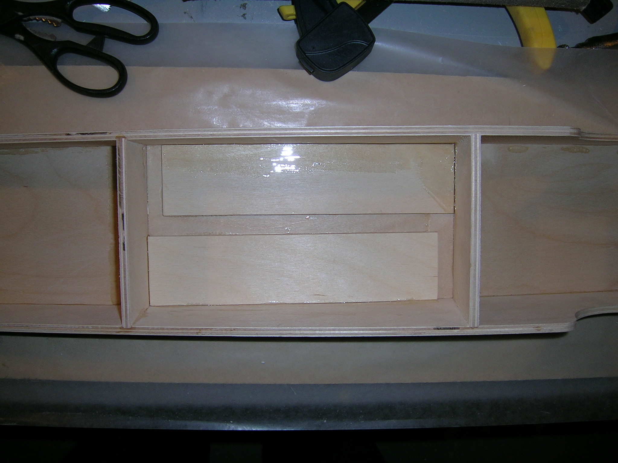

Gluing in the radio box doublers in the bottom. These are 1/4" ply making is easy to mount servo brackets to.

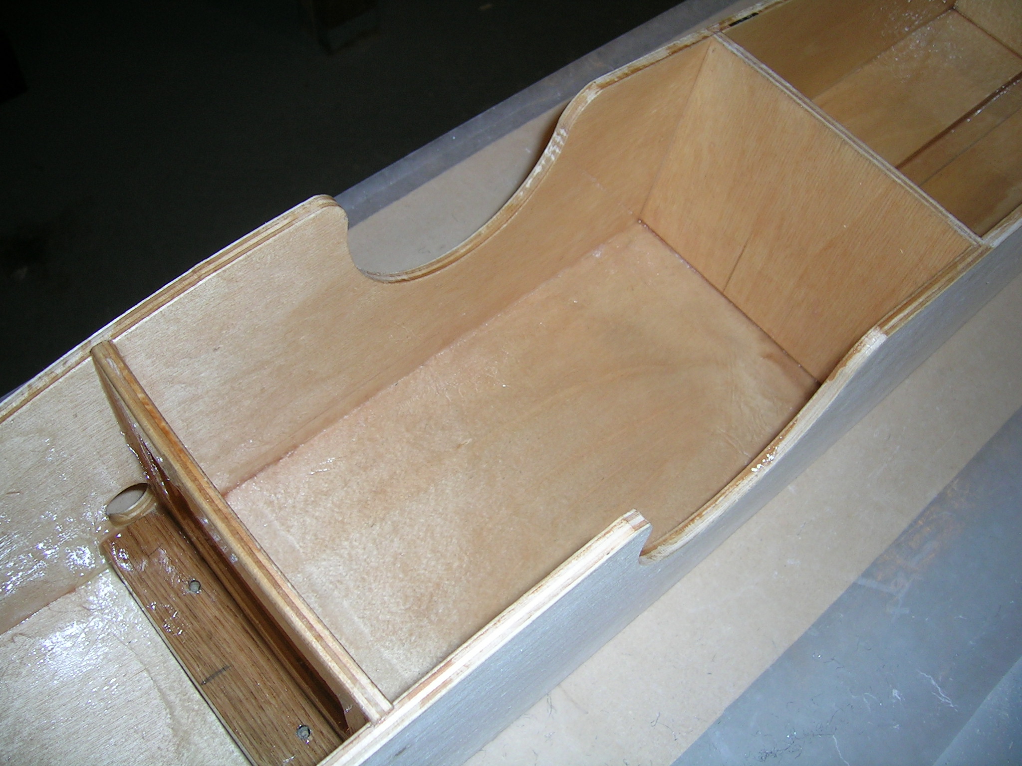

Entire inside of tub sealed (1rst coat) with West Systems Epoxy.

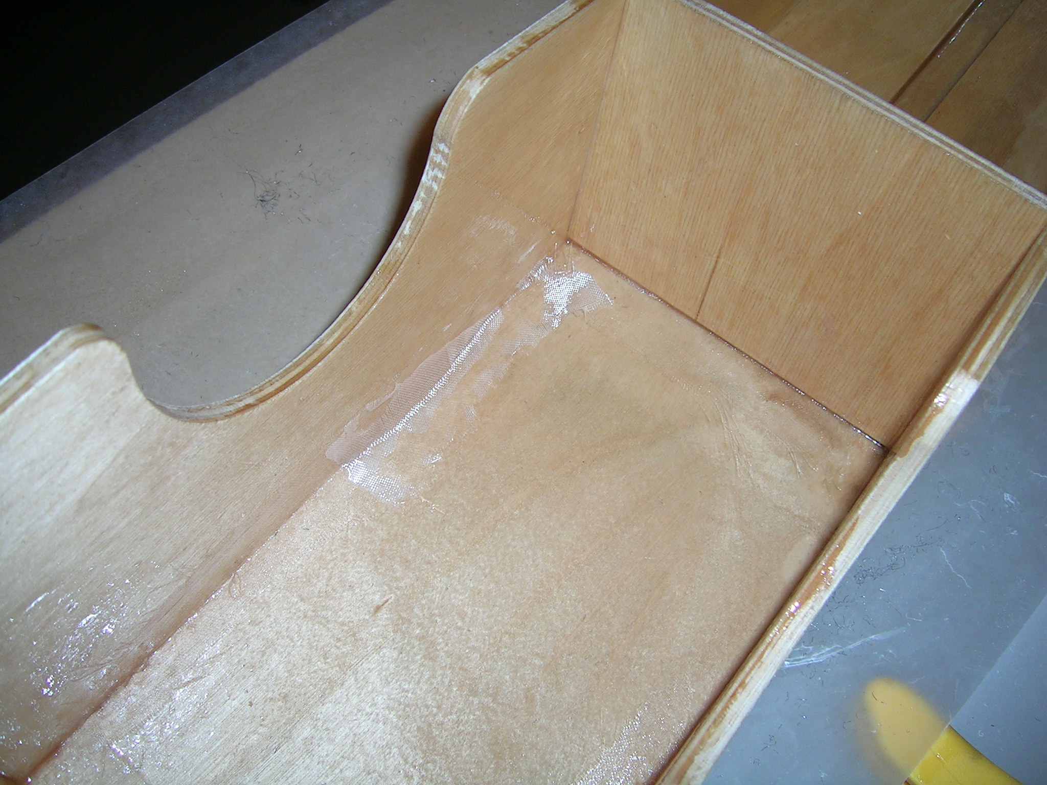

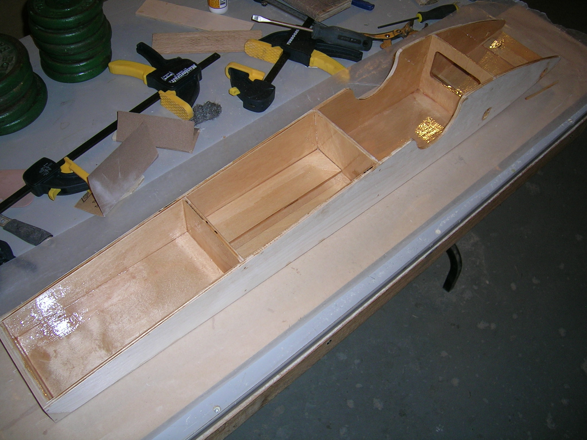

Did a little bit more this afternoon... sanded first coat of epoxy and glassed the seams while putting in second sealer coat in the tub. Will be ready for top sheeting tonight.
A piece of glass before it's wetted in.
After it's wetted it's almost invisible.
Second coat applied to entire inside of tub.

I have some 1 inch and some 2 inch woven glass bands / 80 grams per sqm. Will that be sufficient for the job?
And how about applying it? Do you just use a brush, or are other tools nessecary?
#15467
marc replied the topic: Re: New Warpath build... this one is for Chris "Juice" Rupley
The cloth I'm using for this is VERY lightweight. It's 3/4 ounce tight weave cloth. This is commonly used for aircraft wing coverings and such. It's almost invisible once impregnated with resin. Very easy to apply and conforms well to corners and curves. I apply it in short strips to make it easier. The first ones I did weren't as pretty, but I'm getting better every time I use it! :) What I do is apply the epoxy coat in the hull sealing the interior completely, then I fold the strips of cloth lengthwise in my hands and apply to the inside seems of the hull. Just the lite coat of resin that is already in the hull is enough to completely wet this stuff! Just press it down and remove air bubbles with the brush. Don't stroke, just dab.

yup that stuff is almost invisible. At first i didnt even notice it...and was wondering why Marc didnt glass the seams on mine like he said he was gonna... until i looked closer :laugh:

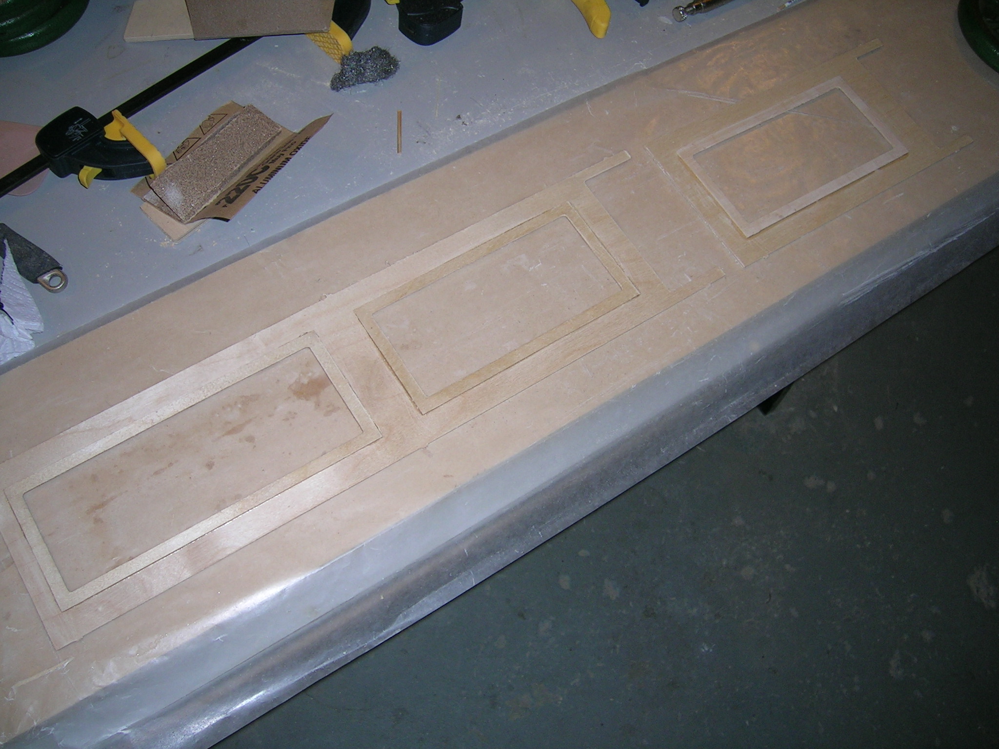

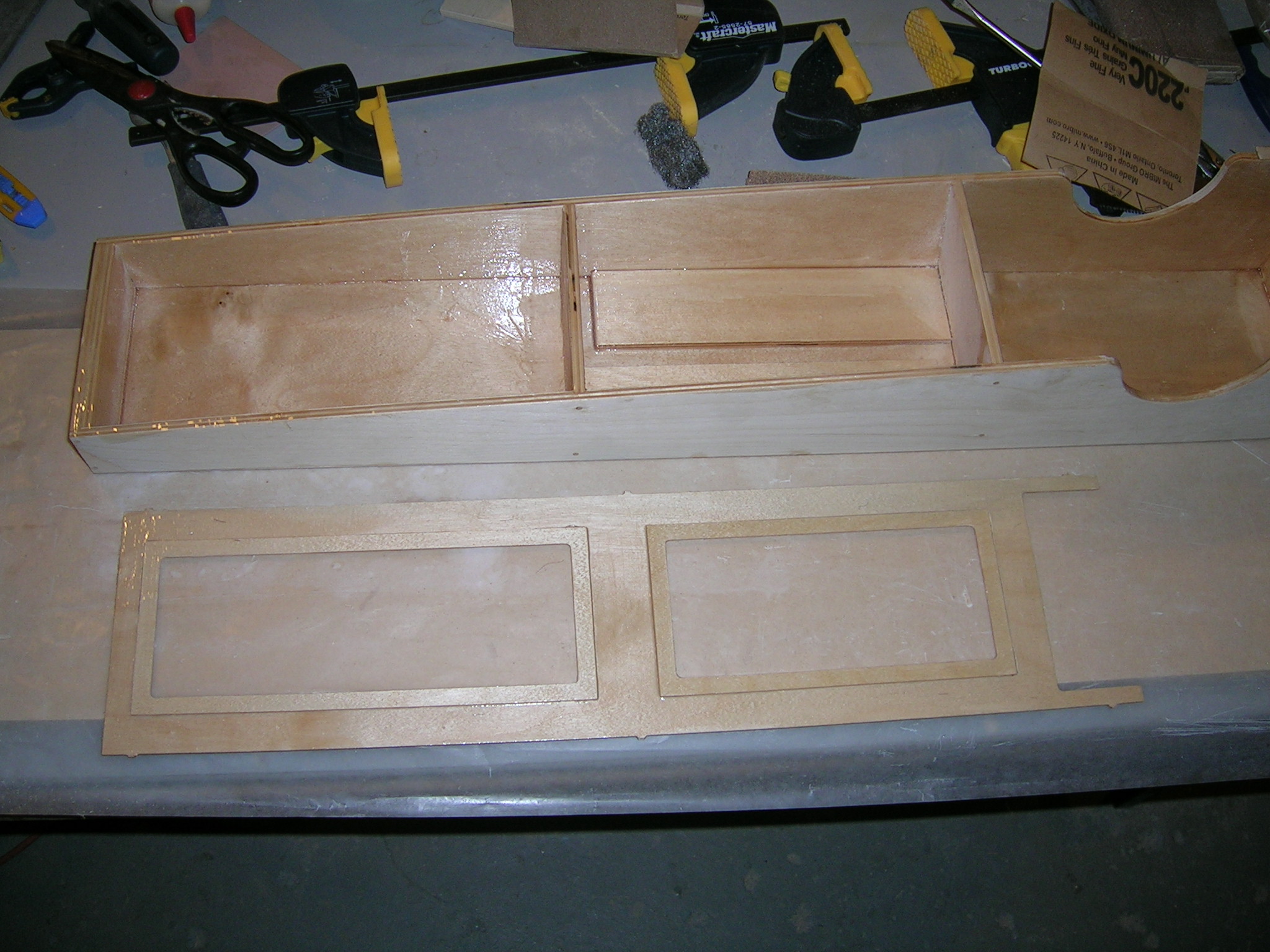

Installing the access cover lips on underside of top sheeting pieces, then sealing everything up with epoxy and gluing them to the top of the tub.
