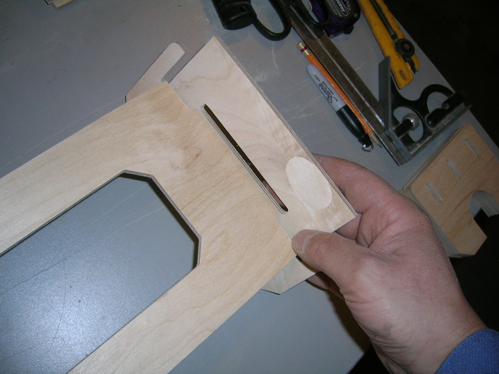

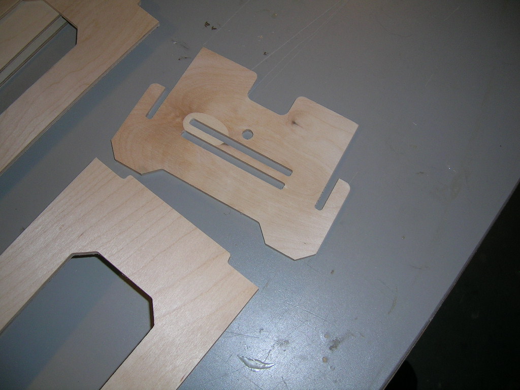

The Parts...

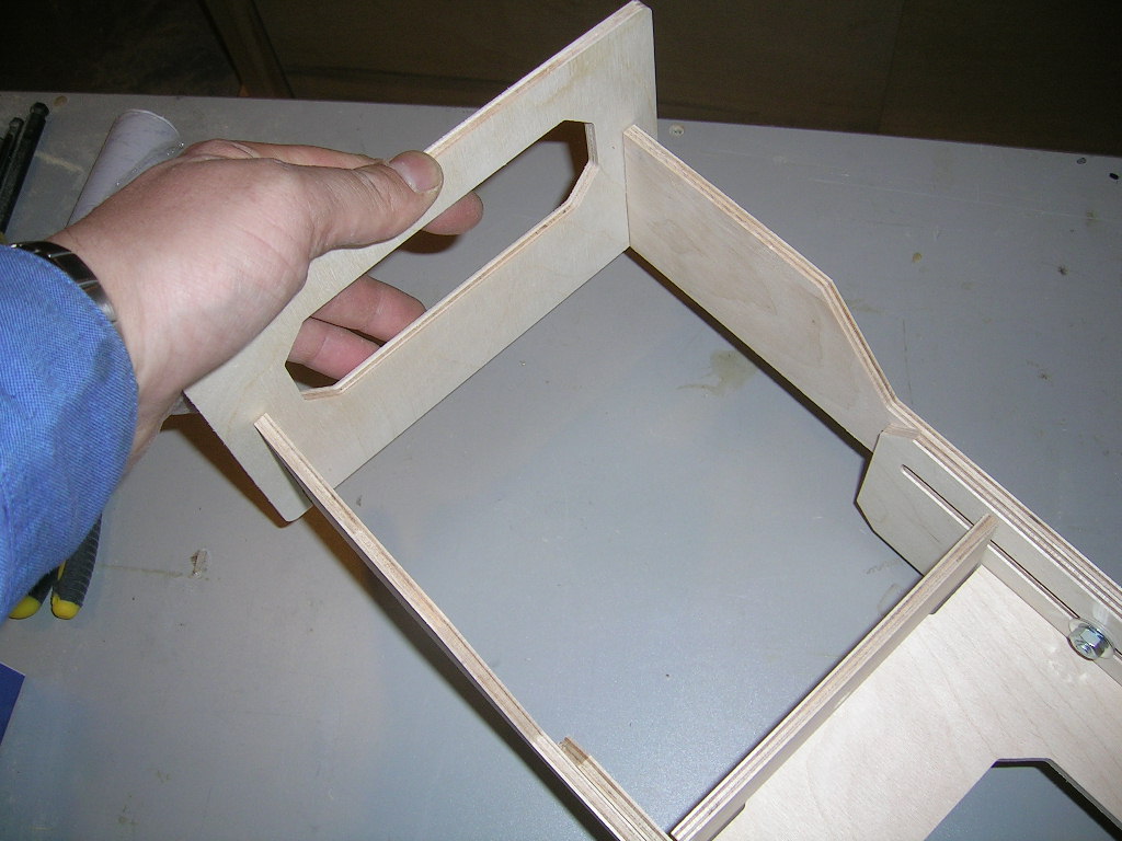

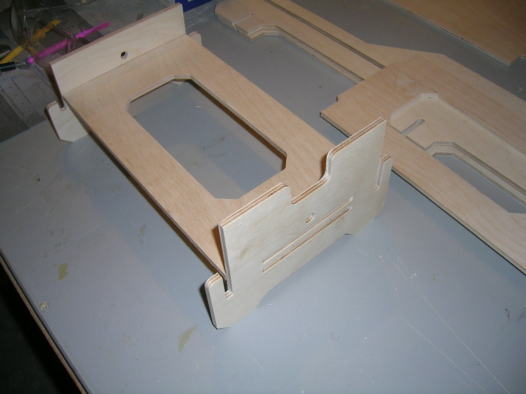

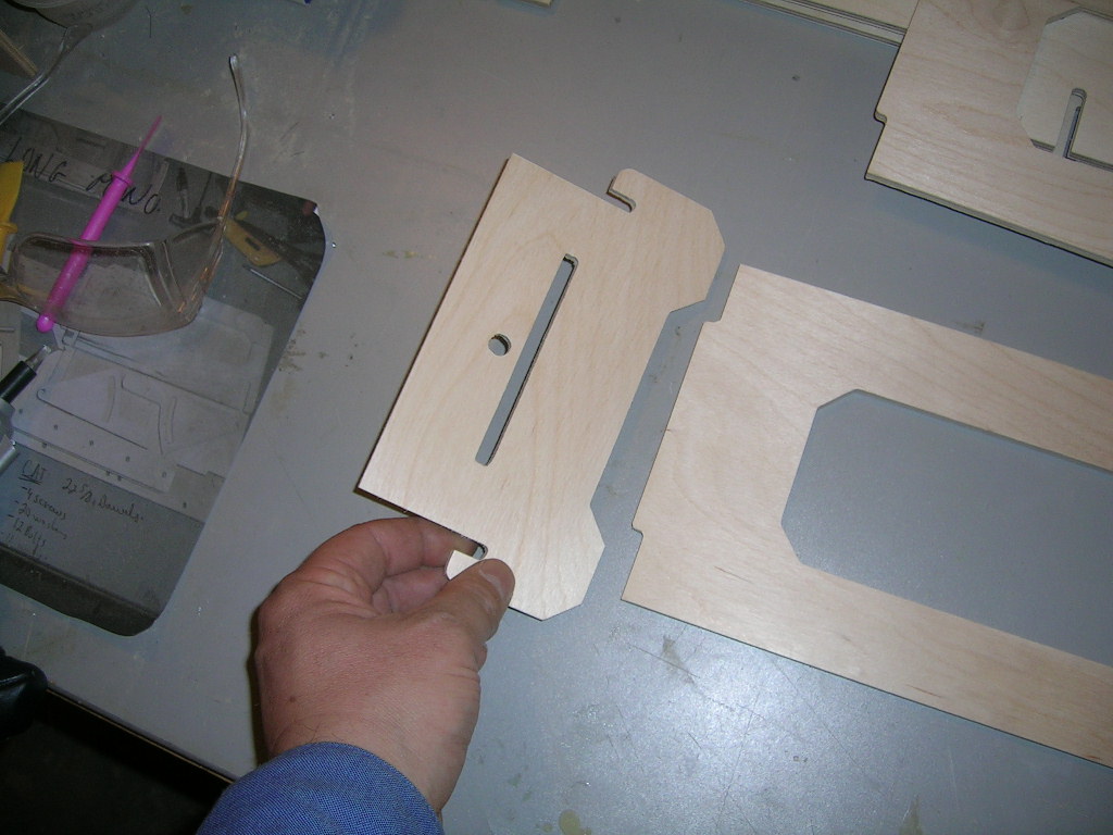

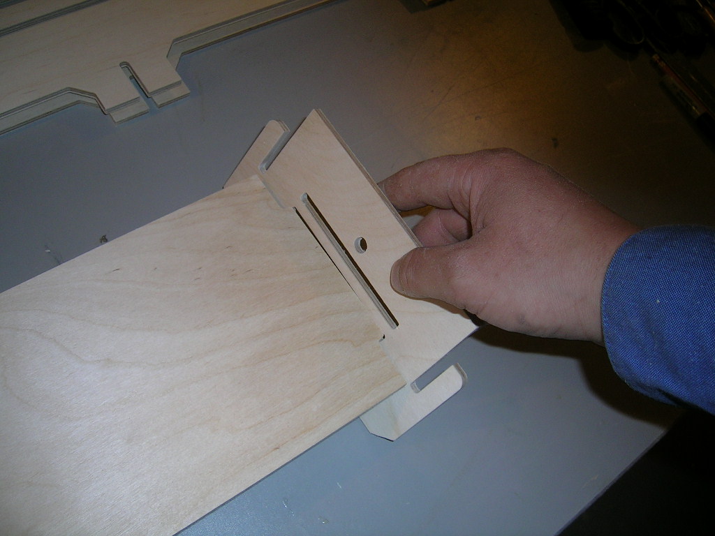

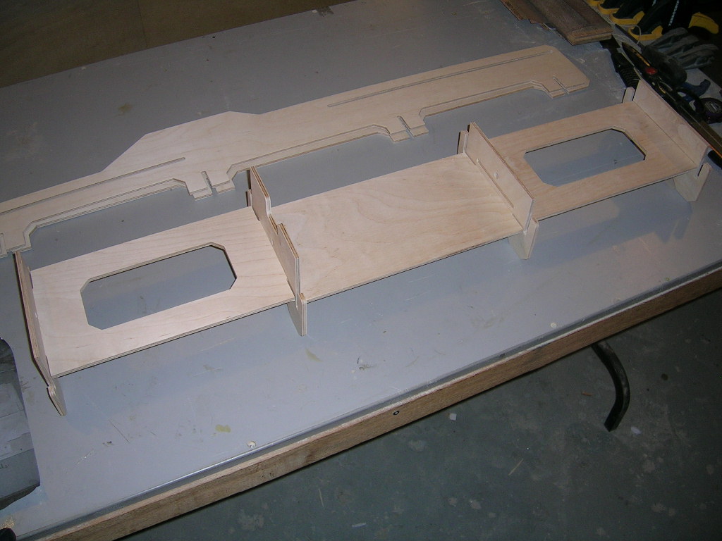

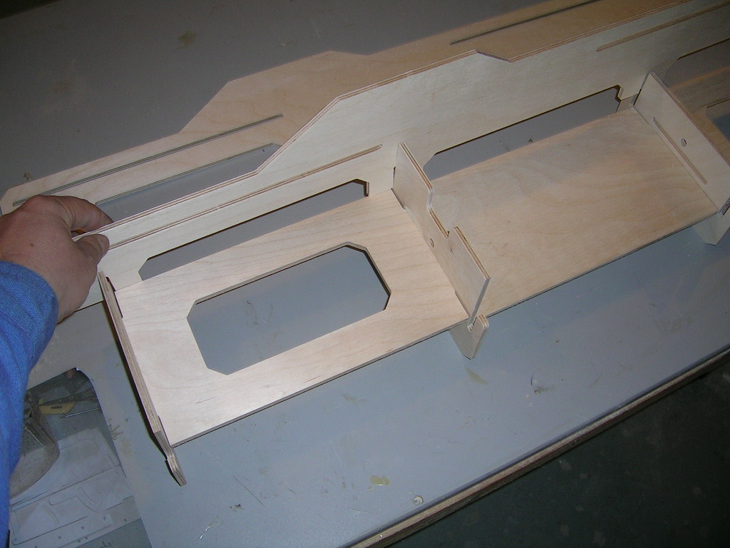

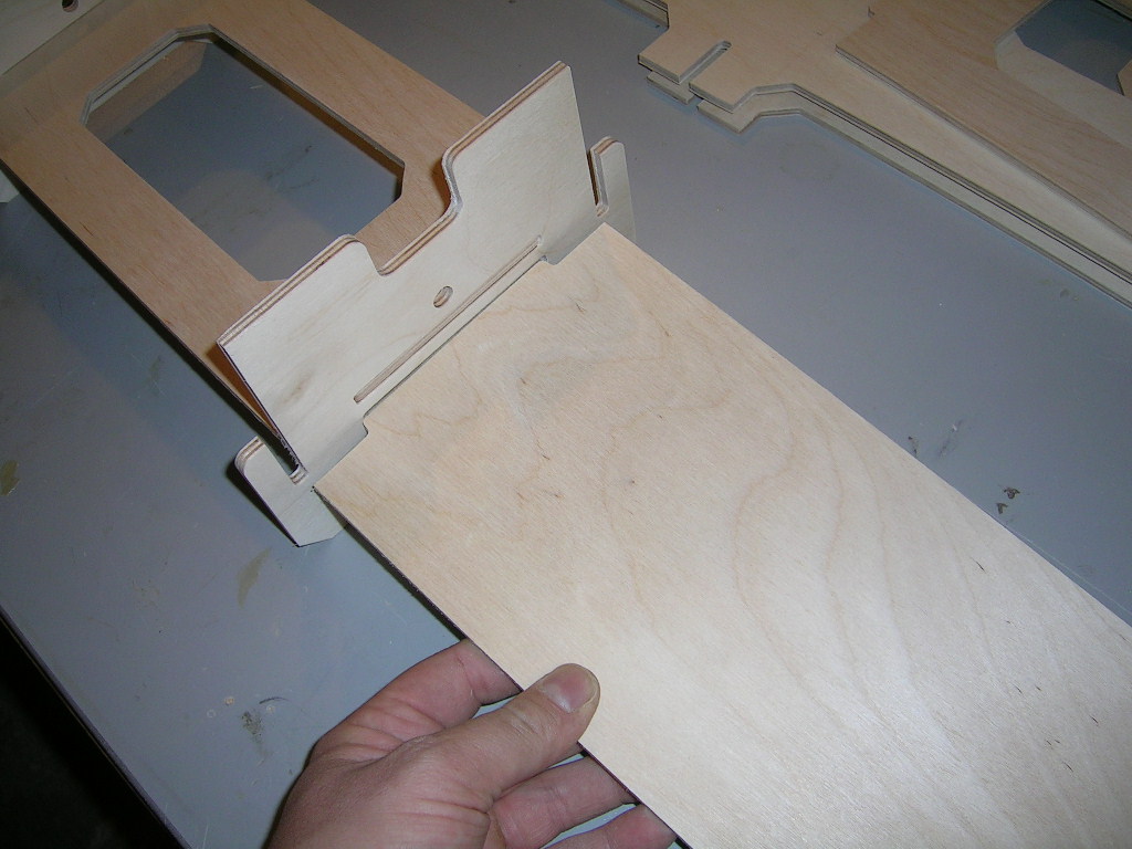

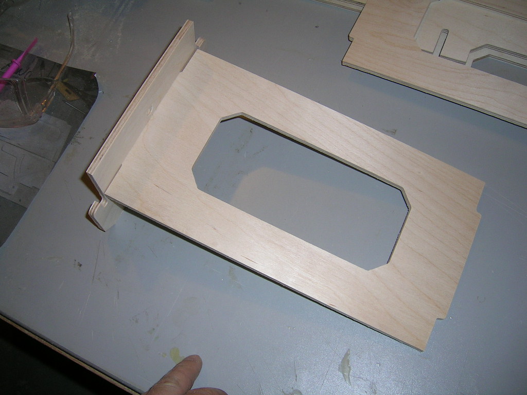

Start by assembling the braces (4pc) to the cross-braces (3pc).
Take note of which brace goes where by looking at the pictures below and following the sequence.

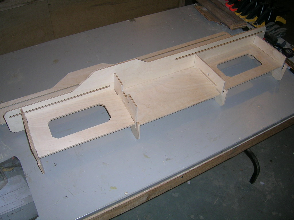

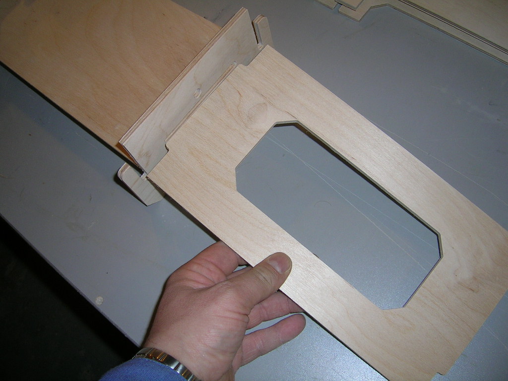

Now you will slide on both side panels. The lowered end of the panels goes to the rear of the stand (the end with a hole in the brace).

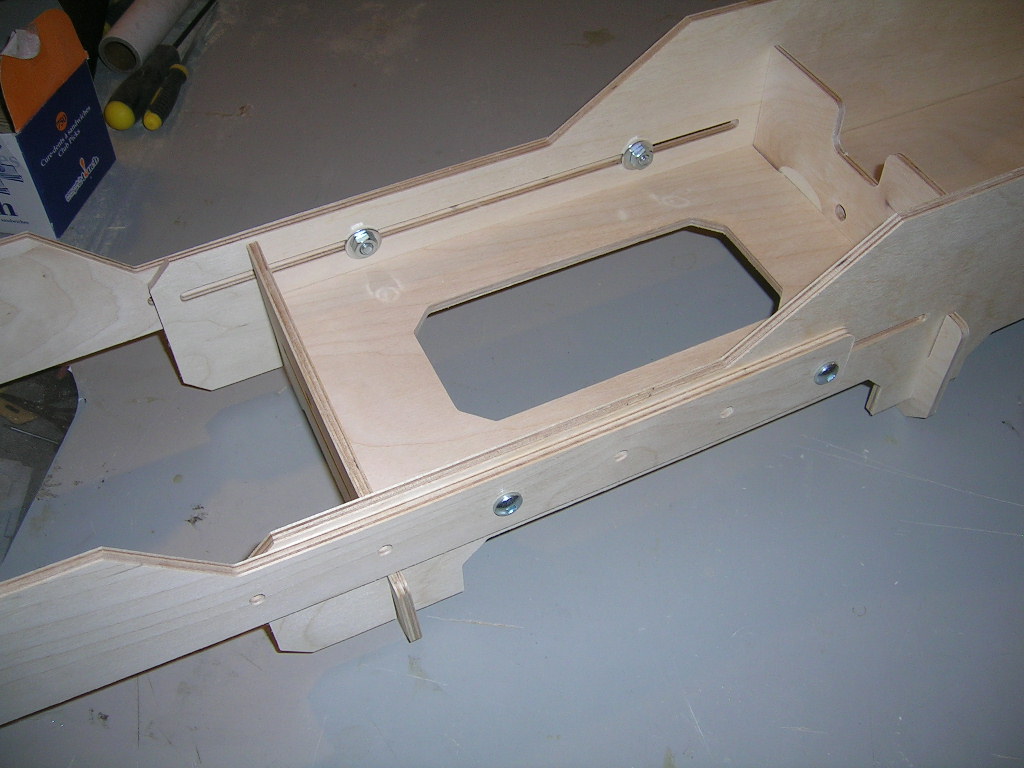

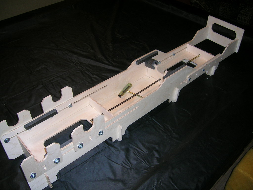

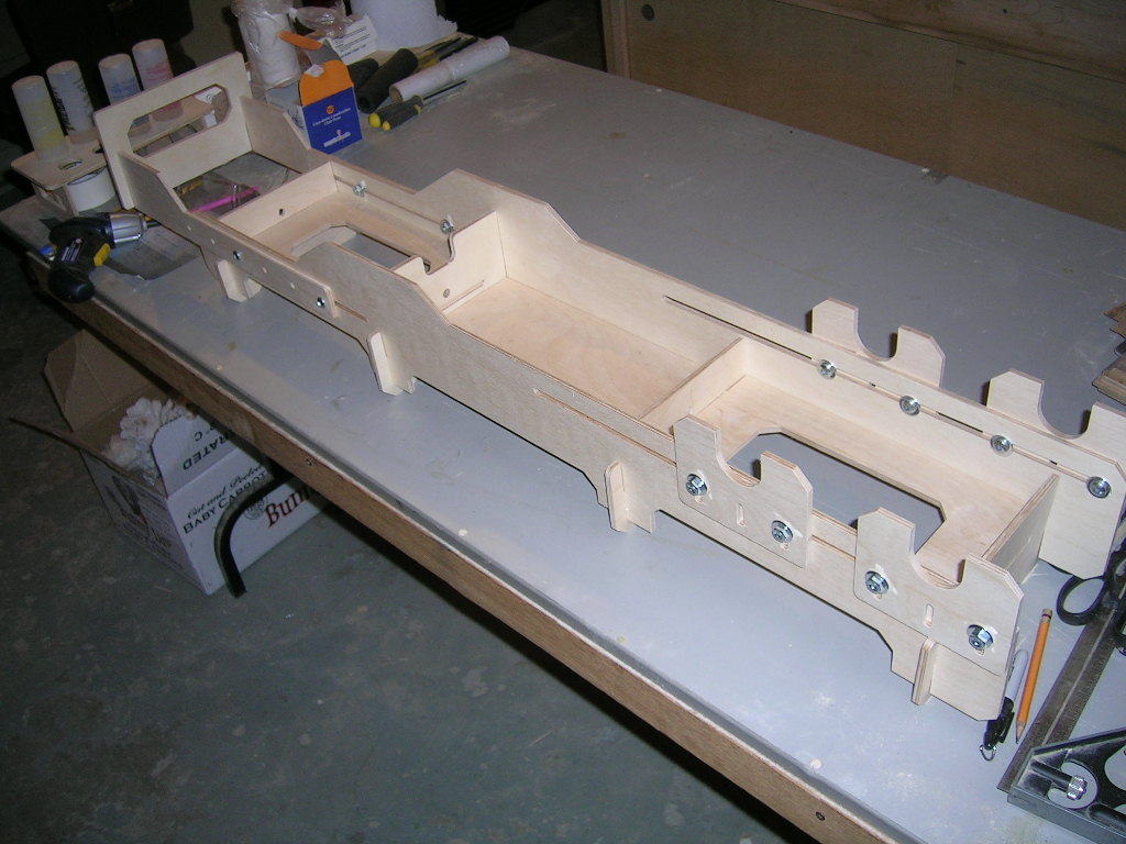

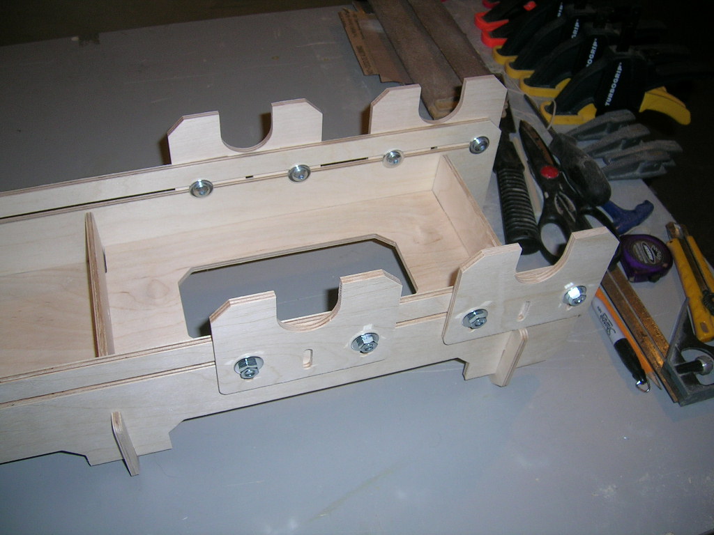

Once both sides are on, install the boom tube supports with the supplied nuts/bolt/washers as pictured.

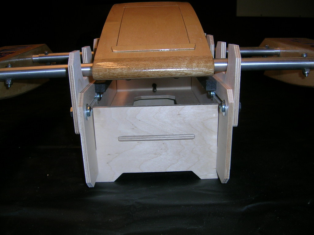

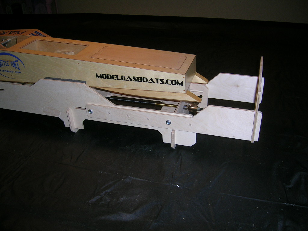

Install the propguard sides to the stand with nuts/bolts/washers supplied as pictured...
Finish by installing propguard backplate...

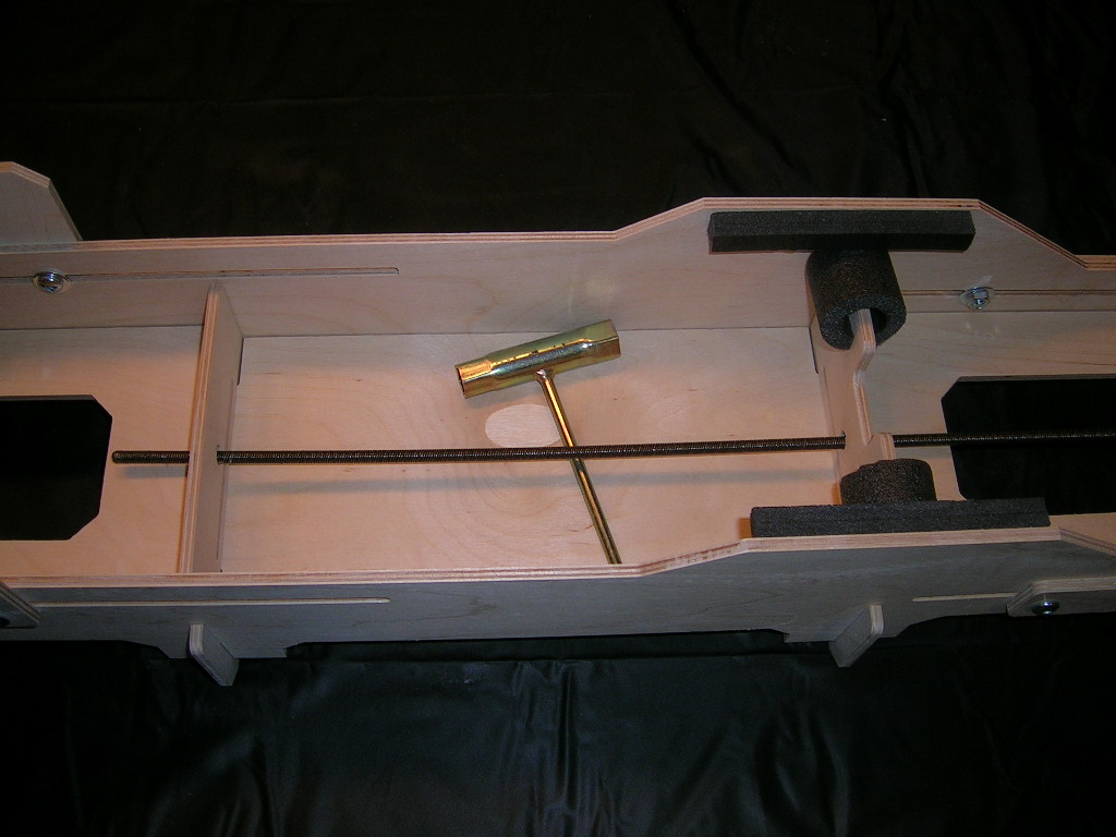

Install padding to protect tub... foam tape/pipe insulators works well.
Adjust boom tube supports to correct spacing and height to best support your rigger.
