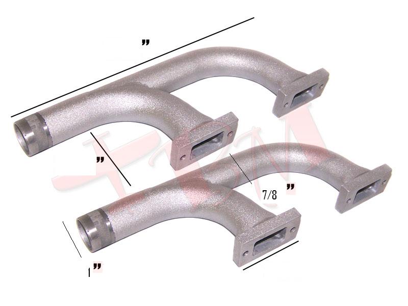

Has anybody ever made or seen a header for a boat made in this way?

Physically I believe it is possible to have a good welder make it out of some of the headers already being made for rc boats, mainly so that the exhaust flange cooling units would also be built into the design. Of course I think it would be a good idea to step up the pipe post merger to at least a 1” inner diameter for obvious air flow reasons. I use 1” because it is the same diameter as all the 60cc exhaust pipes and canisters I have seen for sale.
I just haven’t seen anyone with one or using one and I was beginning to wonder if I was the only one to come up with such an idea or if it is because of the exhaust pipes everyone uses are tuned pipes. Cause, the only tuned pipe I have found for 60cc is 28” long and I have about 22” from pull-start coil to where the exhaust will need to exit the boat, without having 8-9” of ugly pipe sticking out the back…LOL

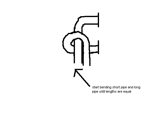

well it seems to me that if the motor is angled to the back of the boat at say 15-25 degrees, as is usually the case my idea is only good in theory.
Also in order to use the same length of exhaust pipe, it would stand that they would both have to be bent because air flow would need to be close in both pipes to produce equal turbulence for tuning purposes.
that being said, the pipes would need to be off-set from the header plane as close to 7/8" as possible...see my 3rd grader pc drawing...

That looks more like it...
Just to confuse the issue more...lol ... it may be that you dont have to have them at the same length but wher the " exhaust waves" meet and are " in phase"
I know i know i'm a Bastard lol
