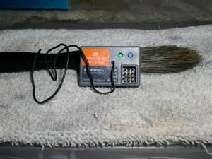

hydropondics replied the topic: need help ...
thanks for the reply's guys ...ok the miss bud hydro 1/5th is running a standard futaba throttle servo fp s148 and a large hitech hs 700 for rudder.. ran through a sr 3000 spectrum 2.4 receiver and a dx3 radio...the other mono hull boat is running old school 72 am stick radio, with a FUTABA FP R114H RECEIVER ,,,, FOR RUDDER a hitech hs-705mg,, and throttle is a Jr nes-517..now i did notice that both antennas were cut at one time and the owners before me spliced the antennas...thought for sure that's what the problem was.....but i took one of my spectrum satellite receivers , from one of my planes, and bound it to my dx7 ..and the black mono boat still did the same glitch/ servos moving on their own...???? i was also thinking it could be the prop shaft rubbing on the tube? the boats both sat for awhile so i'm sure there is no grease in the prop shaft tubes... could that create rf interference ..
well you would think that right... but this particular reciever the antenna was about 6 inches ..and he said it was longer so he added some more antenna wire to make it 13 inch or so ...like i said it's a spectrum sr 3000..

Hendo replied the topic: need help ...
There's your problem , SR 3000 is not a marine RX and I would Stay far clear of Spektrum or if you must get a MR 200 or MR 3000 RX and also use a kill switch.
