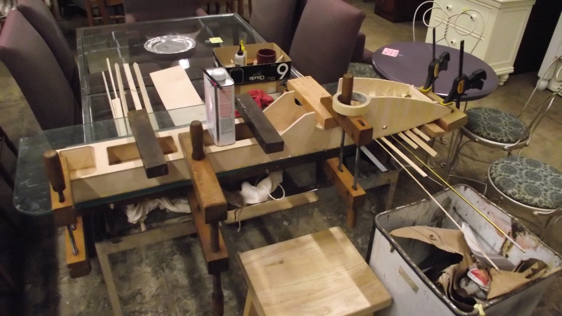

Ok after some wood dust we have a shape, next a tub and onto what the basic monster will look like :woohoo:

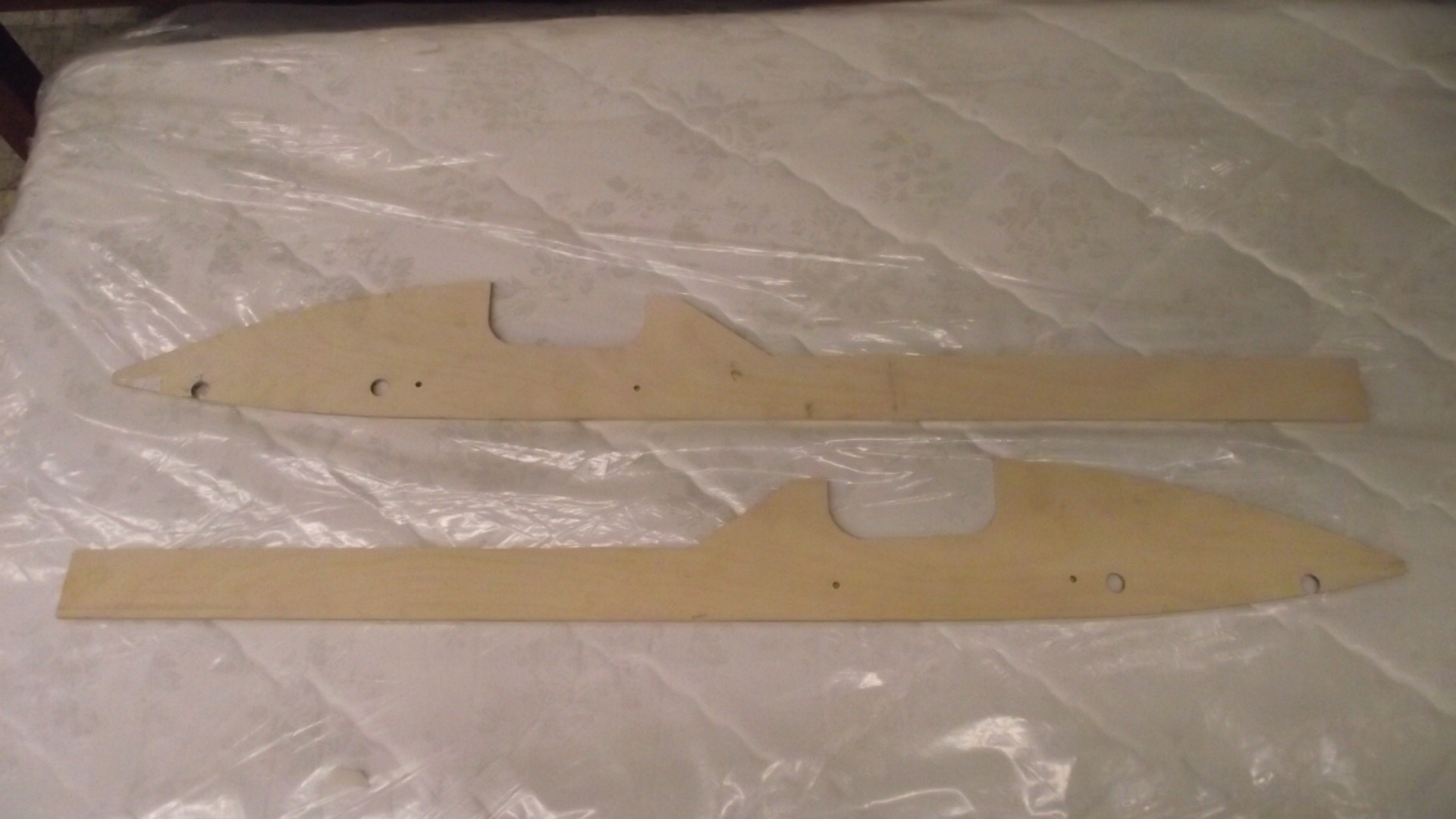

Scott replied the topic: Re: Just sharing my latest engine build ... RCMK 520 twin hybrid
A tub is born ....

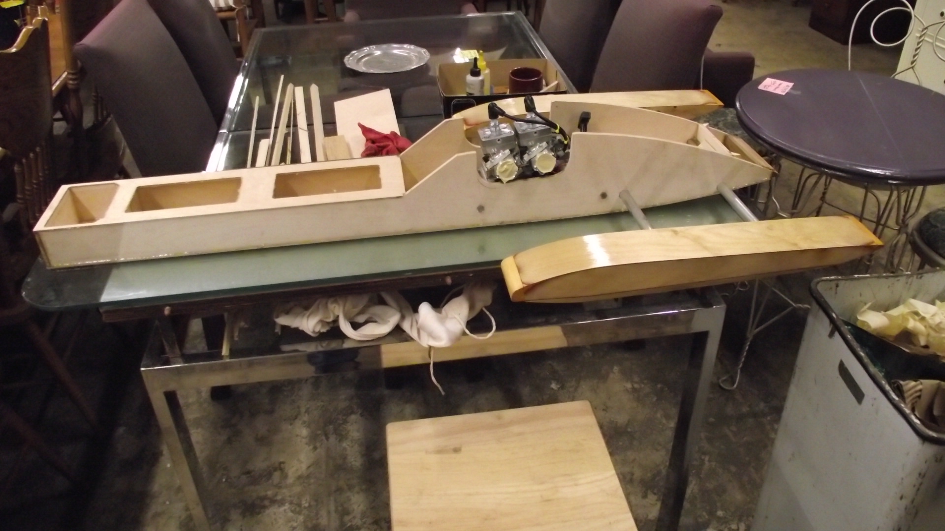

Give the monster a heart and attach some sponsons it looks like a rigger

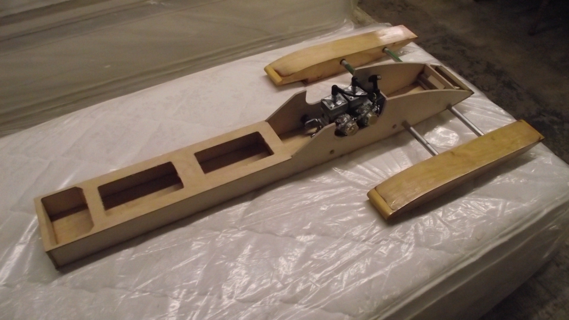

Size perspective .... Tub built from full length 48" stock and assembled as seen @ 52" OAL

Canadian Hot Rod RC Boats replied the topic: Re: Just sharing my latest engine build ... RCMK 520 twin hybrid and now the Hul
Wild build ... always wondered why someone never build a rigger with a teardrop front like that .... make more sense
nice design ...... Have to cal that one ....... Thumper ...lol
thanks for showing
