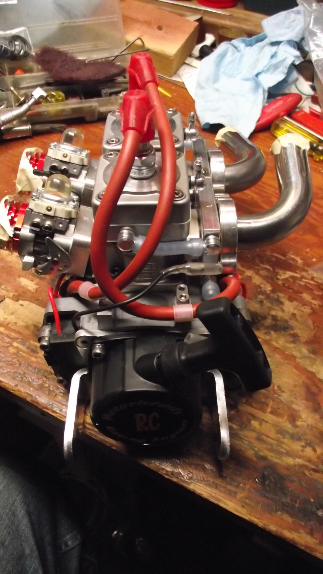

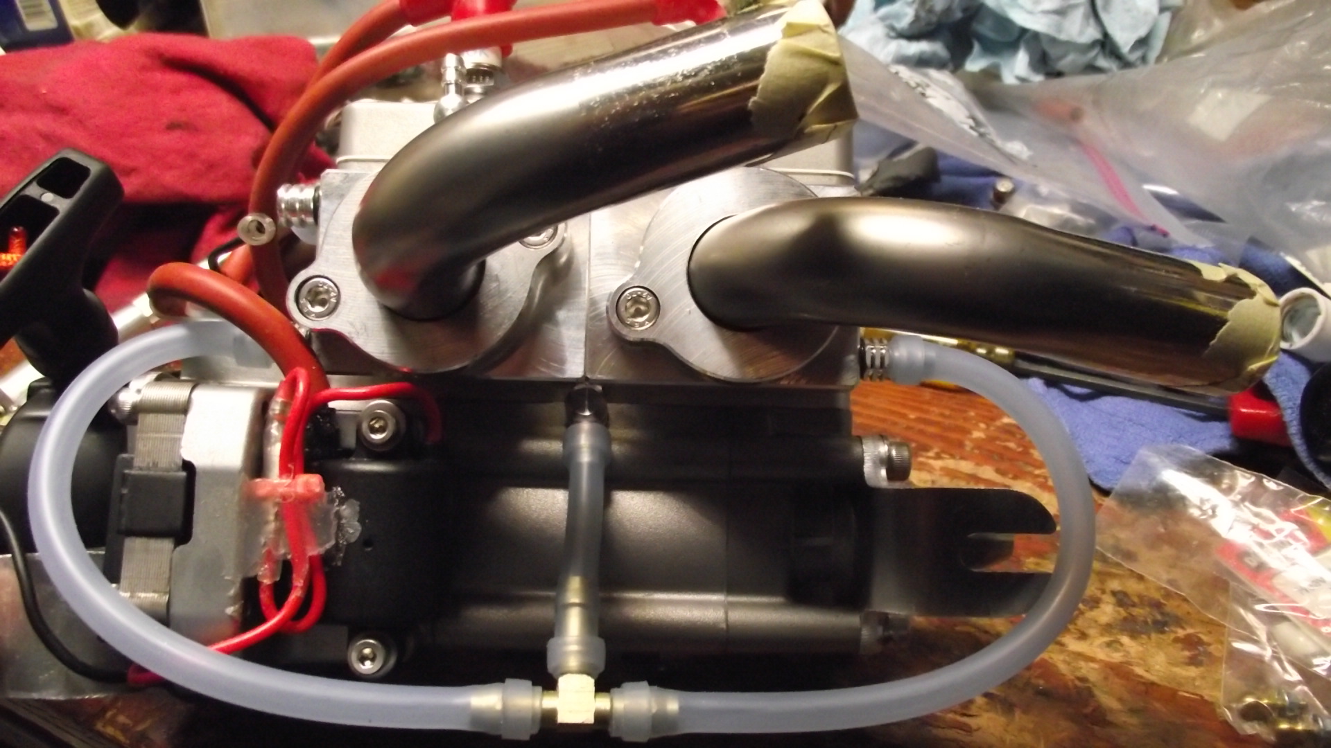

Talked with Carmin Blois of NFS hobbies today and will be having a pair of custom head pipes made specific to my drawings which I will send him.
Worked on water routing after a lot of thought on having equal flow on both cylinders, exhaust and crank cases.
Water in between carbs cooling cases first, out below exhaust then threw the exhaust flanges onto the heads.

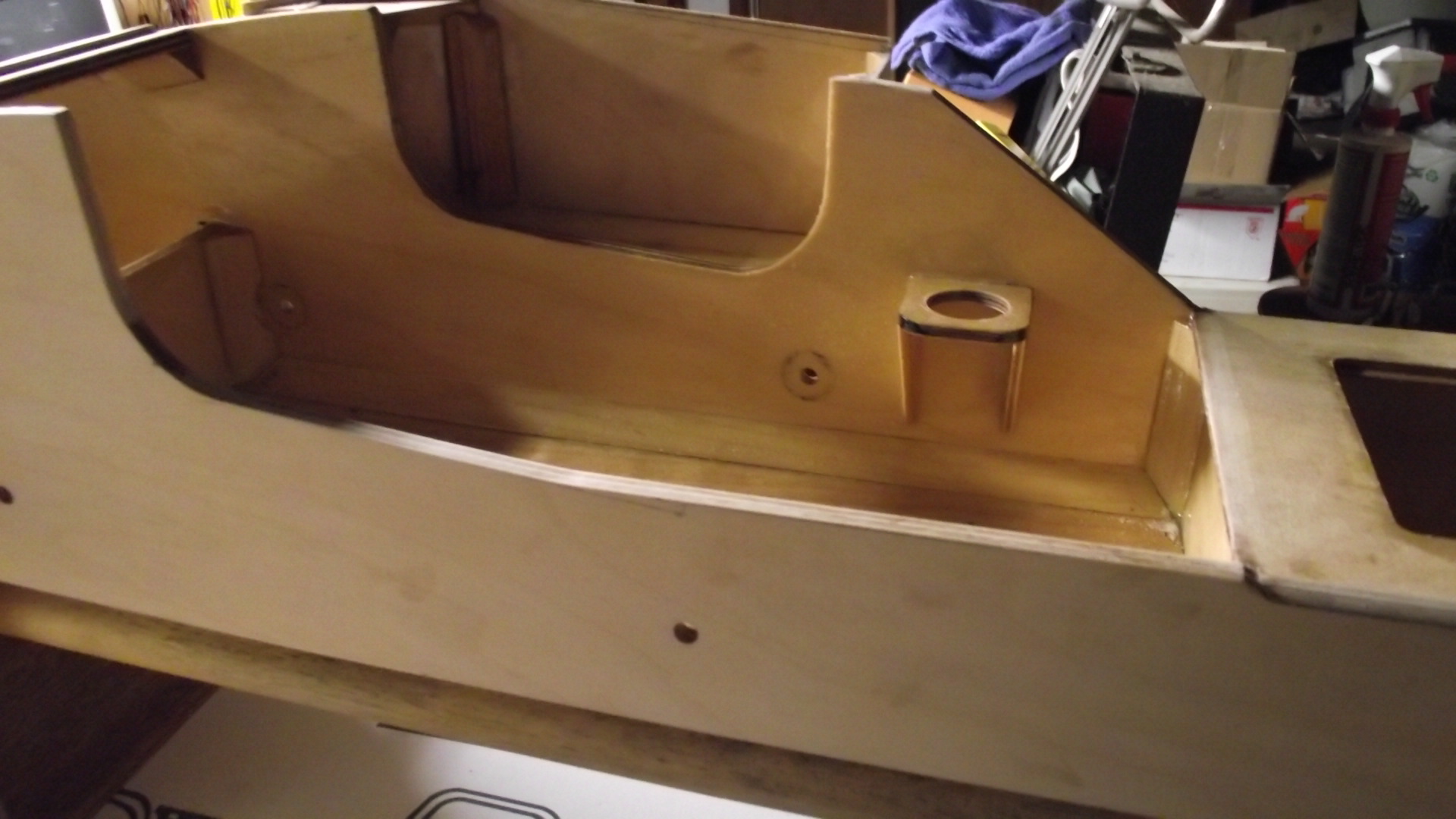

Scott replied the topic: Re: Just sharing my latest engine build ... RCMK 520 twin hybrid and now the Hul

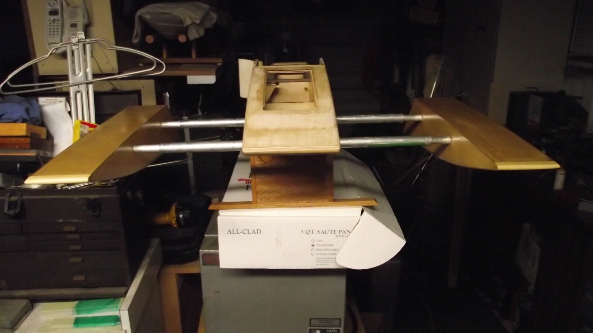

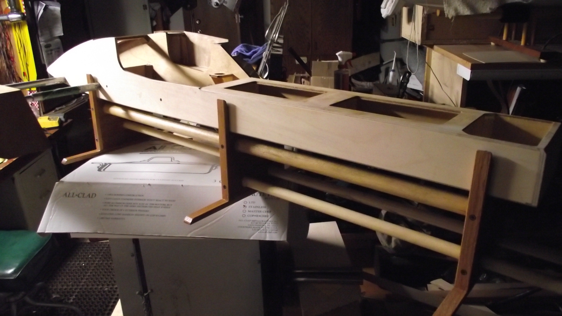

More done last week ... have a Stand built, Brackets inside for cable oiler bottle,
Tub corners all rounded, Sponsons and tubs inside all sealed up.

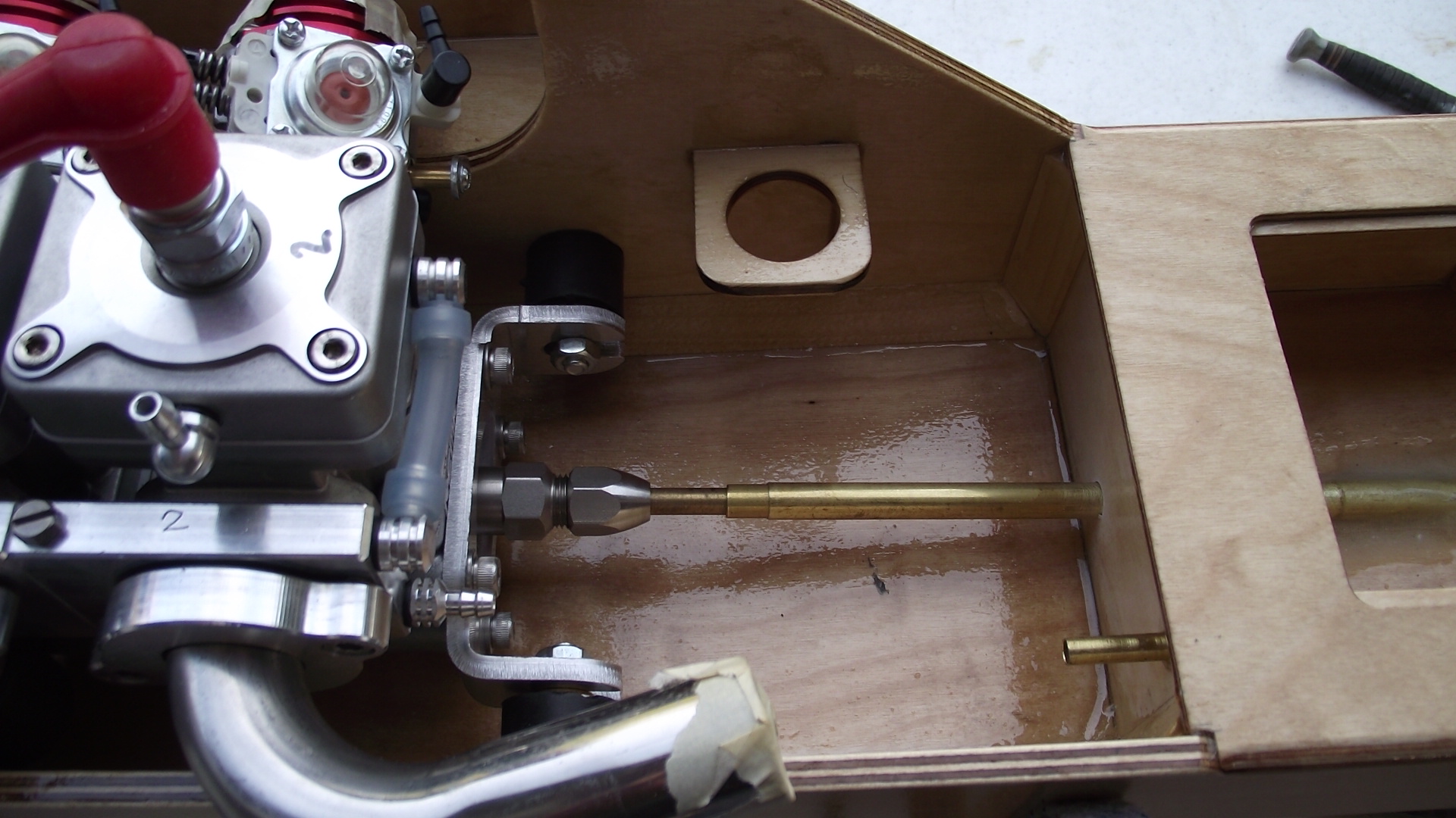

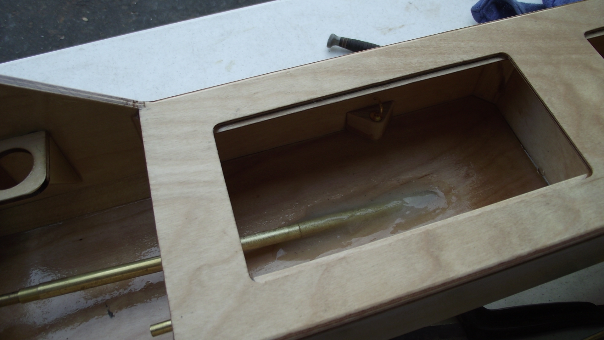

Got the stuffing tube and log set today, Cup hooks for tab mounts on Dr.Bucks fuel bags in between booms and in first compartment.
* Will be running 2 bags equally spaced ahead and behind C/G so fuel load full or empty won't effect ride attitude. ... In theory anyways :blink:
Will be using the heavy .029" wall K&S brass for the stuffing tube hopefully keeping cable whip and knot up issues at bay. :S

Nice looking hull,Scott. I kinda like that front design.like a bulldog. also your carb side bay.Nice to see something different & unique. thanks for the post.Will be watching

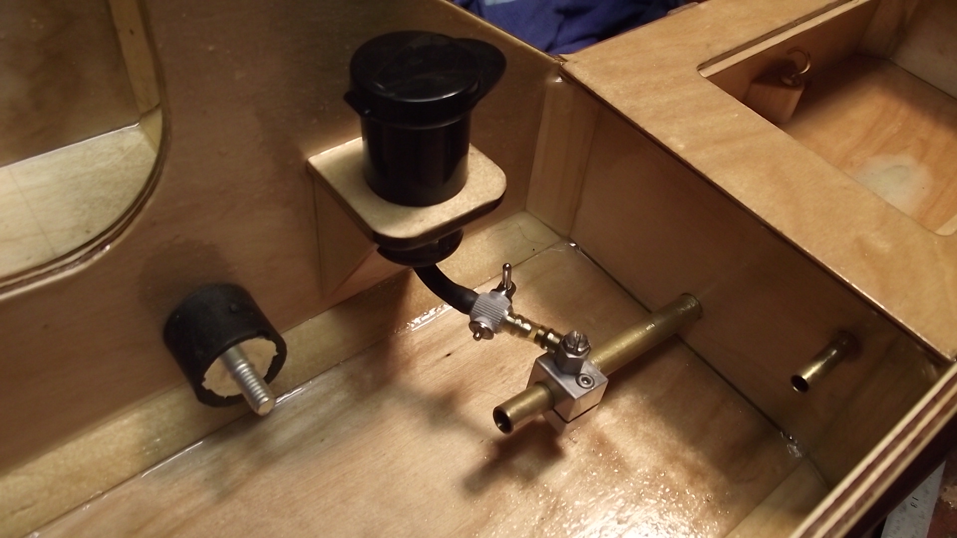

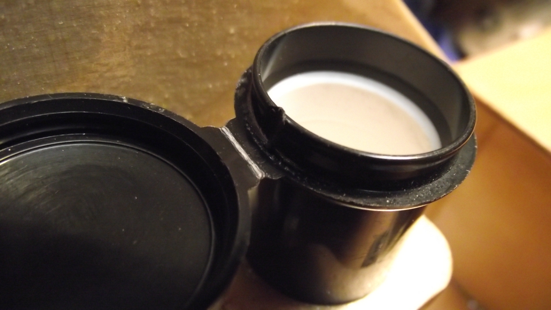

Fabricated the stuffing tube oiler block and set up the plumbing.
* Oil tank has a nitro pipe thin wall fitting drilled and fitted in the bottom. On/Off fuel valve mid hose and a swivel 90* on block.
Will use "Chainsaw" Bar & Chain oil for lubrication ... thick and sticky fortified with anti-rust additives perfect for a drive cable ;)
Cap has had a notch cut into sealing band by cap hinge so it is no longer air tight and will self drain oil having notch being the vent path.
