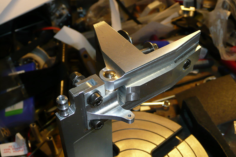

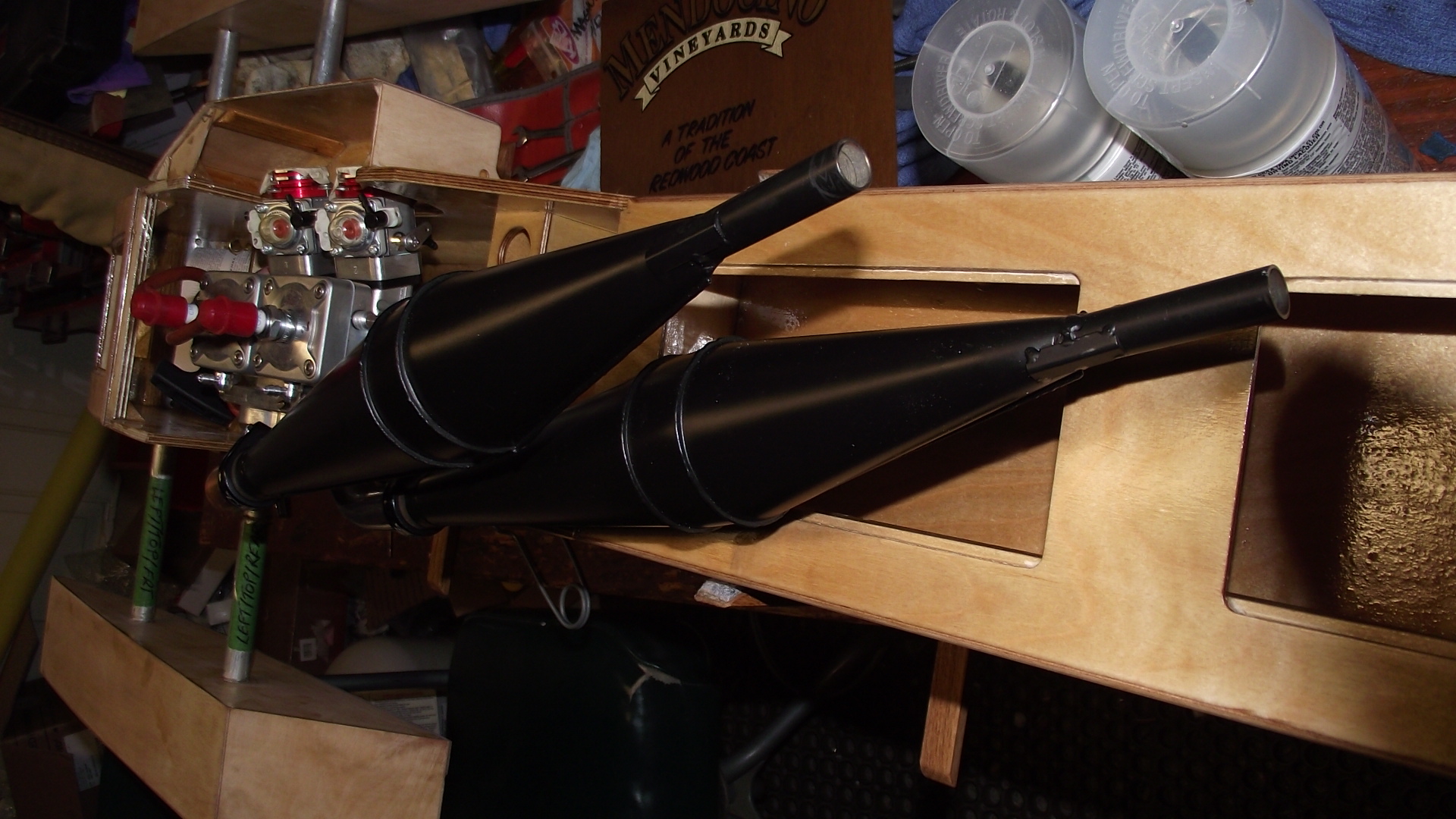

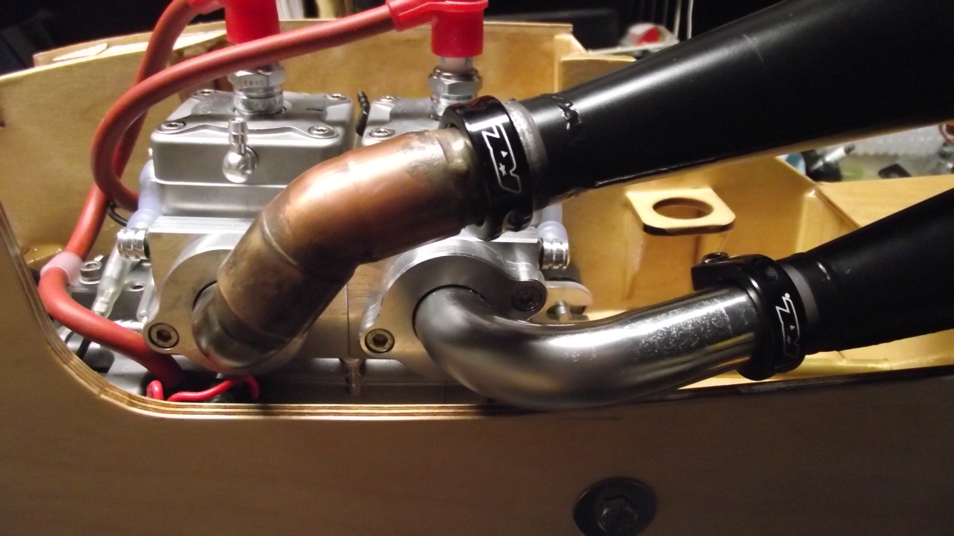

Project getting back on tract ... with the help of Andre in Germany building a rudder assembly and some head pipe fabrication we should be moving ahead with the rigging and painting real soon.
#15523
marc replied the topic: Re: Just sharing my latest engine build ... RCMK 520 twin hybrid and now the Hul
VERY nice rudder bracket!!! I like the way it will hug the side of the tub. I'll have to ask him if he can make 50 of them for me!!! ha ha!!!
#15524
Scott replied the topic: Re: Just sharing my latest engine build ... RCMK 520 twin hybrid and now the Hul
Marc wrote:
Received rudder assembly today and have to tell ya looks better in person :cheer:
Andre even included an improved throttle shaft connector that he says wears much better than either version RCMK has done too date ... Love it having best of the best right from the start !!
Thank You Andre ! :woohoo:
