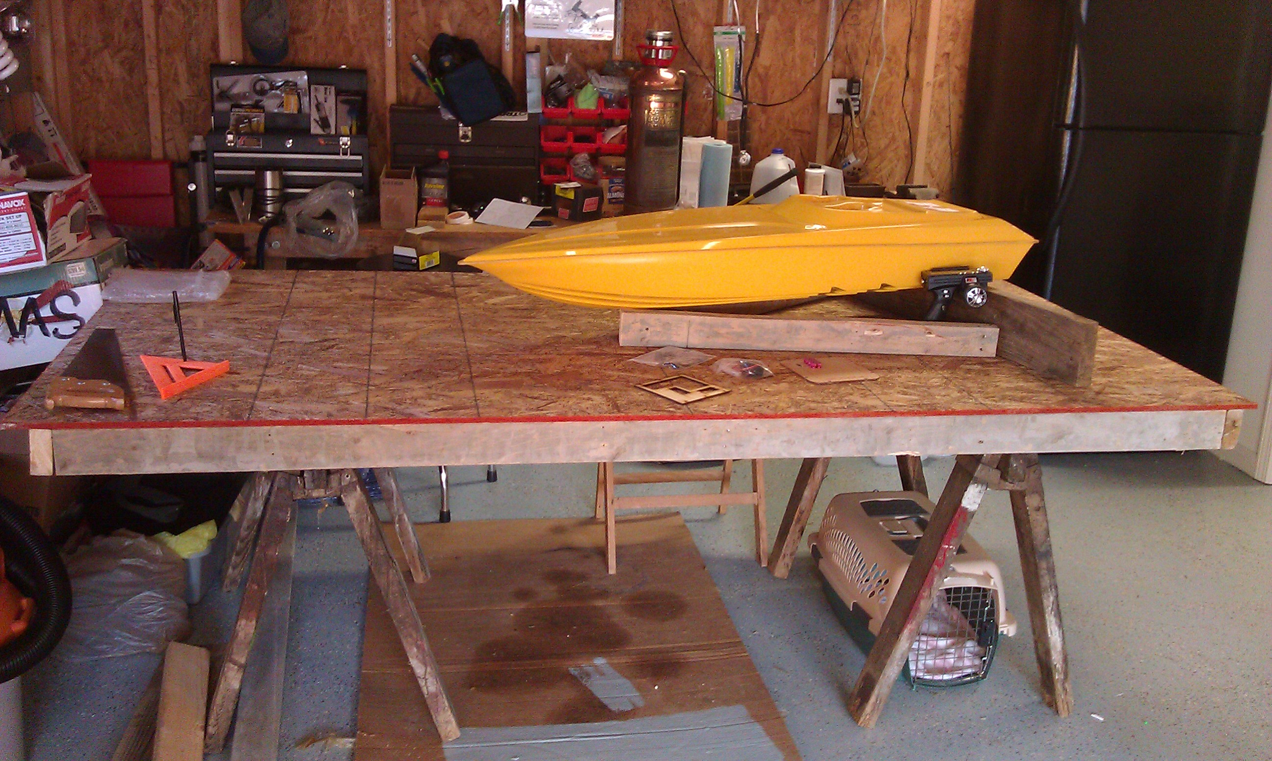

I will be posting build pictures as I go along, I am near the end of my planning stage and begining to buy and assemble the boat
54"(without hardware) fountain style hull

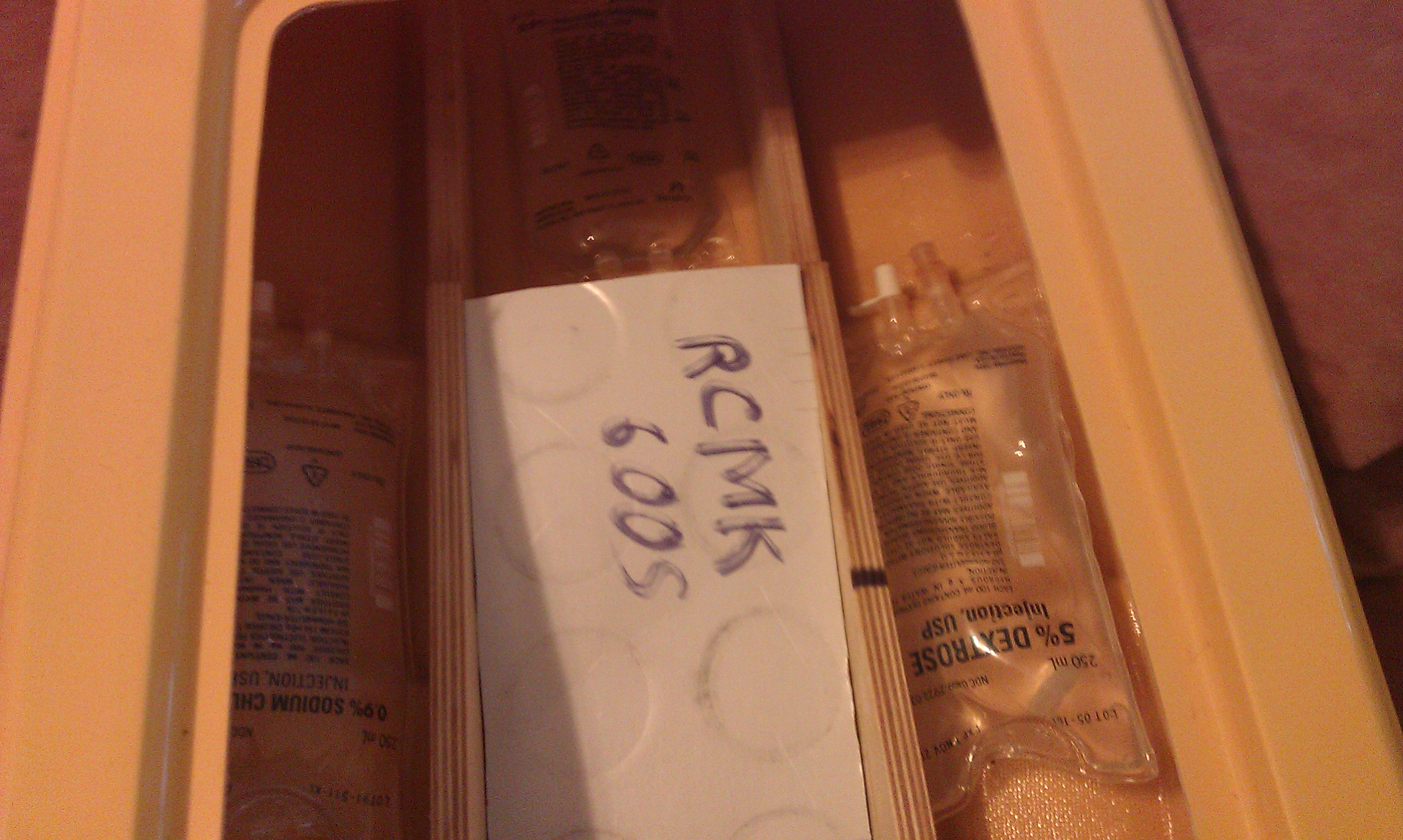

IV triple 250ml gas bag setup for even weight spread

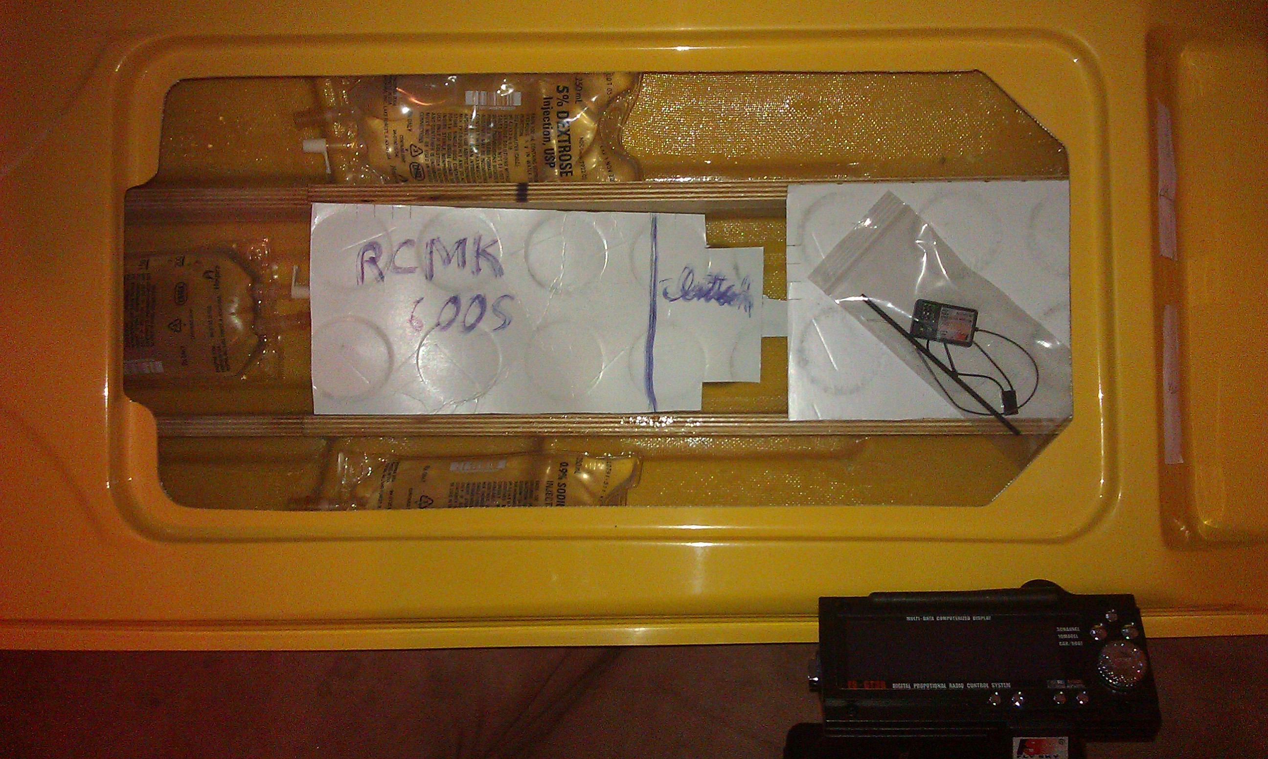

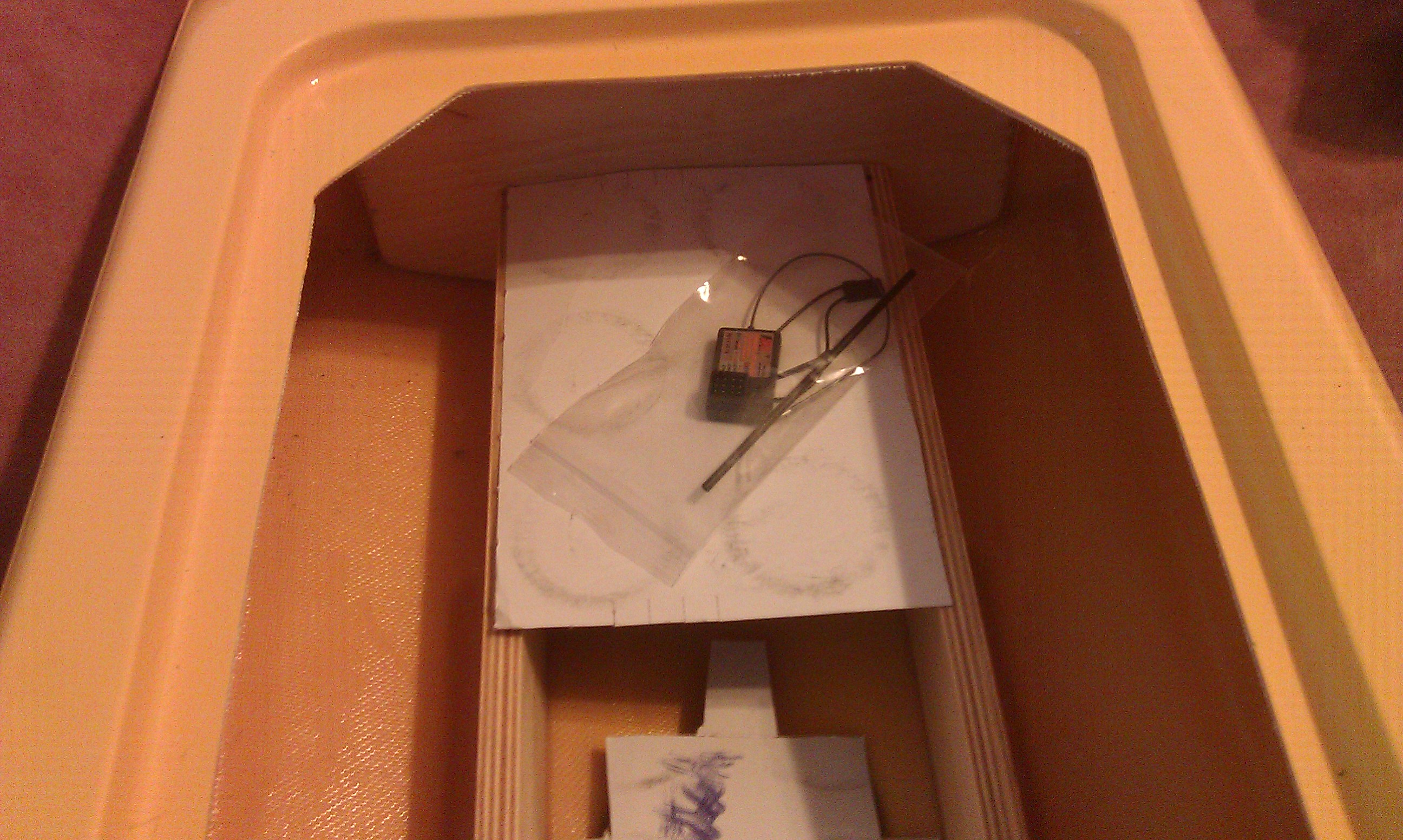

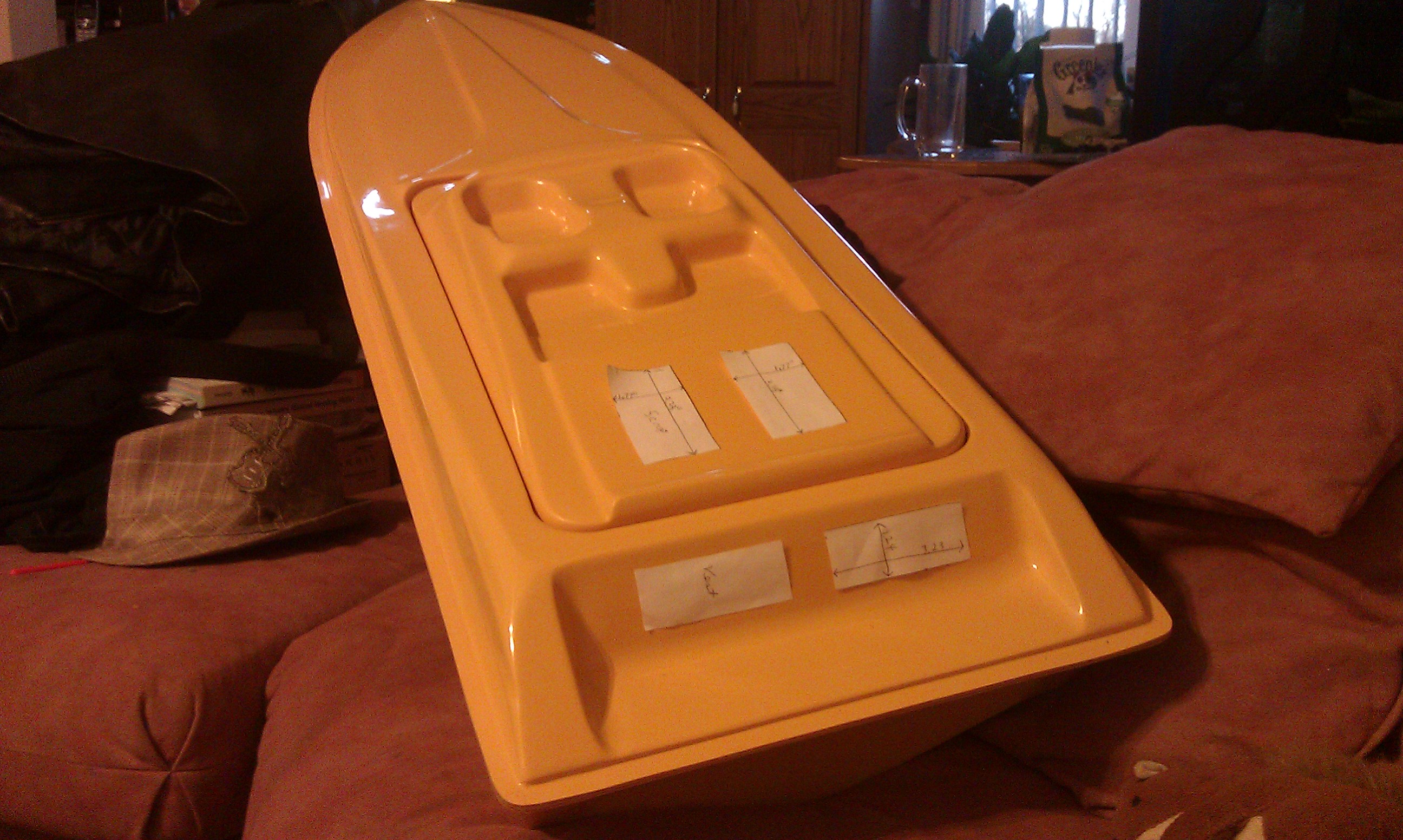

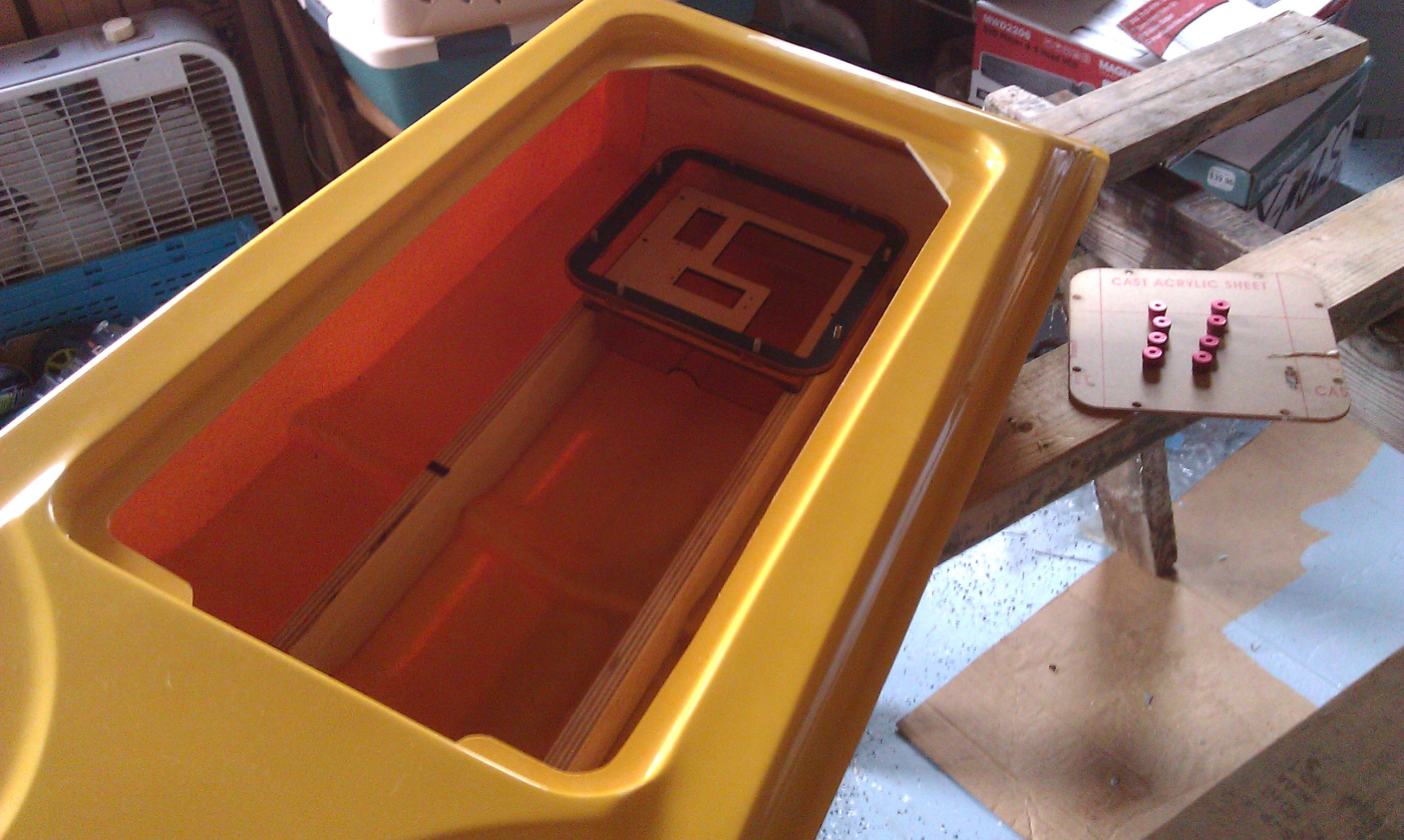

Some setup pics with cardboard cutouts showing engine/clutch and radio box, also placement of triple gas bags... and one shot showing airscoop and vents even though I believe I will need more vent area per scott's rule of thumb of 1:3 scoop to vent area...
Let me know what you guys think of design so far?

monstrosity replied the topic: Re: Bonzisports 54" fountain hull buildup... name= Schizotypal
looks and sounds good have a few suggestions that might help
just block one of the airscoops so its a dummy to get your hull presssurization ( is that a word? ) down. probably only need one open on the opposite side to your carby intake.
just go with one fuel bag if possible . I personally only use 1 liter bag and cause its in front of the motor and pickup at rear of the bag the natural g force of acceleration keeps feed to carb even if i havnt burped all the air out remember the KISS principal. The more fuel lines and couplings you have to link it all together the more chances of failure IMO.
i am not to keen on the reciever but that being said i have never used fly-sky.
if its a ground reciever for cars they dont work too well in boats. I use Futaba and recievers like the R603FS which has two antanea and switches between them continuosly so less chance of loss of signal has built in failsafe as well
you dont want your new boat Ghosting into the far bank on debut lol
i have thought about thru hull filling but again KISS good for BLING BLING factor but another part to fail and let air into system i have seen these fail on nitro and cause all sorts of tuning issues untill was removed and problems went away that being said the MHZ ones are probably better than DUBRO
Havent used EL wire but looks good what sort of pwer /volts does it need?
just some thought and others may be different but its sometimes good to collect lots of info and then learn from others mistakes/success

Good idea on the dummy air scoops!
I know I am testing "Murphy’s Law” with the multiple gas bag setup but I know that getting this boat to balance at 30% is going to include the gas weight also... see cardboard cut out pic and the sharpy marker spot on the stringer is the 30% mark...
I have heard mostly real good things about the 3ch. 2.4 ghz fly-sky, but of course I will be using a failsafe and checking my distance and all that good stuff. i will however report back and let you know how my 60$ 2.4 ghz tx-rx combo is doing...
yeah, the MHZ ones even cut off flow to the carbs to prevent flooding as one fills the tank/bags... plus any mistakes can be washed of the surface instead of contained in the hull with explosion possibilities.

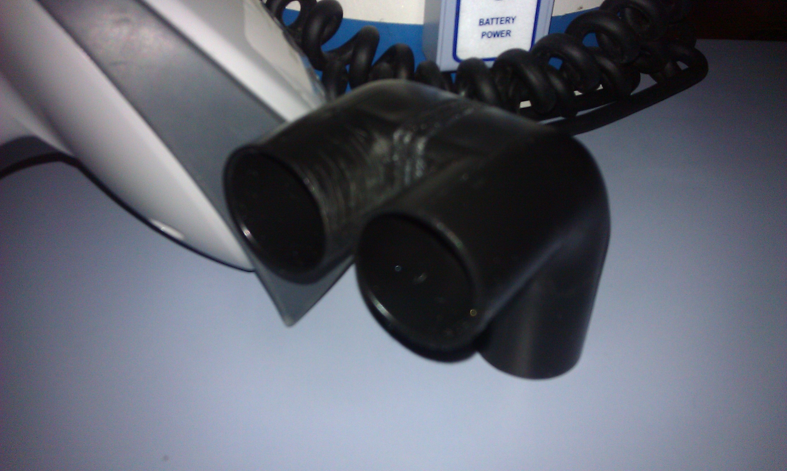

Construction pics of the air scoops!
