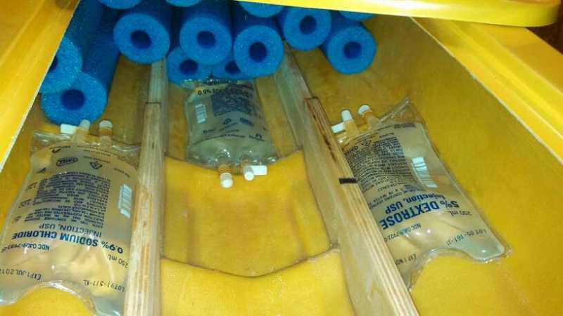

smokeater2005 replied the topic: Re: Bonzisports 54" fountain hull buildup... name= Schizotypal
Triple gas bag setup will eliminate weight shift as gas bags empty, also provide the lowest center of gravity, and even Though a bit more tricky they can, with one way check valves, prevent total fuel leaks into the hull...
