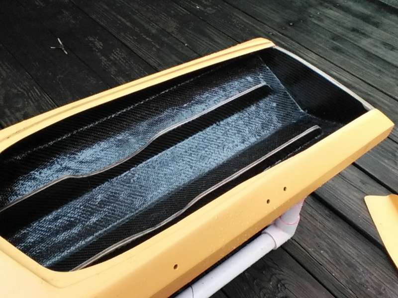

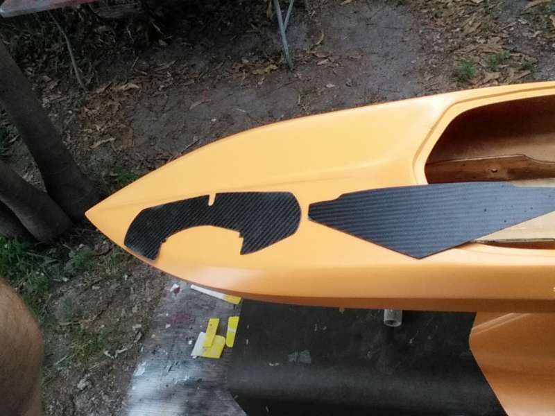

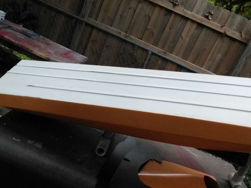

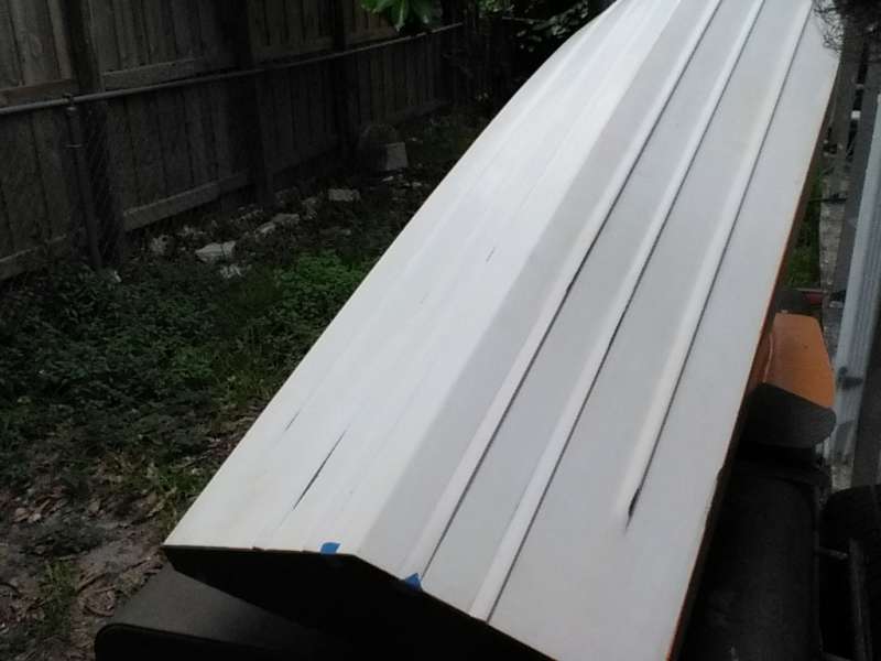

Time to turn this old race boat into a weekend hot rod. Got some paint and strake extensions. Got to get the carbon fiber on and I'm ready to start assembly.

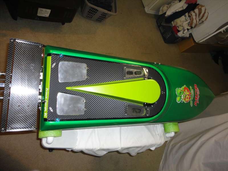

I did same thing with a older Razor deck -- the wing is 2mm Carbon Fiber Plate though :lol:

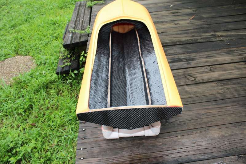

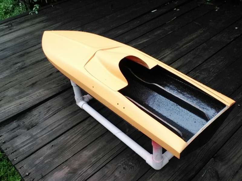

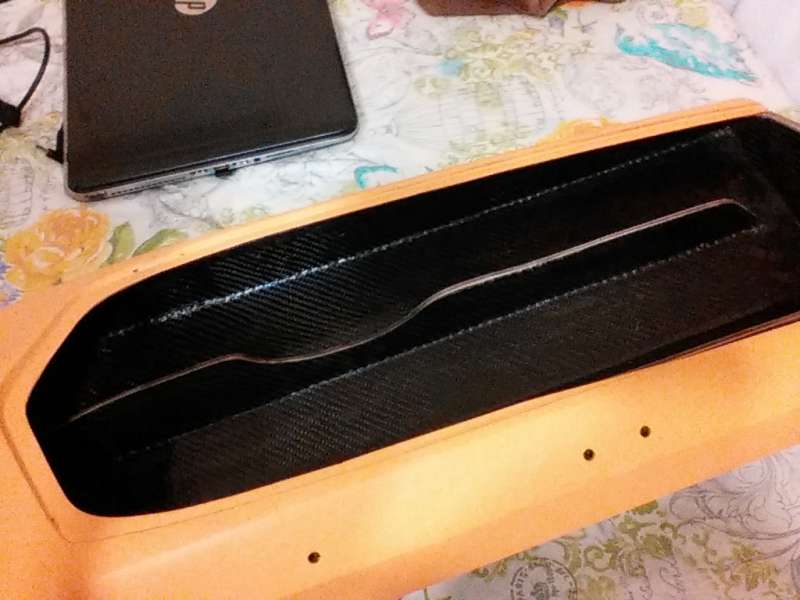

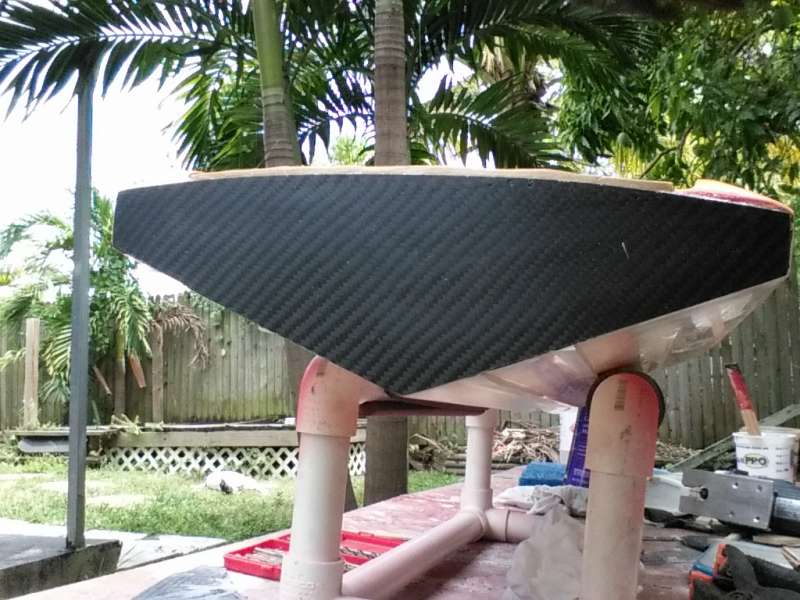

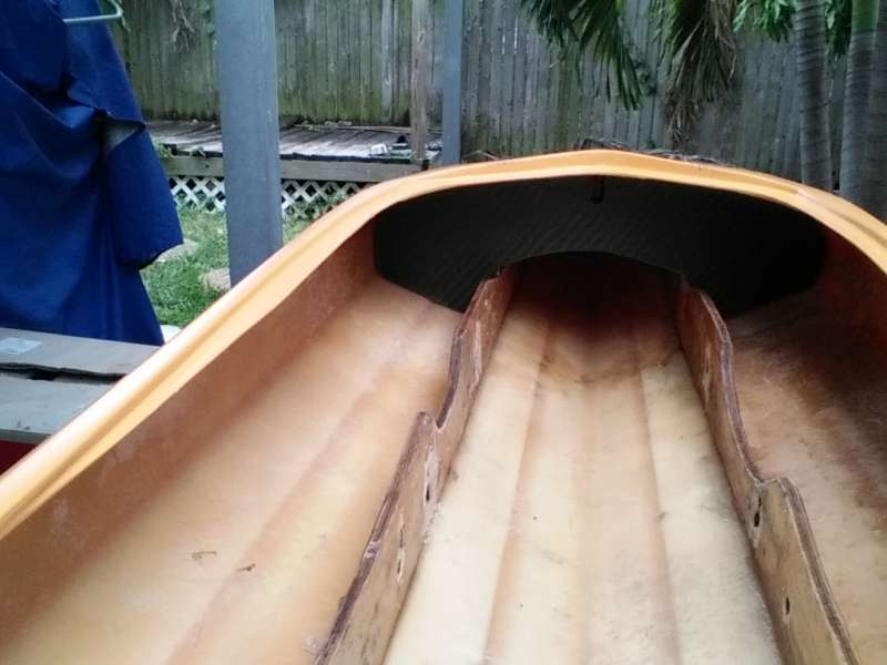

Rysquedases replied the topic: Retired Raceboat Refit
Carbon is done. Needs a few stripes and some buffing....

Why did you extend the strakes?

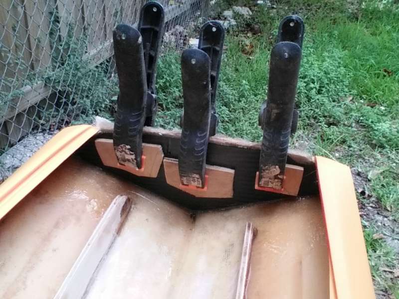

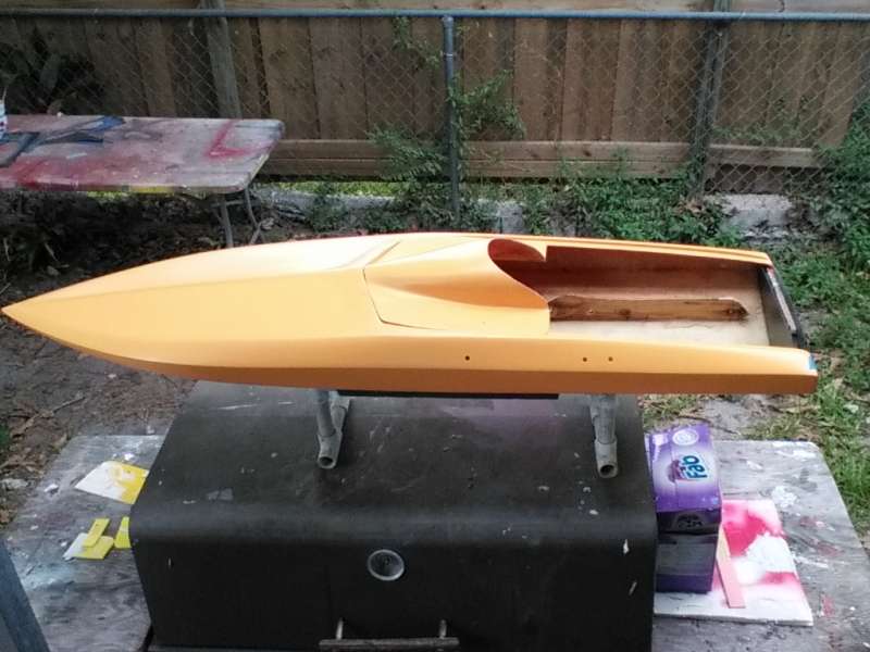

Used speed master hardware. Two fins a shortened stinger two small tabs and 6" standoff rudder. I did the strakes before the teardown and it ran with a lot more lift at the transom and wet the first run so I gave a hair positive on the stinger, removed the inner Trim tabs and it ran a lot dryer and was very stable. It should help with the added weight to the rear of the the boat.
Something else I'm trying is to mount the rudder about 1/2" closer to the prop to see what that does. It seems to me the headwear design and the stringer is dictating were the rudder is being mounted so I removed a section of the stringers to the transom.

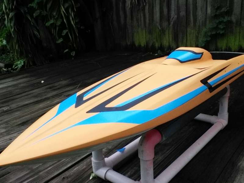

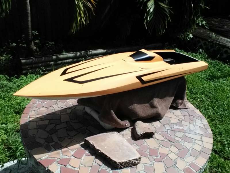

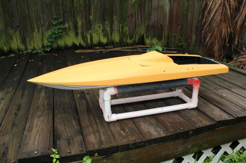

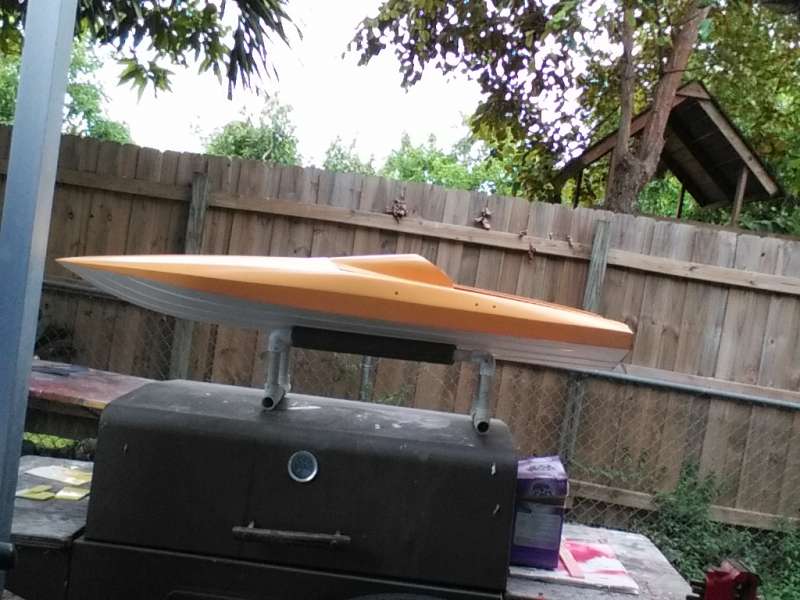

Still needs more stripes that contrast..

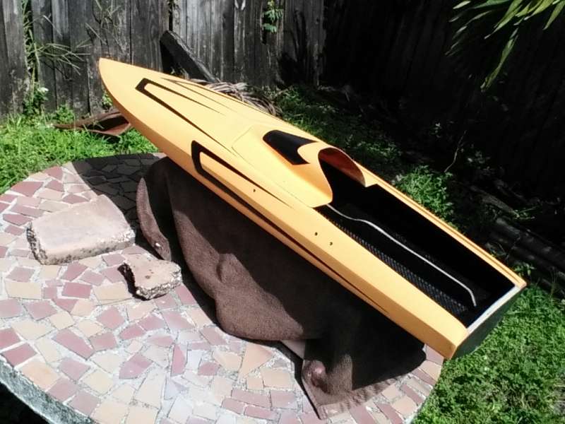

#24708
Now it's ready to put back together.

Motorboater replied the topic: Retired Raceboat Refit
I don't usually like hatches, but that looks really good. What make/model of mono is this exactly, I like it.
