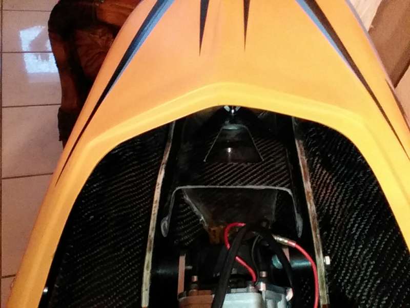

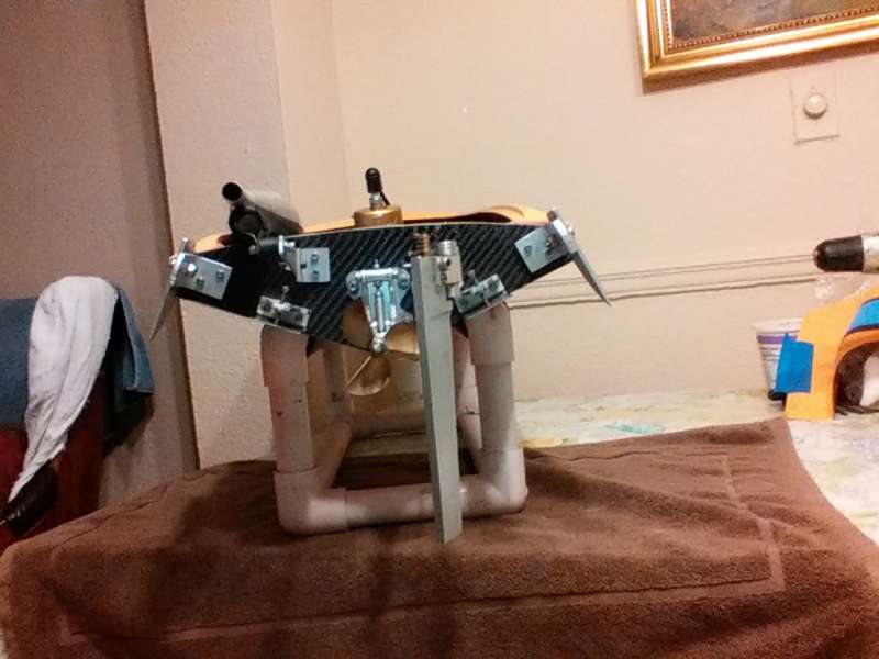

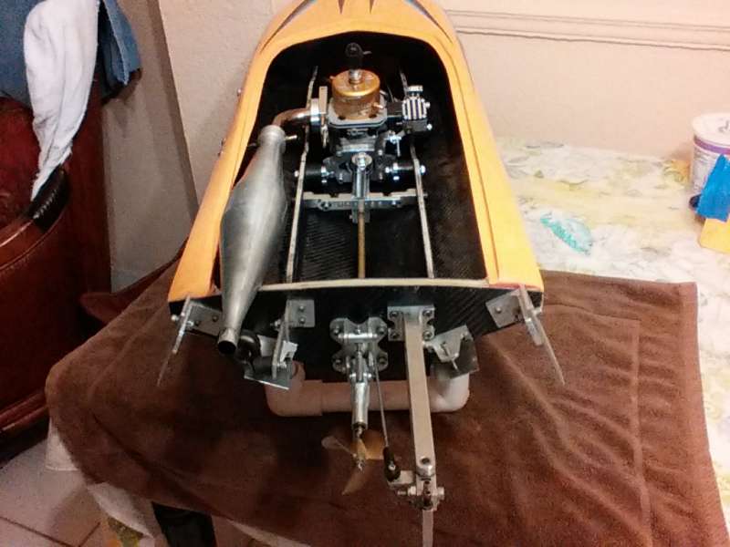

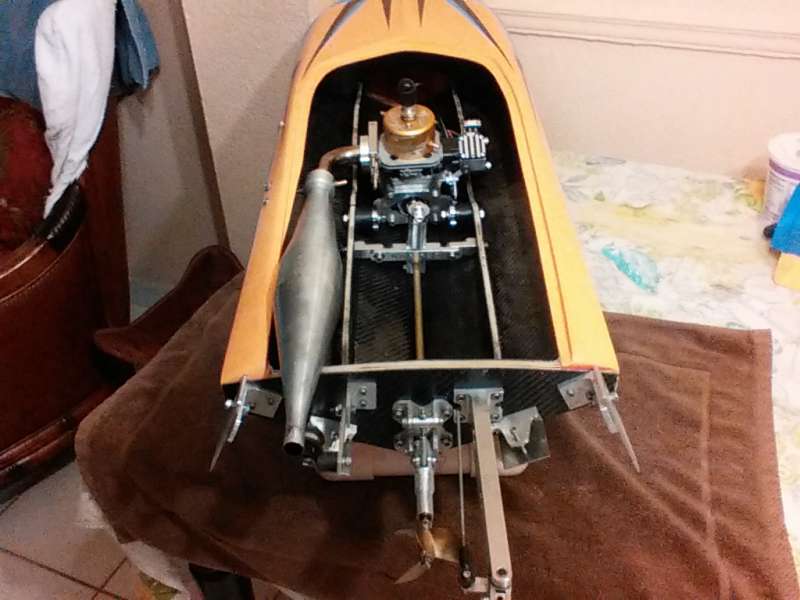

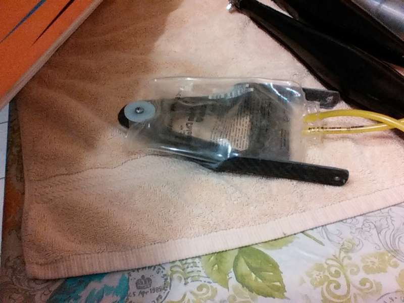

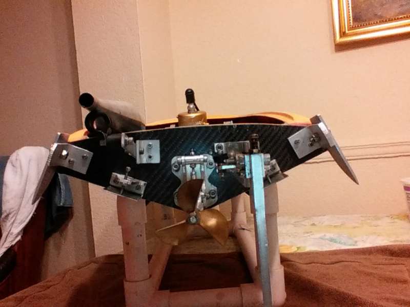

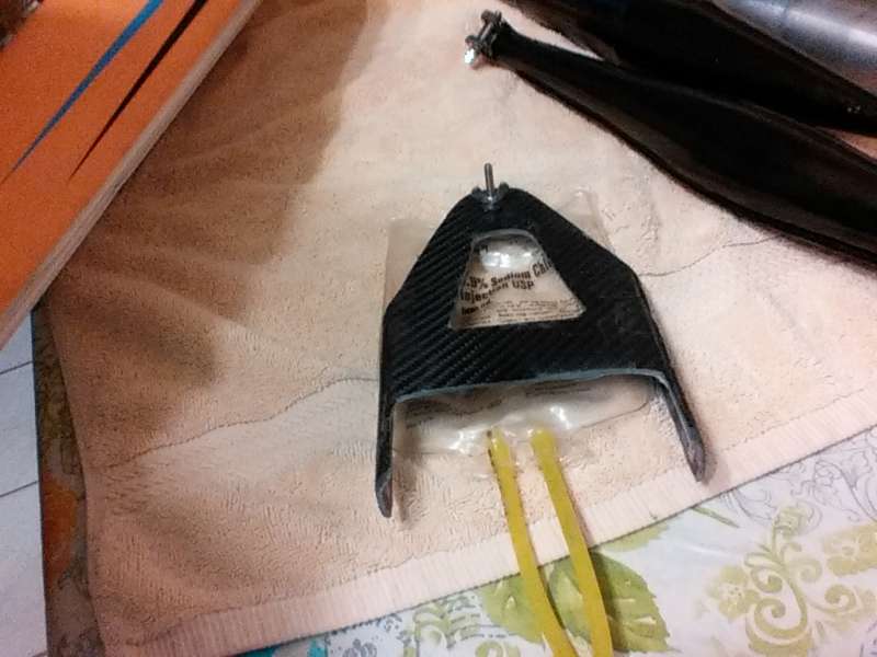

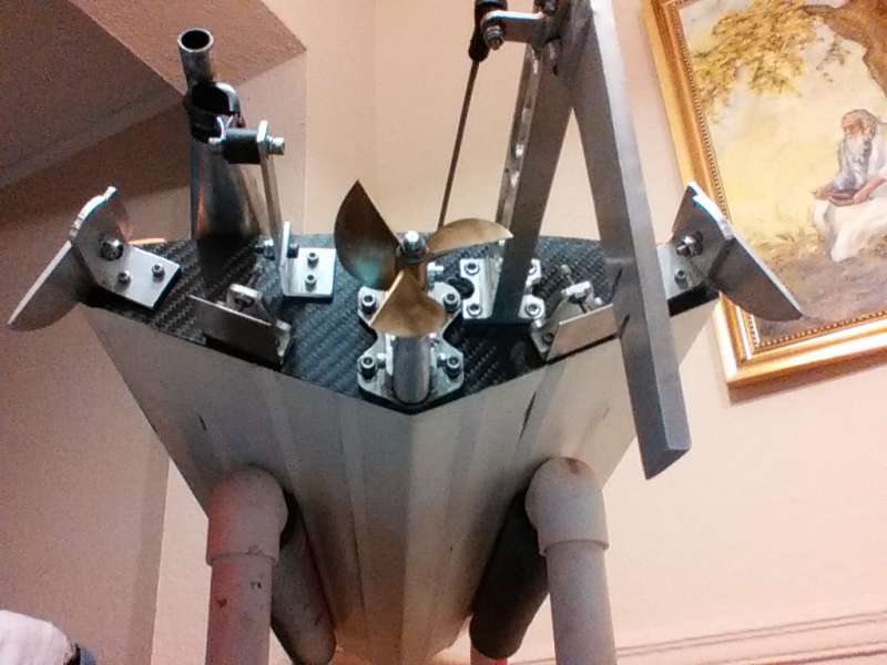

Rigging almost done. Rudder bracket almost up against the stinger. Eliminated inner tabs. Made adjustable turn fins ( back fwrd up down). Never been a fan of having tabs so close to the keel almost in front of the prop blades. Just need to make the radio box and fuel bag bracket.

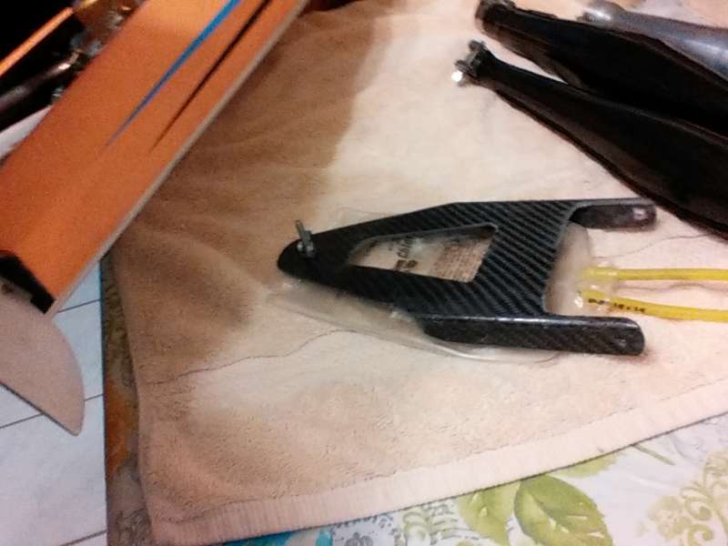

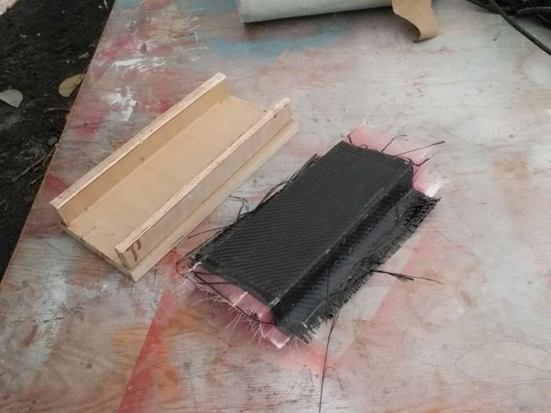

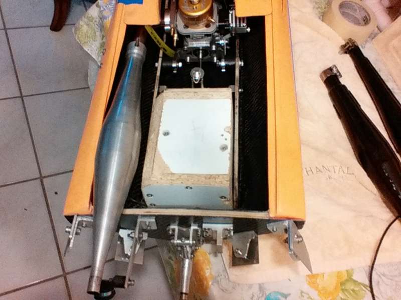

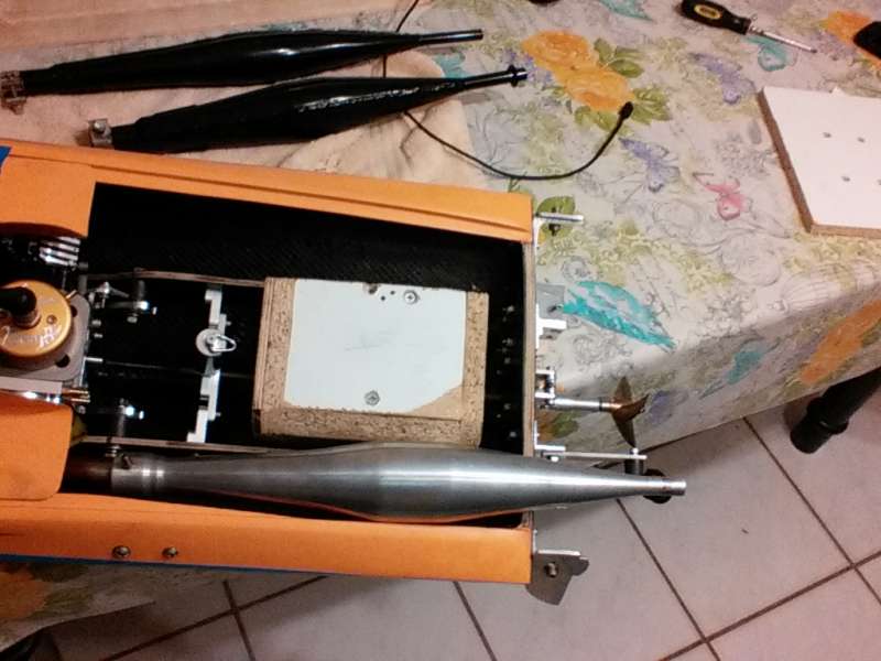

Got the gs bag mount done now working on a plug for the radio box.
#24791
Rysquedases replied the topic: Retired Raceboat Refit

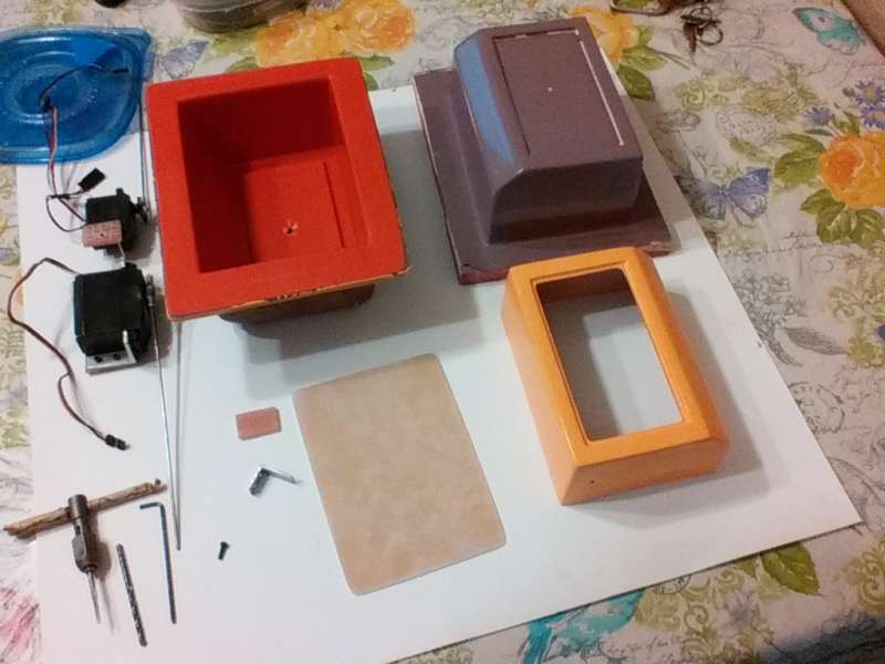

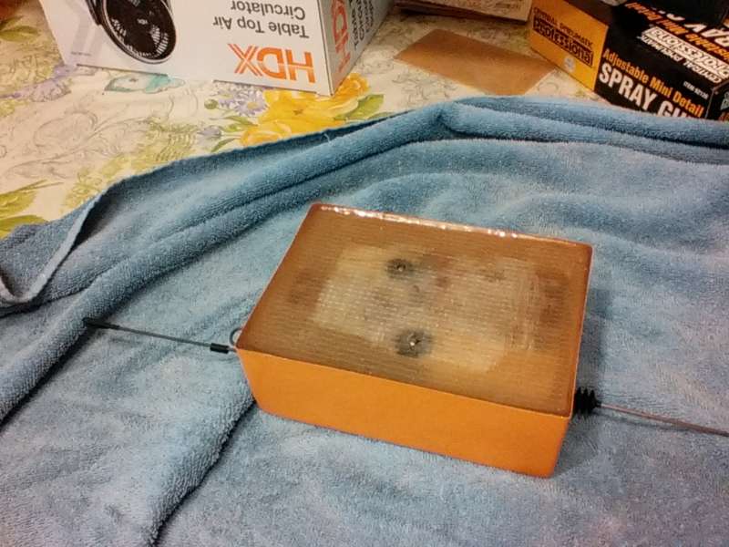

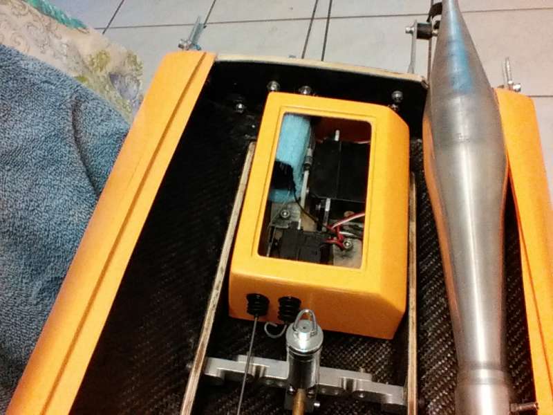

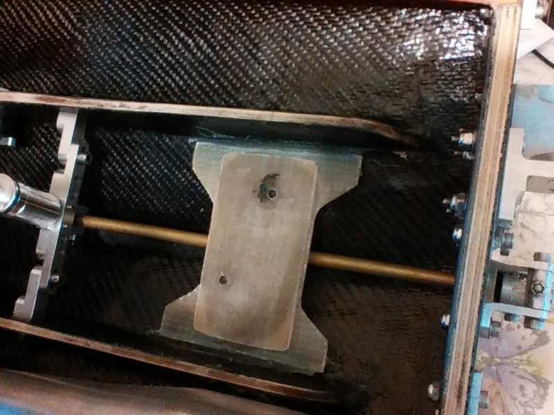

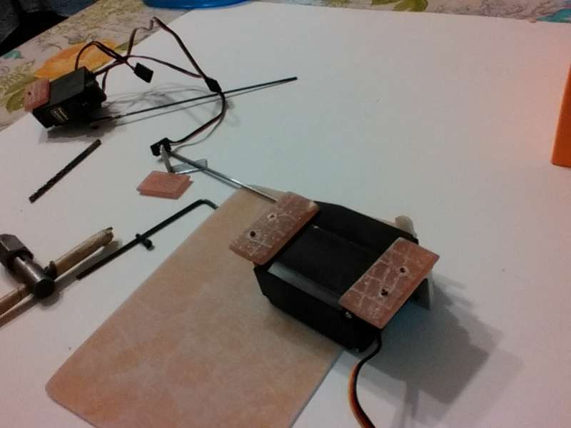

The radio box build. Decided on a angled side for the pipe clearance. The bottom is a fibergass panel with tapped reinforced fiberglass blocks for the servos and a panel that can be tapped to secure the box that is bonded to the hull.
