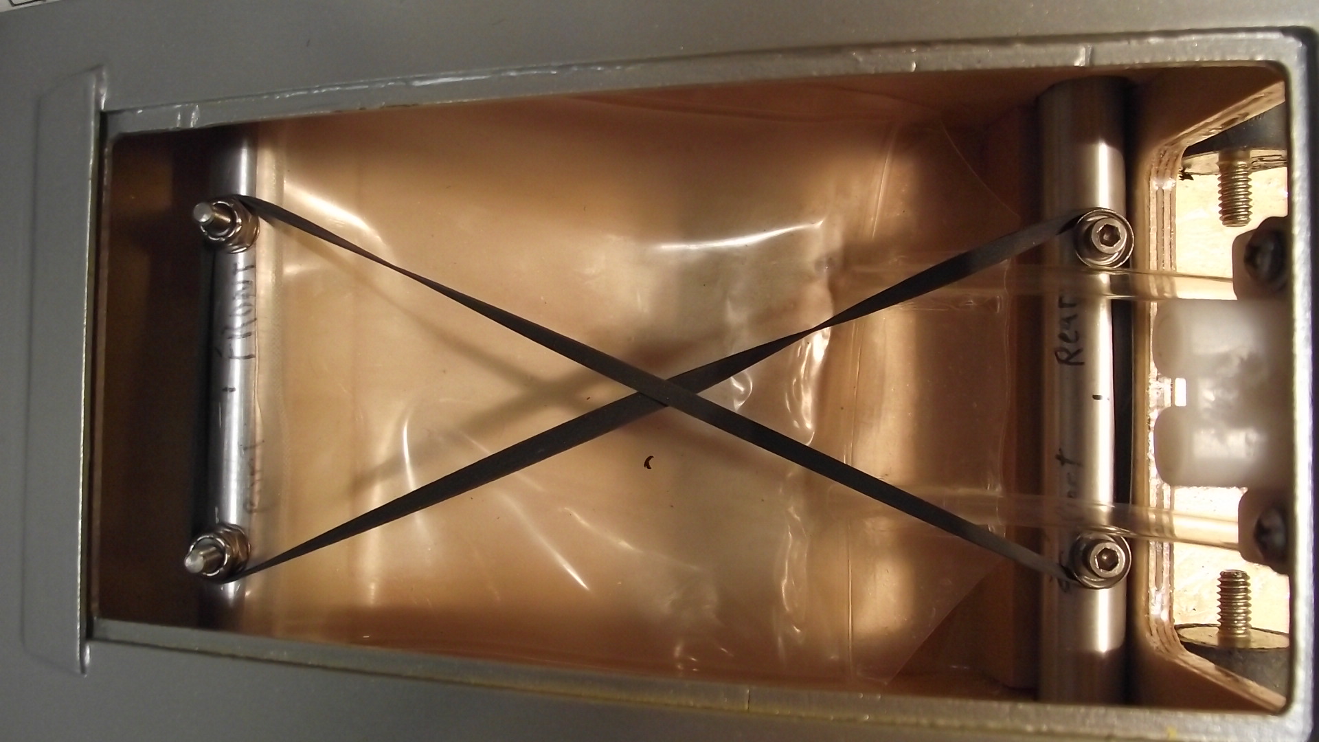

Used a couple cone washers upside down on rear booms screws to create a catch for a single rubber band crossed over making an X to retain fuel bag.

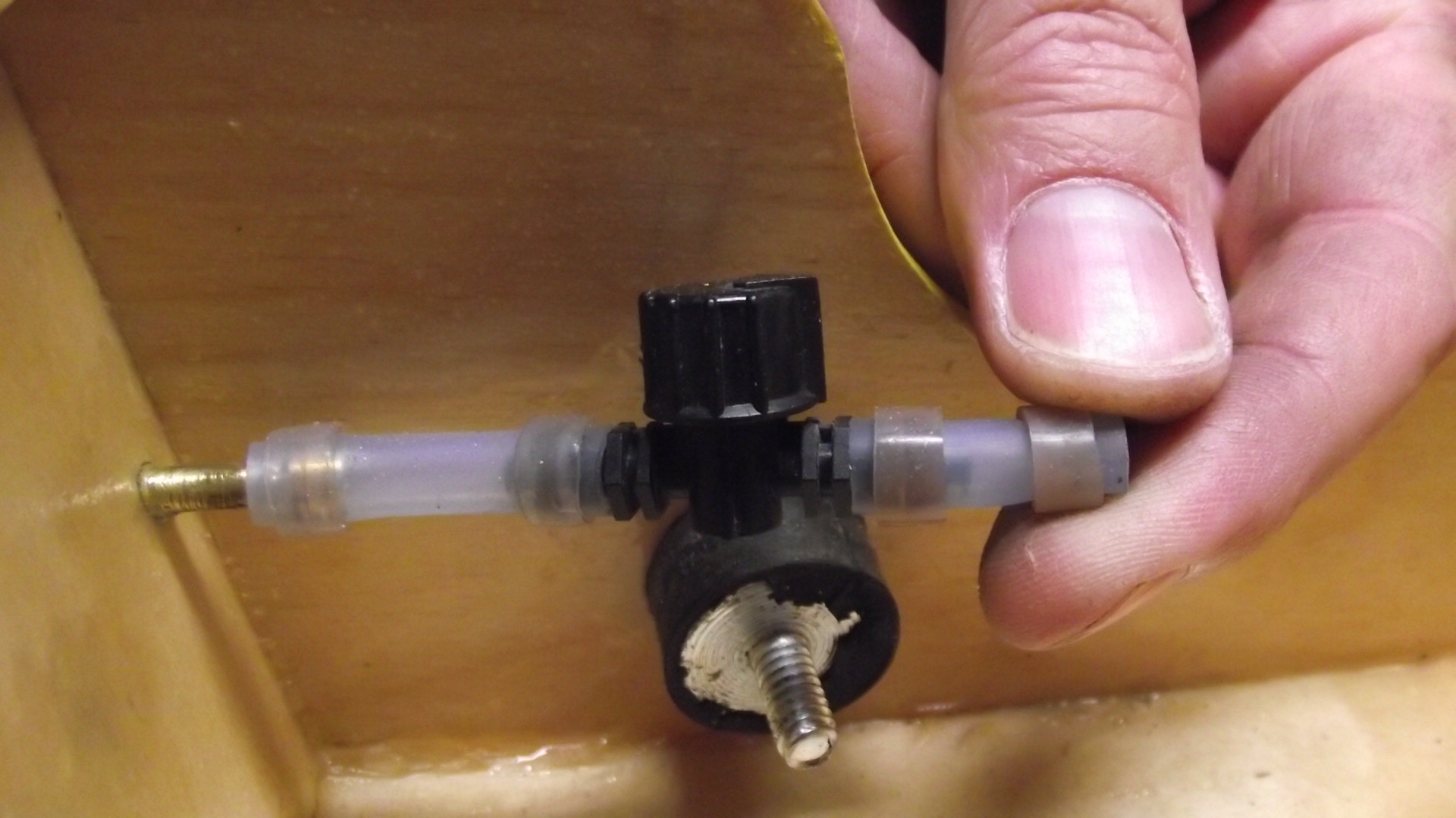

On cooling water line placed an inline valve so water flow can be restricted in cooler climate and engine heat can be better managed.
( This just a double barb garden "Drip irrigation" part )

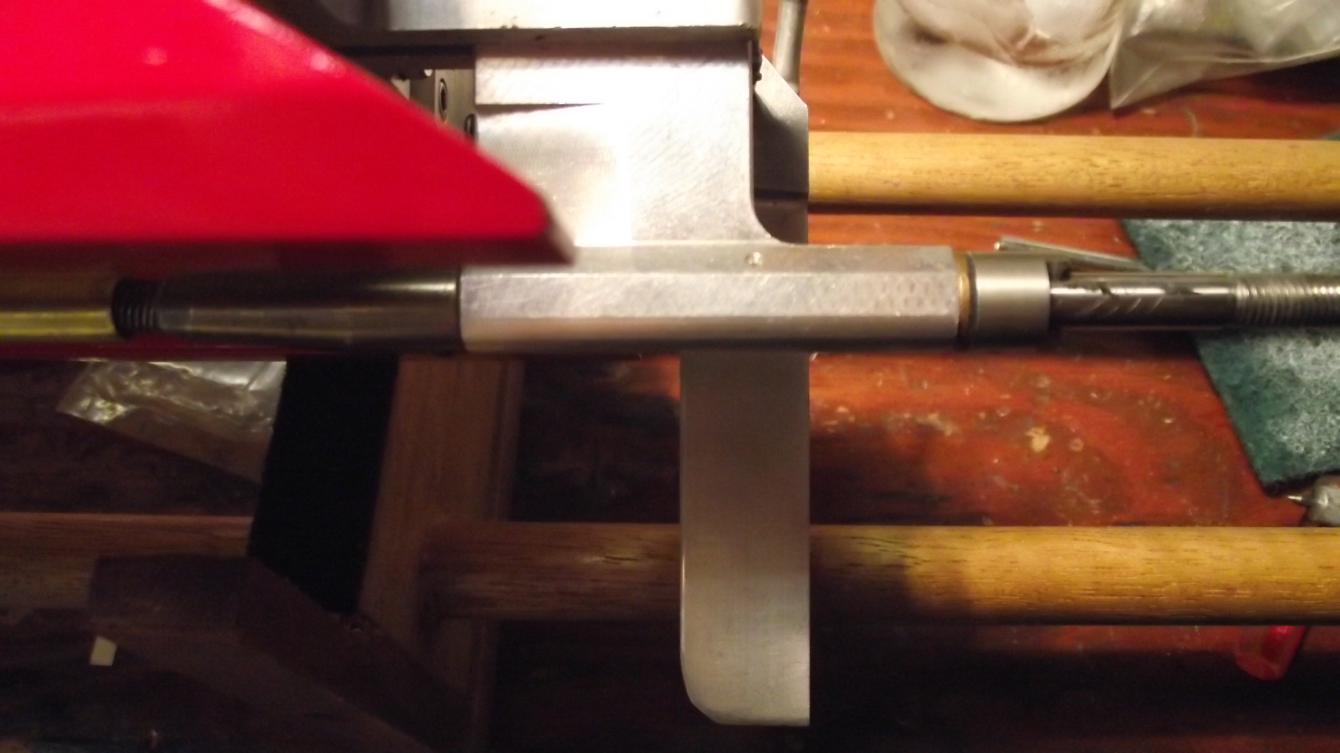

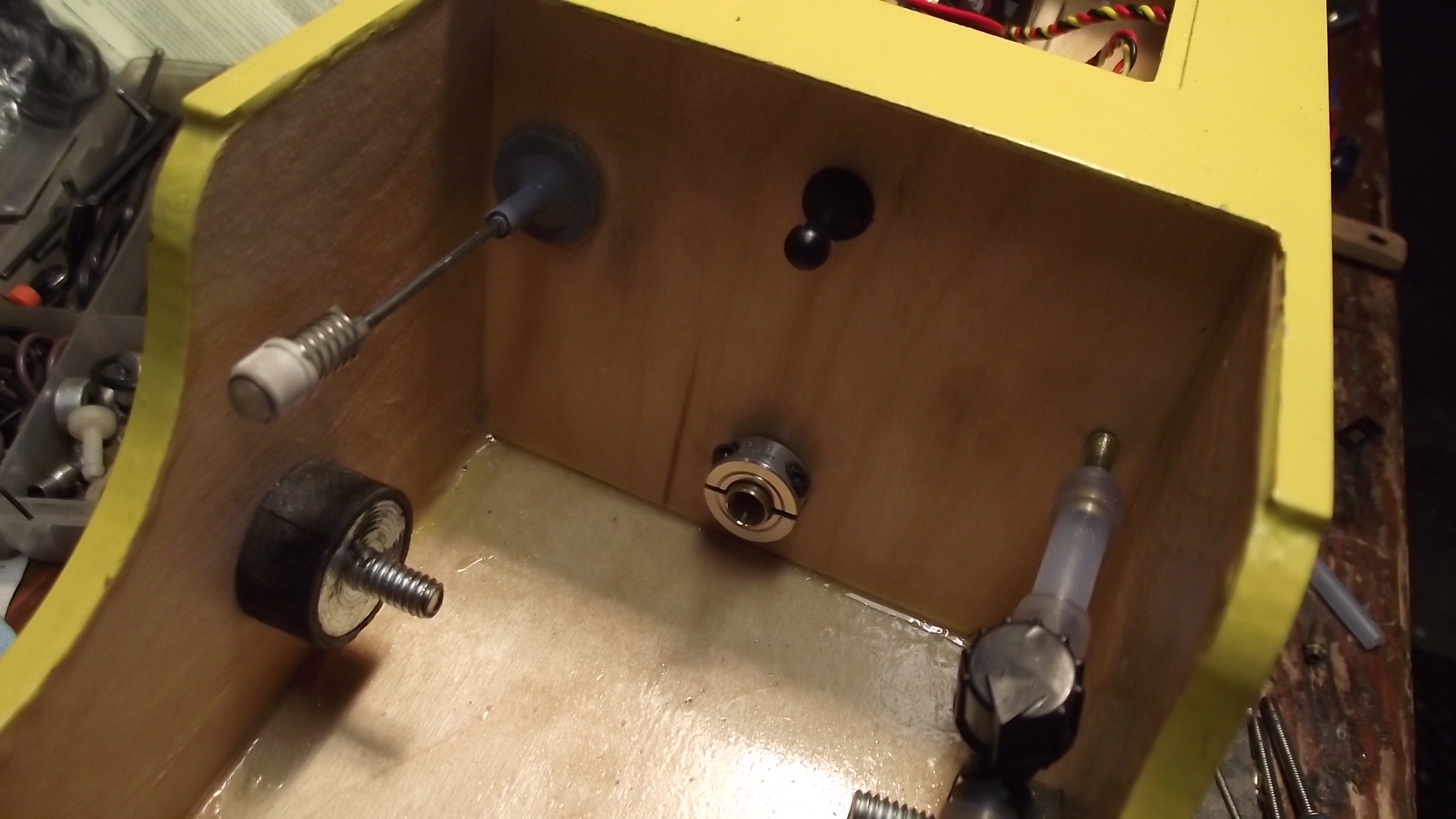

Where stuffing tube LOG exited bulkhead took a slit saw and cut into it @ 1/4" lengthwise.
Doing so allowed a 11/32" split collar to go around it and when tightened firmly hold the 5/16" stuffing tube within it from moving.
Radio on/off switch mount ( Dubro Quickswitch ) placed top middle of engine side bulkhead for easy access.

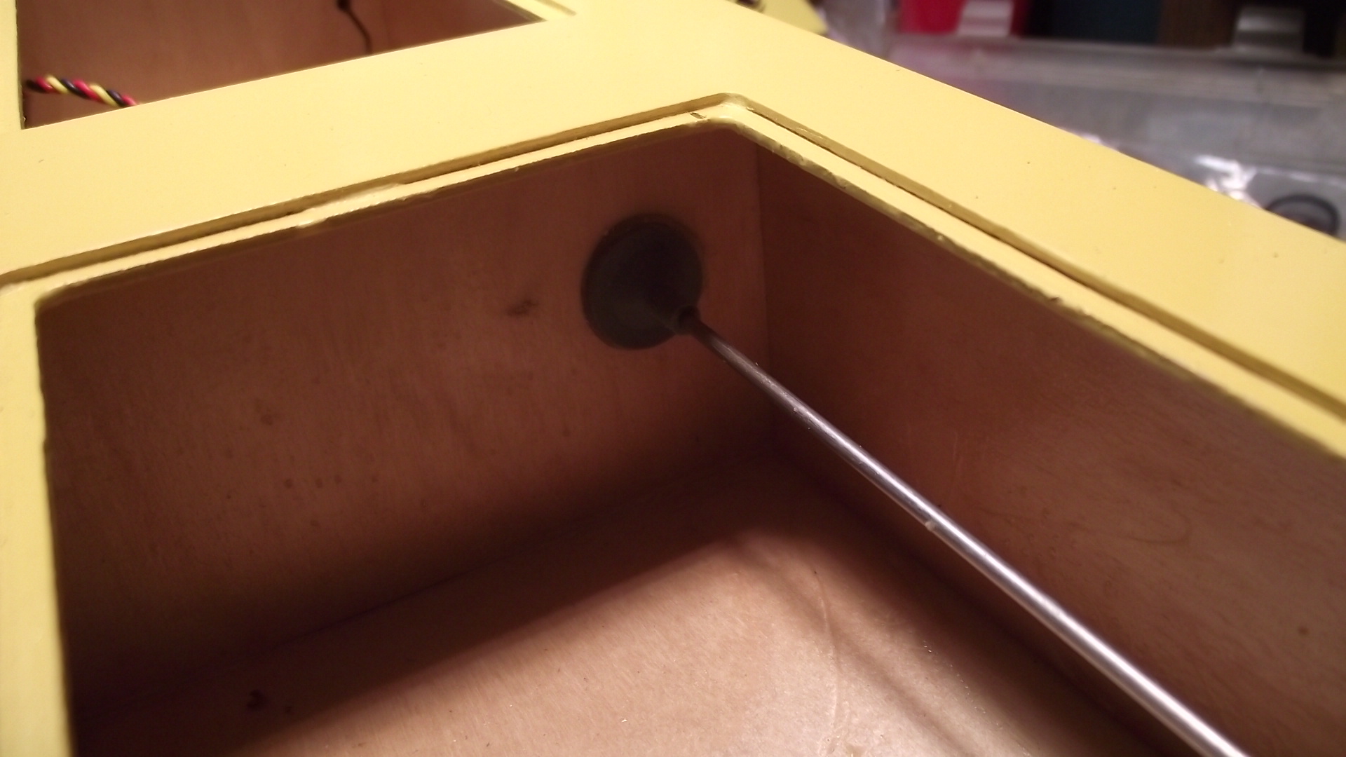

Push rod seals the most excellent "Prather" now sold by Hyperformance products. 2-56 size on throttle & 4-40 on steering.
Sullivan ball lock clevis for throttle bell crank connection.
Being I have chosen to place all radio gear in forward box, steering push rod seal ends up on interior of rear box.
Now with the steering push rod needing some wiggle room exiting transom and really no simple way in placing another push rod seal there will just leave the rear box unsealed. ( it still will provide flotation when lid is taped up so really not worried ... tho being the dead space in there cut down a piece of pool noodle and stuffed it along side push rod. ( If tail weight is required the noodles hollow core is ideal for a few fishing sinkers ;) )

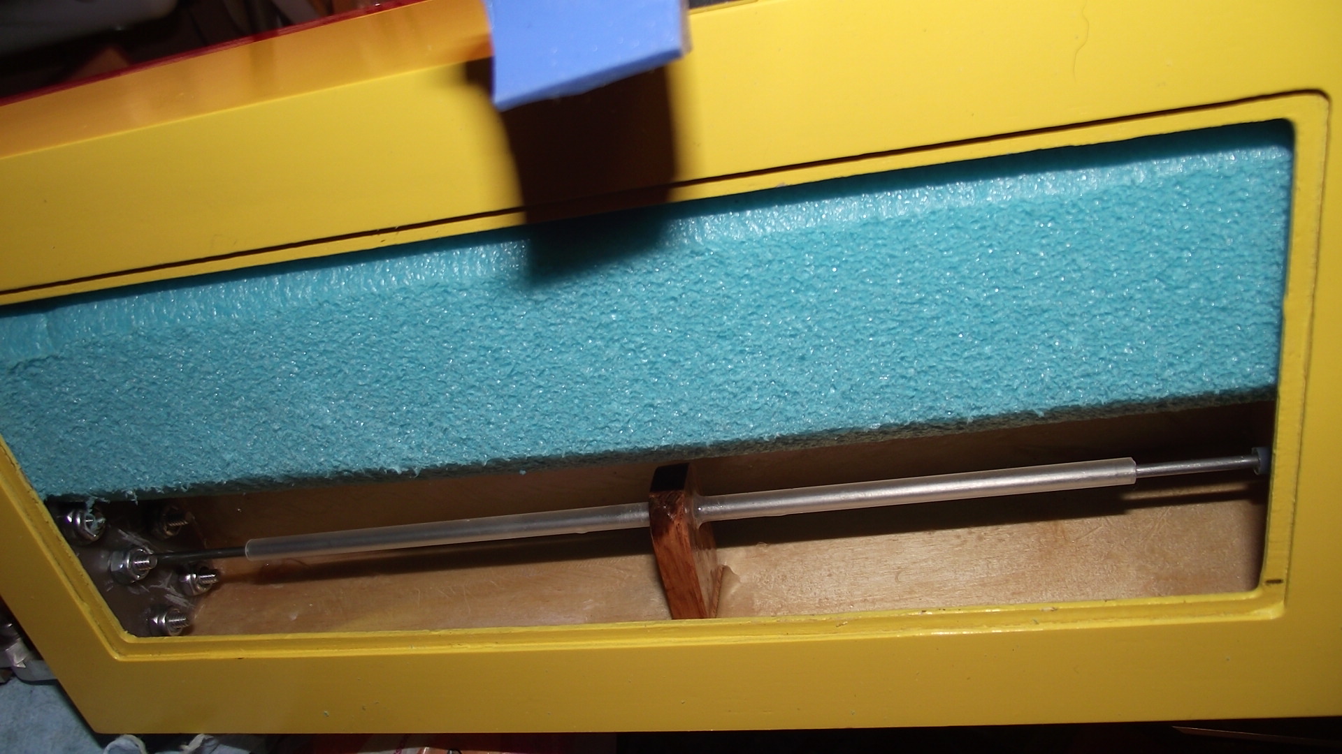

Started thinking HOW LONG the steering push rod was and figured it being supported would take away any chances of flex or vibration. Short piece of nylon 4-40 guide tube threw a wood block secured to tubs side was just the ticket.

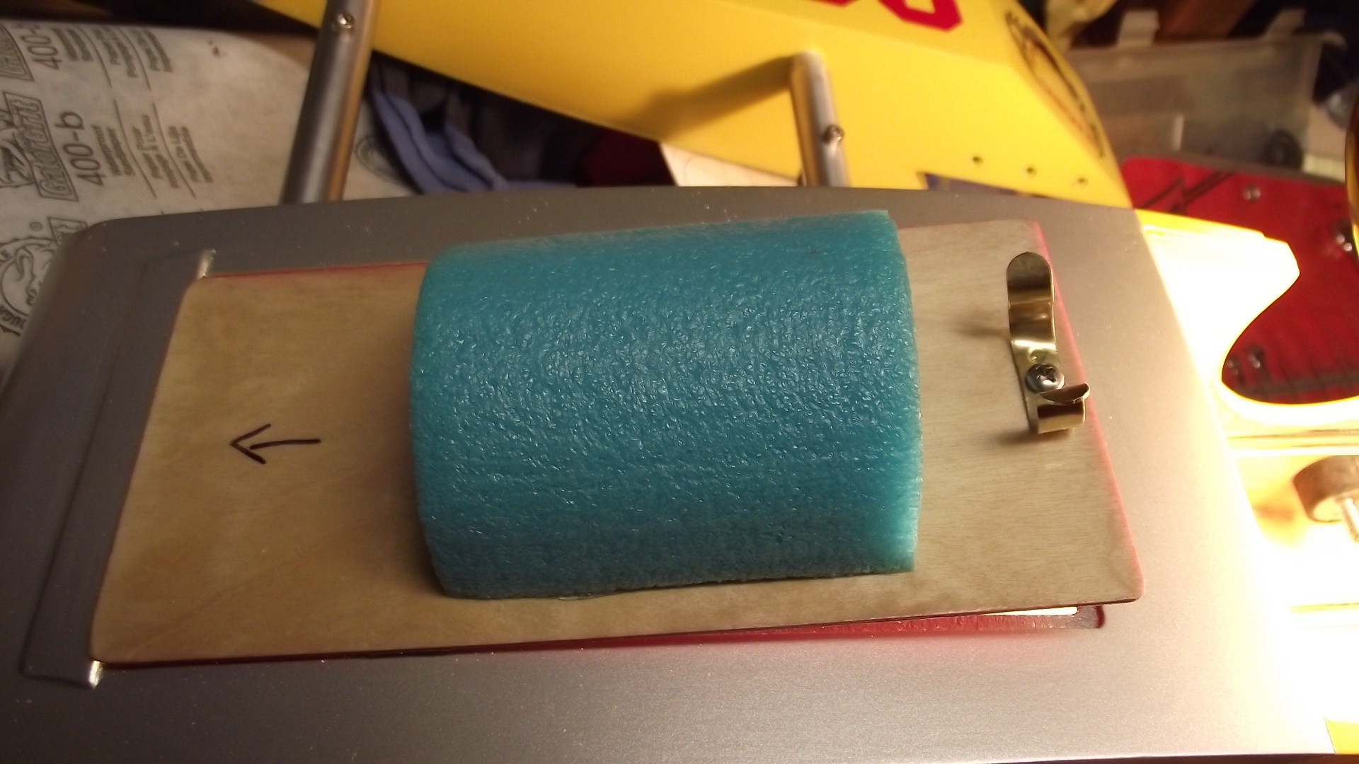

Also a bit of extra flotation added under tank cover ...

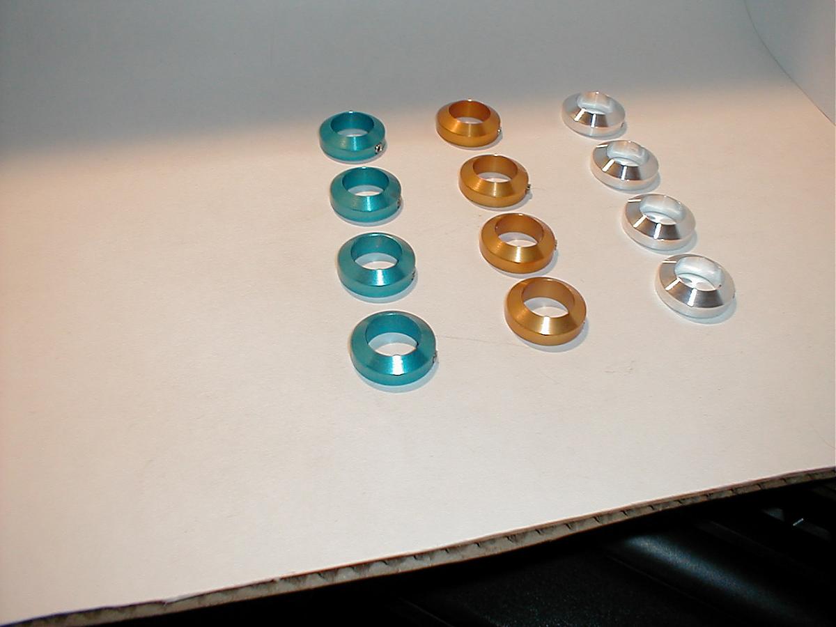

Collars
Do u guys know where I can find a set of boom tube collars - perfer blue

Canadian Hot Rod RC Boats replied the topic: Re: MGB Warpath ... Gas Rigger / rigging and set up info
Thanks Guys I talked to Bob on Jim's today and he has a blue set I can get
I hope 5/8" was right cause that's what he had. I checked tubes and looked like 5/8" to me
I need to find that little 11/32" collar that Scott used for a clamp on the stuffing tube. Then I actually have a weekend I can work on it

That split collar started life as a 5/16" :P Placed some shim stock in the gap of both sides while tightening screws, put in the lathe chuck running a 11/32" drill threw it ;) .... You should be able to find 11/32" split collars too.

Check out GasRCProducts for the stuffing tube clamp...Vince has some real nice ones.. I have a few here that I will be using on some future builds. Check out this article on the front page and scroll down a bit they're there. www.modelgasboats.com/New_Prod..._GasRCProducts/
Boom tubes are 5/8" O.D. so you should be good... that's pretty much standard for aluminum booms.
