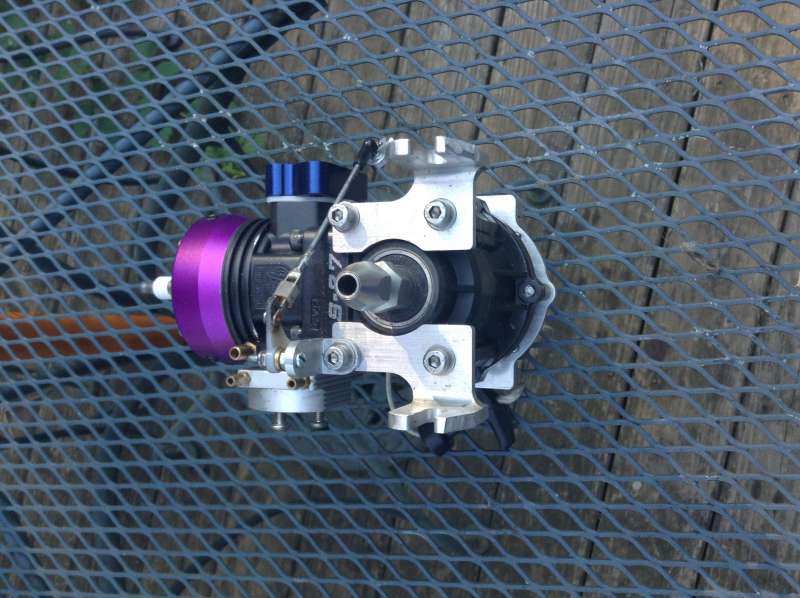

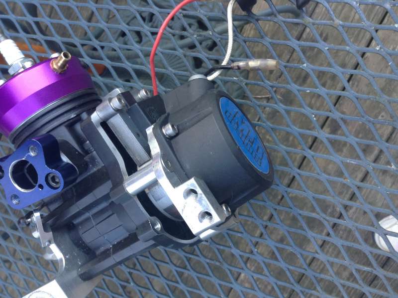

Marc ,I had a Pro ,what was the mount that will fit inside the tub this is the mount I had . This is the one I used ,now I can't recall were I got the mount.any help?

Steve Seebold replied the topic: MGB Warpath ... Gas Rigger / rigging and set up info
I can make them. I moved my machine 2 weeks ago and I won't have it up again for about another 10 days, but when I get it running, I can make them.
I can get them drawn and programmed while I wait so I don't lose time making programs once the machine is running.
I'm guessing they'll be somewhere in the $50 to $60 range. I'll have a better idea once I get them drawn.

315neil1007 replied the topic: MGB Warpath ... Gas Rigger / rigging and set up info
Thanks Steve it's the last race of the season. I decided to give this mount to Matt Smith one of our members So he can race in 2 weeks The coil reloactor has beed removed near the pull start. The tub is 4 1/2" wide. We will trade mounts just not sure were I got it from.

marc replied the topic: MGB Warpath ... Gas Rigger / rigging and set up info
I don't recognize those mounts at all. Most mounts are made for 5" rails when using 3/4" long isolators. Thus in most cases just swap the isolators for 1/2" long ones and you are good to go in the Warpath.
