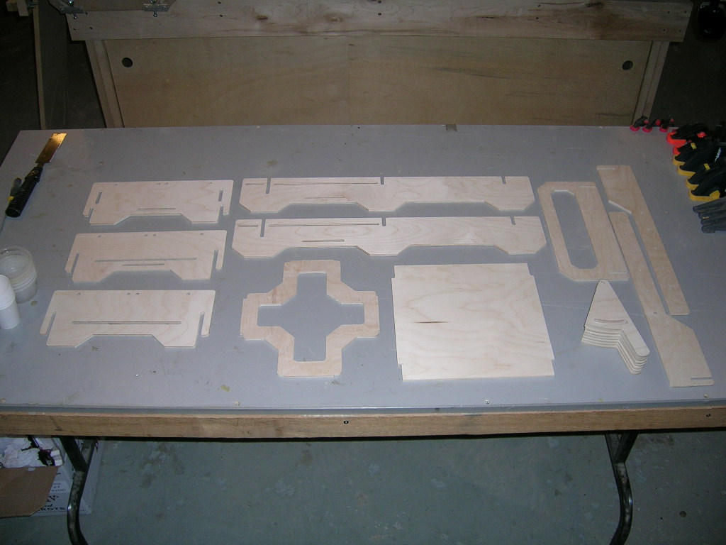

The Parts...

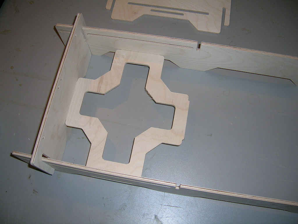

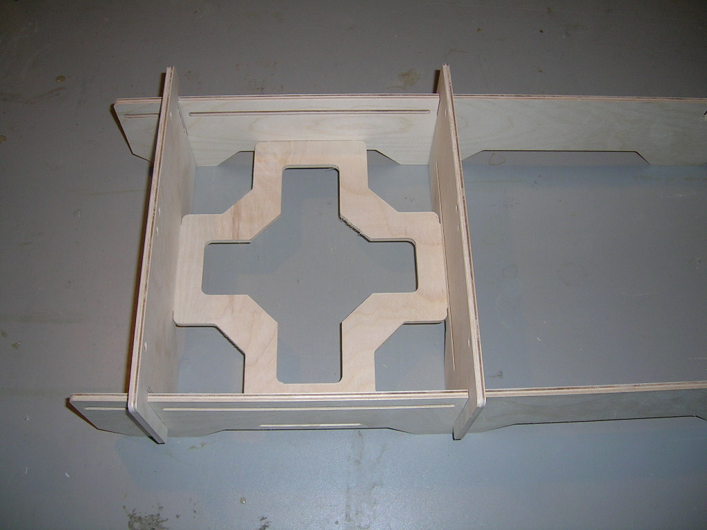

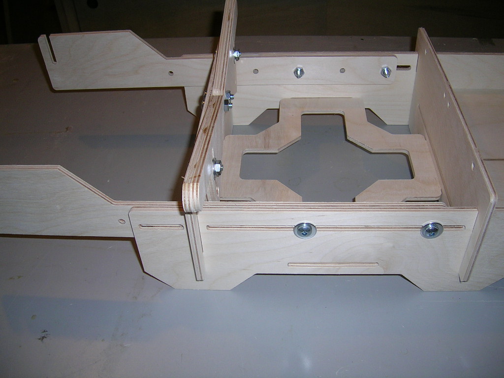

Install the rear brace (brace 1) between the two side rails then install the cross brace as shown. The rear brace is the one with two small 1.5" long vertical slots in it for the propguard. Keep side rails spread a little to get the cross-brace in.

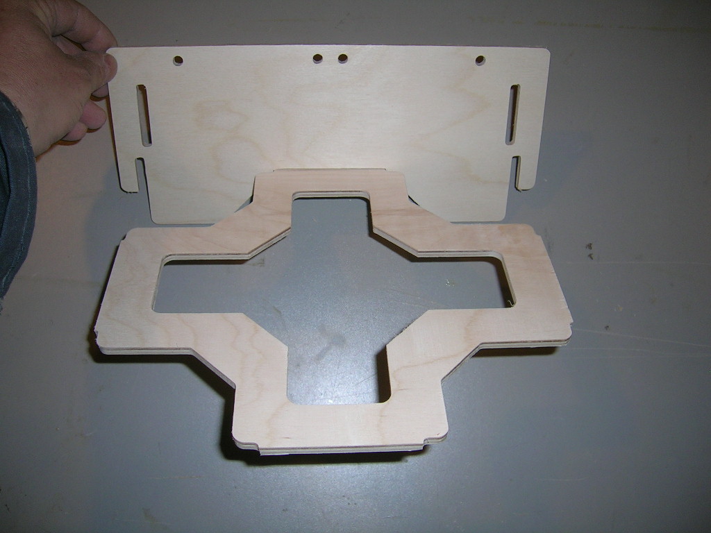

Install the second brace (brace 2)... this one will be more difficult to get in. You have to insert it inter the slots in the side rails and while doing so, lightly pry the bottom a little bit to let the cross-brace into the slot into this brace. Take your time, it works. Just don't overdo it and break the pieces. I've assembled several stands without breaking a single one.

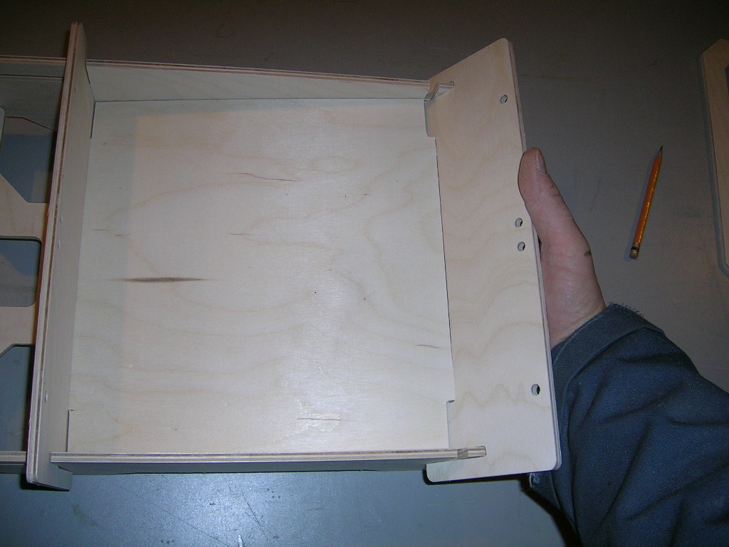

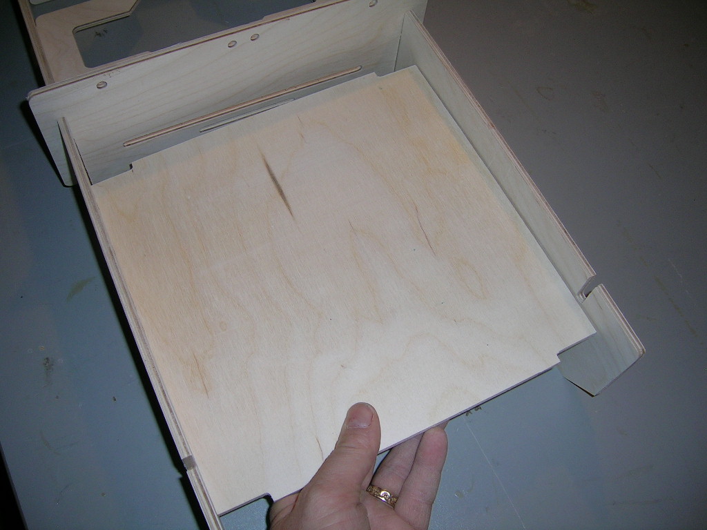

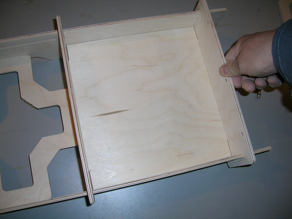

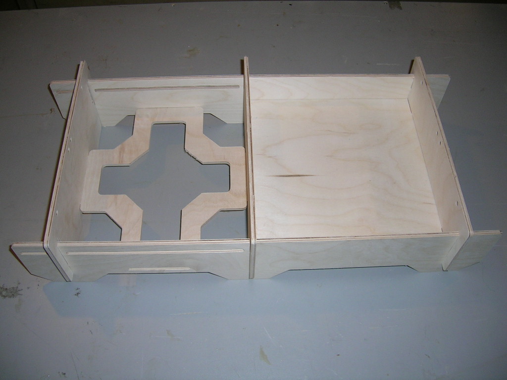

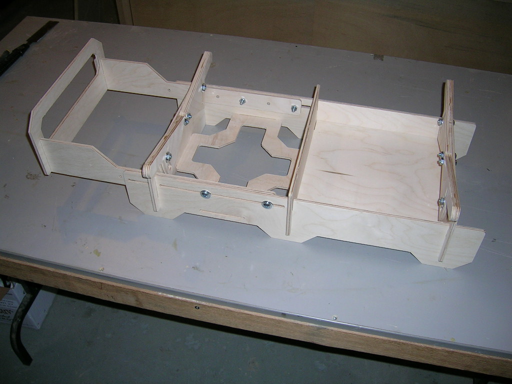

Now install the tool compartment bottom and the third brace. These pieces are easy to put in. Put one end of the bottom piece into the slot in brace 2 and then holding the other end up insert it into brace 3 and slide them down into place at the same time.

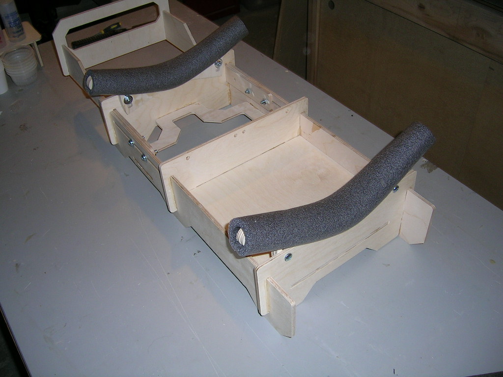

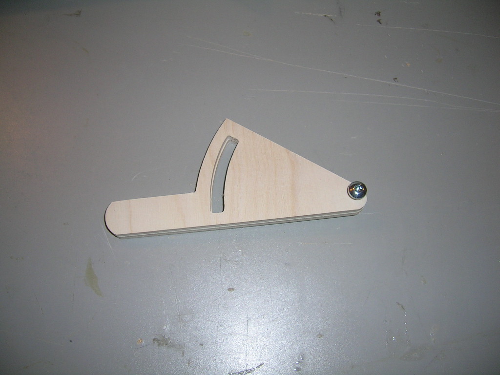

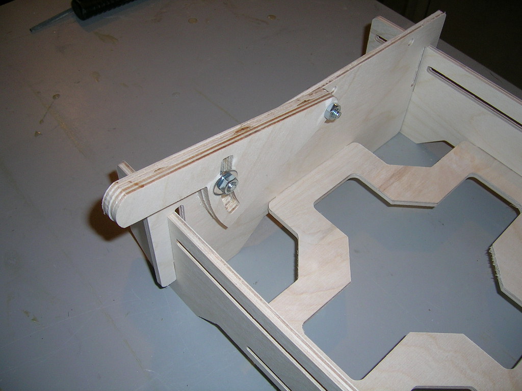

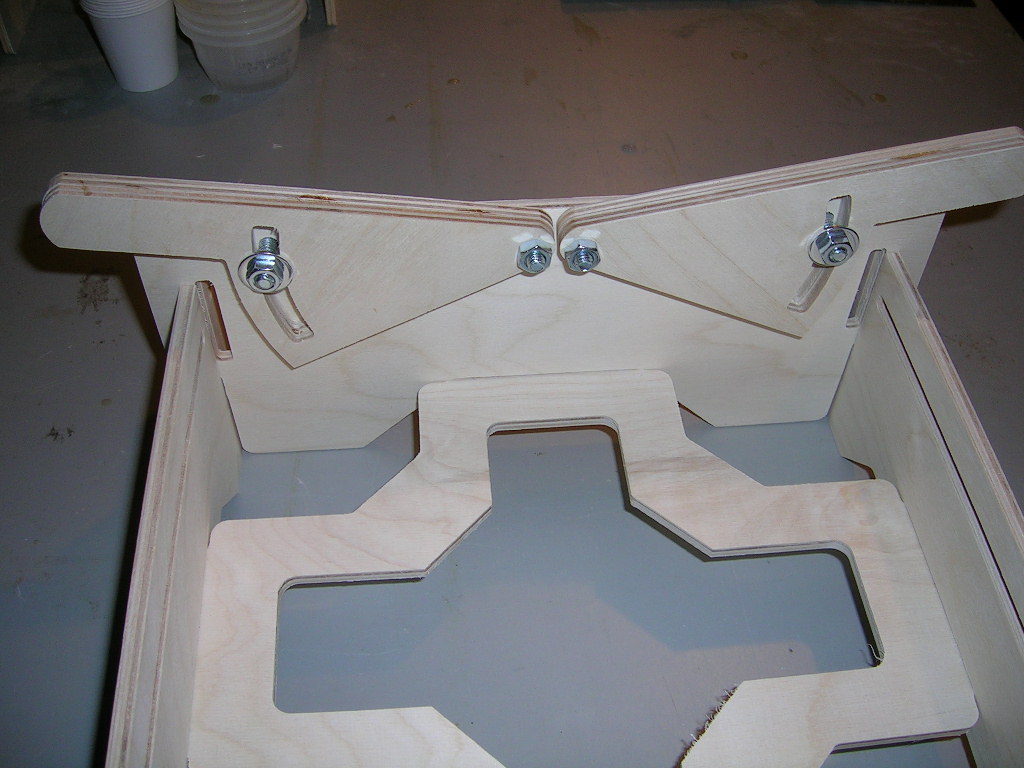

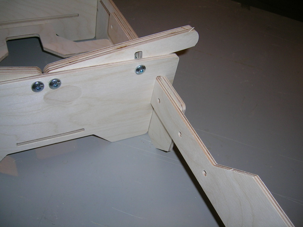

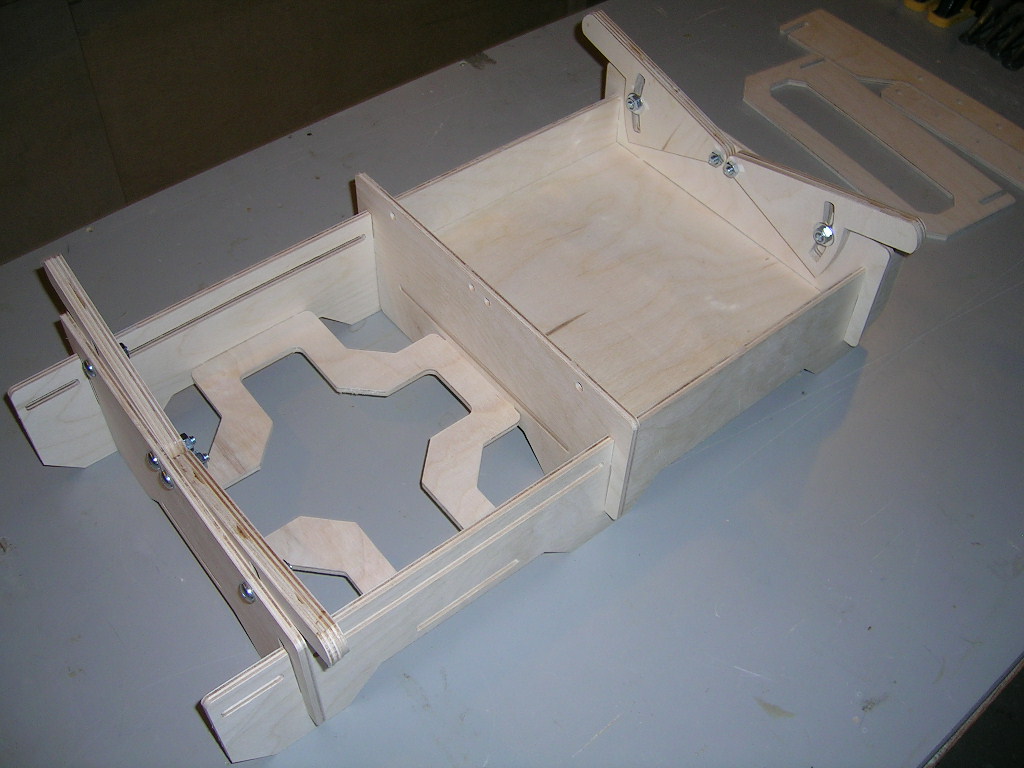

There are 8 hull supports supplied with the kit. Hardware is supplied to install them "doubled up". What I do is glue them together in pairs to make them thicker and install them in 4 points on the stand. If you want, you can install them individually and have 6 supports instead of 4, but you will have to supply 2 extra nuts/bolts/washers to do this. Pictured below are the supports installed "doubled".

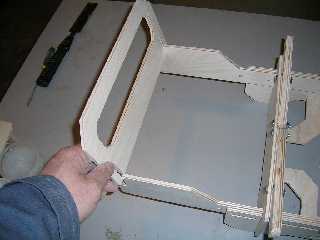

The propguard consists of two sides and a backplate. The two sides go into the slots in the back brace (brace 1) of the stand and bolt through the side slots as seen in the pictures below. The backplate simply fits into the slots at the back of the side pieces.

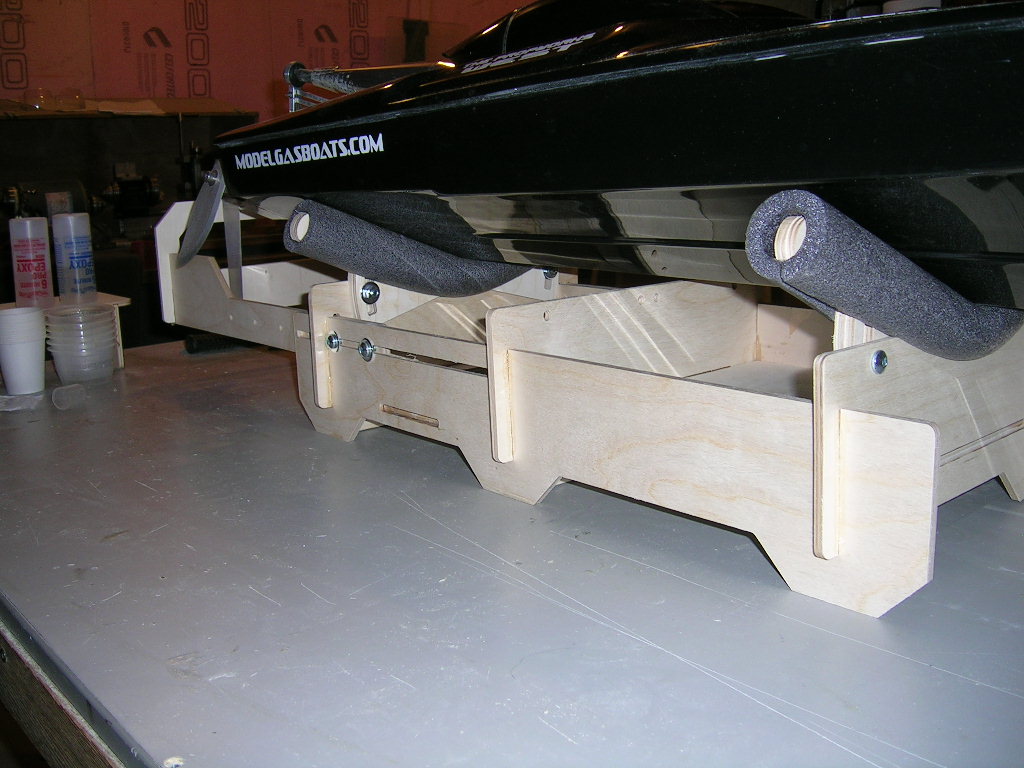

All that's left to do now is install padding to the supports. Pictured below is the stand with 1/2" pipe insulation foam on the supports...it works great and is very economical.
*** adjust the stand to your boat BEFORE installing the padding.
