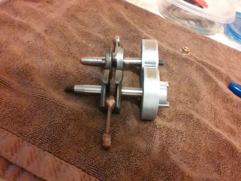

Rysquedases replied the topic: Lightened flywheel for Zenoah
Gizmos was working on spacers to use the TK small flywheel and coil for a zen bottom at one time.
Also the cy flywheel is a little lighter, light enough to make a difference but you have to space out the source coil notch the starter and grind off the paws if you want to use the easy start. The cy flywheel does not overhang on the crank like the Zen.
I'm also going to try using the CR crank and the CY fly wheel but I would have to use CR bottom and modify it with a front plate and spacers for coil and starter.
The only thing I don't like is the unsupported space between the bearing and the flywheel. That's why I'm going to a custom CR bottom end.
Look at the difference in space between support. 12.00 crank with no steps and 45.00 bottom complete with 4 bearings to play with. www.gizmomotors.com/index.php/...rankcase-detail

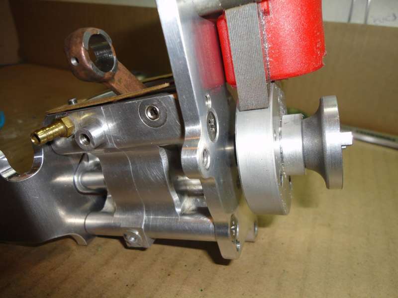

Canadian Hot Rod RC Boats replied the topic: Lightened flywheel for Zenoah
Gordon
I fitted the QD case with the TK small flywheel but nothing else will work (that I have on hand ) (Zen / MK) not sure about TK - maybe MK SX case will work. Another issue was the crank - I had to use TK crank to get proper spacing with crank taper on front
- just me though sure others have fitted it before ... :ohmy:
Here is QD (first fit) - will go into LZ as well - -- should have this ready soon - tweaking it for next week
RD

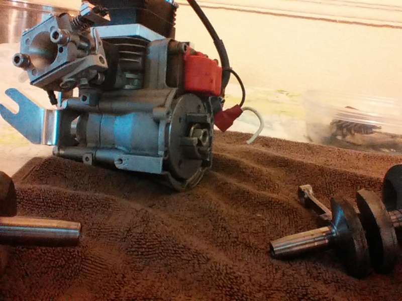

I think it's safer to use a lighter fly wheel. I don't know that you can remove enough material safely from a Zen to be as a CY in weight. The third pic shows how close the CR crank with the CY fly wheel comes to fit in a pum case, less than an 1/8".
This post is wrong about what I said about the third picture and the crank crank. Flywheel is on the wrong end. :silly:
Also want to point out that it looks like I would have to shave off about 1/8" between the CY flywheel and CR case. Won't know for sure till I get it.
