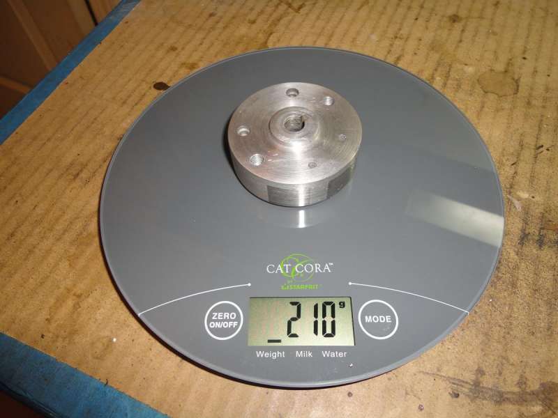

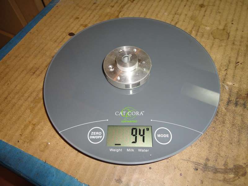

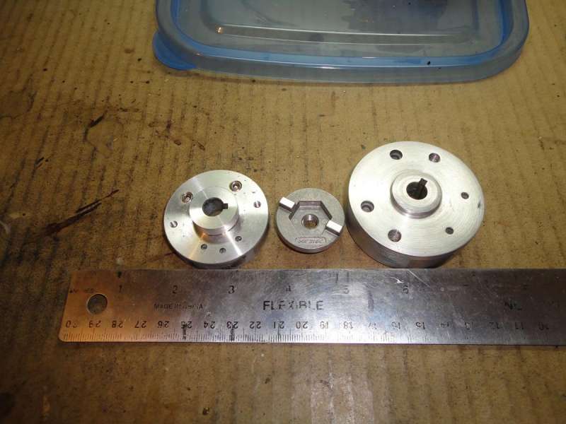

Have you actually raced them with lightened flywheels? Not trying to be rude just curious -- I hear guys say that "They have heard" it but have not run them that way
I would think - the boat who gets the revs up first would lead out of the corners :laugh: the boats are already 'spooled up' (reved up) so it's not like you need the torque to get it rolling (heavy balancer) - it is already rolling ????
Just seems funny that guys pay for lightened pistons and cranks to rev faster - but believe that a heavy balancer would not be a factor in faster revs - guys worry about a 28g piston vs a 20g - (8g) but the TK balancer is 94g vs Zen 210g (116g)
Just curious - thanks

You can eliminate the flywheel altogether and run EI.
The only problem with super light flywheels/EI rotors is that they are harder to pull through compression.

I plan to take a 16th" off and bevel the diameter of the ( CY ) flywheel side that faces the case and see what happens. As far as the lightened ZEN flywheel goes, I dont remeber the last time I seen one advertised since a picture of a busted one on another forum or to risky to try. I think the magnets are to wide ? It would be nice if Zenoah had other flywheel options like the younger manufactures.

I have a couple of the 20 EI - that's why I was wondering about why more guys don't run lighter flywheels ??
The 20 EI's rev rather well....
