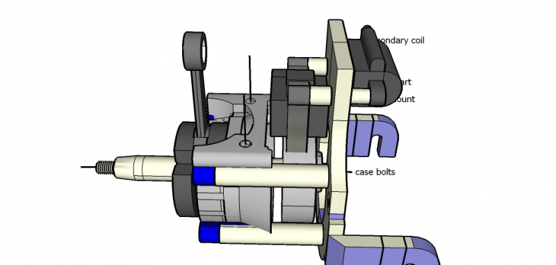

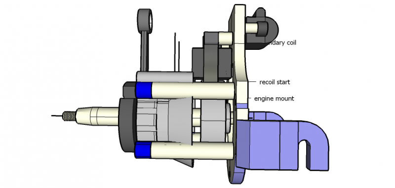

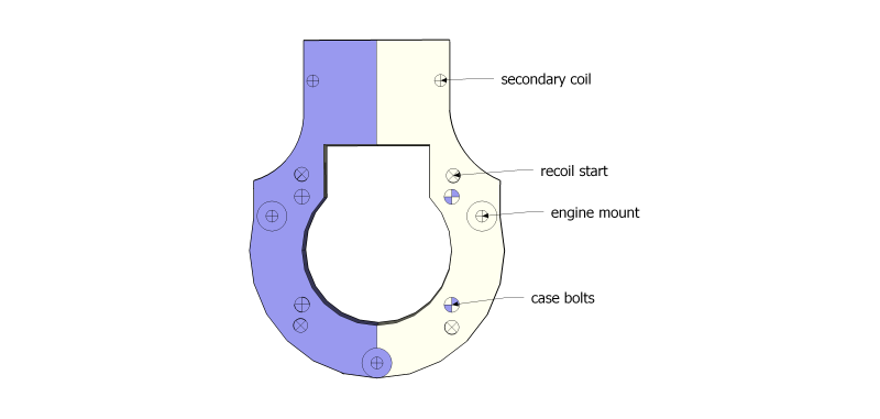

I have done drawings to check it out, I also have ordered a stock rotor and coil to do a test fit. I was originally thinking of making a bracket that would bolt to the Zenoah case using standoffs and longer case bolts. Replacing the front part of the Zenoah case that the engine mounts bolt to.

here are more images of my thoughts...

I think it may work if you leave a big enough hole in front to set the gap on pickup coil, may be tough to tighten pickup up (room behind to get wrench or key in)
When your mobile come over and we'll see if we can cut something out (brother has new lazer) if we make a pattern he can cut it out - I may even have a front mount or two we could use (the TSB) ones are a similar plate.

I am working on a bracket, because the TK rotor (flywheel) is smaller diameter =less weight. Since the flywheel is a smaller diameter the Zenoah primary coil can not be used, and the TK coil has different mounting holes. Hence need for a custom bracket. The first idea was complex as pictures show, I'm currently working on a KISS design.
The TK flywheel uses the same key way but the hole has a different shape, hole on the back side is the same but the hole on the front is slightly bigger. It's not perfect but it should work with very little problem. I'm planning to use a TK crank so I wont have issues with the fly wheel.
