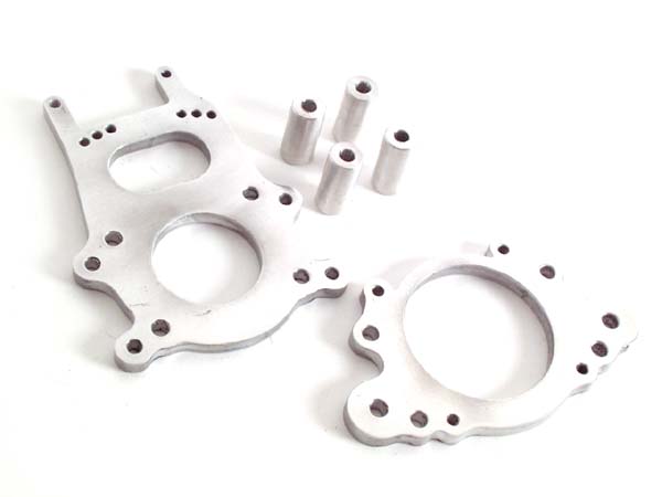

Randy the primary coil mounting plate is what I'm thinking of but on the outside of the flywheel. RMCK makes a similar plate for the sx254 also a "tuning" plate for Zenoah. The newer QD plate is side mount coil don't think that would work.
following are the 2 RCMK plates
The plate would allow the mounting of smaller dia. flywheels and their coils.
