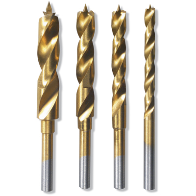

So, I've ordered a right angle attachment for my dremel. What bits do you guys use to drill the holes for the engine mounts etc in the stringers?

Dremel makes a set that are for that tool & wood work (brad point)
www.dremel.com/en-ca/Accessori...aspx?pid=631-01
