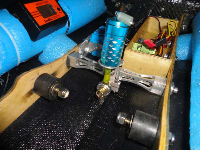

I'm just about finished now I think, but I have one last (hopefully) question:
Whats the easiest way to drill the hole for the oil in the stuffing tube?
Thru the the T-bar or by taking it part and trying to line it back up again? My drill chuck doesn't tighten on the 1mm bit and the dremel just slides off when drilling thru the T-bar.....
How do you guy's do it? Or should I just use grease on the flex and not worry about the auto oiler thingy?...
#25148
Canadian Hot Rod RC Boats replied the topic: Need help setting up a mono for the first time.
I'd try grease first because you have a liner in the tube. Hard to keep liners from shifting so if you grease it you know you have lube. I use oilers but I don't have lined stuffing tubes
#25149
Jase replied the topic: Need help setting up a mono for the first time.
Sounds like good advice. Probably better for the environment too, plus I was wondering how the liner was going to stay put.
Even with a cable tie I had doubts about it shifting. And I'm used to greasing before every run so that will be easy to remember.
If you use the proper oil - it's not that bad - I run Stihl bar oil
www.stihlusa.com/products/gree...d-fuels/biooil/
The cable spinning creates heat so after a bit the liner will kind of wedge itself inside - till then then zip tie will hold it in place .
We always put a felt pen mark on liner and tube to watch and check (once in a while) to make sure the liner doesn't spin.
Your boat is looking good - should be a quick little begger :side:

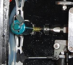

the solution to the liner is to just run the right size tube with no liner - my mono's all run with 5/16" (,018 wall) with 11/32" over top it
  • The two pieces are soldered at transom end (Together to stop tubes from twisting inside each other)
  • Then the tube is bent to desired shape (the slight bend also holds tubes together)
  • It's mounted to T Bar and boat
  • Remove oil tank or nipple (I use separate collar with nipple - then I can see if tube is rotating - even if my tube rotates the collar is separate and attached to tube so it rotates with it)
    I use small pice brass tube (guide) inserted in "Oiler feed hole" -- use it as a guide for a 1/8" drill bit and drill through both tubes
  • I put a piece of 1/4 rod in tube when drilling so I don't drill through and don't get a burr on inside
  • I then I make sure all is tight and lined up
  • Seal transom - dap of silicone at transom to stop water and help with vibration
  • done
  • I use Stihl Enviro - oil and top it up little bit each run
  • end of day I pull
  • and check
cable
www.gizmomotors.com/index.php/...6-tubing-detail
www.gizmomotors.com/index.php/...2-tubing-detail
Awesome. Thanks for that. I've managed to drill a 1mm hole thru, is that not big enough?
I see you drill 1/8" (3mm)...
#25154
it may be I'm not sure - I never drilled one with a liner - have to try it and check it a few times and see :woohoo:
#25155
Might just nip back out to the shed ( for about the 4th time today! lol) And open it up a smidge. And off to the mower shop for some oil. Is there any special applicator involved or will a syringe and some tygon do?
