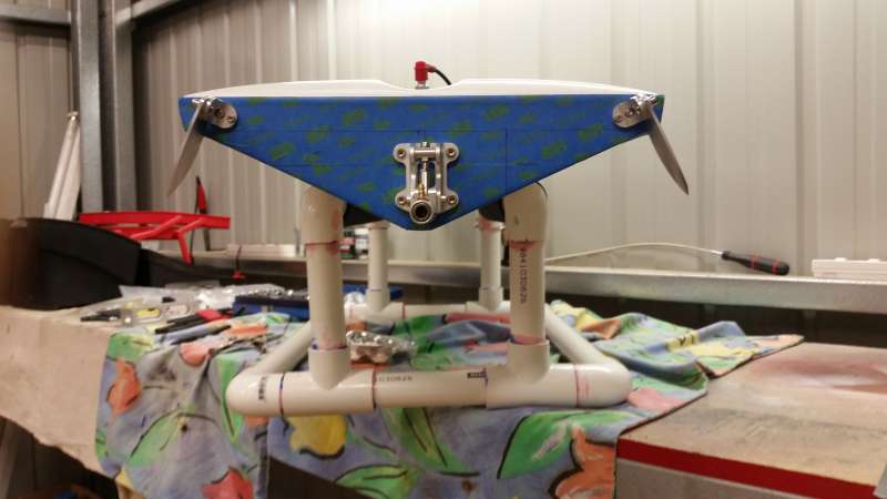

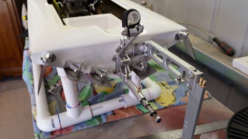

Jase replied the topic: Need help setting up a mono for the first time.
Haven't got far yet. Just marked the transom and mounted the stinger and turn fins. Trim tabs only arrived today so they're next, then I was going to see how much room I had for the rudder. If I mount it flush against the stinger without grinding anything it will be 5mm short of the 2 1/2" mark. That should be fine do you think?
#25123

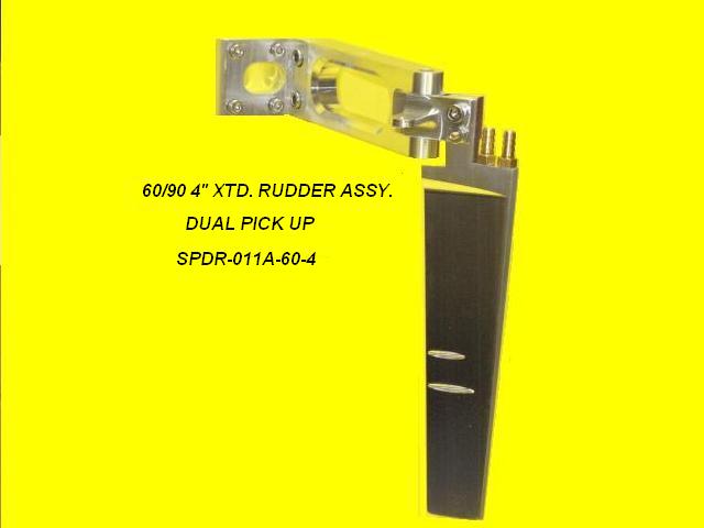

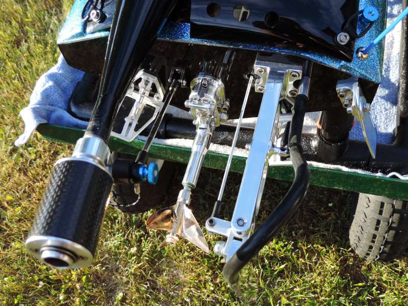

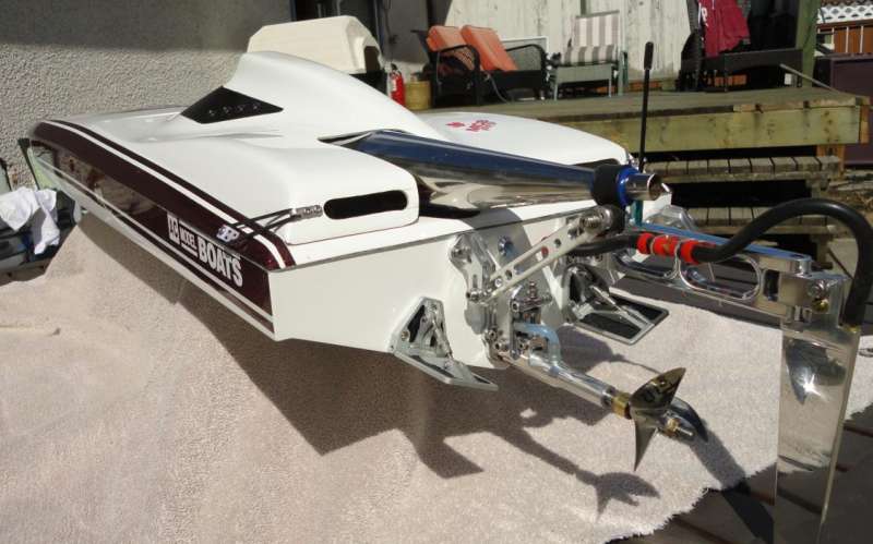

Canadian Hot Rod RC Boats replied the topic: Need help setting up a mono for the first time.
I don't think will bother you a lot as long as you get it straight up and down
If you look at my rudders I use a "T" bracket so there is bolts on either side
if you use a "L" mount bracket it can get close
T Bracket and rudder centerline
L Bracket
#25124
Yeah, I've got an L bracket. Very similar to the one you posted. That's set my mind at ease a bit, I'll forge on ahead to the next road block then! haha

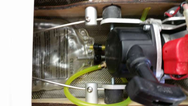

Aussie, are you measuring 440mm from the transom to the centre of the plug for a Zenoah?
What's the 500mm for?

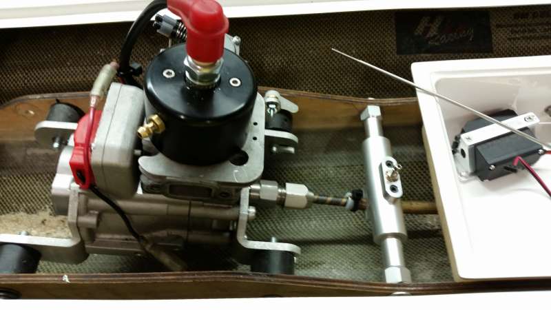

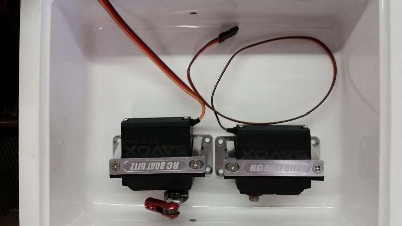

Ok guy's, here's where I'm up to. Any input would be appreciated. A question with the servo mounts, is it better to epoxy them on or bolt them down? You can see the epoxy I have. Or would doing both be the the best?
#25142
danielplace1962 replied the topic: Need help setting up a mono for the first time.
They must be bolted solidly through the bottom of the radio box. Even that sometimes needs wood epoxied to the underside so it is thick and strong. Bolts and nuts and never use wood screws for anything.
