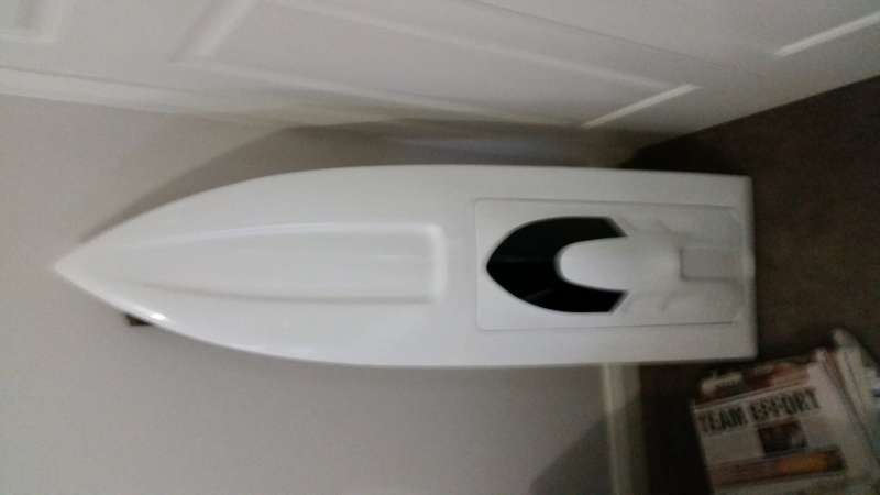

Hi guy's, Ive just bought a new 47" mono hull and it didn't come with any set instructions so I was hoping some of you wise old boaters could point me in the right direction?...

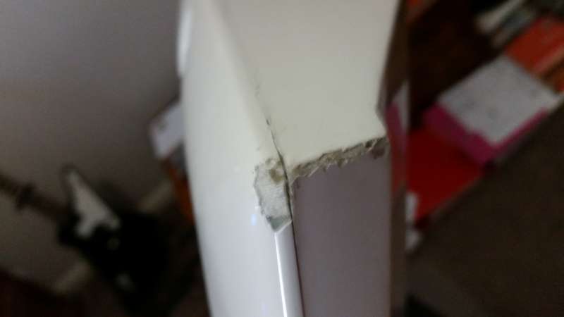

PS, whats the best way to repair the damaged gel coat on the corner?

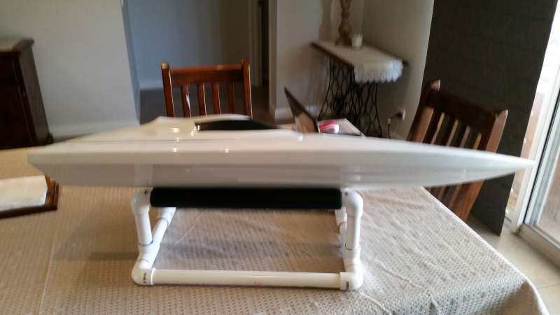

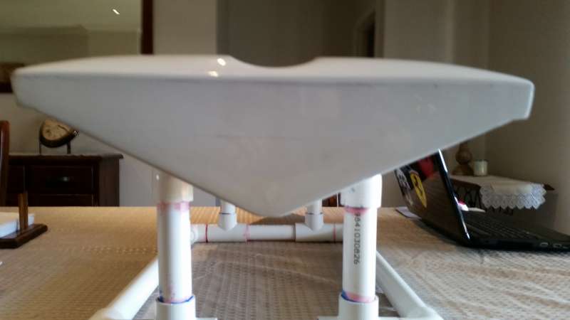

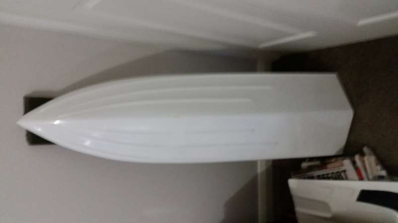

The first thing you should do is check the bottom of the hull for rocker or hook. Put a straight edge along the rear ride surface to check. If it has hook, look to see that it is uniform, side to side. If not, it needs attention before anything else.
That hull appears to have a rounded or flat ride pad at the transom. That will make it a higher lift hull. If you are going to put ANY descent power to it, I STRONGLY urge you to offset your drive 1/4" to 3/8" to starboard. This can help greatly to stop bad handling on light, high lift V hulls. The stuffing tube should be held by a "T" bar up near the engine, and a simple hole drilled through the transom. Depending on what drive you use, the stuffing tube can pass out through the transom, and into/up to, the drive. I would shoot for 5/8" above the bottom of the keel, to the C/L of your prop shaft. You can enlongate the transom hole for up and down adjustment. The 105 drive length will be good, with a 5 1/2" to 6" rudder standoff. You want the front of the rudder blade to be slightly behind the prop, offset 2 1/2" to starboard. Without knowing the power available, I would say a C of G around 28 to 30% with a half load of fuel. It's very easy to increase it, and harder to reduce it.

You can go to local Real boat store or shop and ask if they have a Gel Coat touch up kit in white to fix damage - most will have kits in stock
