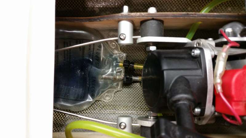

I have a few small (4 oz) bottles I fill before we go
like these
#25157
Jase replied the topic: Need help setting up a mono for the first time.
Ok cool. My oiler has a nipple tho, maybe the syringe idea might be the go.
Thanks for all the help by the way, it's really helped me out.

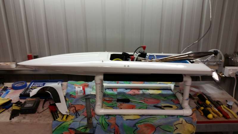

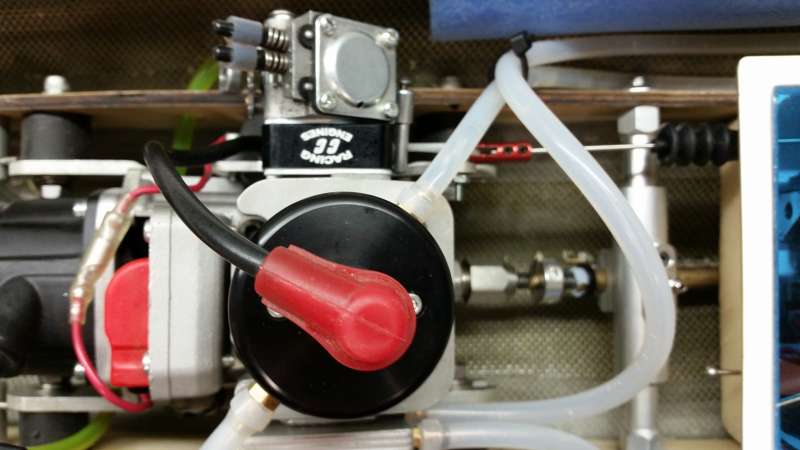

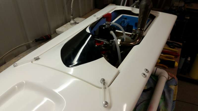

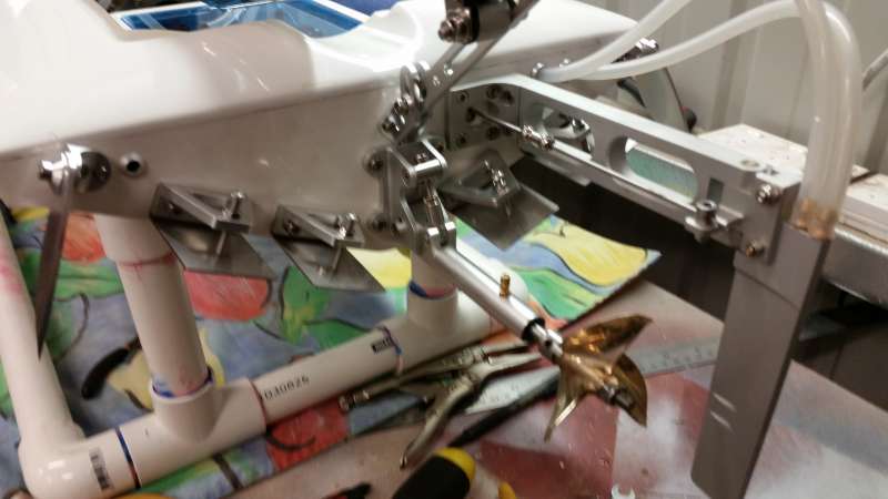

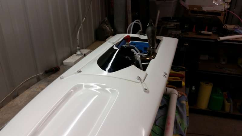

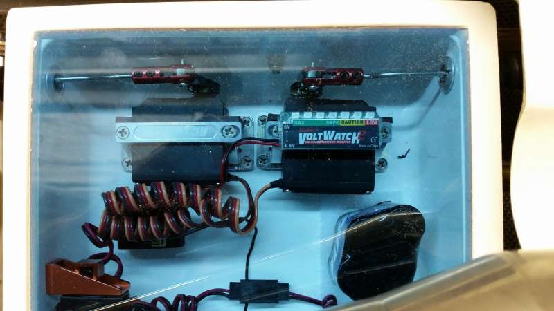

So here's what I've got. I think I'm ready to hit the water for some testing.
#25173
Canadian Hot Rod RC Boats replied the topic: Need help setting up a mono for the first time.
Looks like fun -you did a good job
make sure u have enough floatation inside and a piece glued to hatch so it floats as well.
try not to get your hoses too long from rudder to boat - they can flop around and come out if there real long.
Zoom Zoom :woohoo: :woohoo:
